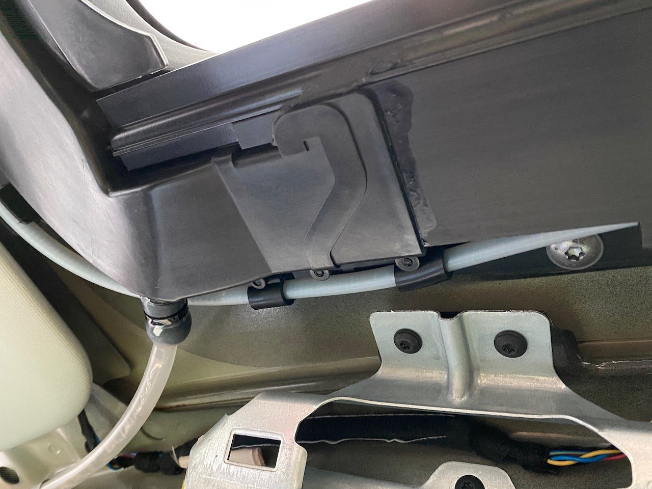

This article describes locating and rectifying a catastrophic water leak into the nearside passenger compartment of a six year old Škoda Yeti, which had a standard-fit panoramic sunroof.
  • The leak was traced to the NSF corner of the sunroof by removing the top of the NSF door seal and the NSF screen pillar trim.
  • Subsequent removal of the headlining and testing of the sunroof showed the cause to be failure of the seal between the aluminium channel forming the nearside of the sunroof frame, and the plastic channel forming the front of the sunroof frame.
  • The sunroof was removed from the car in order to run a penetrating sealer vertically down into the defective join, using a syringe and needle. Upon re-fitting the sunroof, the remediation was found to be successful, however the corresponding join on the offside front had been compromised, presumably because of the mechanical trauma inflicted on the structure during re-fitting.
  • The offside join was subsequently sealed successfully with the sunroof in-situ, using the same method.
  • Experience showed that (once correctly identified) a repair could have been effected without any dismantling, although the seats, carpet and underlay were subsequently removed in order to dry them properly.
The full story, together with annotated images is in the attached pdf document. If you're suffering with the same problem, I hope you'll find it of help. Please post any comments or questions.

A quick update on the leaky sunroof saga.
After several warm weeks I'm confident that the join between the plastic drain pans and the aluminium cassette is as dry as it's going to get, so this week I set about adding Captain Tolleys Creeping Crack Cure to the offending crevices, squirting it upwards from the freshly opened bottle because I couldn't find the syringe and needles which I'd procured back in winter. After 4 applications several hours apart it seems that the gap is now filled, and there hasn't been a single drop of water ingress following a night of very heavy rain. A replacement needle and syringe is on the way and then I'm going to tackle the other three corners, which haven't leaked yet but are bound to start as soon as the roof lining is back in. Speaking of which, I've gotten so used to the 'superleggera' interior that I may well leave the liner out until next spring, because we get some tremendous rain during the winter months and I want to be sure that it's finally fixed.
Speaking of rain, here's a clip showing just how much flows down the drain hoses during even a light shower. This one's clear because I've replaced the stock hose with a silicone tube, on the basis that it'll remain elastic far longer than the standard connectors, which will probably get the same treatment before the liner goes back in. Fingers crossed!
