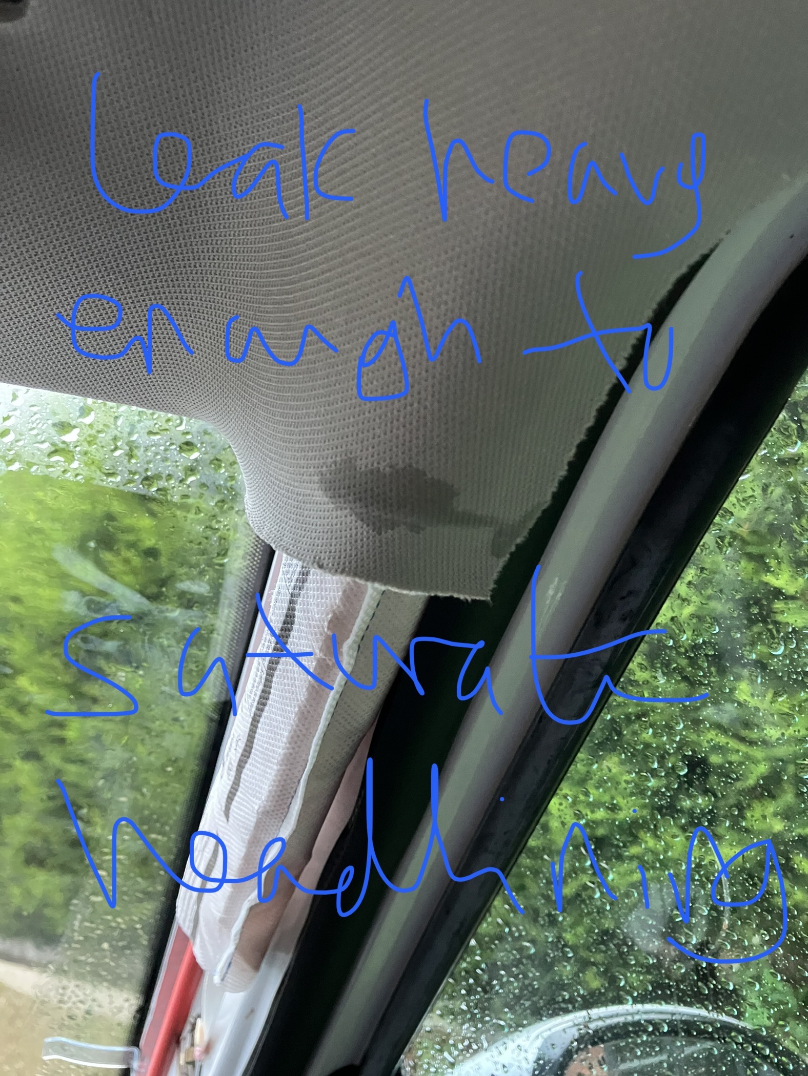

I have owned a pano L&K Yeti for getting on for two years and obviously I have a sunroof leak. Why else would I be here…
Like others, I have common symptoms: lots of water in OS F&R footwells, wet around OSF curtain airbag, surface corrosion on fuse box. All drains are flowing water freely when poured directly into them but cannot see any source of free flowing water in the vehicle regardless of sponging endless amounts of water from the insulation. I guess the trickle is slow and constant and signs disappear quickly once the source (rain) stops.
My questions to those with experience (apologies if this info exists within this chat but I did spend hours reading this page and other forums over the weekend) - for those who have paid Skoda for new sunroofs, new seals, new drains - have the problems resurfaced? Was it worth the repair? I would feel less bad paying for a repair with the knowledge the issue isn’t just ticking away again. I would now prefer to have a model without a sunroof but have a well-specced low miler and would actually like to keep it.

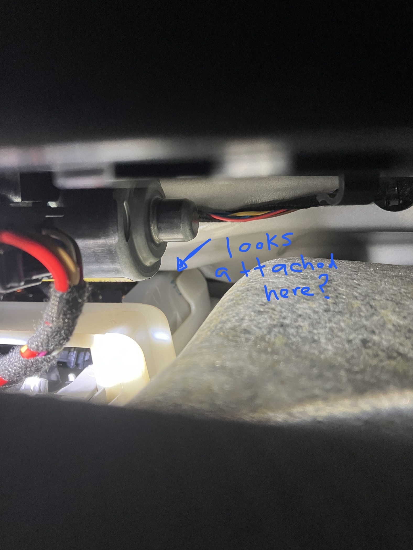

I’m trying to drop the headlining but am struggling with the section with the sunroof controls and reading lights. Do these controls belong to the car or the headlining and if the latter, how do you continue to open/close the sunroof once detached?

To those who have removed headlinings, what is holding up the sunroof and reading light controls? I’ve only removed the OS sun visor and driver’s grab handle. Do I just need to remove the NS to get better access?

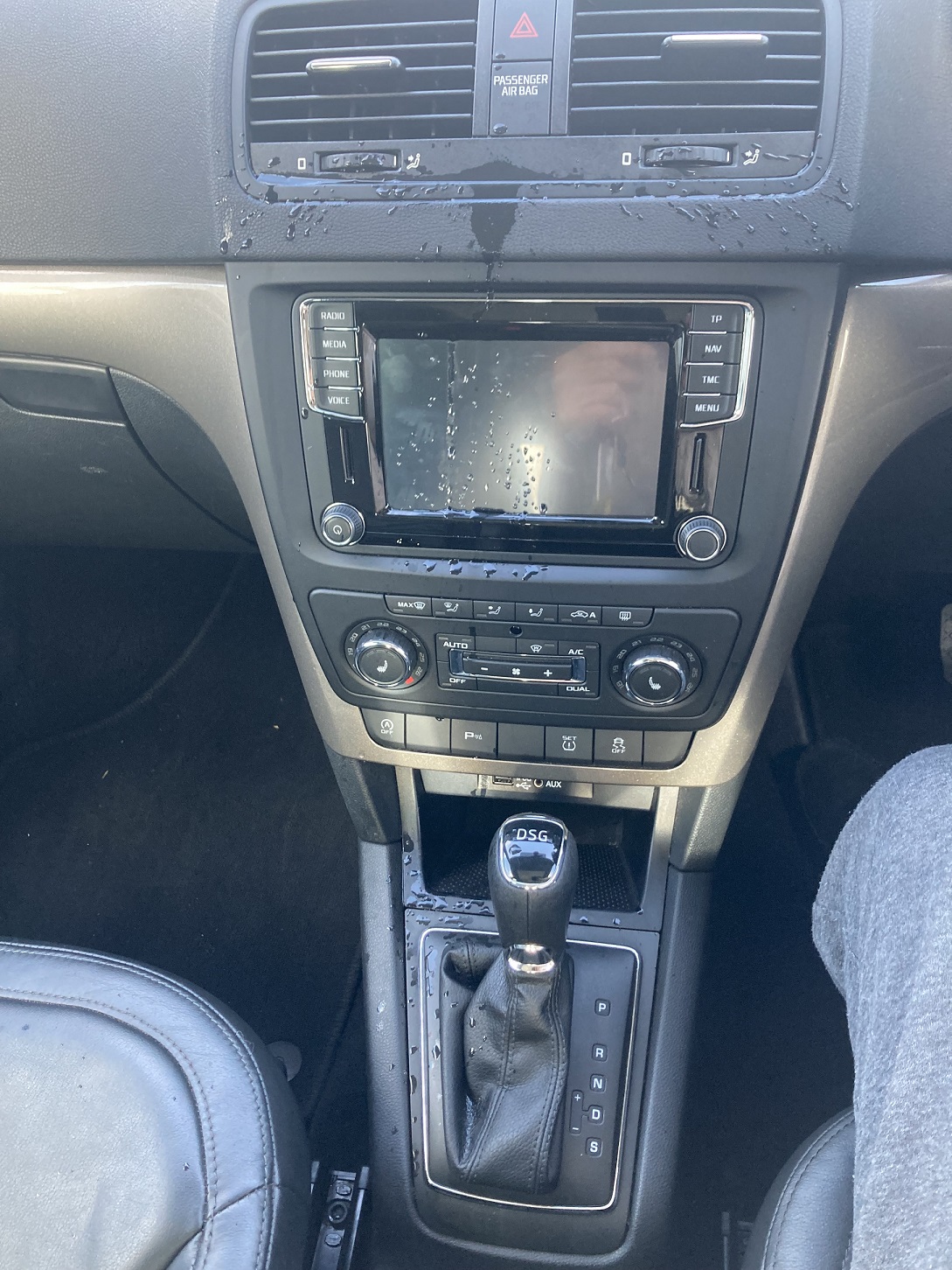

How do you remove the centre console up to the gear stick? Mine is a DSG. I’ve seen the removal of manual stick trim which looks easier as the gearstick gaiter is soft fabric opposed to the hard cover of the auto box stick.

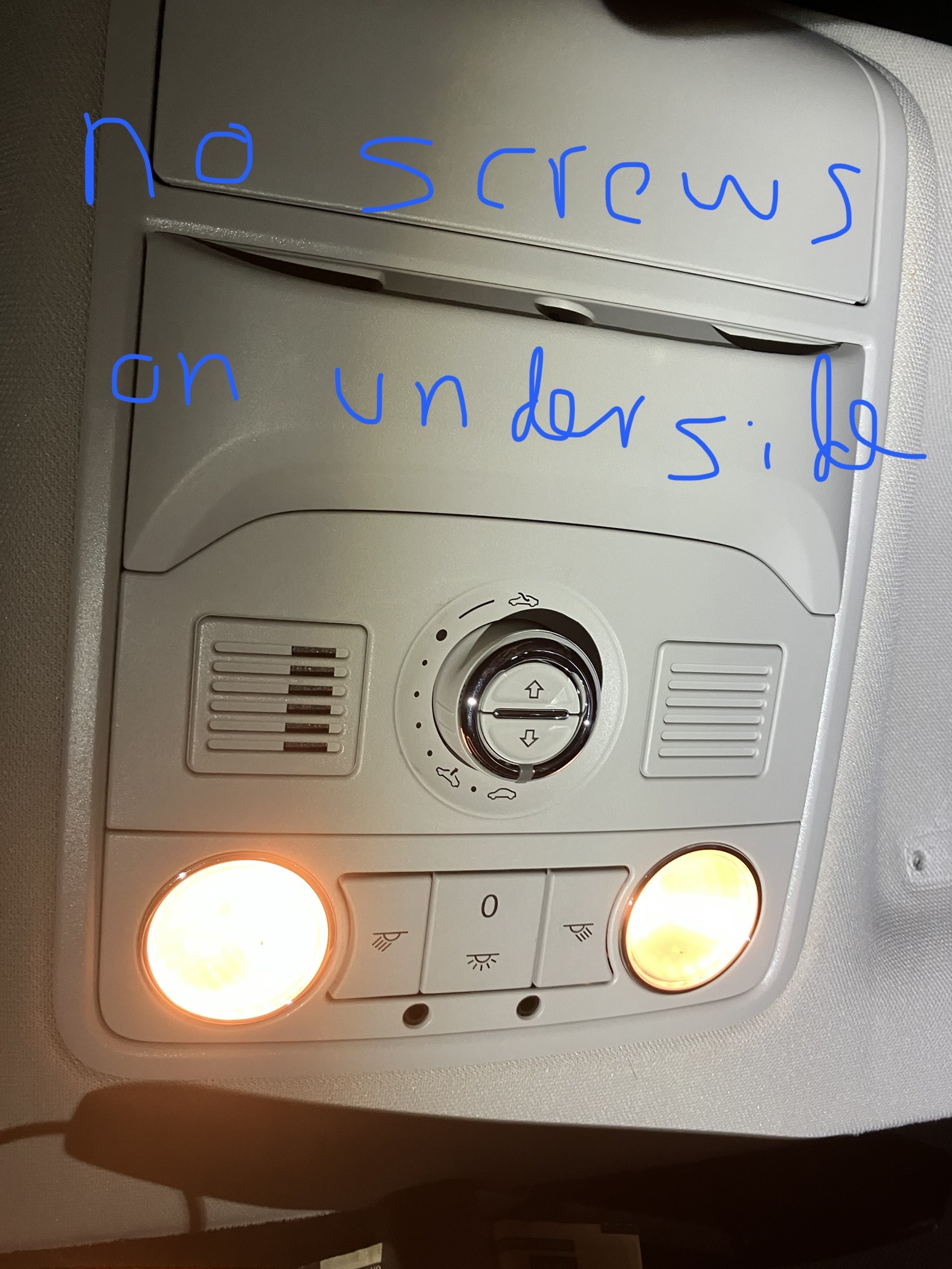

I have removed the driver’s side sunvisor and grab handle and detached the A pillar cover to reveal the curtain airbag and drain tube. Also removed the headlining from the fixtures all the way to the rear quarter panel window so can see above i t at the driver’s seat where my leak is. I don’t want to apply too much force though but would like to get better access to effect a repair.
If you peer in from above the headlining at the sunroof controls, you can see what appears to be mountings just back from the windscreen but nothing corresponding on the underside of the lighting cluster/sunroof control panel to unscrew.  Do you pull that panel apart to access screws or does it come down on the headlining once the sun visors are removed on both sides of the car?
I don’t think I’ll be able to remove it entirely as the are dog cage mounts in the rear which hold it in place. I’ve no idea how they are attached.

Please could you give me some pointers with regards to getting the headlining down sufficiently?
There's a PDF floating around on this forum which I followed without too much issue, and I'm glad I did because some of the things you need to remove - sunroof controls for example - are not straight forward, and it really helps to see where the fasteners are located beforehand. I thought I'd saved it locally but I'm not able to put my finger on it now - have a scratch around and I'm sure you'll locate it. Whatever it takes, I recommend taking the headlining out in order to do any work as otherwise you'll only end up damaging or marking it otherwise.

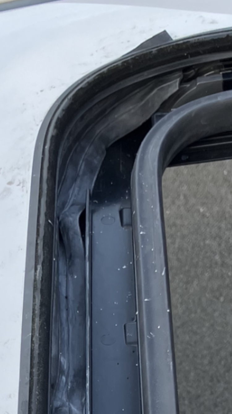

Would the inner tube flashing get sucked out while driving with the roof open?
Not insurmountable for a man with your fault finding logic and ingenuity but something to consider.
@J.R.no, it’s a small section and held firmly in place by the roof seal. The part exposed protrudes downwards into the plastic tray.
Additionally, given the profile of the inner tube is only ~0.5mm thick, it has minimal impact on the way the other seals and mechanicals of the roof, and wind buffer function.

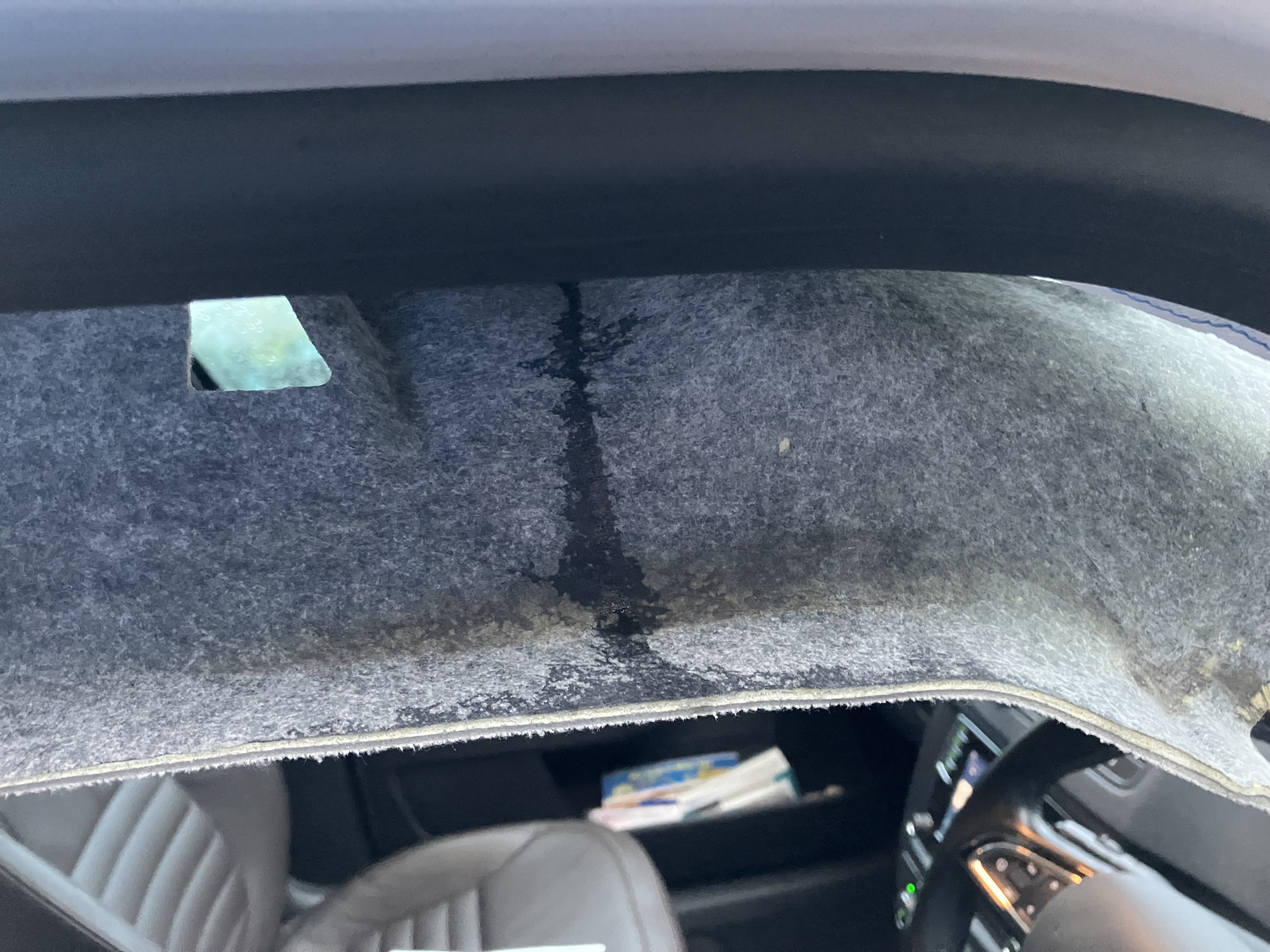

4 hours ago, BeePM said:
Doesn't change the fact I now have a fresh anxiety kick in every time it lashes down with rain. As soon as the rain stops I'm straight out to check if there is any ingress into the car.

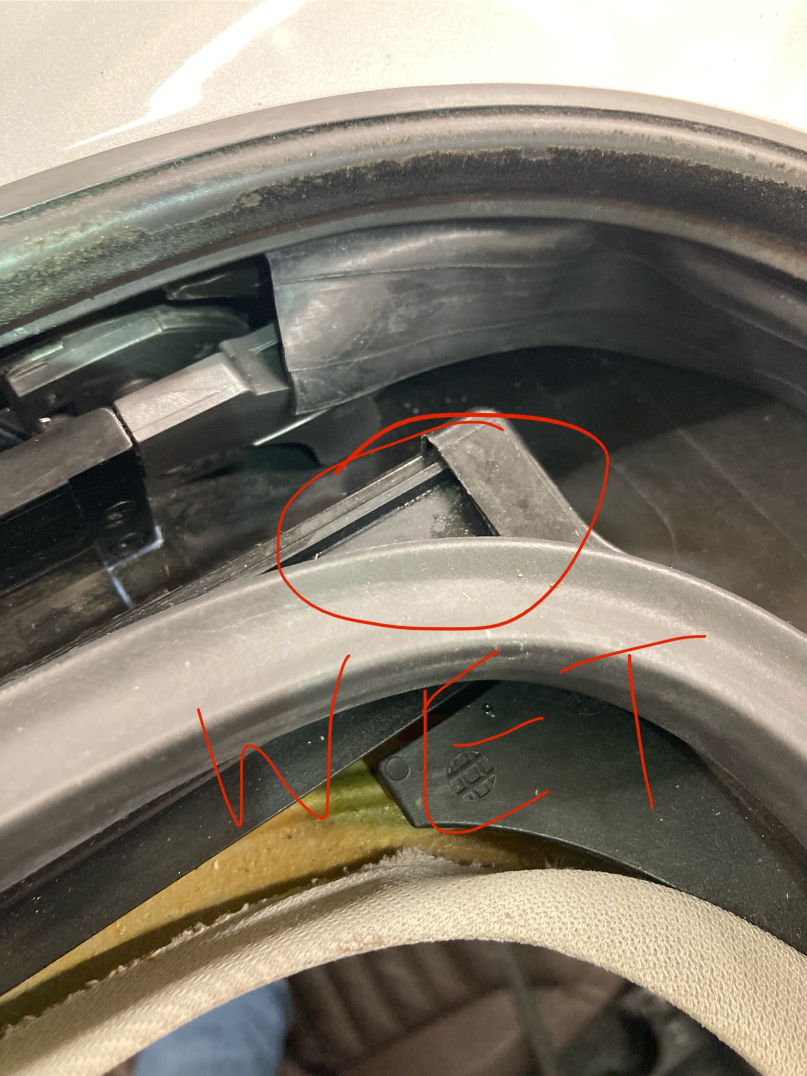

This may not do your anxiety any favours, but I found I had greater chances of water ingress if the car was parked facing slightly downhill. Might be worth your while forcing the issue, if you still have some warranty on your fix?
@BeePM do you know specifically  what your dealer fixed on your car?
Anyone else who still suffered from leaks but has tried sealing the plastic-aluminium joint looked at the overlap of the front of the main seal into the plastic tray (the one I have the cotton bud in)?
Agreed. Not the first time I have read / heard this and makes complete sense, especially if the issue is partially blocked drainage hoses / routes or leaking joints, which my issue appears to have been. Not only am I able to park on quite a steepish slope most evenings (plenty of hills where I am) but the car is looking lovely and clean because of the amount of pressure washing & car washes it’s been getting. I also park it nose up as well as nose down, to test both front and rear drainage routes. I had a long journey over the weekend, roundtrip of 400 miles and it completely lashed down both trips there and back. Although I found the driving in such torrential rain extremely challenging (most sensible drivers were reduced to 40 mph on the motorway, visibility was so bad) I tried to look at it as a good real-life test, and there wasn’t a drop in the car, so I’m fairly re-assured for now the dealer has sorted the issue, time will tell (insert fingers crossed emoji here).

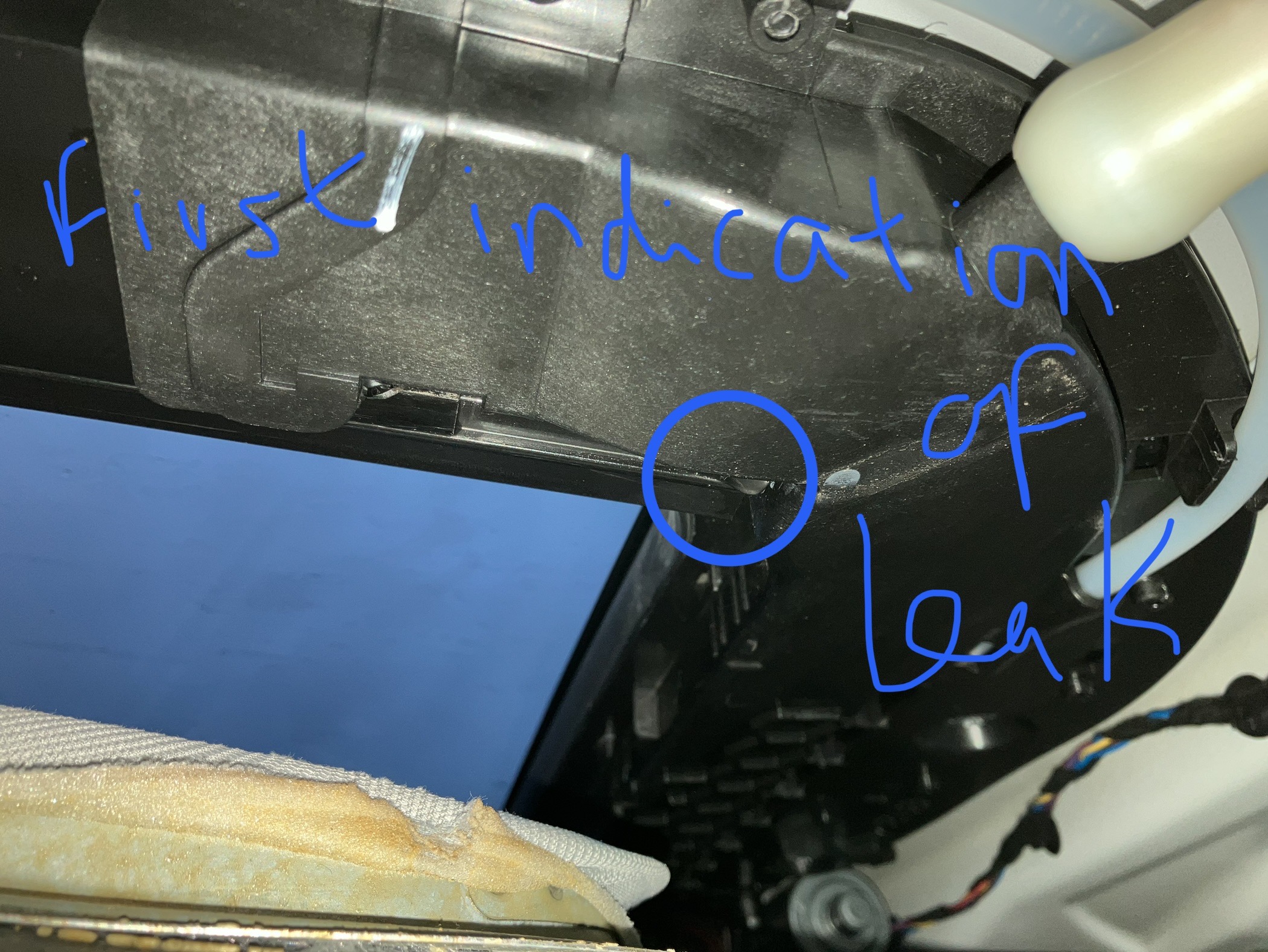

If the dealer is to be believed; it was the more common culprit of the drain hoses, where they join on to the collection tray spigots. I say ‘if the dealer is to be believed’ because the aftercare sales guy said there was a crack which needed to be sealed, but when I spoke to the actual mechanic carrying out the work, he said that it was the hose joints onto the tray. I also asked for photos to be provided before they re-installed the headliner so that I had an audit trail in case of future issues. Pictures added below of my initial discovery of the leak and where it showed itself, and also from the dealer showing the joints. They sealed all four joints (red hoses to the front, blues to the rear) . They allowed 3 days (allegedly) for the Skoda specific sealant (allegedly) to cure properly before water testing again and then returning the vehicle.
Do I come across as cynical in anyway 😁.
To be fair the dealers have been really good, I am so very glad we didn't go for a private seller. The warranty does offer peace of mind. If there is an option to extend it I will most likely take it.
Storm Ciarán tomorrow and Thursday should be a good test !

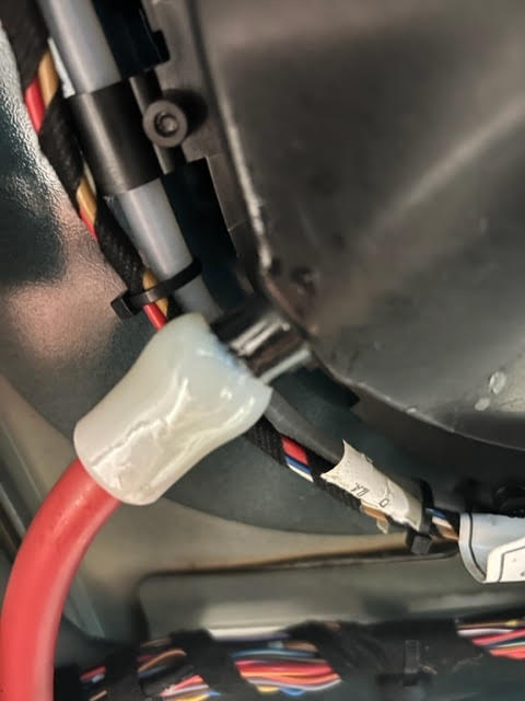

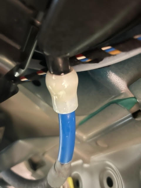

The problem I had with mine was the passenger side front drain pipe was "kinked". I took it into our local Indy and they replaced it. At the same time they "glued" all the pipes in place as they said that tended to be the main problem....ie the drain pipes coming loose and allowing water to run down the outside of the pipe into the car...
...NB I did not have a problem after this, but I decided to tape up the sunroof using clear gorrilla tap anyway, (just in case / paranoid), and obviously did not open the sunnroof again. Took the tap off when I sold it after 4 years....

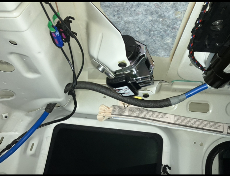

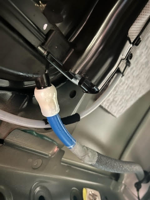

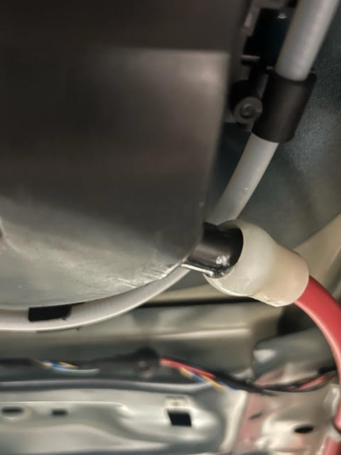

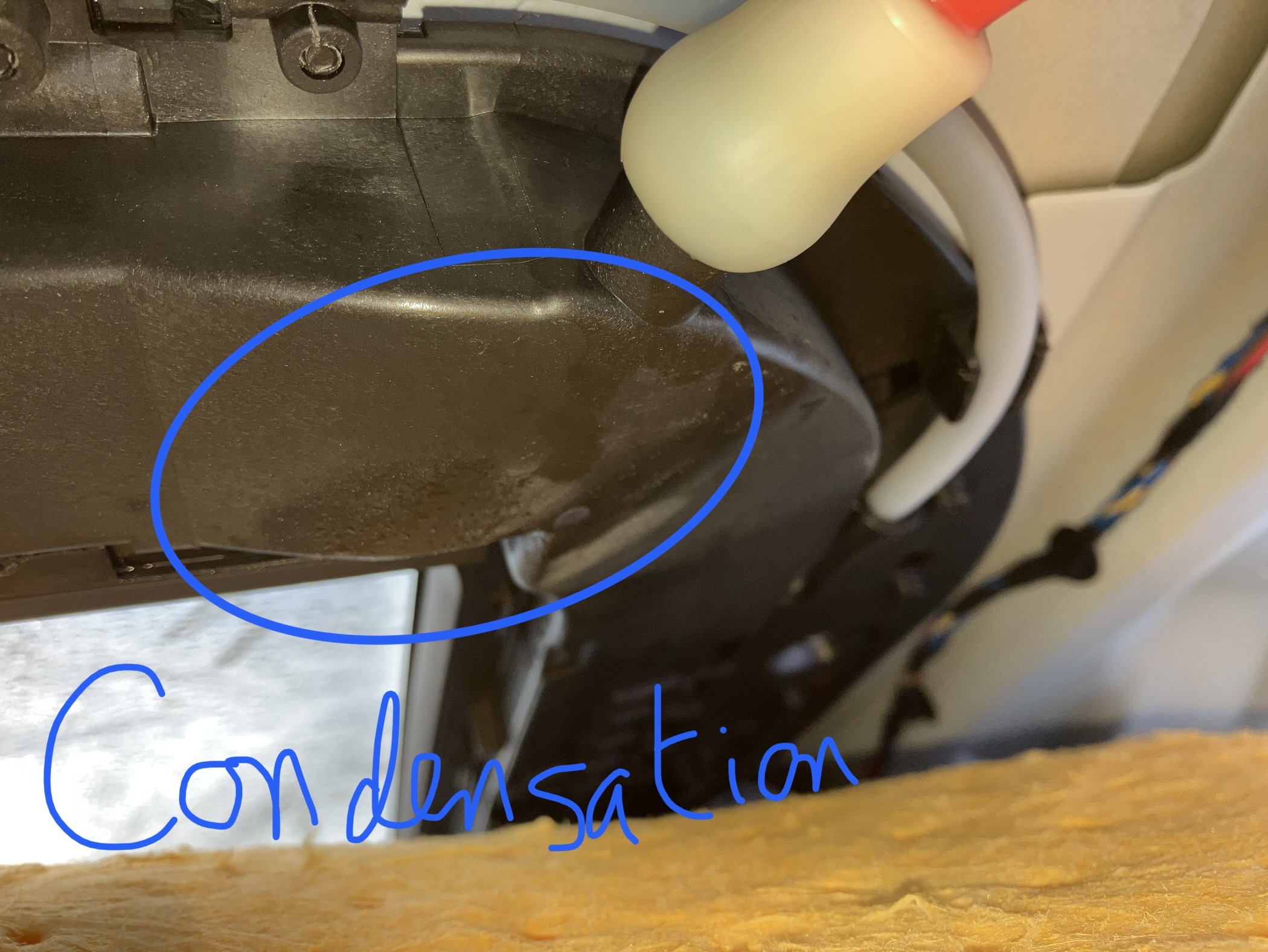

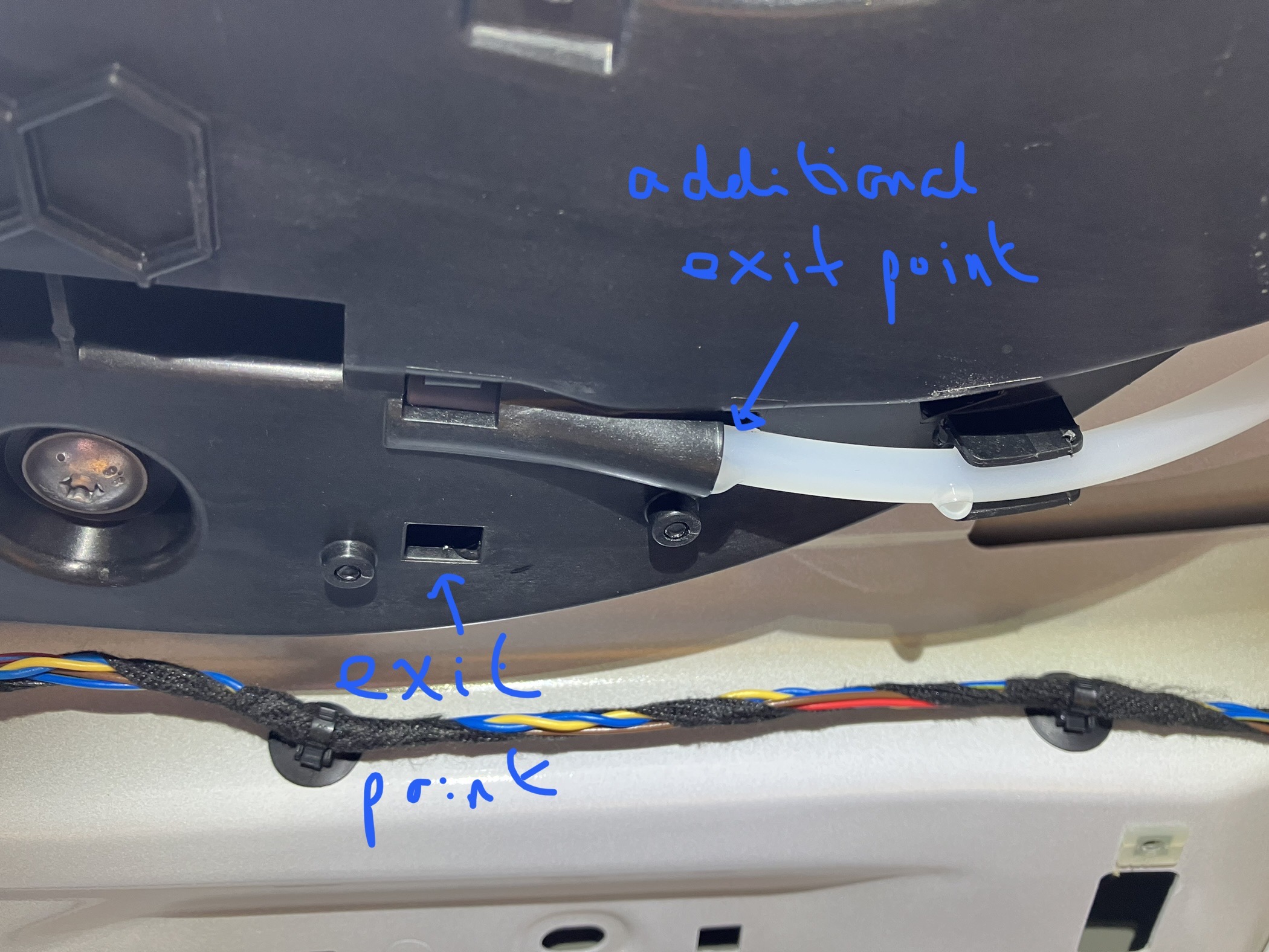

I have finally found the cause of the gluggling/bongo drum sound from the rear of the car when the fan is on and the outside conditions are wet.
A drain with a direct passage to the ground would not make this sound, and for a number of weeks I have thought it sounds like there is air trapped in the drains like a U bend. Even if the drains were partially blocked this sound should not occur. It can only happen if a liquid has the sort of non-continuous flow you get when pouring a full bottle of wine - the air stalls the flow of wine as it equalises the pressure in the bottle. If you were to pour a liquid down a section of tubing, even partially blocked, you will not hear the sound provided the tube travels continuously downwards.
So, the cause is indeed a U bend effect.
Take a look at the profile of the rear drain (blue pipe in image).  It runs downwards then back up before entering the enclosed box section behind the seatbelt. Since it falls and rises, water will sit in the low point.  With a positive pressure of air from the cabin pushing past it, the trapped water will make this sound. The only way to prevent it is to eliminate the rise and fall nature (though in reality it is fall and rise). This could probably be done by lightly strapping something slightly stiffer to the drain such as a thin section of wood or stiff plastic, so the drain always travels in a downward direct or at worst, only has level spots.
Nobody has reported the sound coming from the front of the car, only the rear. This is because the front drains have a continuously falling profile.

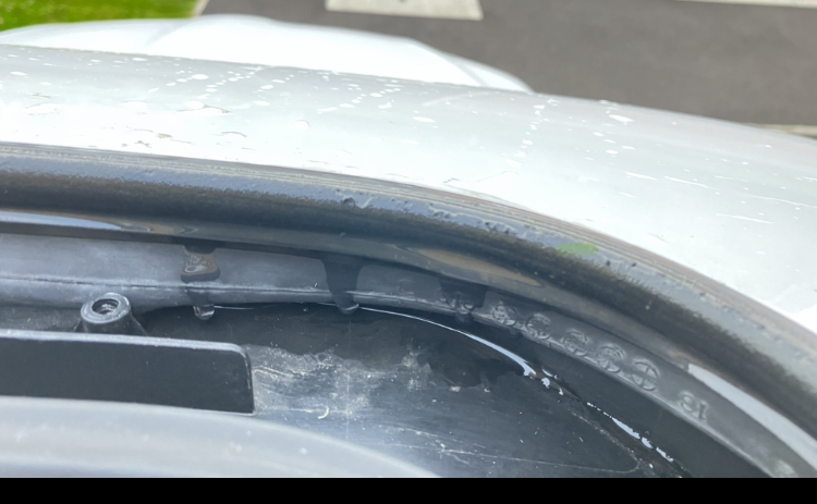

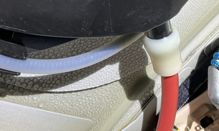

With the car standing for a week in the cold weather, I also noticed the roof, sunroof and windscreen were heavily covered with condensation. This presented as a combination of small and large water droplets which formed due to the vast amount of water still trapped in the car.  We all know condensation forms as humid air contacts cold surfaces (roof, sunroof etc). The aluminum sunroof channels of the cassette can also get cold and a provide a ‘good’ place for condensation to form.
Since it only takes a few droplets to coalesce, a larger droplet of water can easily form and drip wherever this happens (usually from the aforementioned cold surfaces).  This can give the appearance that the car is leaking from places it actually is not. I believe this may be the case for many people who think their sunroof is leaking from the plastic-aluminium joint on the sunroof cassette. I myself saw water here and figured that was the point of ingress. The fact is, with enough water in the air, it can condense and drip virtually anywhere. With the headlining in place though, it will most likely run down the pillars making people think their drains or cassette is leaking.
I you have tried to seal your drains or cassette without success, try the inner tube method I described above and see how you get on.
Below image shows excessive condensation with no leaking on or around the front drain hose or hose connection.

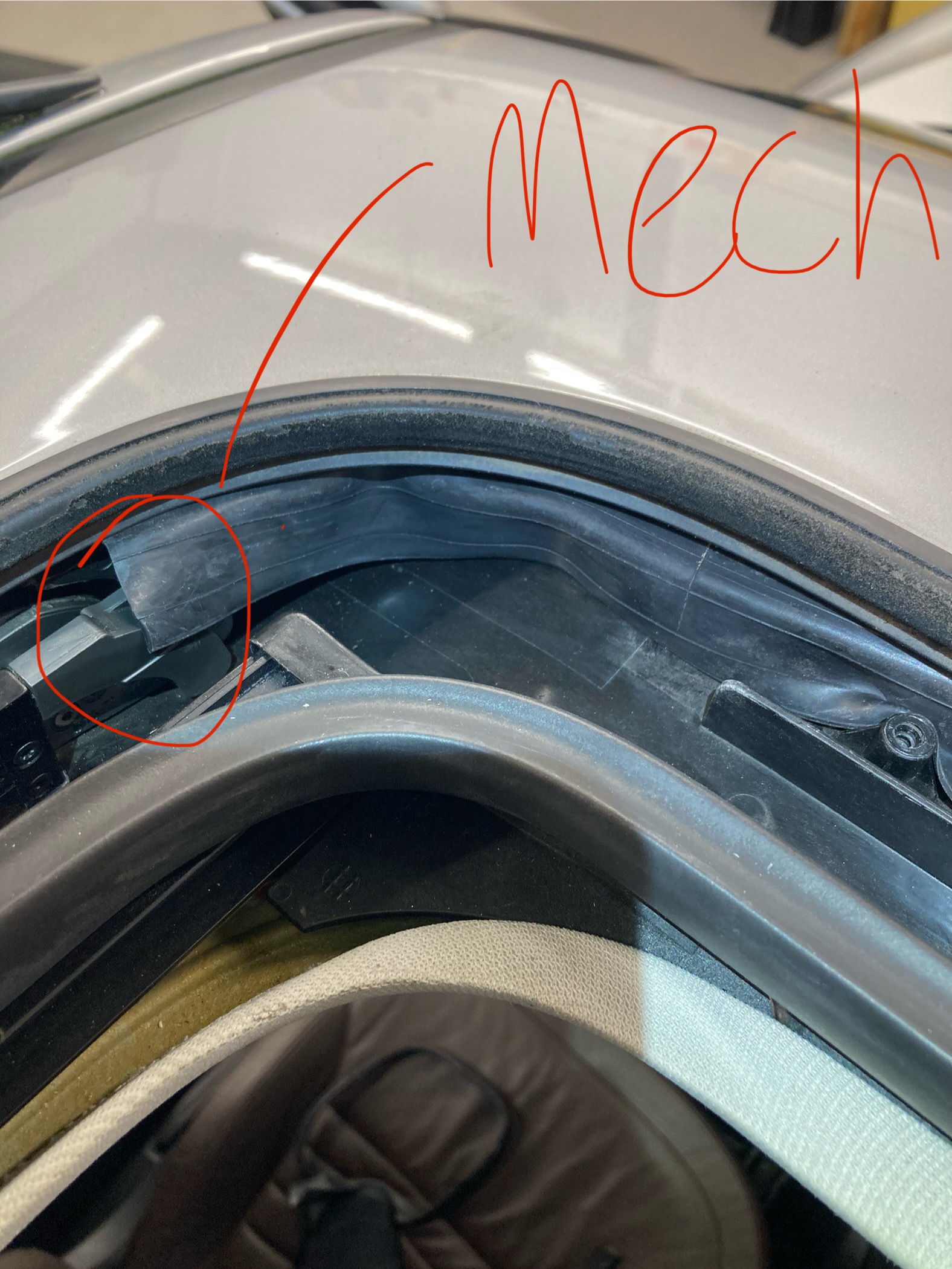

I've been following this thread for a while now and have tried many of the creative and appreciated fixes suggested by soggy-Yeti owners to date. To me, there's always been something fundamentally wrong that we've not identified as owners yet. My car has got progressively worse over time and the volume of water that's coming in to me implies a direct path, I suspect not (or in addition to) a capillary path.
@Wetiwhen I read your post it made a lot of sense to me and hence I popped out this evening and fashioned the seals out of inner tube that you suggested, installed in mine. The design of the OEM seals really is crap as the whole thing depends on the drip pointing down the way otherwise the water is going to potentially run from the seal into that gap. The seals on mine have varible angles and I could see your hypothesis holding water (excuse the pun). Kudos for spotting it and providing this suggestion of a fix. I'll be delighted to test it.

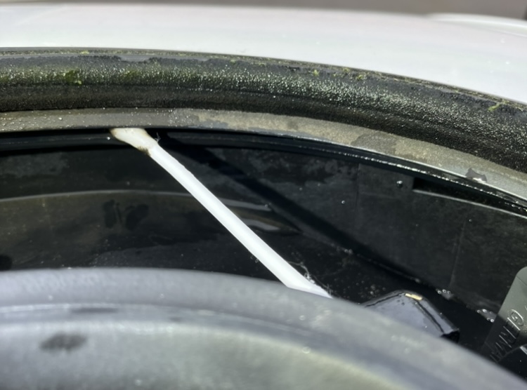

I couldn't see how you'd got this concept to work with the sliding roof mechanism, so I simply ran the seal as far as I could around the front before it would start interfering with the roof mechanism. My leak is NSF.
While I was in there poking the inner tube in with a cake knife (the extant seal does seal nicely to it - nice thinking!), I spotted something. Has anyone considered the possibility of the wind deflector forming a structure to channel water from the area where it should drip into the tray to the inner part of the assembly? I saw that the inner plastic at the corner of the assembly was wet (highlighted in the image). The only way I could see water getting there was via the wind deflector.
So I clipped out the wind deflector/fly screen (dead easy with flat blade screwdriver) and will try this in conjunction with the fix that @Weti has suggested.
It's been kept in the garage for the past couple of months, it is out in the Scottish rain tonight.
