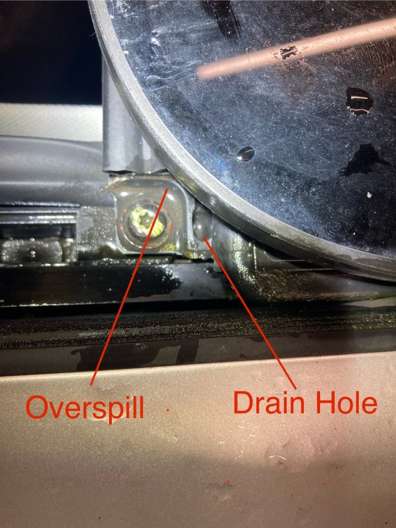

  • I have taken a different approach to a repair, which has shown to be somewhat effective under controlled conditions - cheap, and not a drop of Captain Tolleys in sight.    After some head scrat

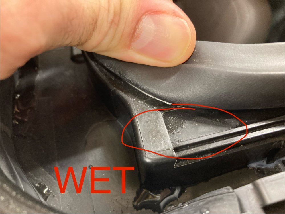

831B4236-ECB2-4825-921D-FB96FCDE83E8.thumb.jpeg.2baa34d8a2fbefb94d151ab9e76fee97.jpegHello again, well so far after copious amounts of welsh weather this weekend the car is still dry,both sides now . I peeled this seal back amd filled the void with silicon sealant careful to be fairly quick to reset the seal and clean up any excess sealant before it got tacky. In my case I believe this was the main cause of the leak although I did use the Tolley treatment as well as said before. It’s a quick trick a d the only dismantling needed is the 5 torx screws ( in red ) removed which hold the fly screen in place at the front , hinge the fly screen back and then that gives access to the seal .as you can see in the second pic the seal is actually deteriorating and may have been responsible for some ingress itself,however,had the pan set up been designed correctly that ingress should have been transported to the drain point irrespective of where or how the point of ingress was. Hopefully this will help those with the roof with the same leak as mine. Good luck.680F249E-10A3-4B05-A617-38CCB2F244FA.thumb.jpeg.10ab65510132af5267f459b8f39f66ec.jpeg

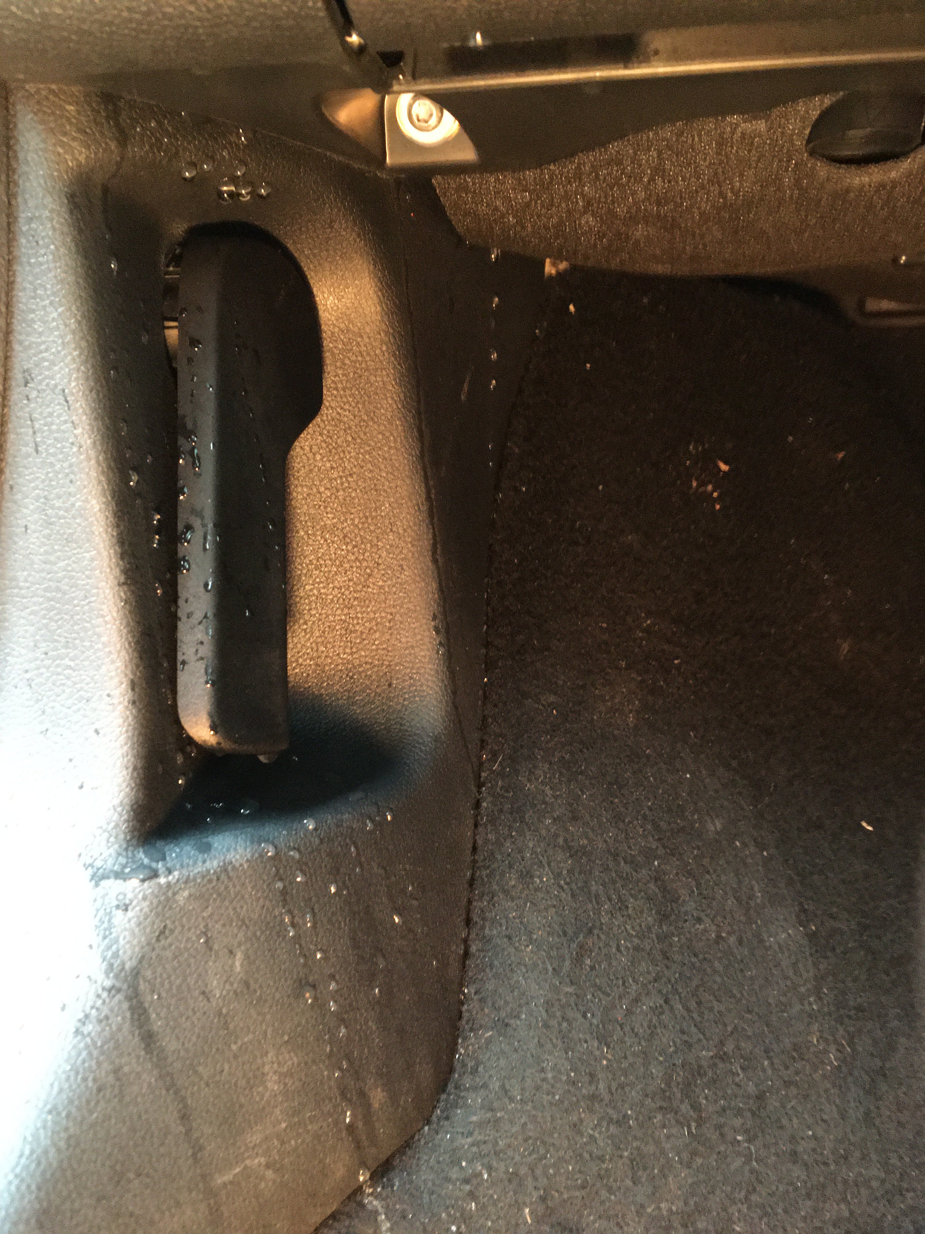

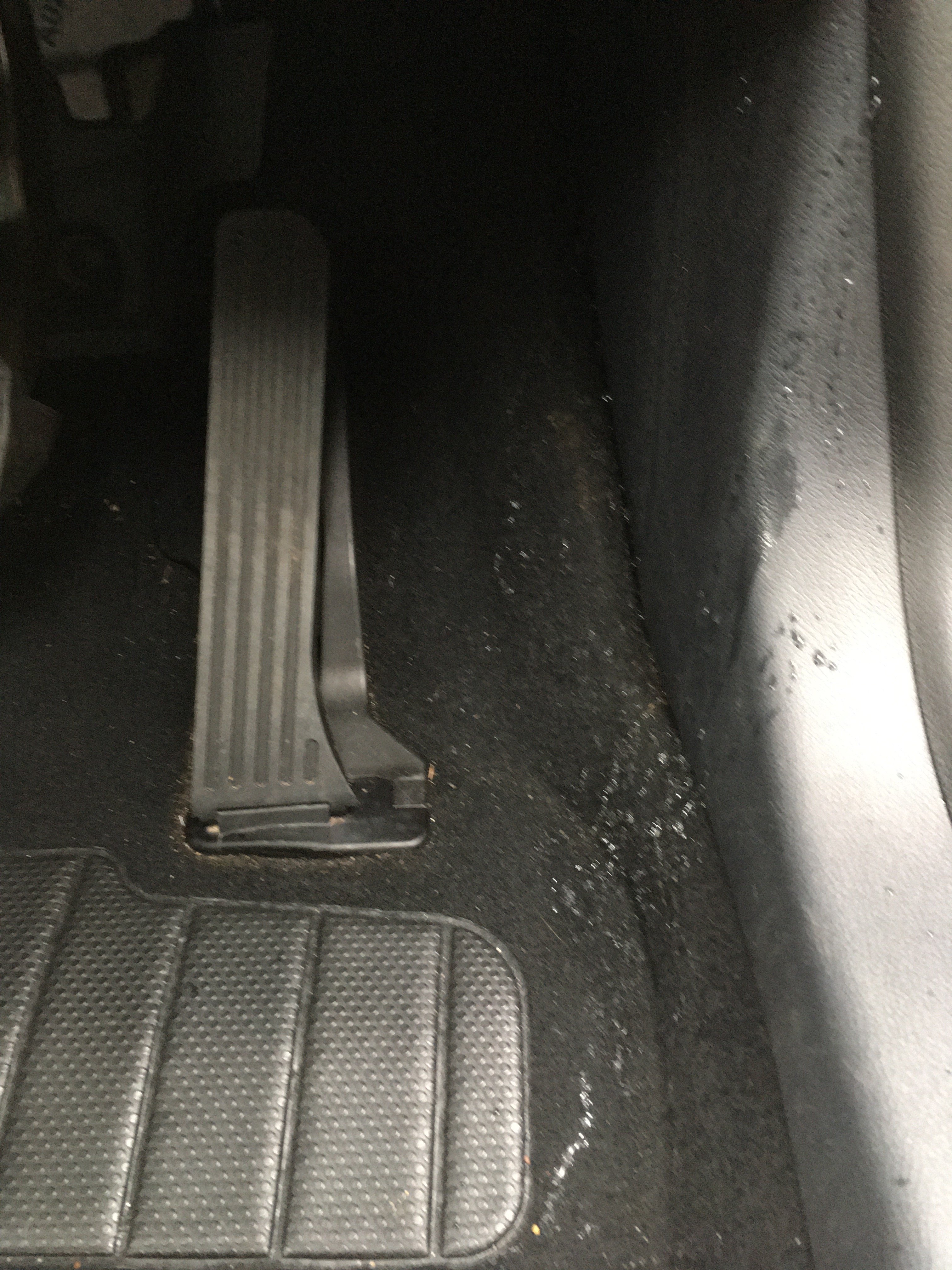

Hey folks. You only tend to frequent car forums when you have a problem so yep, here I am!
I've a 2015 L&K with pana sunroof. Totally drenched with water in front but mostly rear OS footwells. I gather it doesn't really matter though as the floor is flat so water will run wherever.
Car was parked up for quite a lot of the last 6 months throughout lockdown and I only really noticed the issue last week when the windscreen was condensated inside and then the OS rear window wouldn't demist. On inspection, carpets were sodden.
So quick question or two before I embark on analysis as I'd rather start at the easier things.
I have this tapping/knocking sort of noise when the fan is on past setting 1 or 2 and just initially thought it was some problem with a vent. Strangely though it was still making the tapping noise when I was out of the car one night, so is this the telltale signs of the drainage tube being blocked? It was coming from rear OS (or C panel) area.
Second thing - I can see the front drain holes on sun roof frame (not sure where they exit). I can try blowing these through as per normal if I know where the exit hole is. But how do you access the rear drains? When the sun roof is fully open, I can't suss out how to gain access, even before I know where to start looking.
Third, scuttle vents? I had a problem with a USB lead that was failing to charge and just the other day when I was out, the radio started to turn on and off of its own accord. I assume there's water getting in to electrics somehow.... if it was just running down A/B panels for example, I wouldn't expect it to effect electrics, unless if I read correct, the fuse box is in the front and close to the sun roof drain tube route?
So essentially, for those with prior experience, where would you say to start? I don't really want to start ripping off trim or panels if I can help it but will if that's the logical steps.

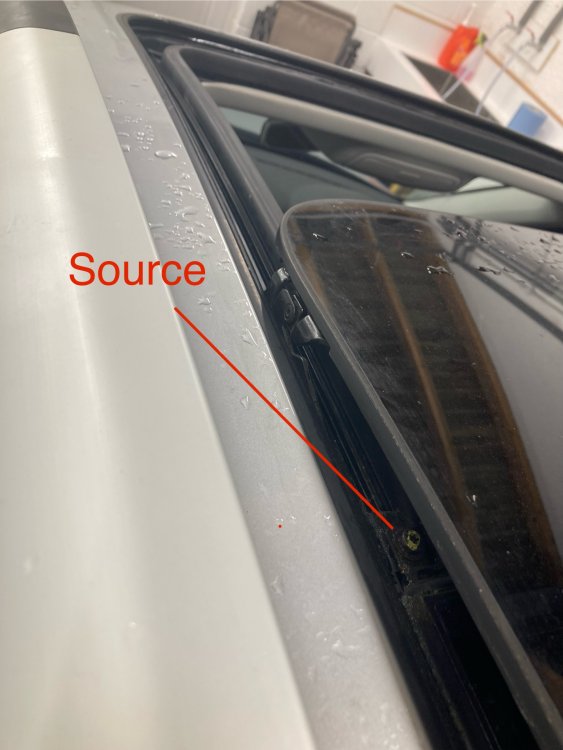

Hello mate! I've had dribbly footwells on and off for just over a year now on my 2016 L&K Yeti, and for the longest time I've put off any remedial action because it just sounded too daunting. About a week ago we had a deluge of biblical proportions and my footwells experienced a flood, so it was a case of biting the bullet or driving around in a foot-spa.
I'll upload a fuller post with pictures in a day or two, but long story short: removing A-pillar trims and pulling back the roof lining is easier than I thought, and I identified the leak as being caused by the rubber grommet which connects the drain hose with the extruded plastic tube in each corner of the sunroof cassette. It appears that this grommet loses some of its elasticity with age and water starts to seep through, which is in line with what others have reported on this forum.
The solution for me was to pull off the grommet, clean it, and re-seat it onto the drain tube once that's been coated with Room Temperature Vulcanising (RTV) sealant, which is a cross between silicone sealant and the proverbial poo from the blanket. Doing that for the first A-pillar took a couple of hours, the second less than 25 minutes. There's an excellent PDF guide floating around on removing the roof trim, and I recommend you spend 2 or 3 quid on a plastic trim removal kit on eBay.

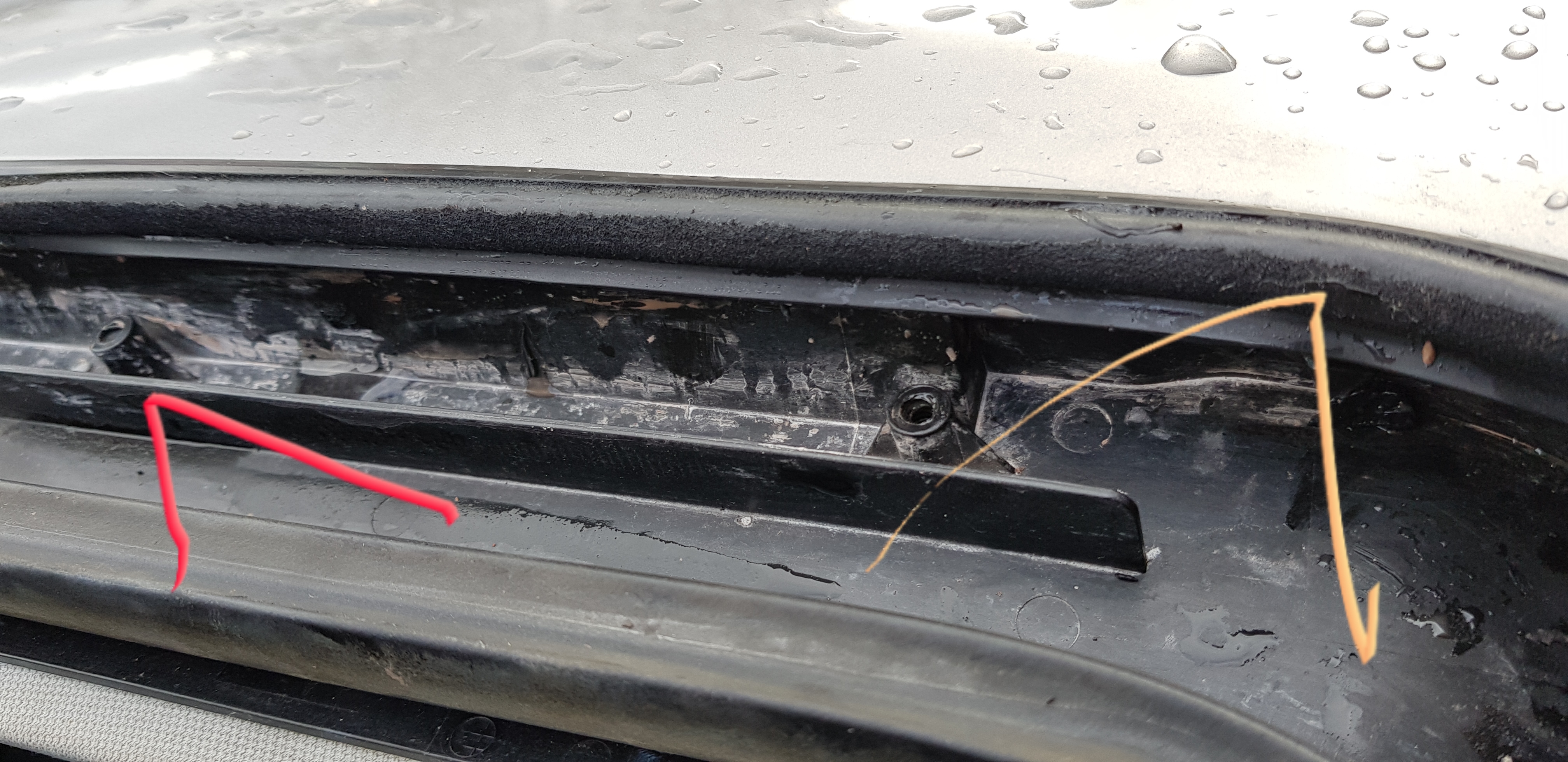

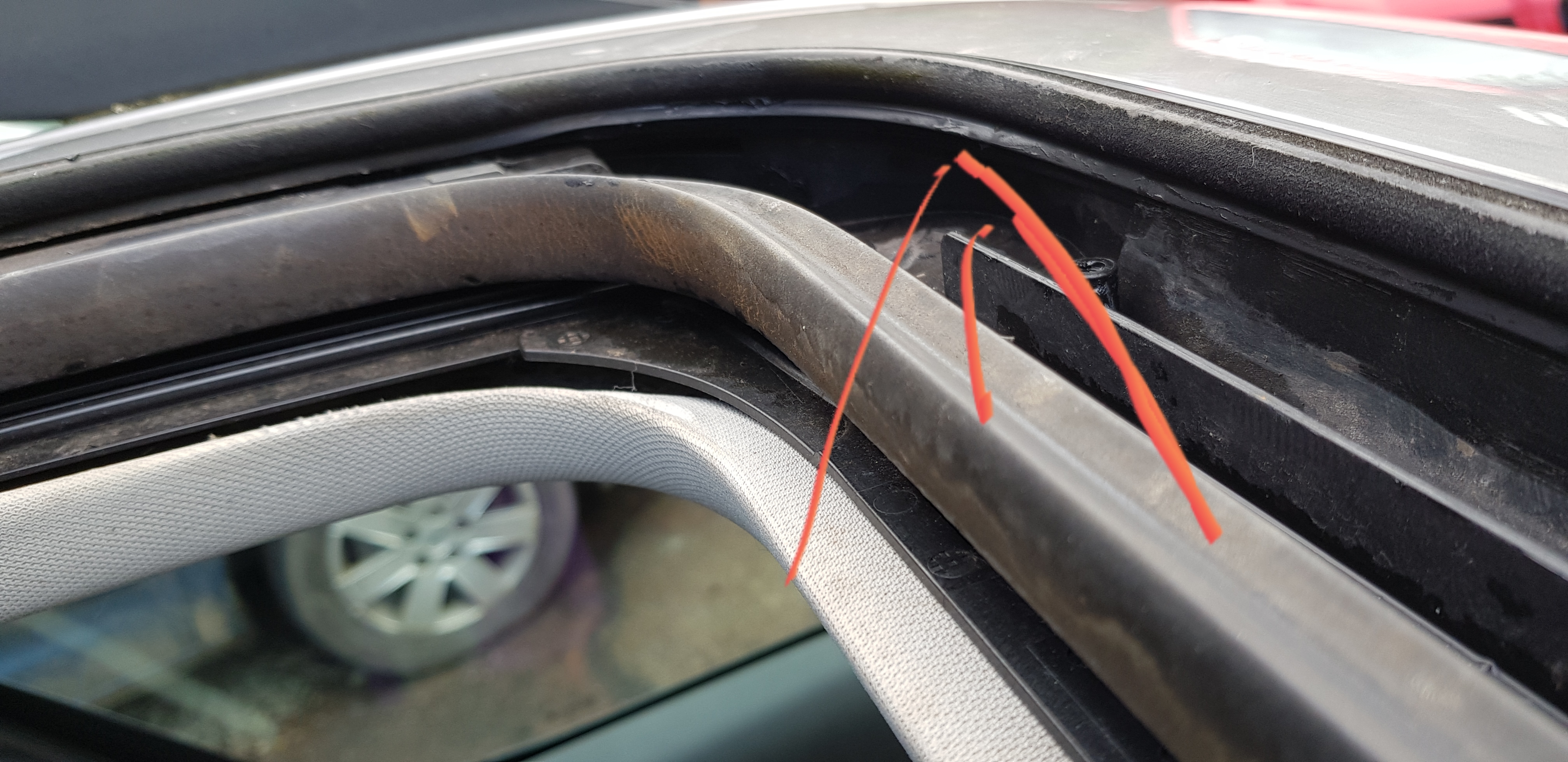

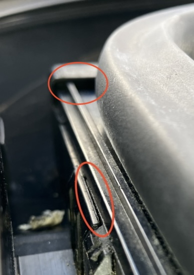

I've just had my panoramic roof repaired (2014 Yeti L&K), not by a dealer but a local garage. They ended up replacing the rubber seals, after a lot of investigation. I've always kept the drainage channels free using a length of bike hydraulic hose (perfect diameter) but it was still letting water into the footwell. It was getting grim in there so it was a case of either seal the damn thing up with Gorilla tape or spend a few hundred to get it fixed, I'd had a good look under the roof lining but couldn't get further. It ended up costing nearly £2k, and now the leak is fixed but DAB reception has pretty much gone. The garage won't accept that it's a problem so I wish I'd just bought the Gorilla tape now.
Anyhow they tell me the life of the rubber seals is about 4 years and it's a known issue on VAG sunroofs. Known by them, maybe.

I think the kit was about £260 if I remember rightly. I don't have a part number I'm afraid and yes the sunroof had to come out. The water was getting in via the leaking seals, I suppose, and it has fixed the problem. But it cost about half the value of the car to fix.

Hi, hopefully you can download this pdf file. Keeping the car dry during the treatment and 'less is more' Captain Tolley's (i.e lots of small doses) is critical to success.
Yeti Panoramic Roof Leak.pdf
