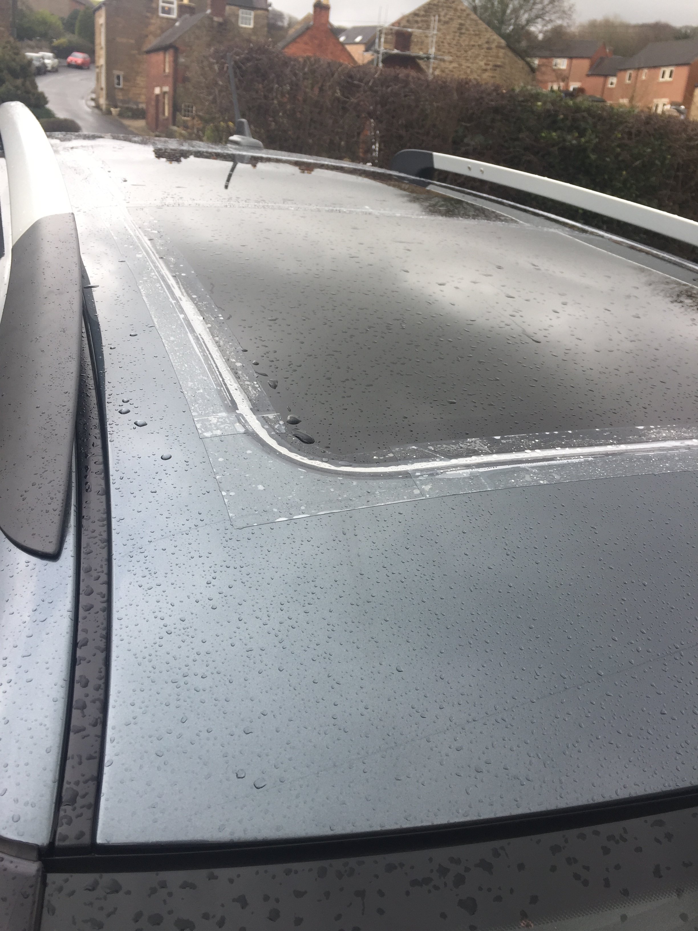

  • I have taken a different approach to a repair, which has shown to be somewhat effective under controlled conditions - cheap, and not a drop of Captain Tolleys in sight.    After some head scrat

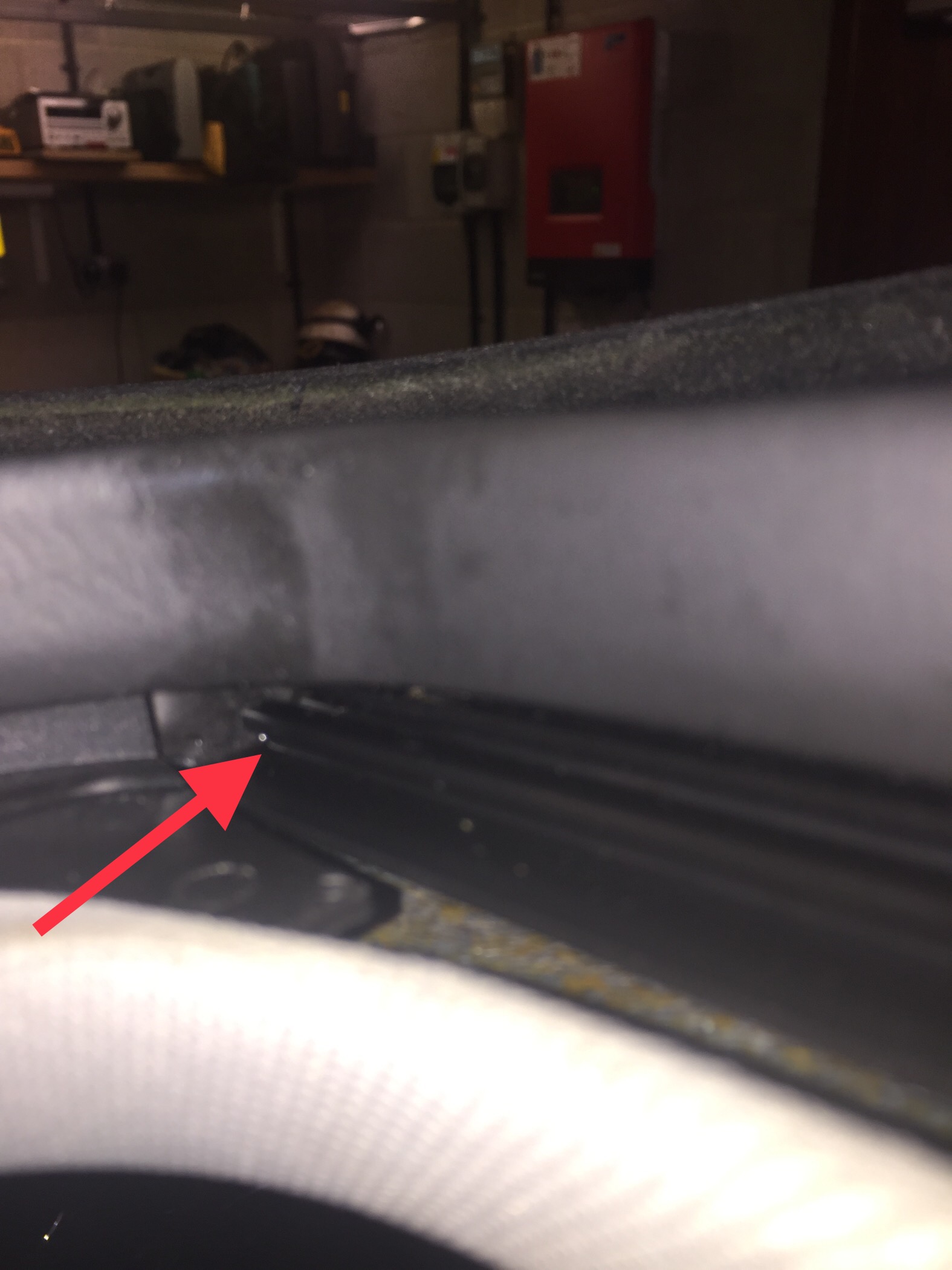

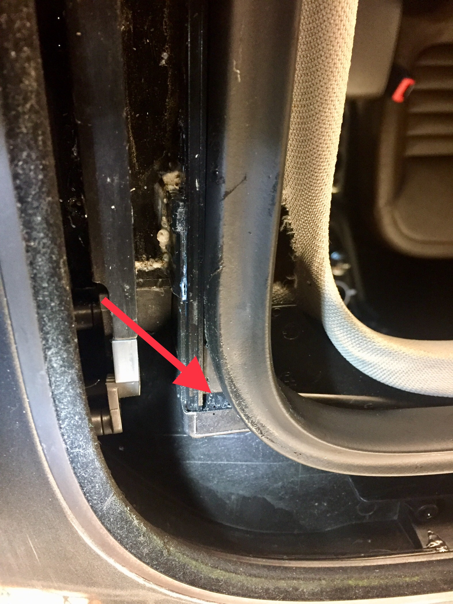

I have been suffering with a leak into my Yeti for a couple of years now. My local dealer wasted the first year ‘trying ‘ to fix it under warranty, which ultimately failed. Back in March I followed united232’s repair, after which the tray passes the static leak test ( drain bunged, water in the tray immersing the joints). However the car still leaks after prolonged continuous rain, albeit not as badly as pre repair. I have managed to trace the current leak path. A small proportion of the water getting past the outer sunroof seal is tracking along the underside of the glass, and dripping onto the raised surface at the front corner of the frame, adjacent to the internal sunroof seal. From here the water can easily pass through the join in the frame, and drip onto the roof liner. I’ve attached photos showing where the water drips, and where I could see water seeping through the frame.
I have attempted to seal this leak path with Tolleys, but I think the gaps are too wide. So I’ve used silicone mastic to form a cap over the corner of the frame. It doesn’t look very pretty, but so far it’s working. Fingers crossed!!
 I will report on the success in a couple of weeks, assuming monsoon season doesn’t suddenly finish.

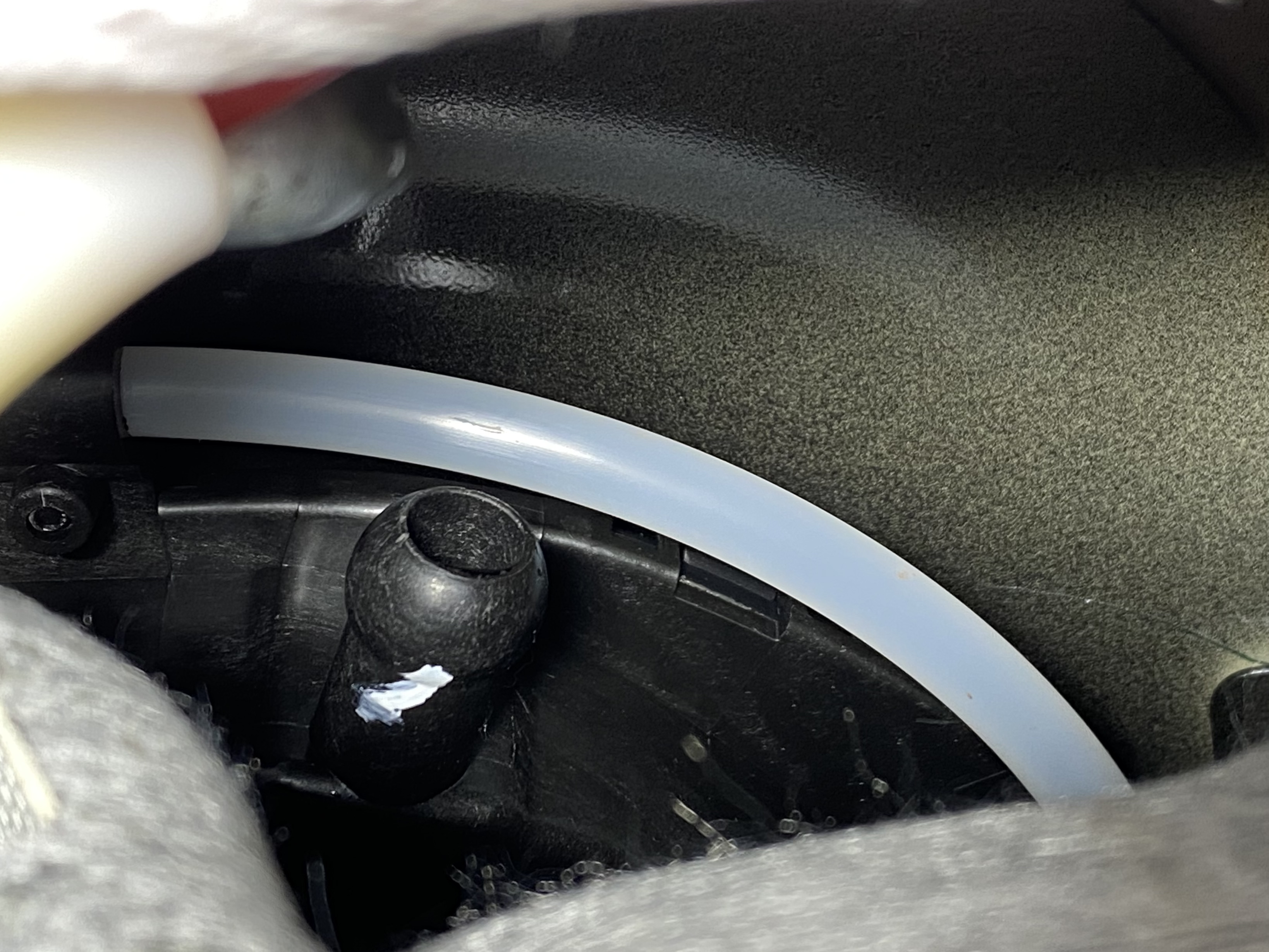

TL; DR: Another one with a leaky sunroof, 2016 Yeti L&K. Three questions at the end.
There's been a bit of a dribble coming in behind the off-side A pillar trim and leaving droplets on the carpet for a couple of months, prompting me to think "I must get around to fixing that sometime". Two nights ago we had rain of biblical proportions and I'd left the car in an unusual spot, nose pointing downhill. I can only guess that the deluge was too much for the front drain channels because there was an inch of standing water in the footwell.
I've pulled off the A pillar trim and gently prised back the roof lining far enough to pull off the drain hose, which wasn't as loose or visibly knackered as I'd have hoped. Still, I reckon it's the hose joint that was responsible for the dribbles up to now, and possible partial blockage that's responsible for the sudden influx. I roughly tested the hose by blowing into it, and the air went through at a rate I'd associate with a pipe of that diameter. Tried blowing in with my finger over the exit hold by the door jamb and it seems there's nowhere else for the air to go, which is good. Yeah, neither test is perfect, but it helps rule out total blockage or a hidden disconnect.
My plan is to refit the hose with some kind of glue or sealant, and see if I get another leak from the same area. If I don't, happy days. If I do then I'll take the whole roof lining out and leave it out until I positively identify the source and verify a fix.
Three questions to those that have been here before:
  1. What did you use to stick the hoses on?
  2. What's the name of the thing that looks like a cross between a pipe cleaner and a bottle brush in this post from 2013? Could be mightily useful in clearing out the four drain hoses to make sure they're operating at their maximum flow rate.
  3. What's the clear pipe that runs above the drain connection? I'm guessing it's a guide for some kind of cable and hoping it's not there to hold liquid, since it felt too loose for that purpose and I was able to pull it out of wherever it docks near the front of the sunroof. Stuffed it in again without issue and it feels as it did before, but I'd kinda like to know what it's for.

I tried fitting strips of Oraguard stone chip protection film around the full perimeter (and the joint between the glass panels), to seal the sunroof, and removed fuse 27. The film got full adhesion to the roof and glass, but after 2 or 3 days of rain, the water found its way through again. It must have been due to the thickness of the film, causing small gaps at the overlaps. But a single piece wrap would probably work better.
