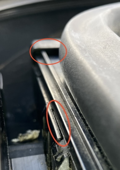

@Grantolatrim the ends of the inner tube so they do not interfere with the running channels of the roof.
Though it’s not shown in full in the second image I posted, if you look carefully, you can see a taper to the inner tube as it runs towards the corner you highlighted as Mech.
Also try to ensure the tube fits fully under the seal and over the seam of the metalwork. The adhesive appears compromised at the front of my roof so water can pass both sides of the seal. If it passes on the front side (closest to the windscreen, see image below) it could miss the inner tube if it isn’t inserted deep enough, and still end up running out of the two rectangular slots (you still have your headlining in so won’t be able to see these).

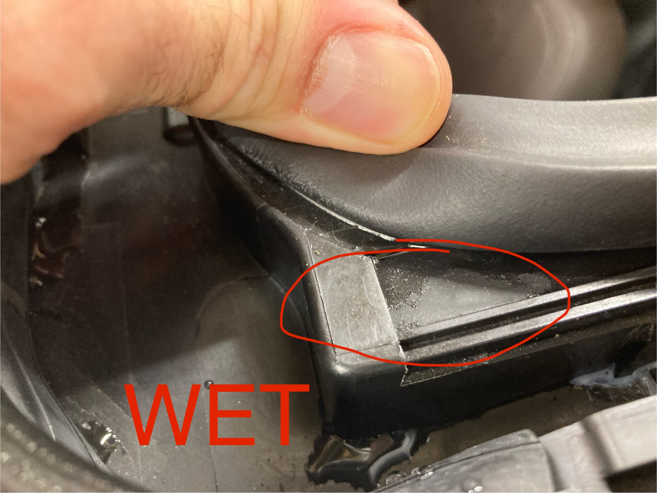

While I was in there poking the inner tube in with a cake knife (the extant seal does seal nicely to it - nice thinking!), I spotted something. Has anyone considered the possibility of the wind deflector forming a structure to channel water from the area where it should drip into the tray to the inner part of the assembly? I saw that the inner plastic at the corner of the assembly was wet (highlighted in the image). The only way I could see water getting there was via the wind deflector. .

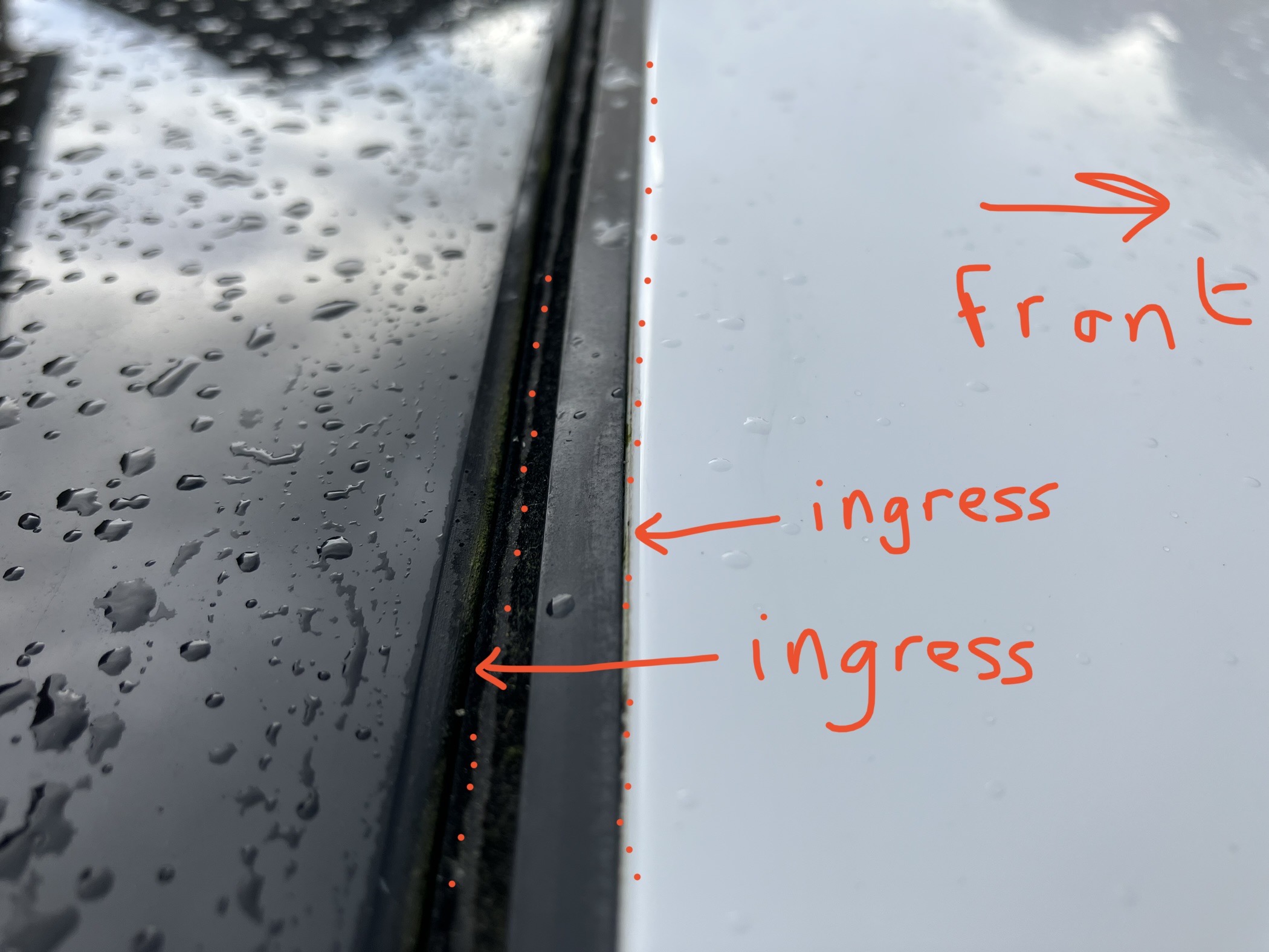

@Grantola I’m glad you remarked on this. This is the area I also think water is still coming in to mine. I can’t fathom how though as the water level would either: 1) need to be filled in the channels so high that it can overspill the break in the plastic. When I opened the sunroof last night during a pause in the rain, I found the whole area essentially empty. This suggests it is not filling up and is draining well.
2) water is somehow tracking sideways across the glass until it hits the inner main seal and then down the break in the plastic. I guess since I’ve seen water breach the main outer seal, this is how it’s still getting it. I just cannot understand why it designed this way unless it is to let the structure breathe/aerate etc. Either way, if your car is soaking in these conditions, the path could do with being eliminated, at least partially.
Even in extremely heavy rain yesterday, and whilst driving the car, only minor levels of ingress were observed. The amount of water removed from the car, like yours @Grantolasuggest either a slow accumulative effect that we only observe when the footwell squelches or it’s pouring in somewhere.
I’m beginning to favour the former though as I’ve driven the car in some pretty horrid conditions since I stripped the interior and water has not poured in. I guess a dribble here and a drop there, with nowhere to go except sit on the floor pan, eventually adds up to litres.
Weirdly, the website is randomly allowing and disallowing photo uploads. These are the areas I’m referring to as potential ingress points and corroborates what you are suggesting @Grantola
there’s no way the channels are filling that high that it’s over spilling so guess water is hitting the main inner seal shown to the right of the image where the glass sits and then runs down the path you are suggesting. Though it ’s a big gap at the top, I suspect it narrows somewhat as I previously mentioned, the ingress was slow.

1. I fitted the inner tube rubber seal as you suggested at the front (again, nice thinking)

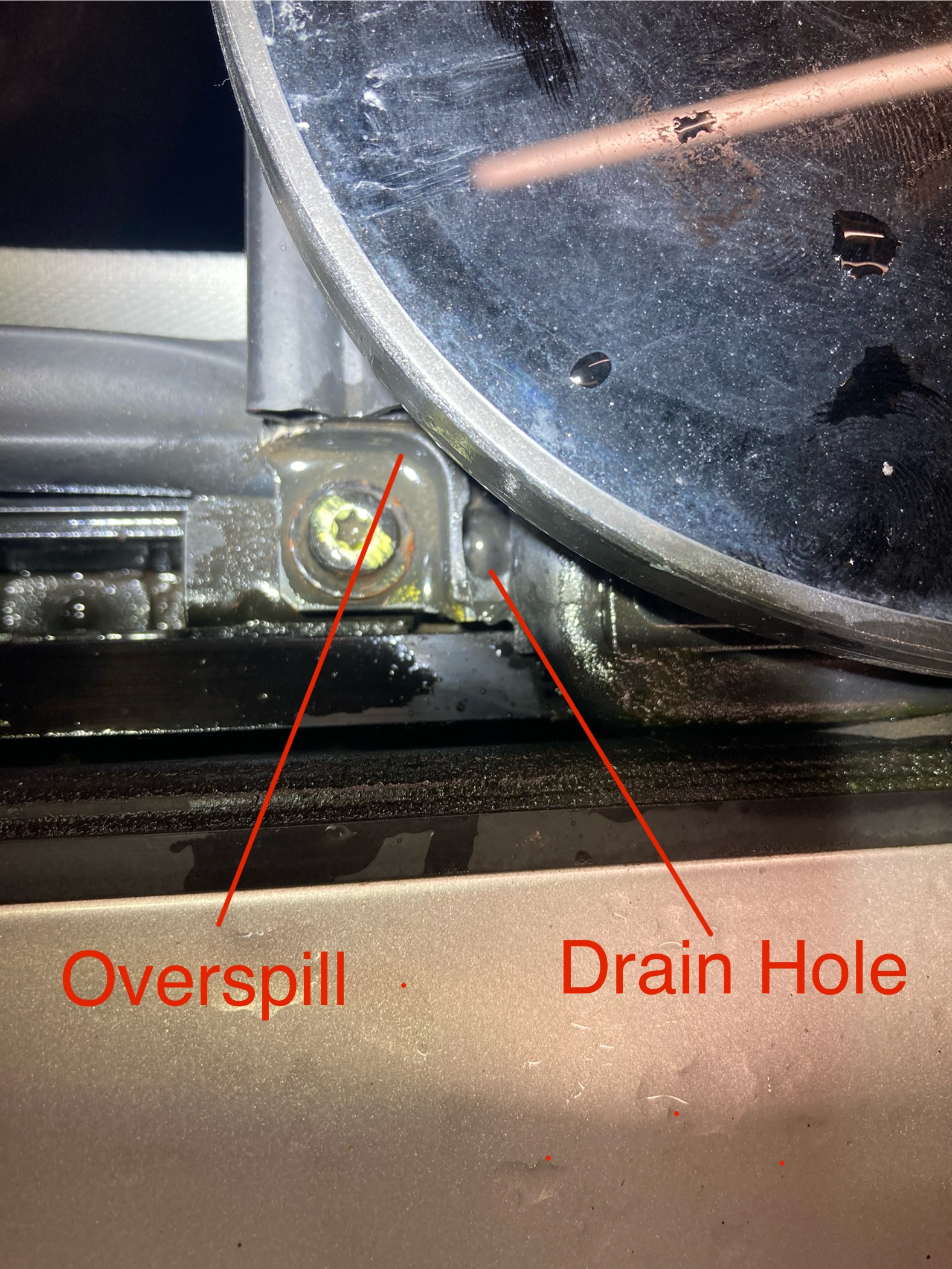

On inspection, there's a centre sealing joint between the front and rear glass panels of the sunroof with a drainage channel located under the seal. The channel then runs transversely roughly between the B-pillars and terminates in two holes which drain the water which drops between the two glass panels down into the aluminium end channels, obviously leading the water to the front and rear drainage hoses.
The NS Torx screw which retains the rear glass panel was obviously wet (the OS screw was dry) and I realised that the NS drain hole was blocked, the water from this channel had obviously been backing up and running over the screw. I stuck a bottle brush into the hole whereby residue plopped out into the drain channel. On further inspection, the hole was mostly occluded at the bottom from excess rubber from the manufacturing process and hence I guess much more liable to blocking. I inspected the OS and the hole was completely clear. Interesting.
I used a syringe to drop water onto the screw with the car on the level and I watched the water run from there, along the channel (the outside of the inner air seal) and guess where it went? Straight down the gap that you've been suggesting @Weti. That's potentially our ingress route. Other side was dry. Correlation?
I rammed the bottle brush into the hole to try to dislodge the excess rubber in the drain hole, only succeeded to open it up, but the rubber remains.
Soggy Yeti owners, I invite you to check your centre drainage holes for blockages!
