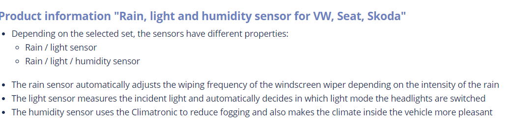

Where's the humidity level sensed? Don't think I've ever seen reference to a humidity sensor in these systems?
Not checked the Yeti but on the Octavia it's combined with the rain/light sensor on vehicles with climatronic.
The person in control of the cars interior is the humidity controller and they might be in the driving seat or a passenger one.
The will fiddle with controls for the heater, fan, climate / AC, windows and sunroof if there is one.
