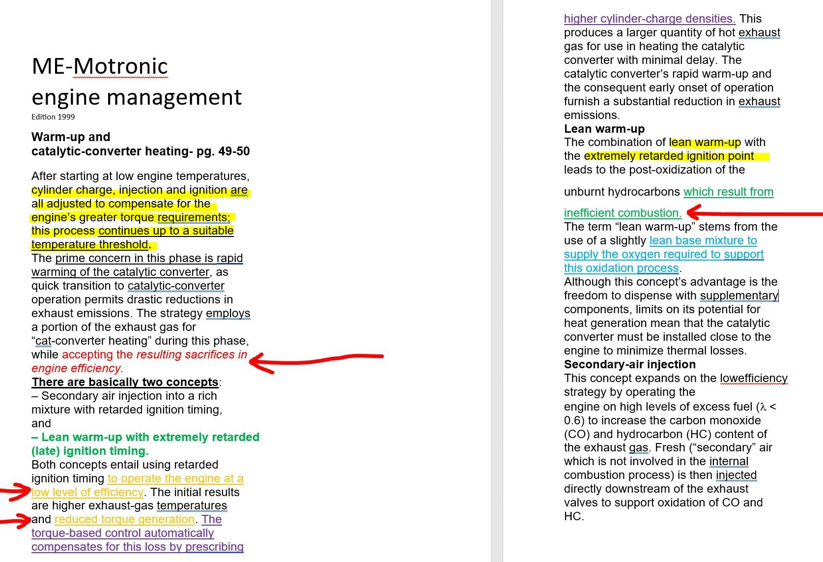

Hi,
here is the cause:
lean warm-up and extreme retard spark.
If VW will fix this then the engine and the catalyst will warm-up slower but the engine will work as it should. (no more kangaroo)
They will not fix this because it will result slight bigger CO2 emissions :)
