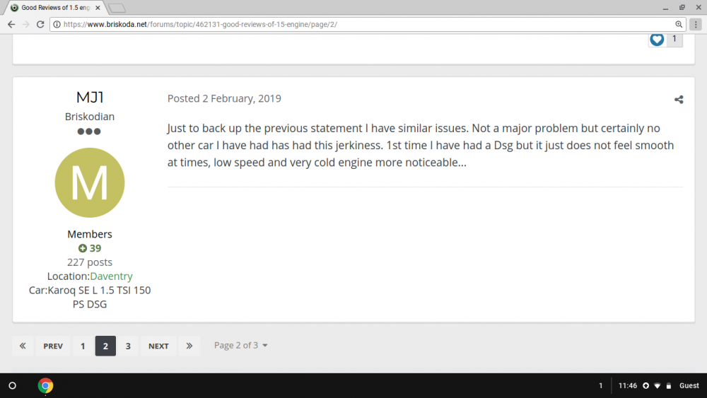

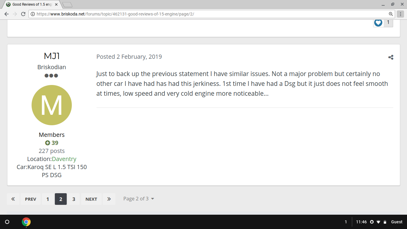

@MJ1
My memory is strong.  I remember my posts and yours and others.
Google or a search not required when you have a photographic memory.
Nice to have, I forget why I get up at times...
