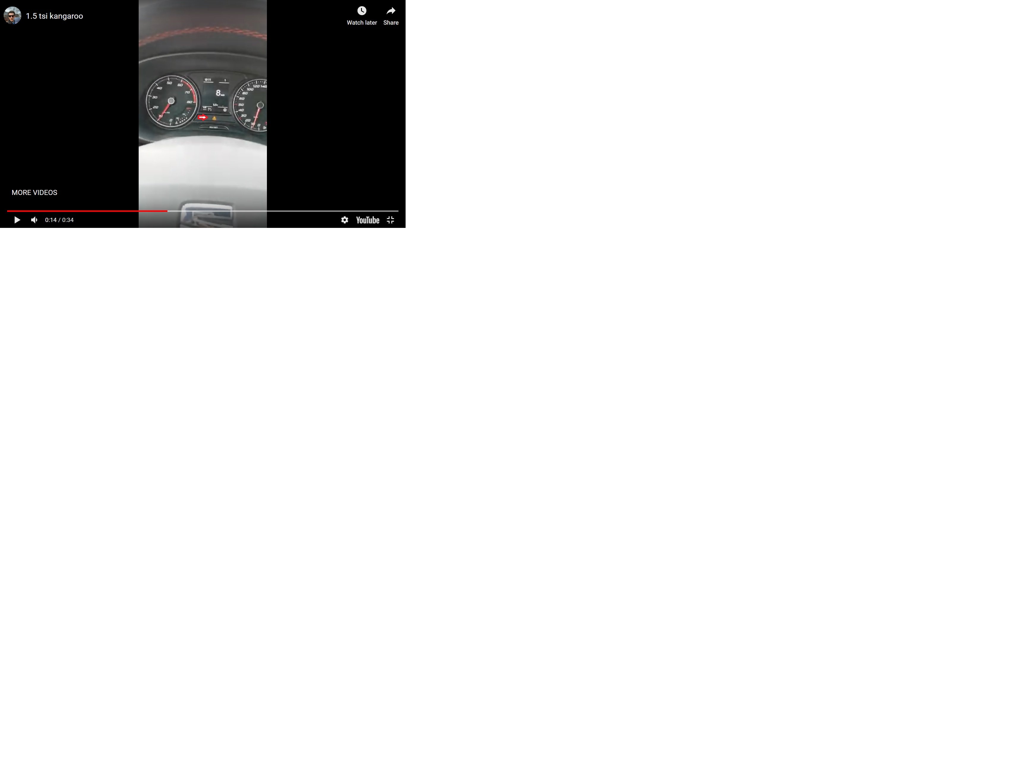

Hi, this is my Seat Leon 1.5TSI 110kw after latest fix from november. Doesn't matter if engine is cold or warm... I hate this engine!
Exactly the same.
What is causing the warning light to come on as I can't make out the symbol as seen in the video?
Its missing windshield liquid, nothing important :)
Many thanks Apprentice, I now know what to ask the main dealer to install, on the first patch they had not a clue!
