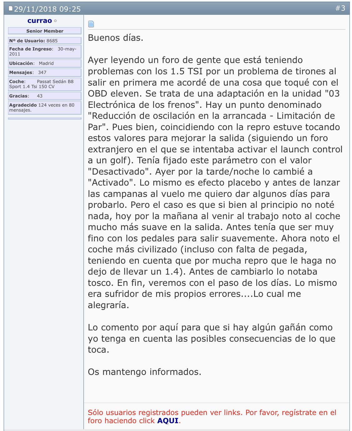

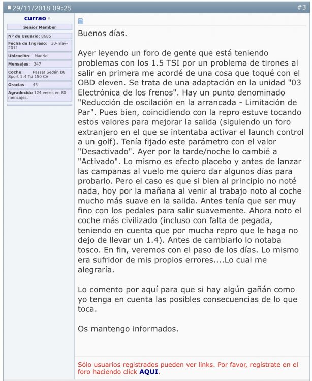

Screen from one forum.
google translate:
Yesterday I was reading a forum of people who are having problems with the 1.5 TSI because of a jerk problem when I went out at first. I remembered something that I had to do with the OBD eleven. It is an adaptation in the unit "03 Brake electronics". There is a point called "Reduction of Oscillation in the Start - Limitation of Torque". Well, coinciding with the repro I was touching these values to improve the output (following a foreign forum in which they tried to activate the launch control to a golf). I had set this parameter with the value "Off". Yesterday afternoon / night I changed it to "Activated". The same is a placebo effect and before launching the bells on the fly I want to give a few days to try it out. But the fact is that although at the beginning I did not notice anything, today in the morning when coming to work I notice the car much smoother in the exit. Before I had to be very fine with the pedals to come out smoothly. Now I notice the most civilized car (even with a lack of punching, taking into account that no matter how many times I reproduced it, I still wear a 1.4). Before changing it I noticed it rough. In short, we will see with the passage of the days. The same was the sufferer of my own mistakes .... Which would make me happy.
I mention it here so that if there is a farm like me, consider the possible consequences of what it touches.
I keep you informed.
maybe somebady have obd11 or odis for test this method ?

But that Spanish Guy has a 1.4tsi Passat. Is it even relevant? 1.4tsi engines have no reported problems.
And I'm sure VAG engineers aren't that thick as to miss a simple adaption setting for well over a year.
Edited by xman
I saw a guy from Russia on the Internet. he has a new 1.4tsi with 150hp and he has the same problem like ours :(
I think Skoffski is right, too risky to intervene in the car yourself.
We will continue to wait ...:(((
