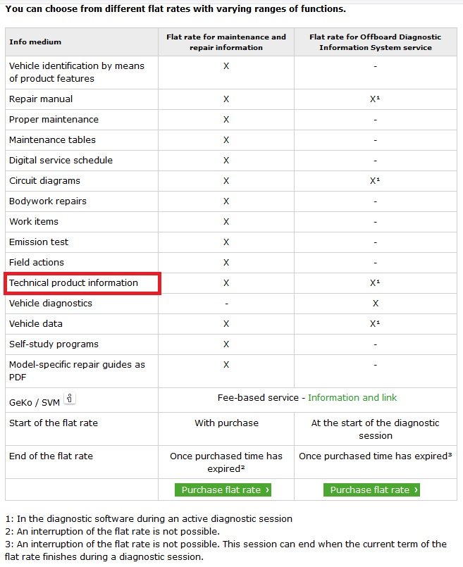

I understand photo from Xtra2 is not the best one, still readable though, so if you look at it, you can not have any objection against it in the way that TPI 2050744/6 from 12.12.2018 does not exists ... :cool:
You can check here for 8,50€ / 1 hour :cool: as already Wino proposed, TPI is available for all, who spends a bit money and have VIN of any VAG car
https://erwin.skoda-auto.cz/erwin/showProductCompare.do
https://erwin.skoda-auto.cz/erwin/showVehicleSearch.do
and you can confront your friendly dealer then with the official TPI you got for your money :biggrin:

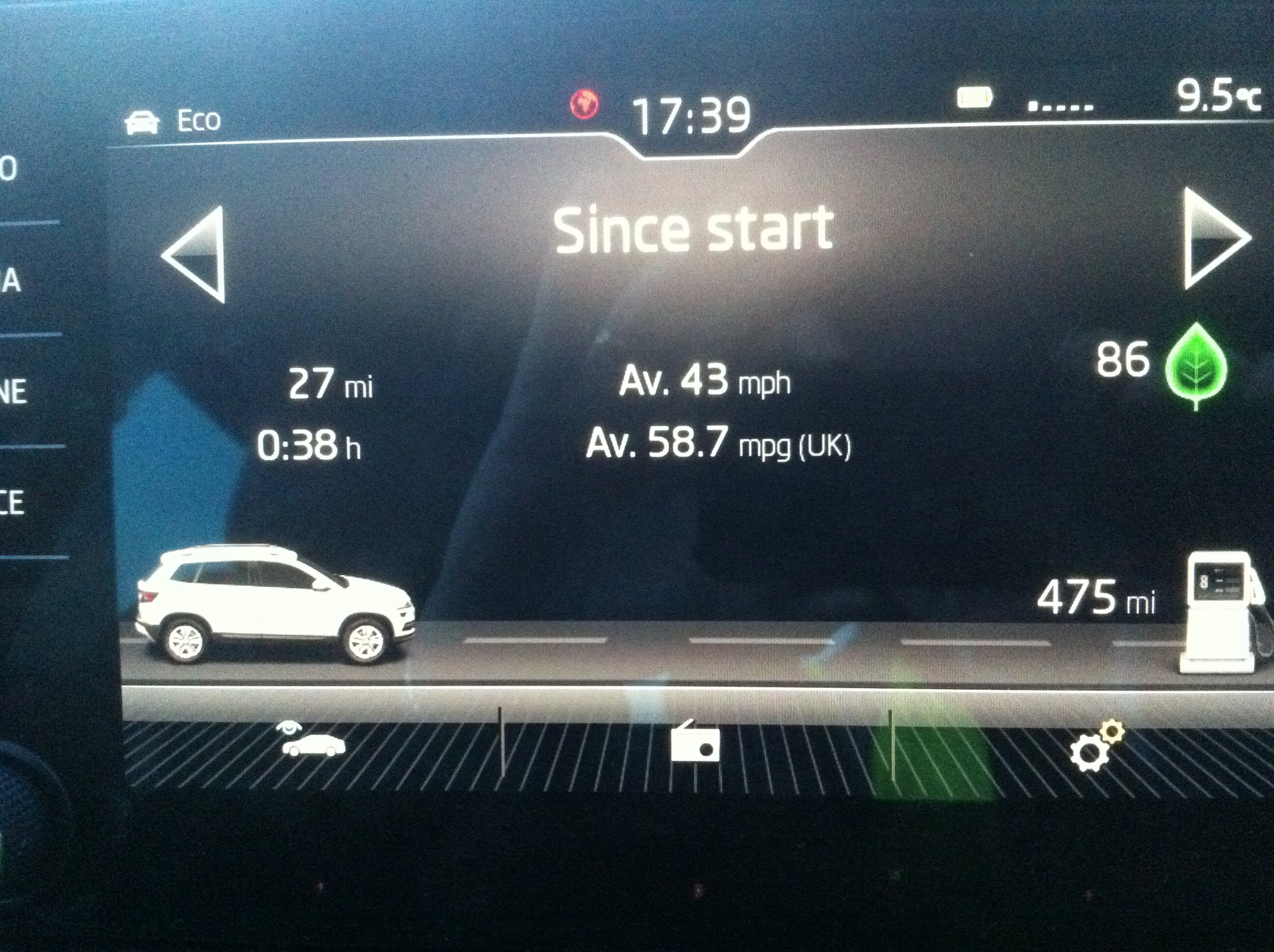

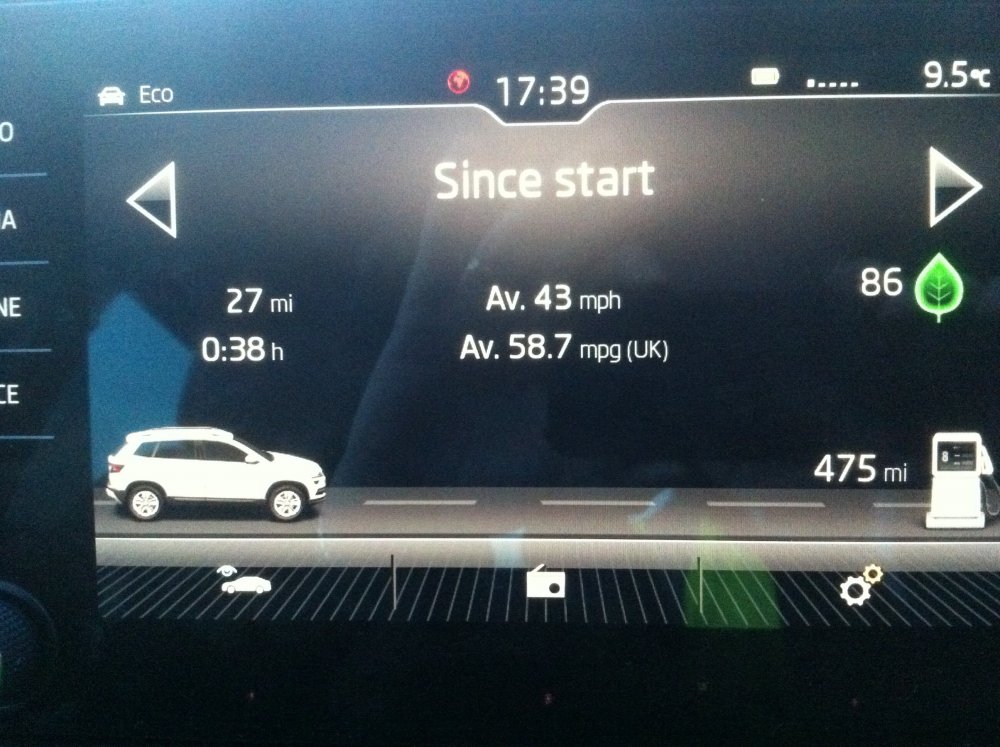

Took the wife's Karoq out today in the beautiful February sunshine car behaved faultlessly for a change. Reminded me what a comfortable, quiet and economic judging by the photo below.
