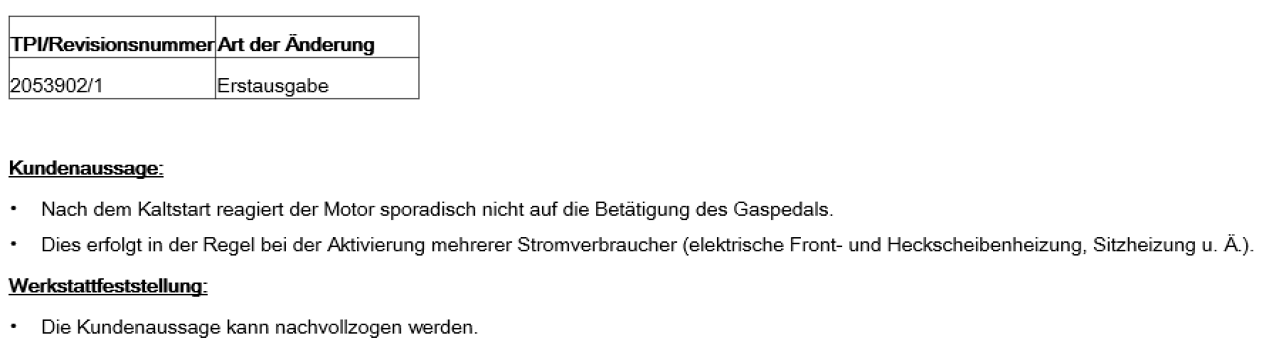

Well, just read this topic, mentioned here many times ...
Last leaked Skoda internal Technical Product Information from Skoda has number 2050744/6, just ask your dealer, if any news visible at their ELSA PRO information system for this TPI, like TPI 2050744/7 or later, exists :cool:
On 03/01/2019 at 16:47, Xtra2 said:
VW has own TPI 2048749 too :biggrin:
https://www.briskoda.net/forums/topic/446820-15-sel-first-gear-issue/?do=findComment&comment=5193191
