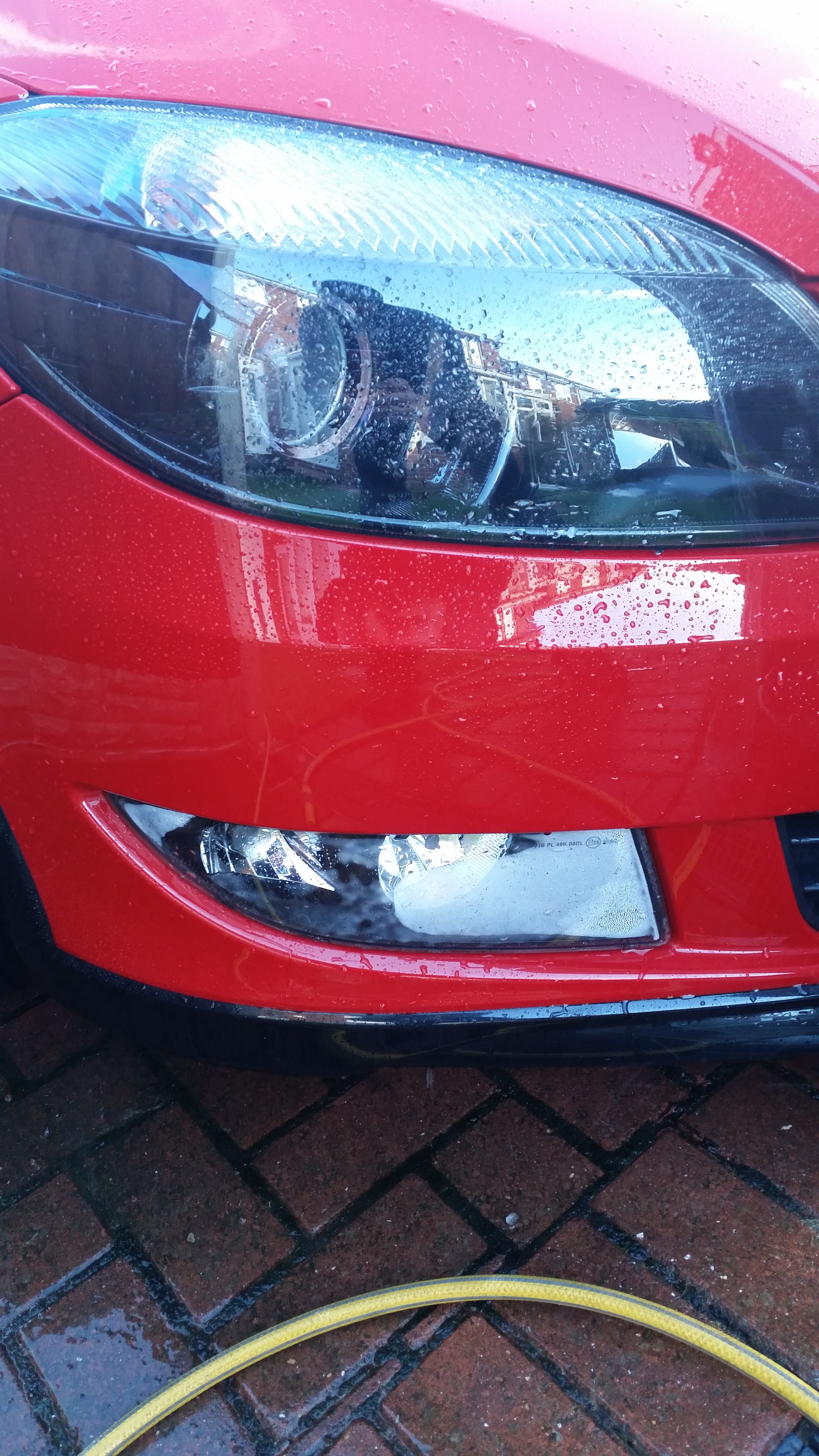

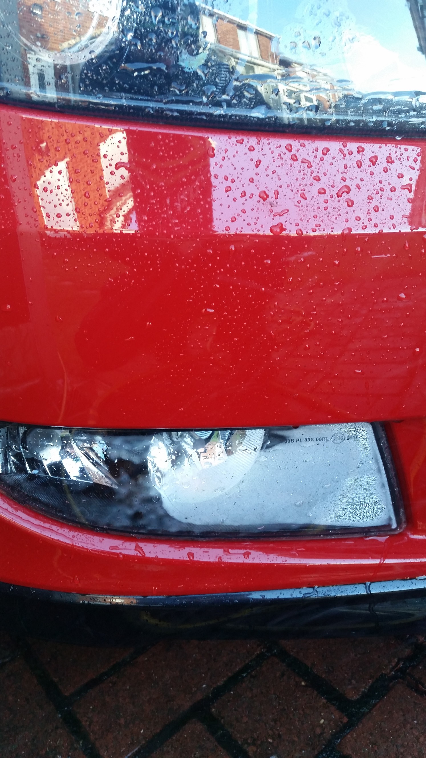

hi , just bought this car and it looks great in red with the black roof but one thing that annoys me it has condensation in the front foglights , ive also seen a few monte carlo driving about with the same fault , how do i stop this as its nearly running condensation now , its doing my nut in

dont know im sure , my wife got back in the car tonight and the drivers side fog light is that wet its running down the inner lens now  , any idea how to take them out?

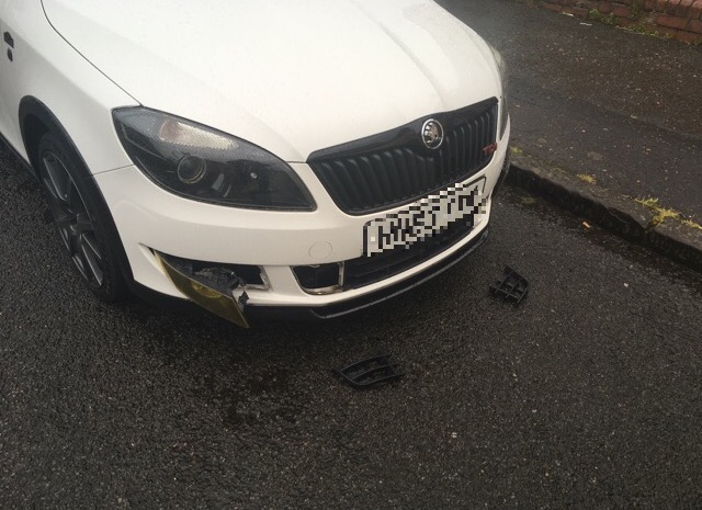

any idea how to take them out to dry them , im going to have a look next week and seal up anywhere i suspect a fault ,lol
Ends of the grill pulls off then you put your hand in and push a clip and they come out
thats great thanks :)
