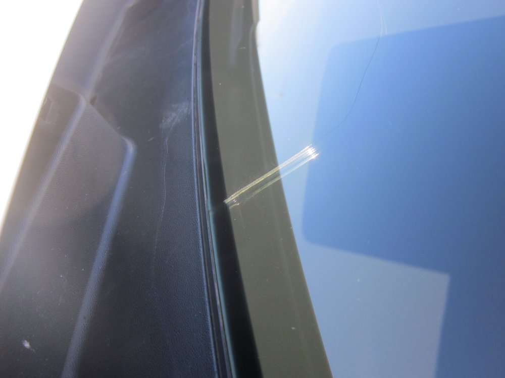

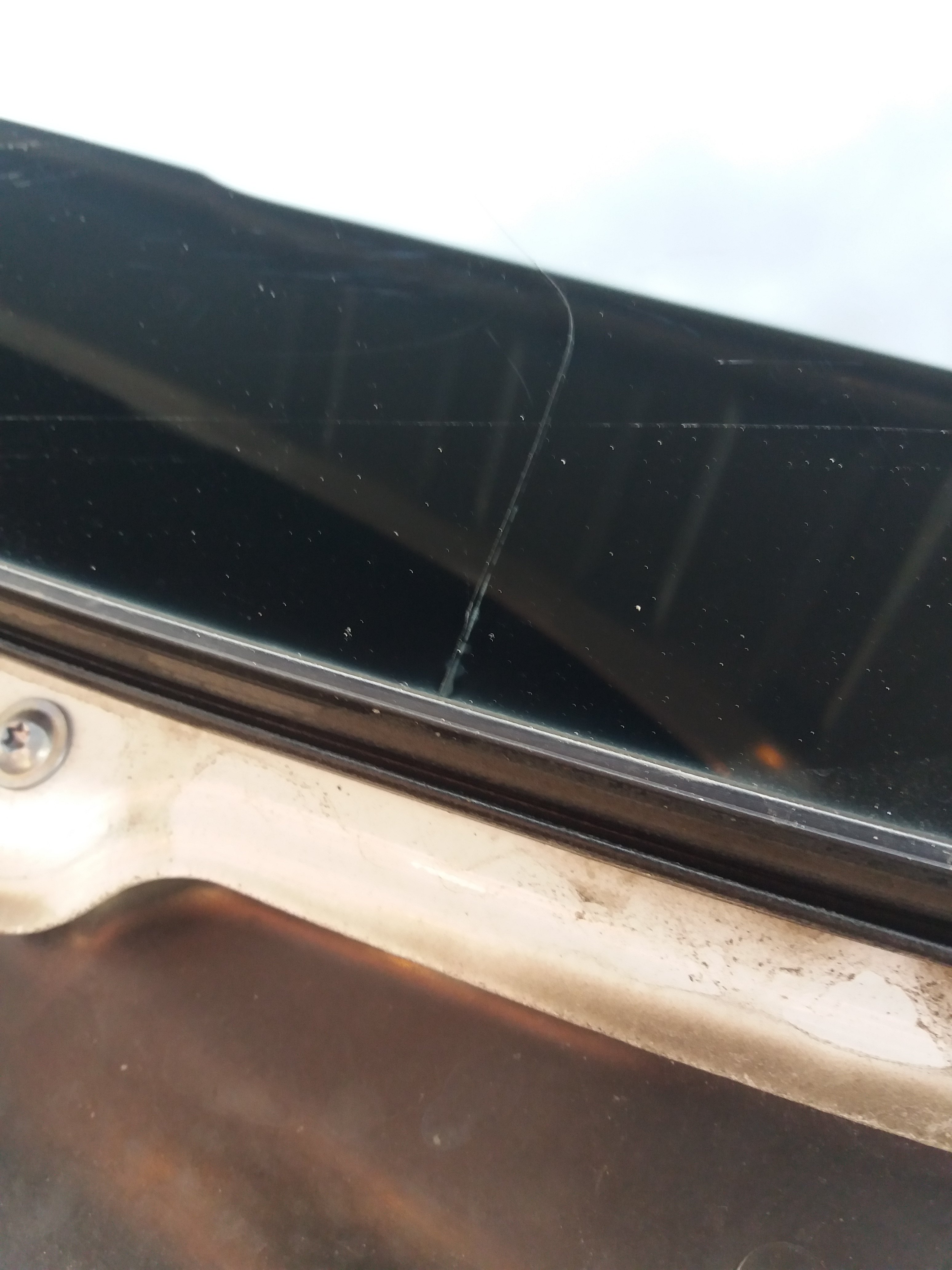

Noticed a crack creeping up the windscreen this morning. Strangely is appears to emanate from under the plastic scuttle tray. Either that or it started further up and headed towards the scuttle tray. I've run my finger along it and there is a small chip further up, although strangely its tiny and below the line of the bonnet.

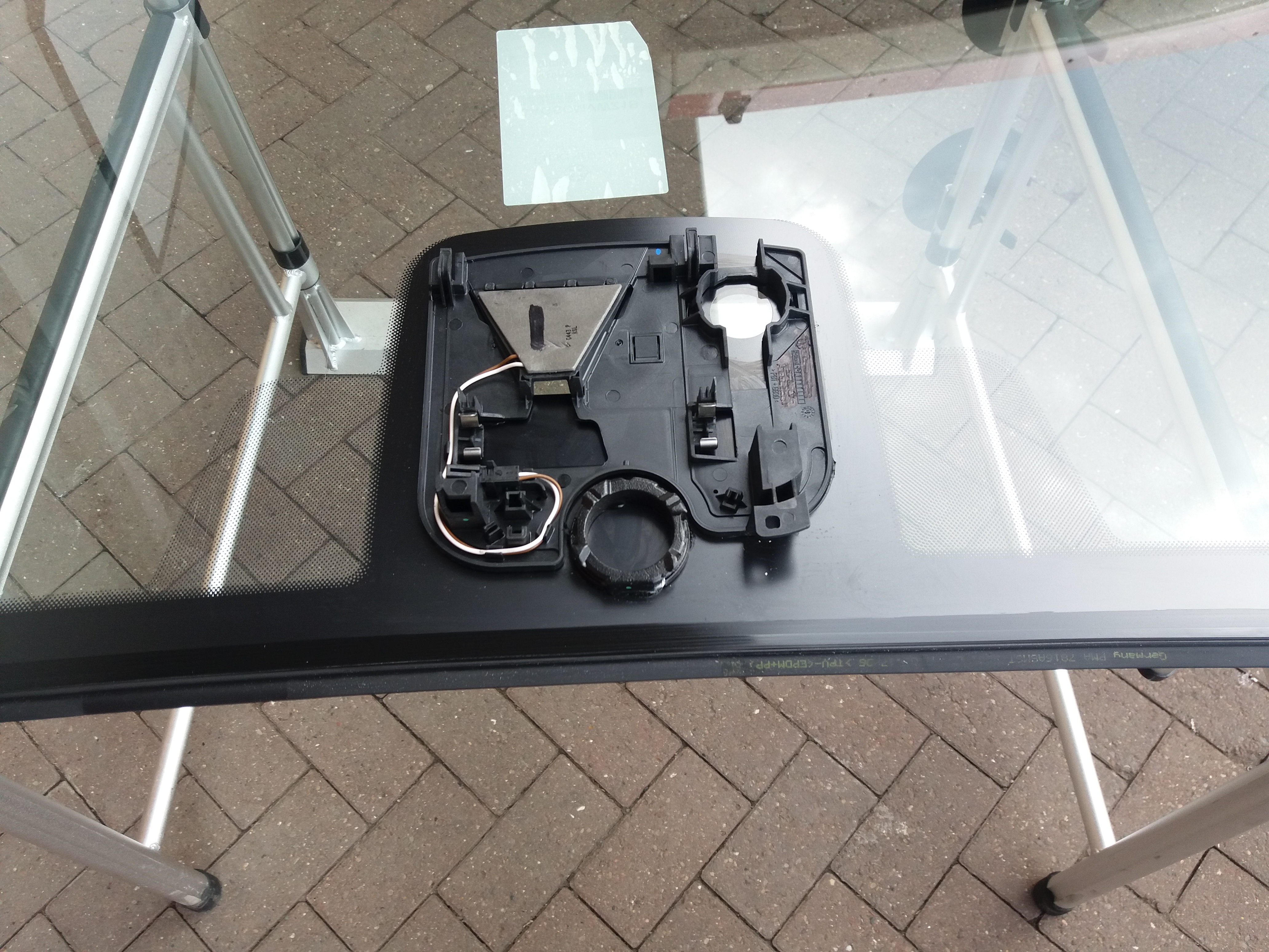

Or so I thought. Just had a phone call from Autoglass asking if the car has a windscreen mounted camera. Unfortunately it does for the lane assist (a feature we don't use).
As a result this camera needs re-calibrating after the new windscreen is fitted. Low and behold this can't be done by the mobile fitter so the car has to go to one of Autoglass's depots with the right equipment, the nearest of which is in Leeds, 40+ miles away!

Looking at my original picture above, the screen is starting to go milky along the edge, is this a sign of delamination? Blimey, my 2008 Octavia suffered this!

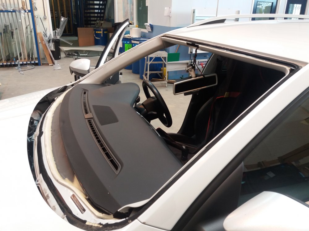

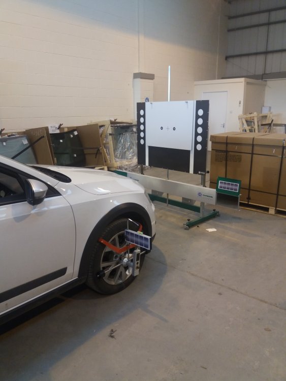

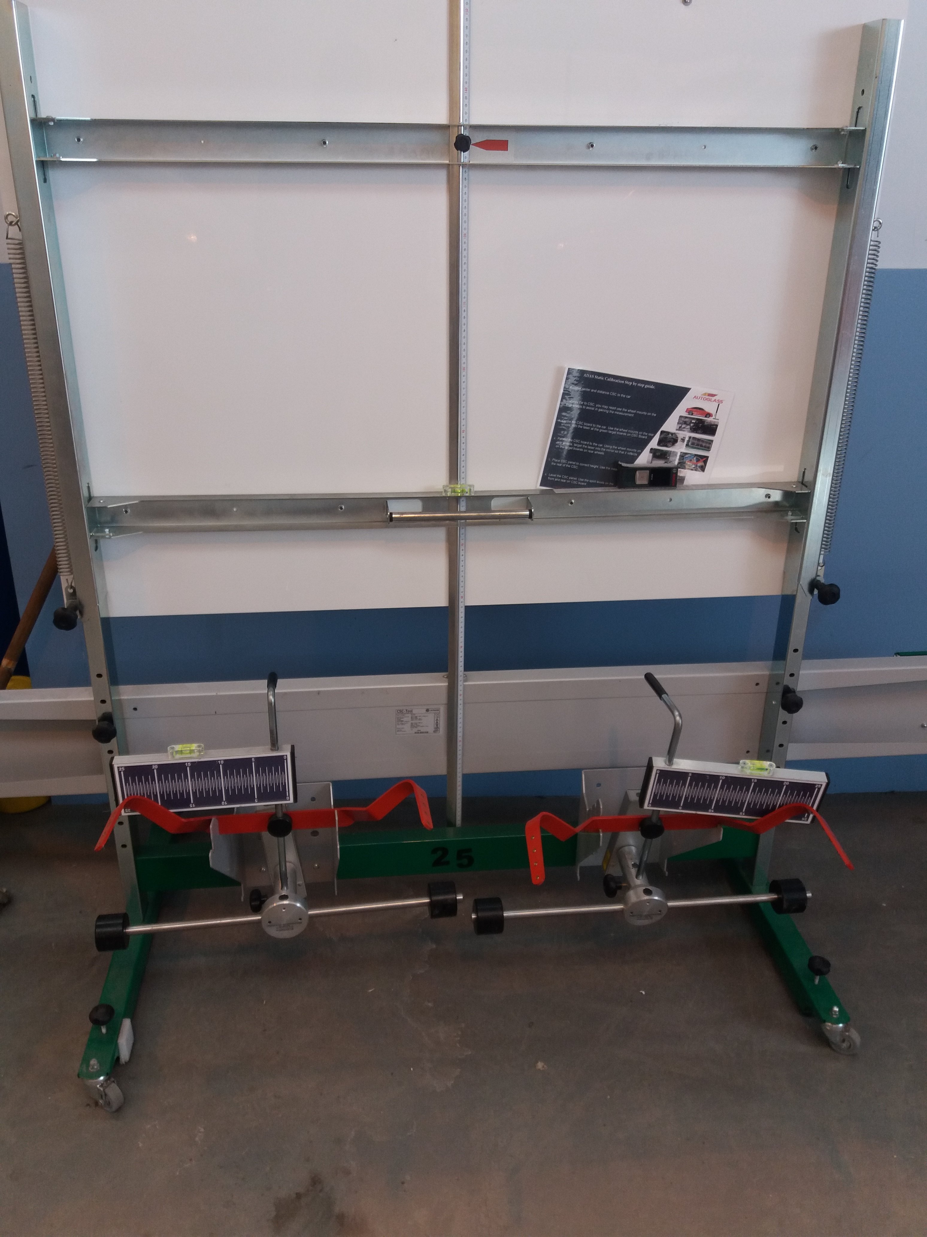

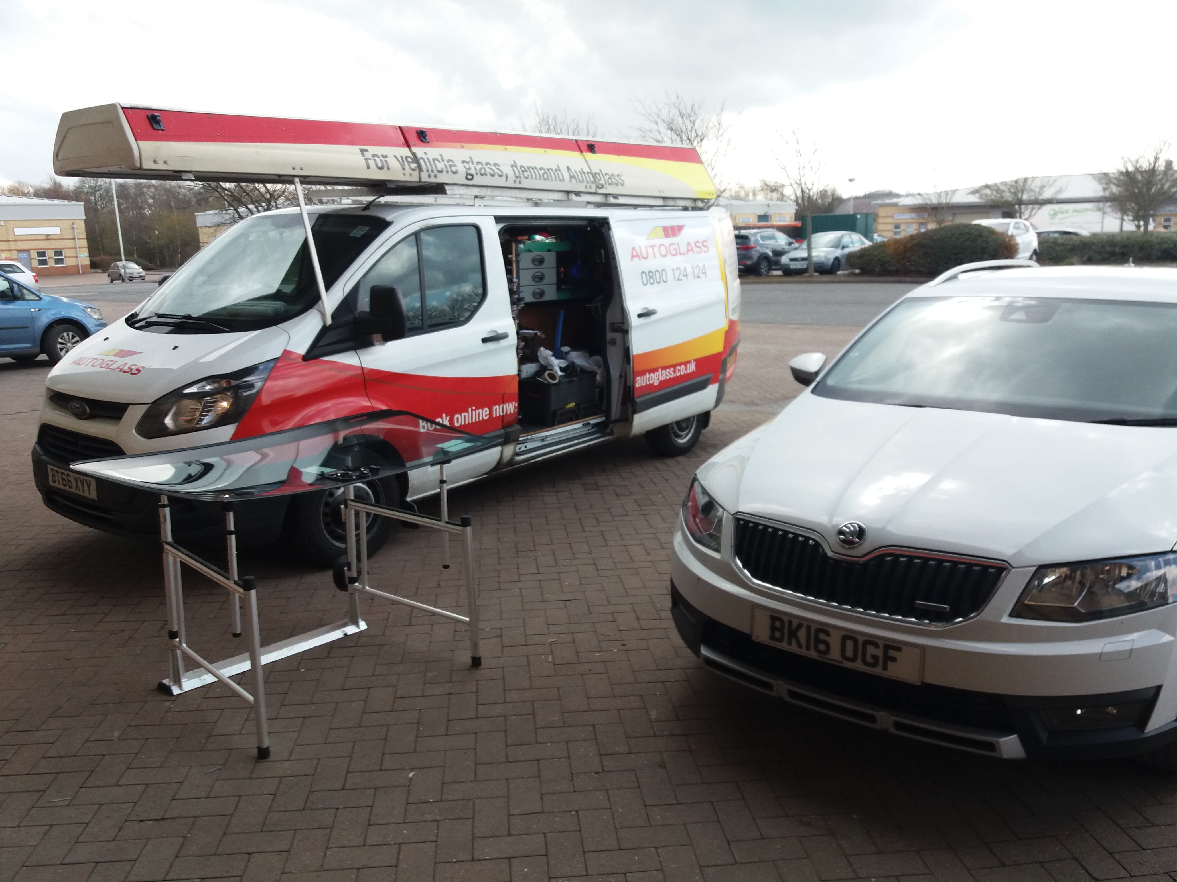

But the common sense in me, and the desire to keep the cost of a replacement screen sensible (in all of our interests) I made some of my own arrangements. I live in York but commute daily to Durham for work. There is an Autoglass depot in Darlington so I took the car up to work on Thursday (its my wife's so left her my car to use), left early and diverted through Darlington on my way home for a 1pm appointment.
The job was quoted as 90 mins, 60 mins to replace the screen and recalibrate the camera, and 30 mins to wait for the glue to cure.

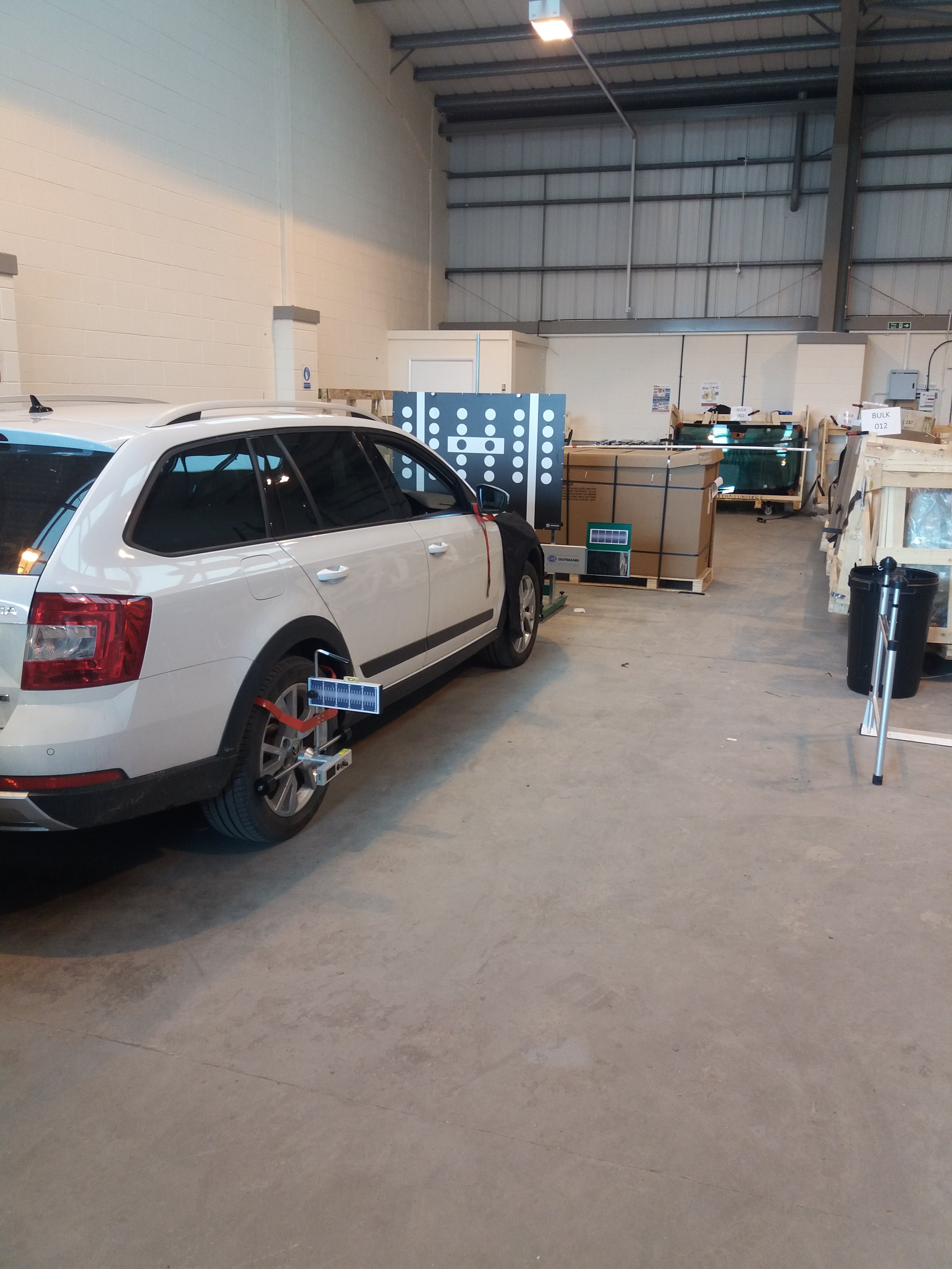

Got there at bang-on for 1pm, the guy was waiting for me. Seems the unit on the trading estate is simply a warehouse holding loads of screens, and the calibration equipment. The guy was still working out of his van.
The replacement of the screen was quick and painless, no waiting room so I hung around and chatted to him as he worked. Once the screen was in the calibration began. Unfortunately for whatever reason it wouldn't calibrate. The guy said the screen was likely faulty (there are lots of electrical components and wires attached to the screen itself)...
He said I would have to have another screen fitted at a later date. Great.
After 3 hours, freezing cold and ready to get home I agreed and left. Strangely the Lane Assist feature worked just fine, no faults or error messages, making me question if it even needed recalibrating.
A few miles down the road I noticed the rear view mirror was vibrating so much I couldn't use it, holding onto it the thing was very loose. It is clearly in the 'socket' but the socket on the screen can't be tight enough to properly hold the 'ball' of the mirror.
I then noticed that the ticket holder (a nice little feature I use quite often) was miles off touching the screen, so now totally useless.
At home the faults meant I took a closer look from outside the car. The visible VIN in the bottom corner of the windscreen is no longer visible. Either the window is in the wrong place of the screen isn't fitted properly.
I can fit my little finger in the gap between the glass and the A-pillar on the drivers side, but can barely get my finger nail in the gap on the other side!
I can see where the glue has squeezed out from behind the glass in places making it look really unsightly. Splodges of glue on the roof and in places on the A-pillar.

To top it off the guy said it was highly likely the damage was a genuine warranty claim as there was no evidence of an external force (chip etc.) causing the crack and that it originated from below the scuttle tray, so likely a stress crack.
The guy thought that the DRL's were interfering with the lasers and used a special cover to hide the lights (the ignition / engine needed to be on for the calibration)...
