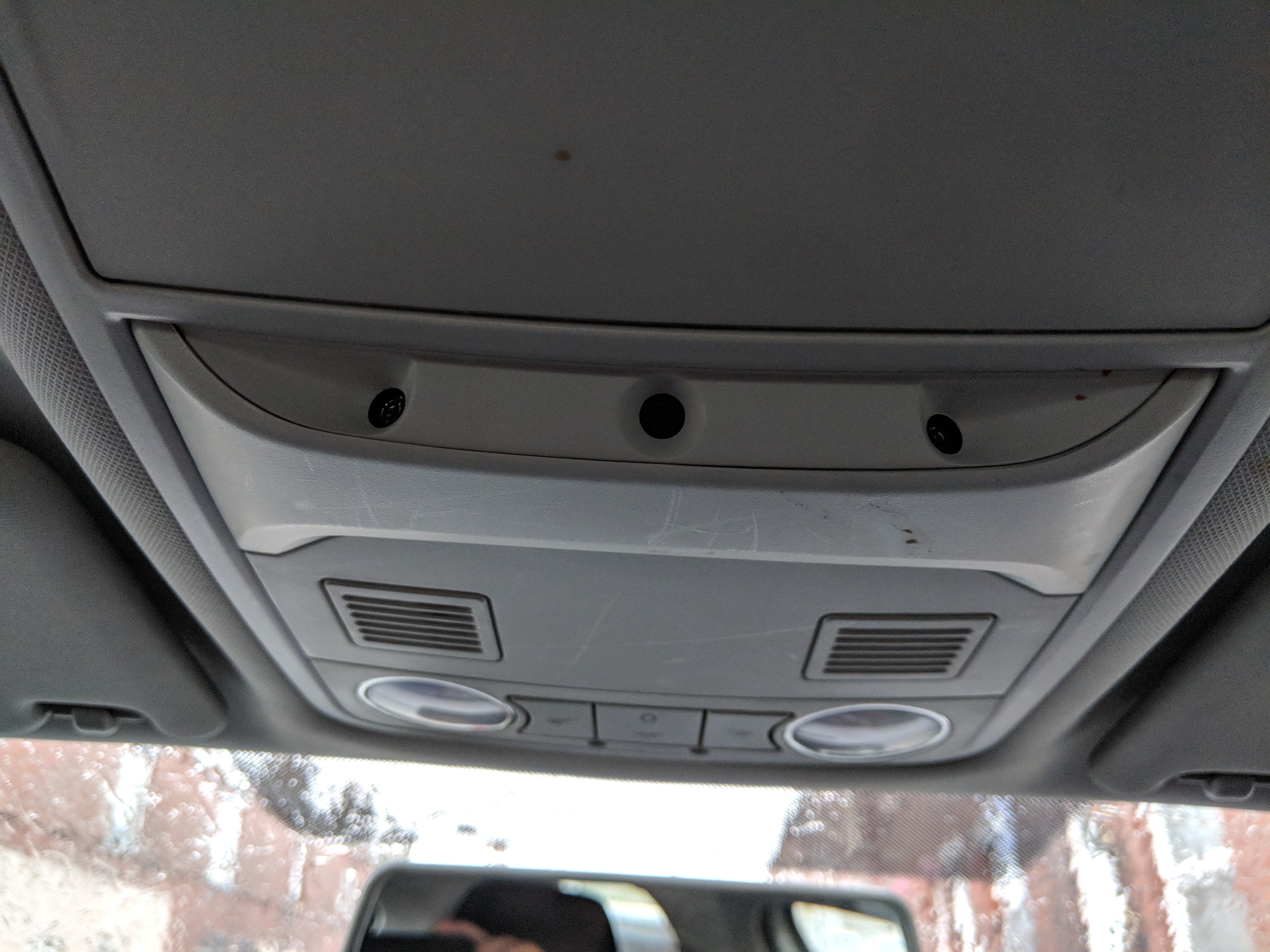

Have you got sensors up on the roof part of the sunglasses box? switch on drivers b panel ? That's what my 2015 vrs has and that has the factory alarm
Are these what you mean?
