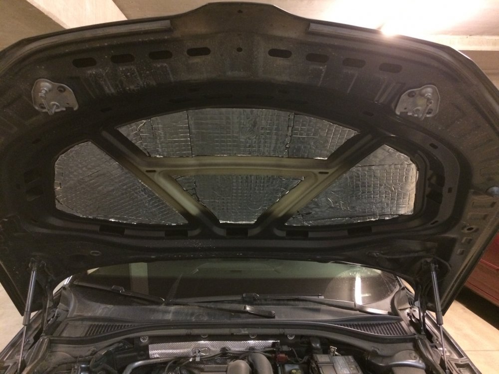

Interesting is the hood. Looking at my cars hood it looks there is already A LOT of sound deadening material under the hood. I actually don't hear engine much. At speeds like 180kmh/200kmh (Just came from Germany) the biggest issue was road noise and the wind noise (coming from windows, it felt like). Engine was pretty quiet. Could be MY18 or am I just not annoyed by engine as much (190HP diesel)?
Any how. I will start with front/rear wheel arches I guess, Then move to doors and perhaps stick to that (we'll see how much road noise is gone). The other stuff don't bother me much, like water noise on rainy day or wind noise at current levels. Mostly is the road. I do have quiet Hankook tyres (68db rating i think) but I still hear much. I just worry damaging something in process and the warranty could be void at these big procedures ( 6 years here )?

Superb's hood actualy has zero sound deadening material. The engines itself are so quiet.
Doing hood is not so much about the engine noise it' s more about the road noise. Windshield lets trough a lot of low level noise and there is a lot of that near under the hood. Hood takes about 0,4m2 of 3mm butyl mastics sheets.

I see. I'm waiting for new hood because some one didn't like my Superb so he jumped on it and bend the hood. So that will come little later. Um so what exactly is this 4cm thick material on the hood? Is that like firewall? I was sure its sound deadening material but now I'm really wondering what else it could be :D. The windows when I was ordering my car they didn't tell me there is option to get better acoustic windows. I'm kind of mad about that. I ordered my car on May 2017 and at time of ordering they didn't mention new option for acoustic windows. So I have normal windows =(. That probably limits amount of sound insulation I can do, because if I do all the things you did I will probably still get a lot of noise from Windows right? I actually already feel most wind noise comes through Windows =(.

4cm sound isolation on the hood? I don't recall anything like that when I disasembeled mine. There was only 3-4mm cover that is intended for heat and high level noise (and for estetic purposes) but no vibration deadening materials.
When we go into car sound deadening theory, then first and most important thing is to eliminate the vibrations. Car metal panels are like a big speaker membranes that create noise when vibrating. To remove the vibrations we need to add mass (most effective when mass is on the center of the panel). The effect is same as putting a finger on a speaker membrane when the music is playing. The rule is that when you cover 12% of the metal panel center, you loose about 40% of the vibrations. So from the vibrations point of view you would not need to cover more than 65% of the metal panel but as vibration deadening sheets also block low level noise, the panels are covered fully.

I took the hood cover off and made a picture for you. Nothing beautiful but functional. Used 3mm Silent Coat butyl mastics sheets.
As you see, its very simple and straightforward thing to do.
And you are right, the butyl mastics sheets are self adhesive. No special preporation or heating needed. Surface must be just dry and clean. I recommend to use some roller though. Like this: https://www.deadening.co.uk/products/silent-coat-deadening-roller. Without roller you get air pockets on uneven surfaces. I have made such mistake in the past.

I see, looks really nice! And the acoustics thing sounds really logic. This is the way studios also do walls so the sound doesn't broadcast from the walls. In car it makes even more sense since panels are very thin
I need to order some asap :D. I'm just not sure about finances, some things are coming up and reserves are running out so need to wait next paycheck to see how stuff work out =). Not sure I could start some cause then it will get into my blood and it will annoy me if I don't buy more / all :D. You did rear doors too right?
