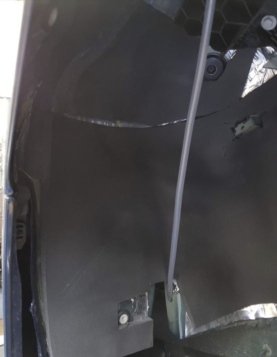

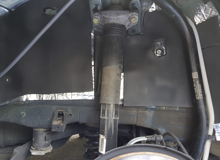

Wheel well noise, I'm told is a significant contributor overall so with this in mind I decided to try out the rears first.   Having recently been camping and totally filling the boot space to the roof it showed that noise reduction could be had and would make a difference.

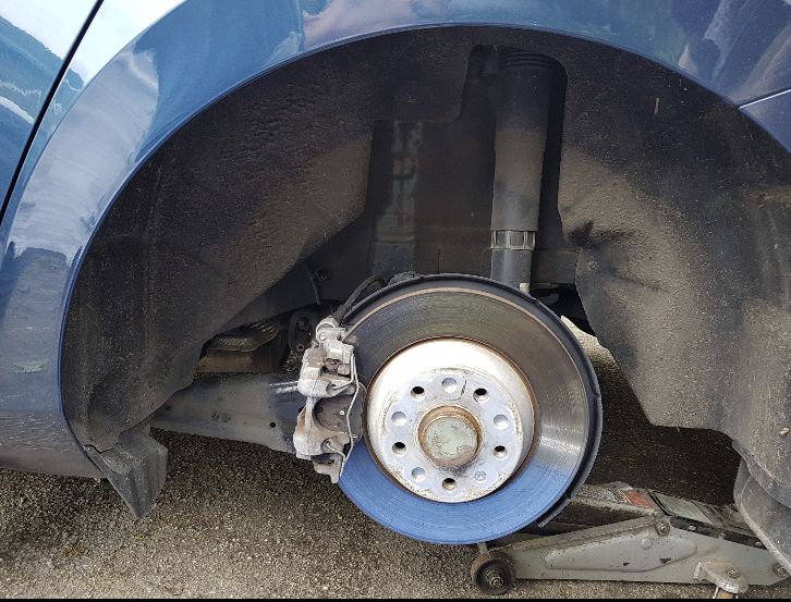

Jacked the car up using an 'alternative method'.  The handbook and docs recommend jacking up on the weld jack point which made me uneasy about stability, folding, etc.    The alternative was to jack on the under arm with suitable wood support to distribute.  I then used the cars scissor jack on the jack weld point to act as a safety support rather than an axle stand.    This meant the vehicle height was only minimally increased when raising to get the wheel off.   Someone please point out if this is a bad approach.
So, with the vehicle up the next step was to remove the liner cover.   Its fastened with a variety of screws distributed on the left and right, back and three around the arch.   The flap on the bottom front left of the image is integral to the cover so remove the screws including the one underneath but not the flat head ones.   If the liner doesn't come out easily, check that all the screws around the arch are out - worth brushing off the dirt first to inspect.   Once removed, give it a good clean.
One thing I noticed is the amount of freespace from the liner to the bodywork and its flexible construction which gave some options.

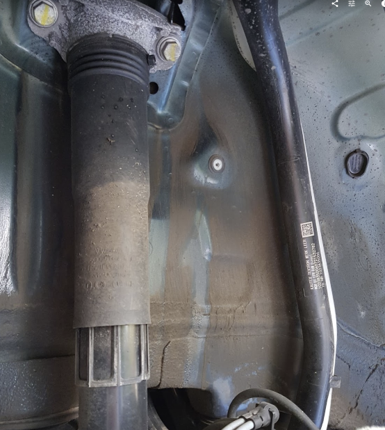

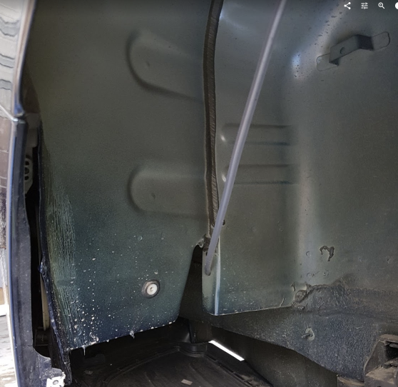

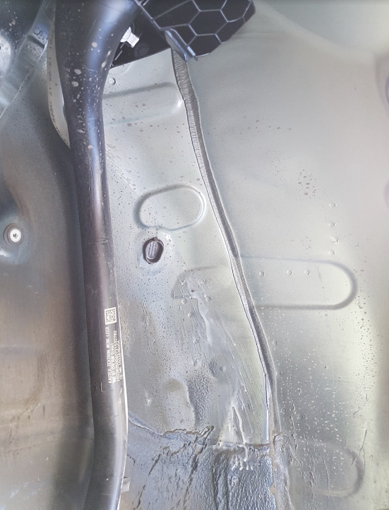

Here is the rear drivers side showing the back and the tube is the fuel spill drain (I presume?)
The metal was brushed then wiped with a rag and technical alcohol to clean the surface.   There's some rustproof coatings on the bottom edge of mine where I didnt put any SilentCoat as it didnt seem to adhere

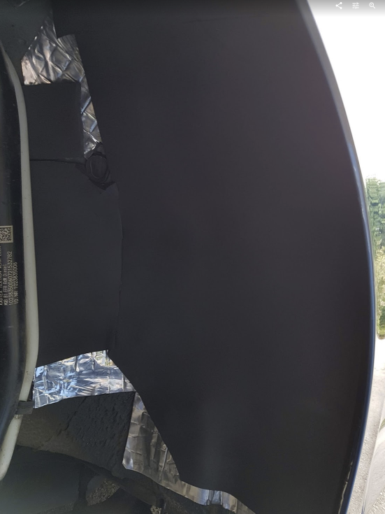

I covered the well with Silent Coat, as much as reasonable possible without addressing every spare space and avoiding where the shock is and obviously the fuel pipe on the drivers side.    We then tried a few things and reasoned that it was worth seeing if the 10mm isolater sheets would fit.   I bought some general brand ones as I planned to put them in the doors:  https://www.amazon.co.uk/gp/product/B01MDUB6T6  - 12 sheets of 50x30cm
The adhesive seemed ok - a stray off-cut stuck itself to my jeans and made a mess trying to remove it but I'm still uneasy on its stickiness to foil.   I figured adhering  as large a piece as possible would be best and its sandwiched between the liner and body so shouldn't go anywhere if it comes loose.
Sticking on the isolator, avoiding the screw holes I ended up with:
image.png.6ffaf8238dd8a131a684a0fa7f8e6039.pngimage.png.e9788bc64eb54f53ab38d9aabdbc3127.pngimage.png.ff92d9dea306a05edbfcf35a6d73c572.pngimage.png.c9d605a7cf3ff12c6fca463a4c2b09cb.png

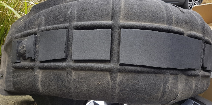

I didnt go nuts trying to cover every last cm2 due to angles and sizes required.   The liner fits back in place with a little pushing to get the screw holes aligned.  The screws have enough thread to go far enough in to hold it well without strain on the liner, screw or thread.
The other thing to note is the gaps in the liner with ridges.  I filled some of the top spaces with spare offcuts:
These are at the same height as the ridges
With the liner  in place everything is hidden, except for a section of the isolator:
This is the only bit that worries me as it'll get full weather exposure.   I should have used additional contact adhesive on the isolator for this section to ensure there's no chance of it lifting.  If you use any, check its ok with foam as some adhesives will melt it rather than bond.  I plan to keep an eye on it and take remedial action if it starts to lift away.
After completing both sides, took the car out and noticed a significant drop in the rear tyre noise.   Tyre noise now seems to be coming more from the front and driving at 30mph on some bad tarmac now doesn't have the roaring drumming noise from the rear.   Around  four sheets of Silent Coat and four of the isolator each side to do the job it's pretty cost effective.   Significantly effective and took me around a couple of hours (Mainly trying to figure stuff out).

Looks very good! Happy to hear about results! My plan is to do that too, probably starting from inside arches and then outside as last step.
I don't exactly understand where you jacked car up (probably cause of my English) any chance you could share some image where that was, the jack point you used I mean?
When working on this project I would really like to put car on Jack stands instead of jack only, since its a long project =).

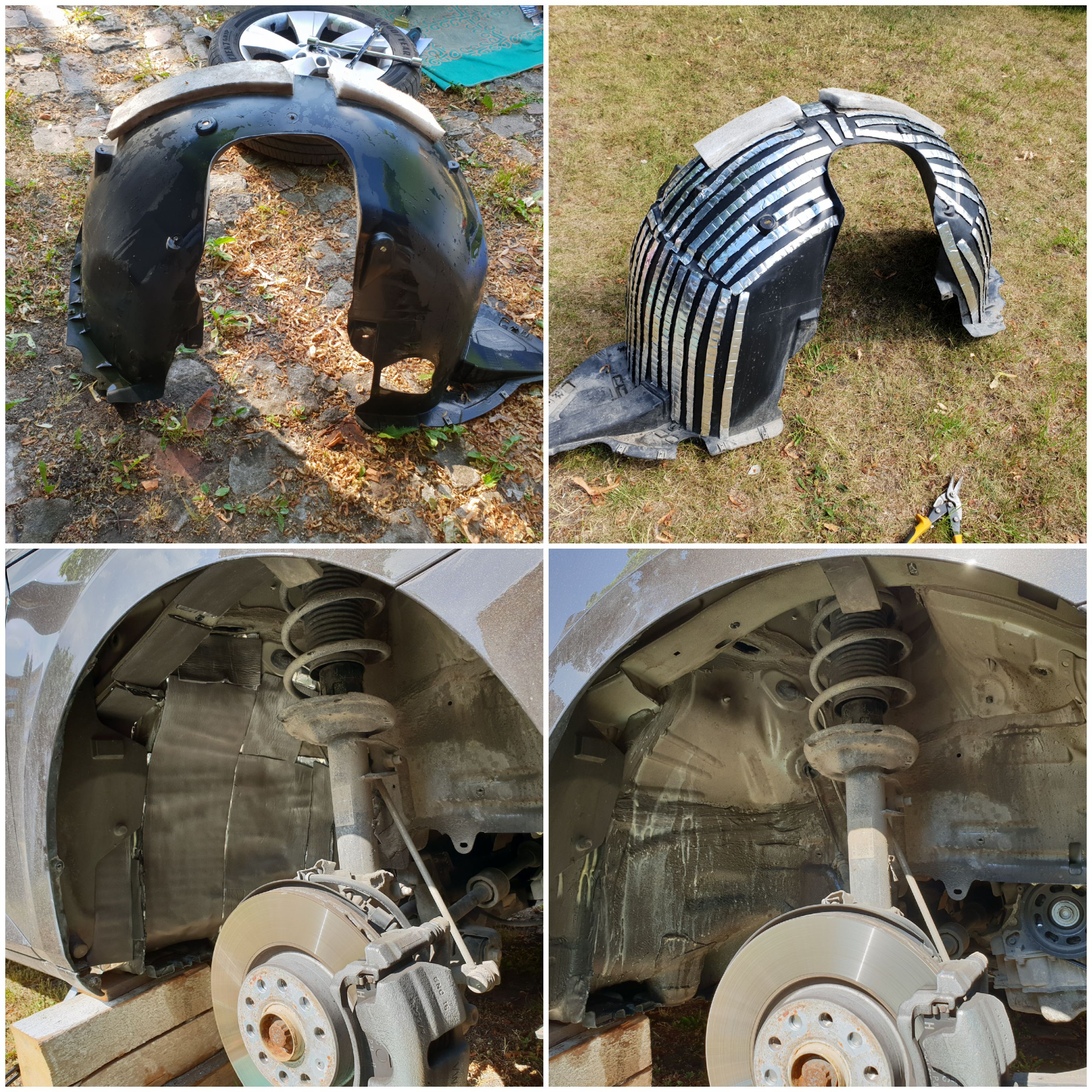

One comment. I would have gone a bit more further and added material to more than half of the wheel arch. Right now you have covered about 1/4 of the wheel arch and it is not very effective in terms of vibration deadening. Covering 65% or so would give the best result. But if you didnt hear any difference now, then you might not hear it after you have added more materials. Every person hears things differently.
What tyres you have and for second layer you used Silent Coat 4mm Isolator?

If vibration from the road is an issue, then probably most help you would get from doing the front floor. Outside wheel arches will give you benefit in terms of noise but not so much in terms of vibration that you feel when sitting on drivers seat.
Covering entire front wheel arch is not needed. Cover only 2/3.

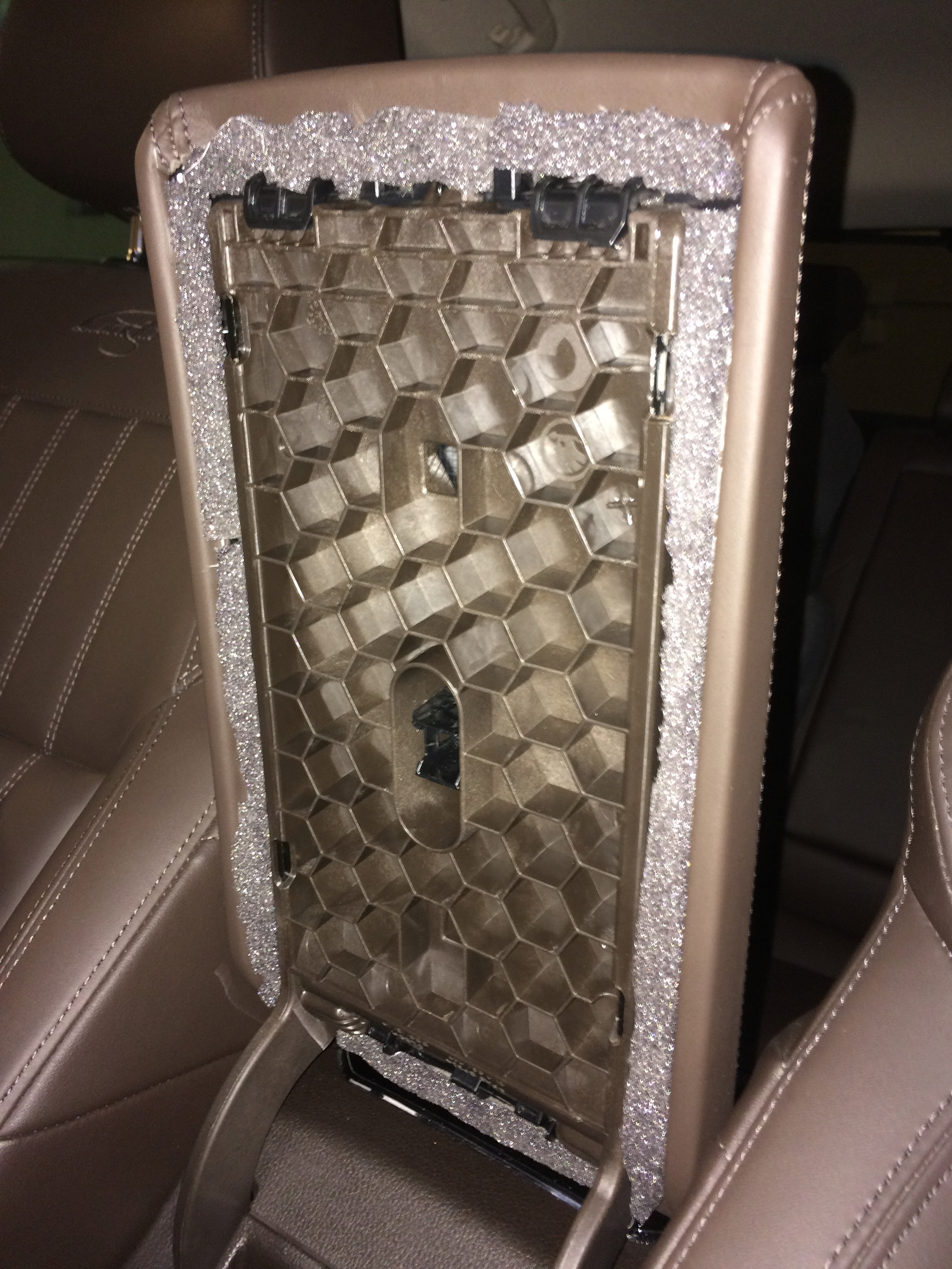

the armrest now is quiet
Edited by MartiniB
17 minutes ago, MartiniB said:
the elbow support now is quiet
No more creaking noise when you put your hand on the armrest?!?!?!?:o:o:o
^^^ @alf.onso
yes, it was a problem in hot weather.
sounds like fixed, but test drive isn't done yet

Wow, gotta try this out!
I always thought this creaking sound comes from hinges but it actually makes sense.
Superb has sooooo many odd plastic sounds. I must next find some instructions how to remove instruments cluster and lower part of dashboard.

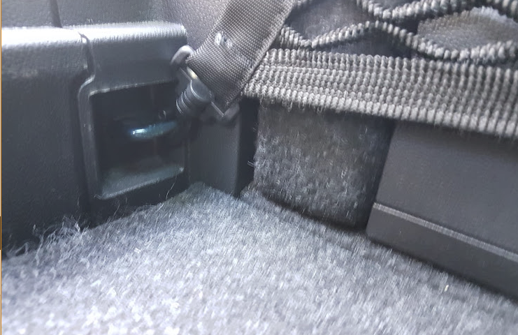

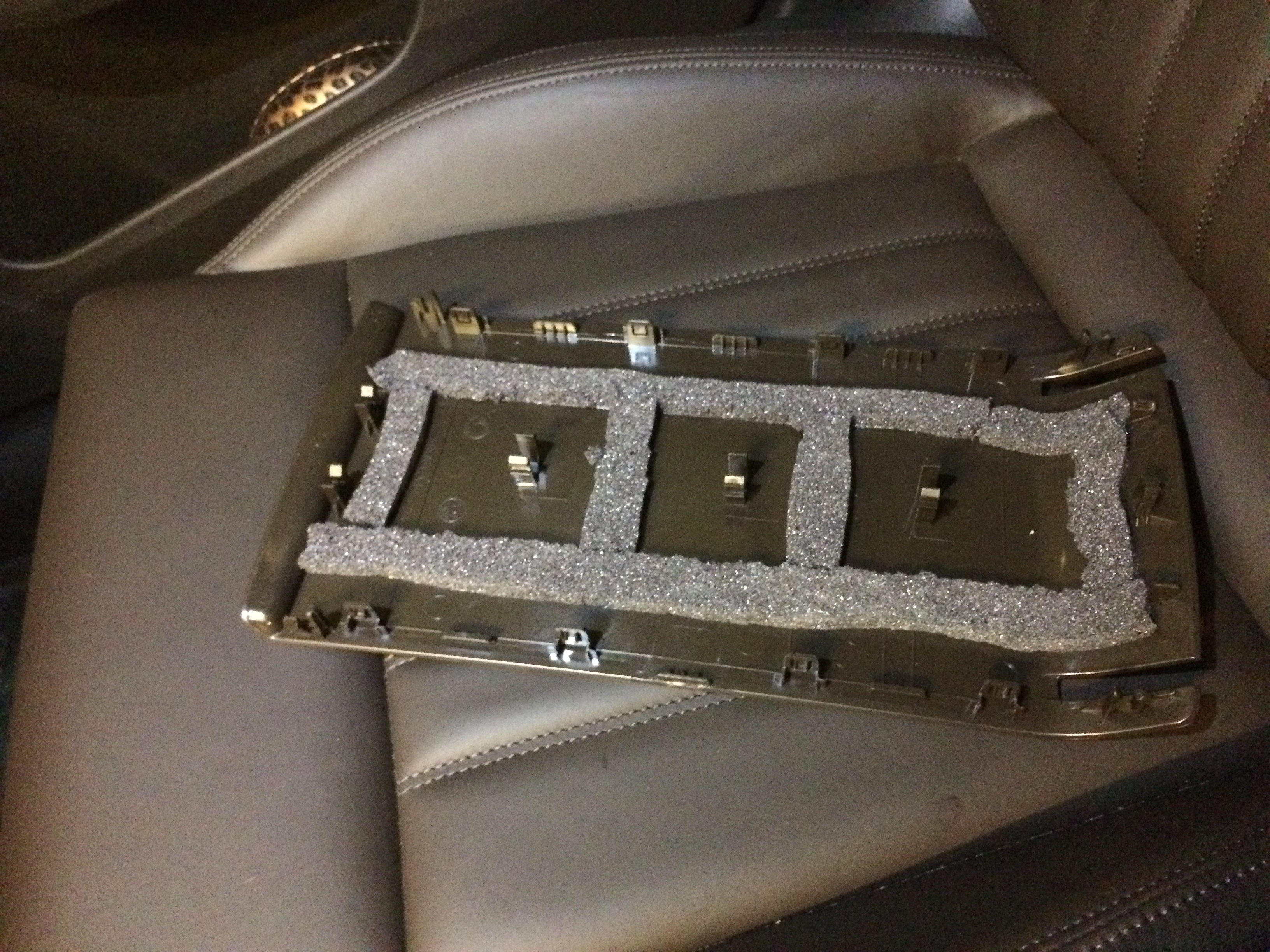

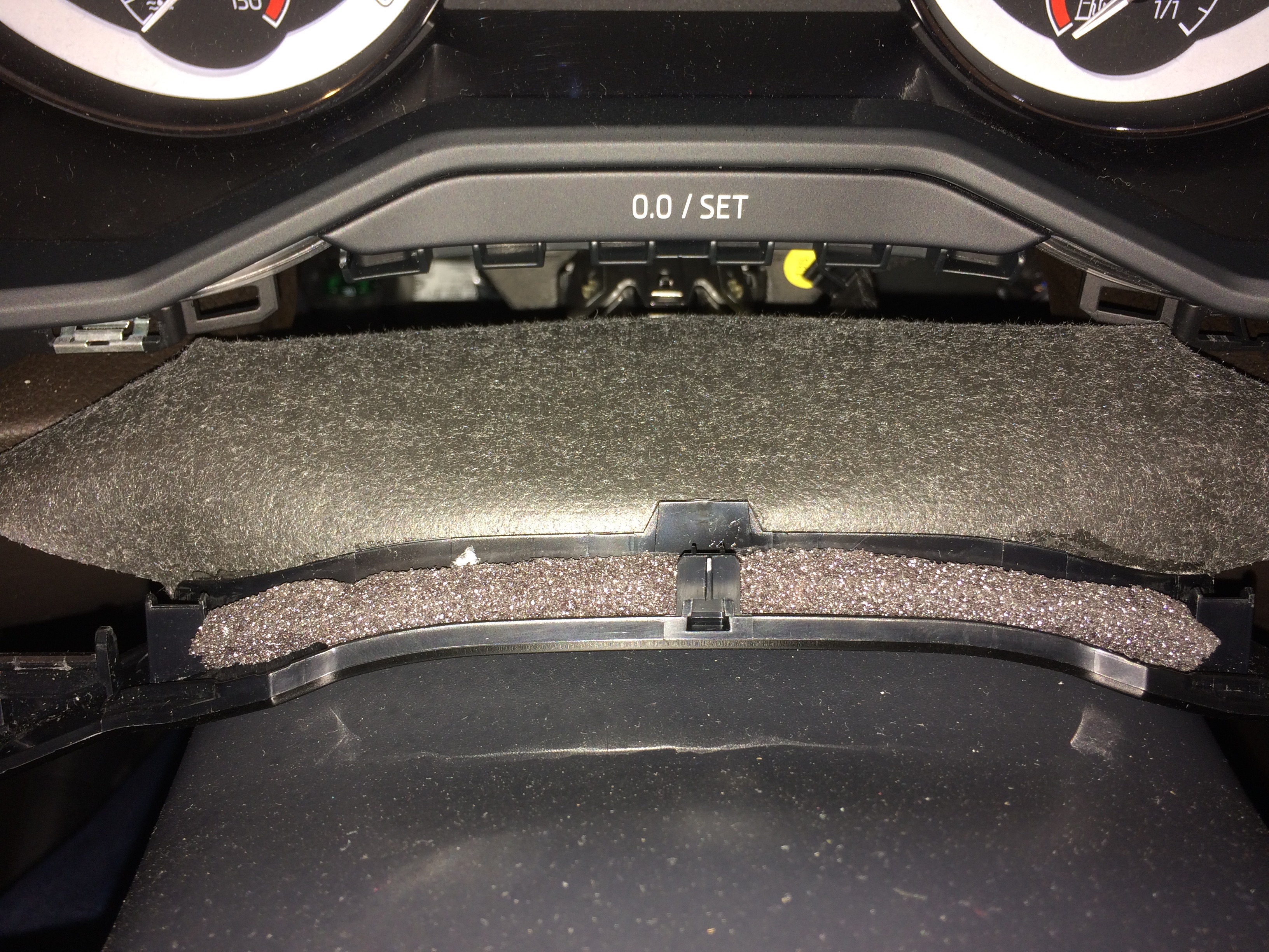

As we already went to the lovely field of plastic parts sounds, here is another thing I did few weeks ago.
Small part of the trim under the instrument cluster made creaky noises on bad roads (the only ones we got around here) so I decided to do something about it.
Recipe for small creaky Skoda plastic trim
Incredients:
 - One small plastic trim
 - Small strip of 7mm Silent Coat Sound Absorber
Then put those two together and no creacky plastic sound anymore.

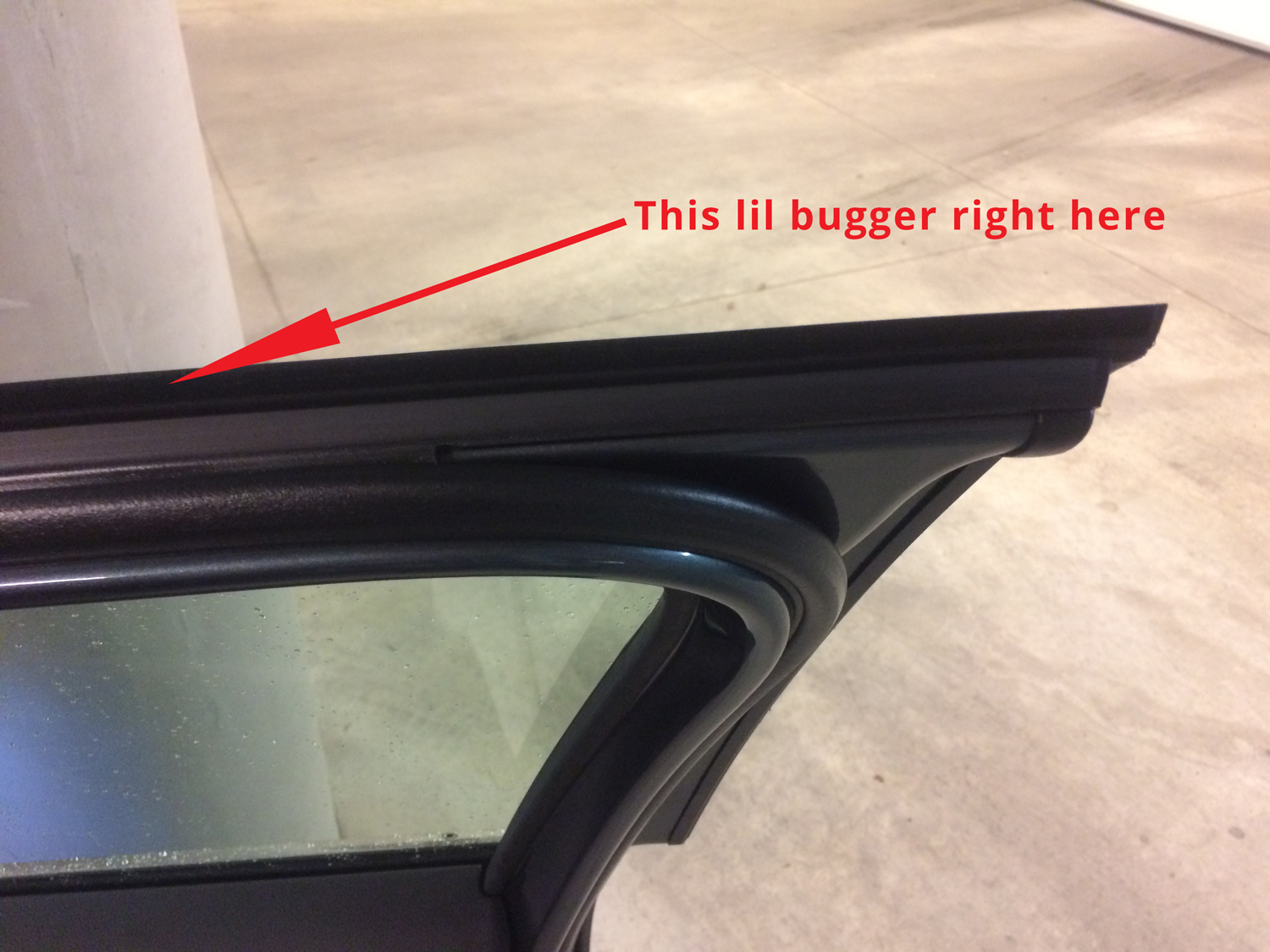

Slightly off topic but I have been going mad with door seals noise when driving on uneven places or when cars body is slightly bent due to different road levels. Have been treating and cleaning those seals with everything mankind has came up and some that they haven't yet. Today I made a breakthough! Seems like that door seals had nothing to do with this sound but this little hairy (felt like looking) "seal" at the top of the door.
Gave it a good cleaning with CarPro Eraser to get rid of all oils and silicones and other residues and conditioned it with Sonax rubber seals conditioner. And the noise is GONE!!!!! :cool::cool::cool:
I was so happy that I even took a picture of that small lil bugger causing all the trouble so that everyone would understand even without needing to read my unproper English mombling.

Yup, @JackySi, I have no misconception of those sounds not returning. Regular conditioning this lil bugger will be a routine but I'm happy to take this routine as long as there is no sound from seals:tongueout:
I see. Yeah the Sonax Rubber seal treatment is awesome for these noises. It also makes rubber last much longer (tested on our old Renault back in 2002, did door seals but not trunk, door seals were like new after 10 years, trunk was messed up)

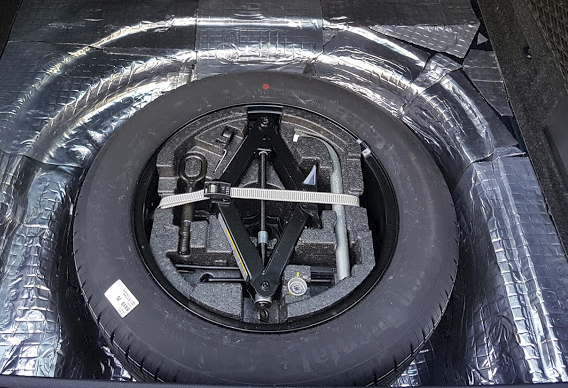

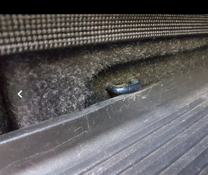

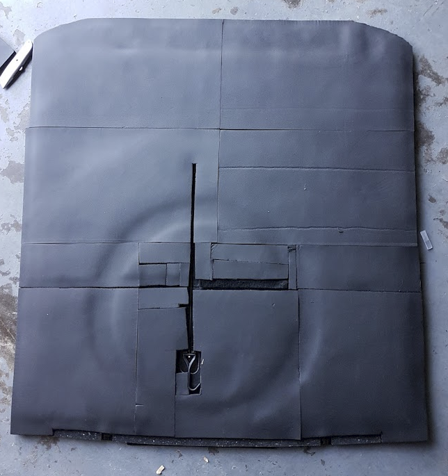

So, another trip into experimentation land, this time adding isolation to the boot floor covering.   First thing to note was the current height of the floor level.  Note the distance to the securing loop:
The boot floor is already patch work SilentCoated and with spare in place:

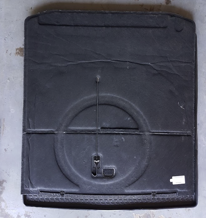

As you know, the underside of the boot floor cover looks like this:
I applied seven pieces of 10mm isolator (500x300mm per sheet), inclding all the offcuts it uses every last scrap.  So, based on the cost, isolation of the boot floor comes in at 12GBP based on the pack price of 12 sheets and havng five left for the doors, etc
Note I left space for the existing bits stuck to the bottom and the elastic cord.  Its also cut across so it folds up when lifted from within the boot
Applied back into the vehicle its raised the level but only by 10mm.  Here's the result with the Skoda boot liner in place.  Note that the raised lip is up to the retaining loop.  There is a notional gap around the floor (Sorry, didnt take the pic) and there's the gap at the rear where the boot lip part is indented.   Nothing I think of consequence.
In terms of affect, the boot area is totally silent.  In the grand schemes were back into the 20% area again but with the wheel arches and boot floor now complete, that's the rear end as silent as I can get without dismantling the interior to access to the arches, etc which I dont think would add much considering I'm not hearing anything from the back, even when in the back seats.
