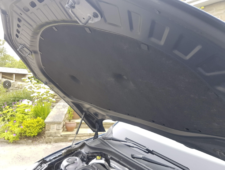

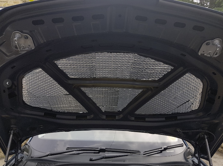

I forgot to mention that, after butyl mastics sheet, you also put back the original hood cover heat/noise isolator panel. It fits perfectly even after the vibration mats.

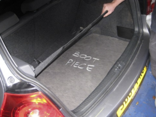

For boot I used 2mm vibration mats and covered it in full (also spear wheel .... "place"). There is plenty of room so vibration mats won't interfere with interior panels nor boot floor mat. You wont see any diference.
For boot you definately need the roller as there are lots of uneven places where you must "stretch" the vibration mat.
Some use 4mm noise isolator, on boot floor, to cover vibration mats but I havent done it yet. Must test if the interiors panels fit perfectly after the noise isolator and maybe then will use it.
Boot sides I covered with 2mm vibration mats and then added 4mm noise isolator. Basically I have put 4mm noise isolator everywhere I could (on top of vibration sheets) except doors and boot floor.
If you want I can take a picture of my boot (well, my cars boot not mine). I need to open boot walls anyway when I do the rear wheel arches (from the inside).

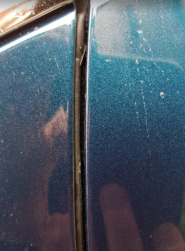

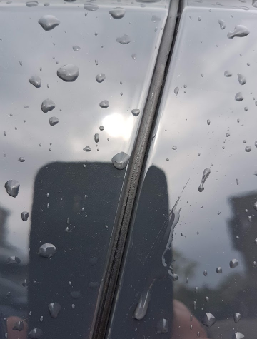

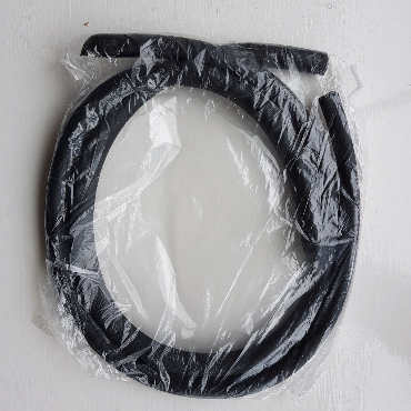

On 5/13/2018 at 11:45, JackySi said:

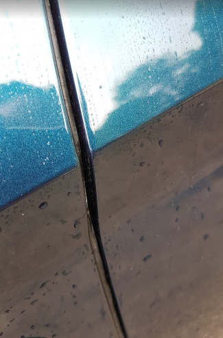

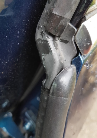

I purchased a set of these.  7 GBP and delivered in just 7 days

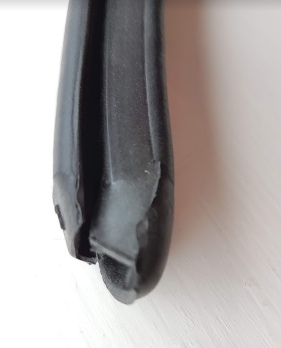

One end is straight cut, the other end has a curved section for better integration into the existing door rubber:
Trimmed 28cm off the total length and fitted to the door.  The metal inside is tough so I used wire cutters.  Its segmented so cutting in the gaps is easier to go through 2mm rather than 12mm.  The ribbing on the edge gives a clue to the spacing.

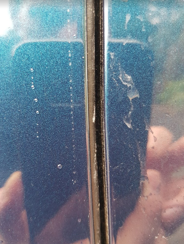

image.png.7d6aba21a00ec9a7d186b9a657a56d50.pngimage.png.72cd14a3ea39046e8eb9dfd213ba7a2d.png

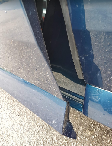

The curved section sits partially under the existing top rubber for a better fit and finish:
Closing the door has more resistance and makes a slightly duller sound.  When closed you can still see some gap present:
image.png.e2bde95ee0ee61d6db034c3598bfbcad.pngimage.png.7967837ed98e5d4043667f3a794821db.pngimage.png.4835627f1bec1b41c9b4173e79a858fa.png
As a comparison, my Mk7.5 golf has rubber trim in the same location and appears more sealed when closed:
Aesthetically, it might not be to the taste of those requiring a more factory finish look.   Will attempt next week to do some A-B audio samples at motorway speed to record its affect.

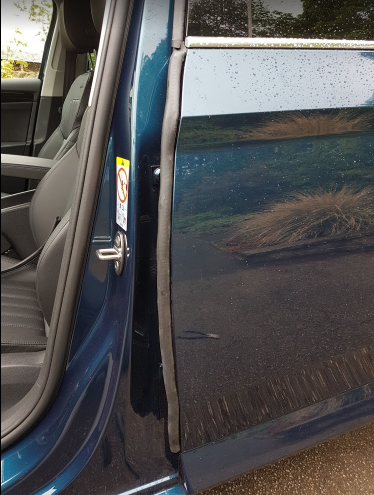

Did you get the chance to test NoDigital?  interested to hear any feedback as thats where I feel the majority of wind noise is coming from.
Yes, did a test this evening.  Dual carriageway, 70mph in both directions, first with the seals in place, then without, then with again.  Recorded on a Zoom H2 in two channel surround from 4 mics.    With my son in the back monitoring and subjective listening whilst in the car, the evaluation of what we heard and the recording was inconclusive.  We couldn't tell any significant difference in wind noise or change of location of noise or elimination of noise.  The wind turbulence externally was consistent above 60mph and couldn't tell if there was anything emanating from the doors or whether it was wing mirror related.   Maybe at 90mph there'd be more and on a still day when there's no wind turbulence, just the vehicle moving through the air may give a noticeable affect.  Like all after market noise reduction  approaches, it may give some benefit if the rest of the vehicle is more quiet - Ie addressed wheel well noise,  etc
So, my personal verdict is the rubber seal, in my observation, made no difference to noise while the vehicle was in motion at UK speed limits.   However, at 7GBP it was, for me, a worthy purchase to improve the quality of the door close sound.

So, I decided to continue with my noise reduction experimentation.  Notes here detail my experience
First thing to try out was the bonnet.   On mine, it already has some form of factory insulation to presumably reduce the higher frequencies but does nothing for the the hollow sound of the hood when tapped.
Clips were easy to remove by squeezing with care as they'd be long gone if dropped in the engine bay.   in my purchasing I'd bought two  lots of sheets, one to experiment with, the other for more crucial parts.
The experiment pack was PeaceMAT XR Pro https://www.amazon.co.uk/gp/product/B01N56230D
 The 'large' sheets seemed reasonable value but they were not that large.    All told, they were about 23GBP for what works out to be a square metre and at a weight of around 3.4Kg per m2.   The price makes them about 10% more expensive than buying a silentcoat bulk pack so not so 'lower cost' as described.   They look similar to Silent Coat and are near enough similar thickness but work out at around half the size of a Silent Coat sheet from the bulk pack.
Applied 8 PeaceMAT to the hood in about 15mins.   It was good to work in free space an understand what the material is like to work with without being in a more difficult space.
Clipped the original cover back on and tried it out.
In terms of effectiveness, its on the 80:20 scale where its likely to be 20% of the last 20% in benefit.   It didnt strike me as being significant or noticeable so not worth being the first thing on your list.   On a satisfaction scale it scores well:  Done something to 'reduce' noise for around ten quid and its very easy with no tools other than the sheets and a roller.
