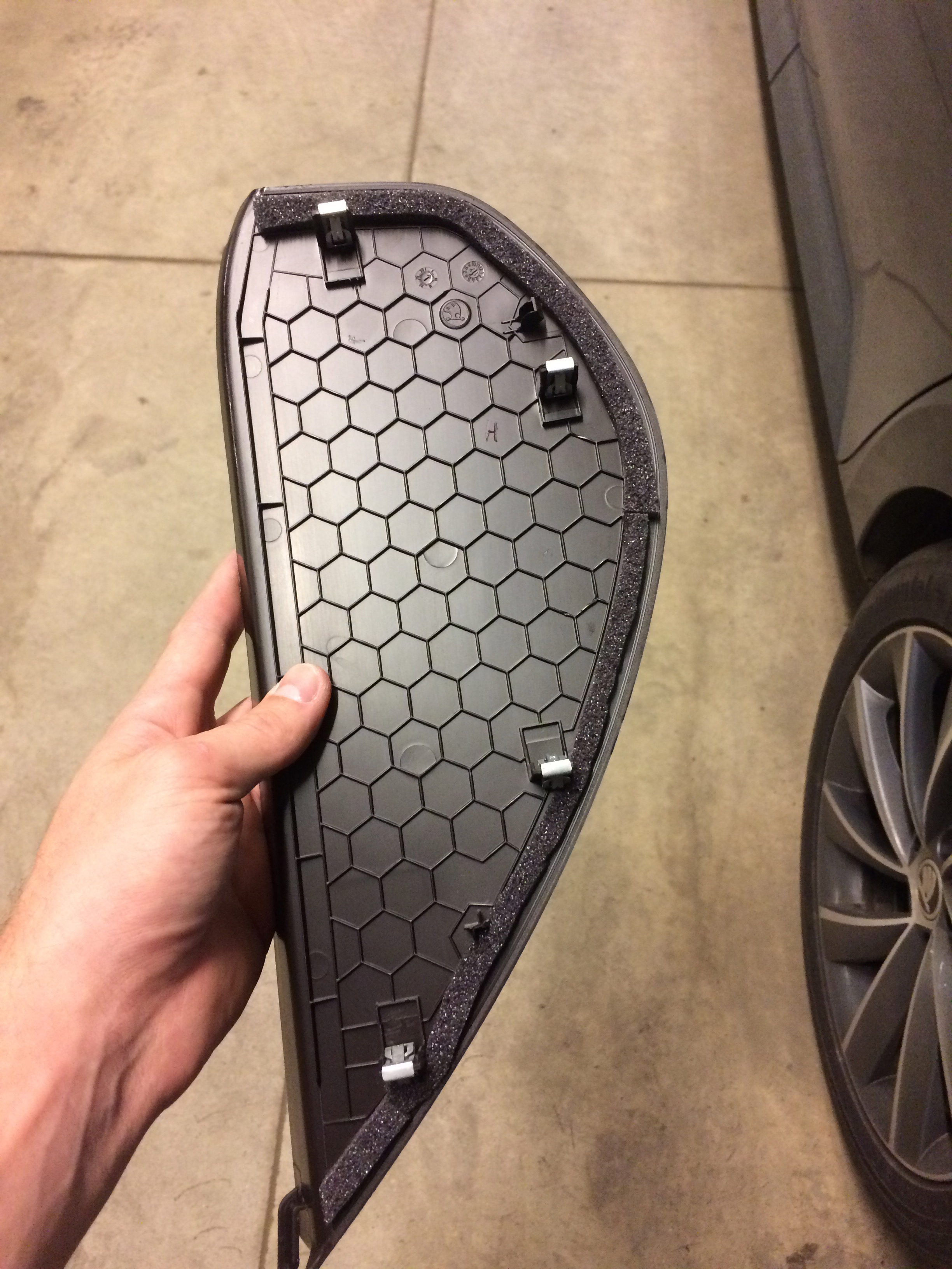

I had forgot to mention that I made one more plastic part (two actually) to loose it's noisiness. Picture attatched.
Used 7mm Silent Coat Sound Absorber as per usual.
That looks good! Need to check manual how to get controls off. Also need to buy some material to put there ^^.

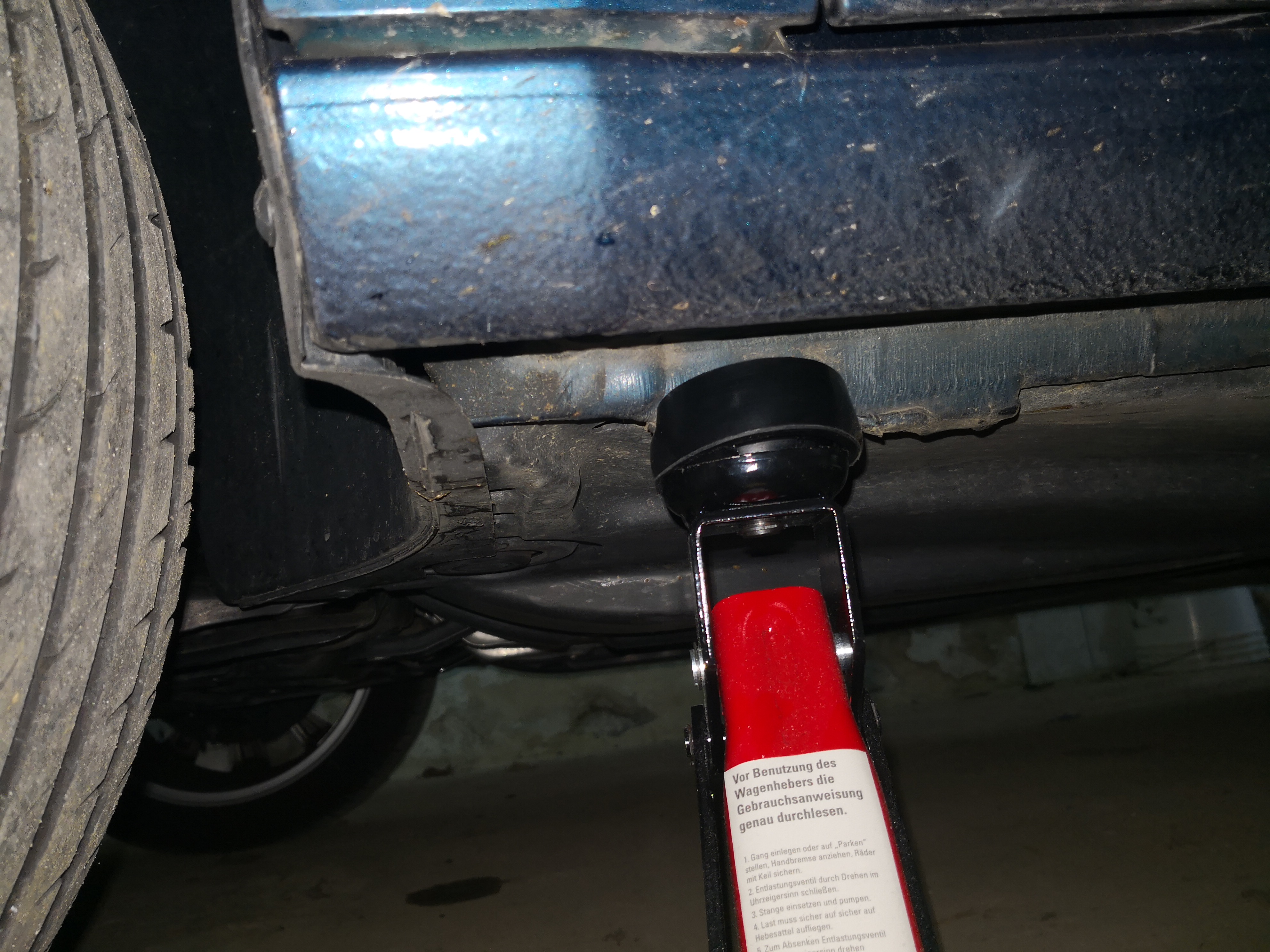

@nodigital sorry but can u show how u jacked up via alternative method? I cant get jackstands at same time no space. I'm afraid to use any other point without some confirmation/pic :-) thanks for all contributions anyhow!
I have rubber pad also.
Edited by JackySi
I jacked with a block of wood to distribute the weight on the arm where the spring is.  Highlight shows the width, obviously to the left side of the protruding nut:
Note this is not an official point but its flat and must be pretty strong as its supporting the spring.   For me this worked and I used the jack point as additional safety support.  Advantage was  it doesn't take much to compress the spring when jacked so I didnt have to lift it far.
