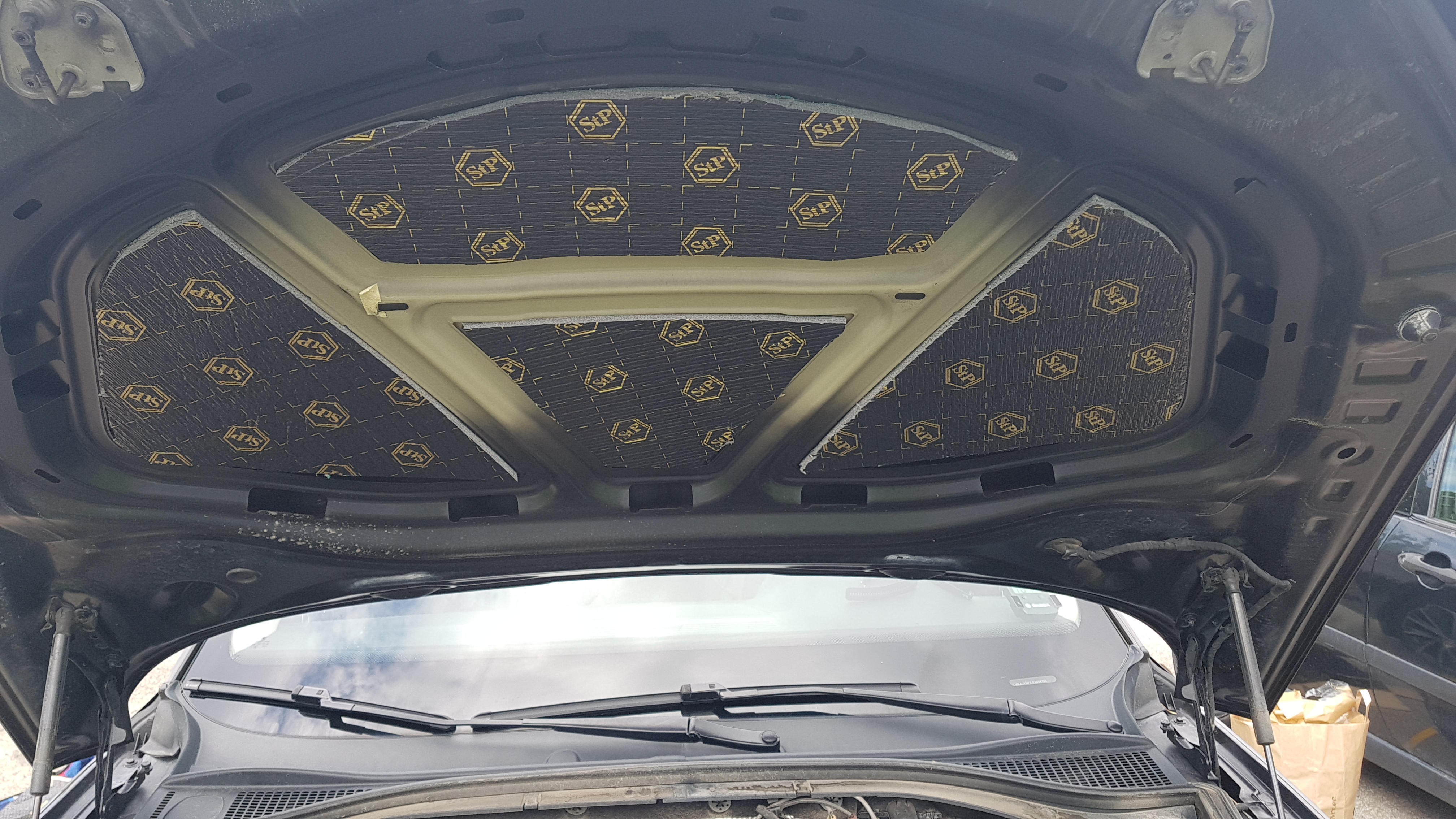

  • Had one week vacation and what would be better than do some sound proofing to Superb. This was my first ever noise insulation project so had a lot to learn and this thread was a great info source for
  • Wheel well noise, I'm told is a significant contributor overall so with this in mind I decided to try out the rears first.   Having recently been camping and totally filling the boot space to the roof

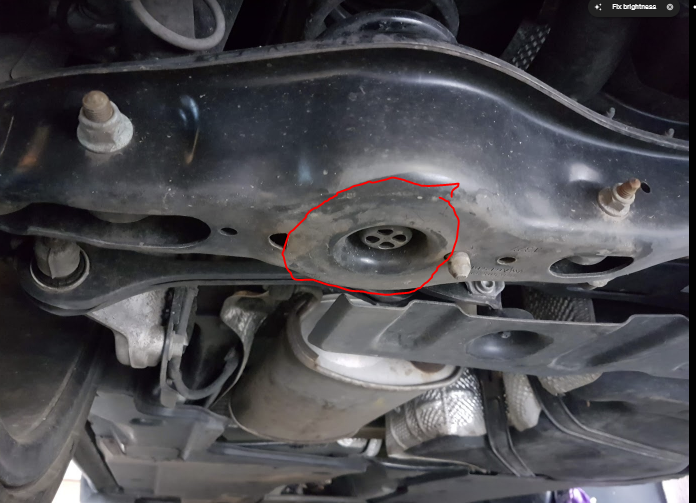

I jacked with a block of wood to distribute the weight on the arm where the spring is.  Highlight shows the width, obviously to the left side of the protruding nut:
Note this is not an official point but its flat and must be pretty strong as its supporting the spring.   For me this worked and I used the jack point as additional safety support.  Advantage was  it doesn't take much to compress the spring when jacked so I didnt have to lift it far.
That actually makes perfect sense! Thanks!
I guess if springs don't break that piece of metal it should withstand jack stand yeah! Very useful. I will jack up the car there and put jack stands where jacking points are (official) and that should allow safe work under car =)
I don't trust this jack a bit.

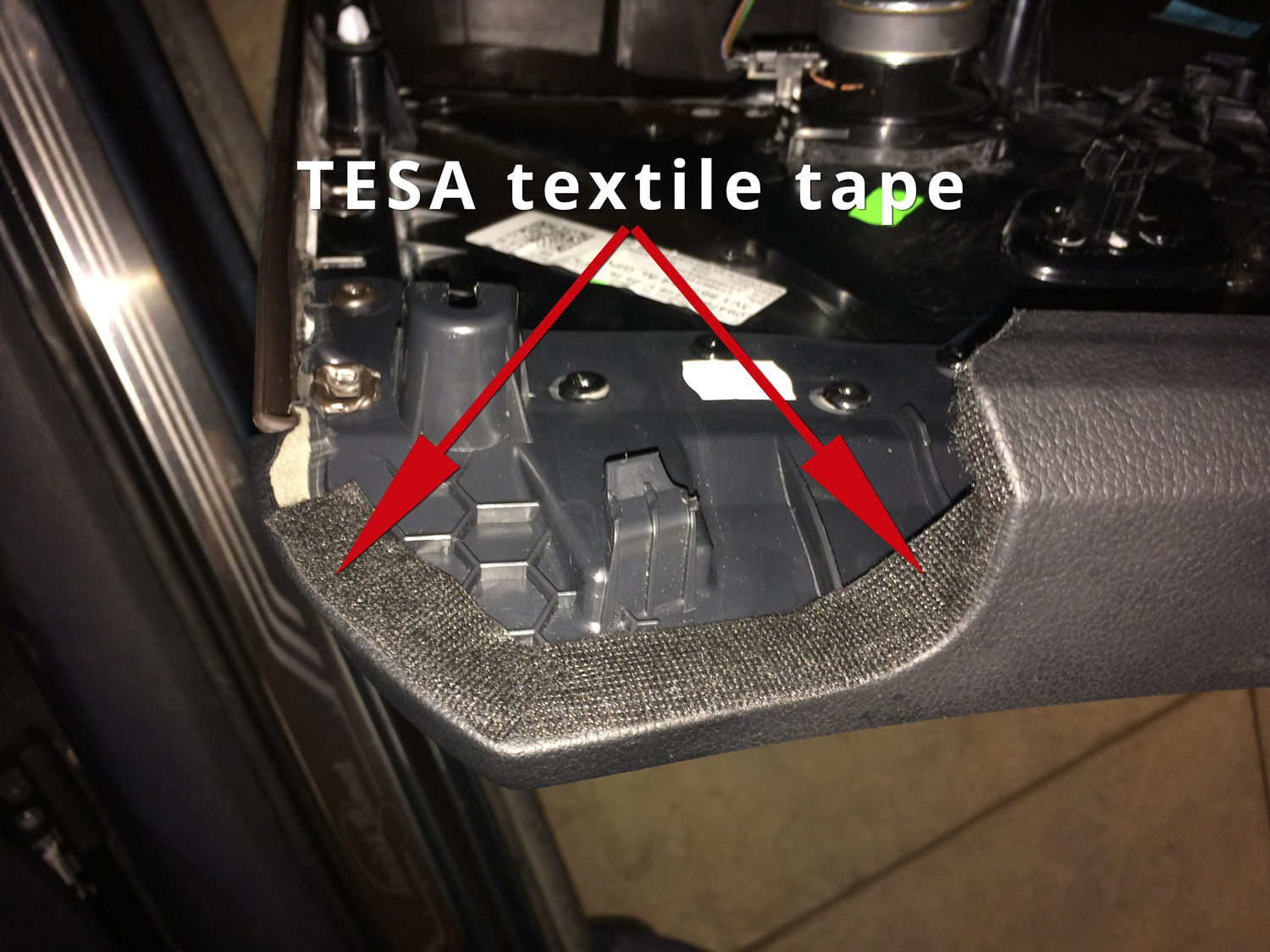

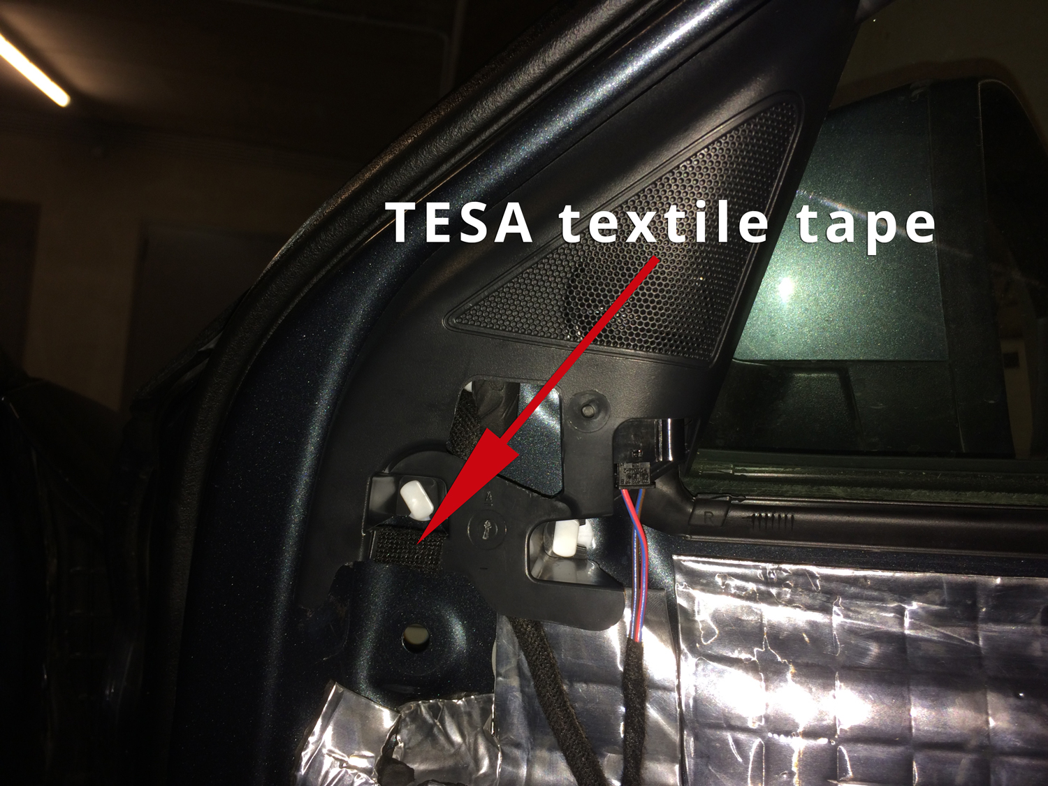

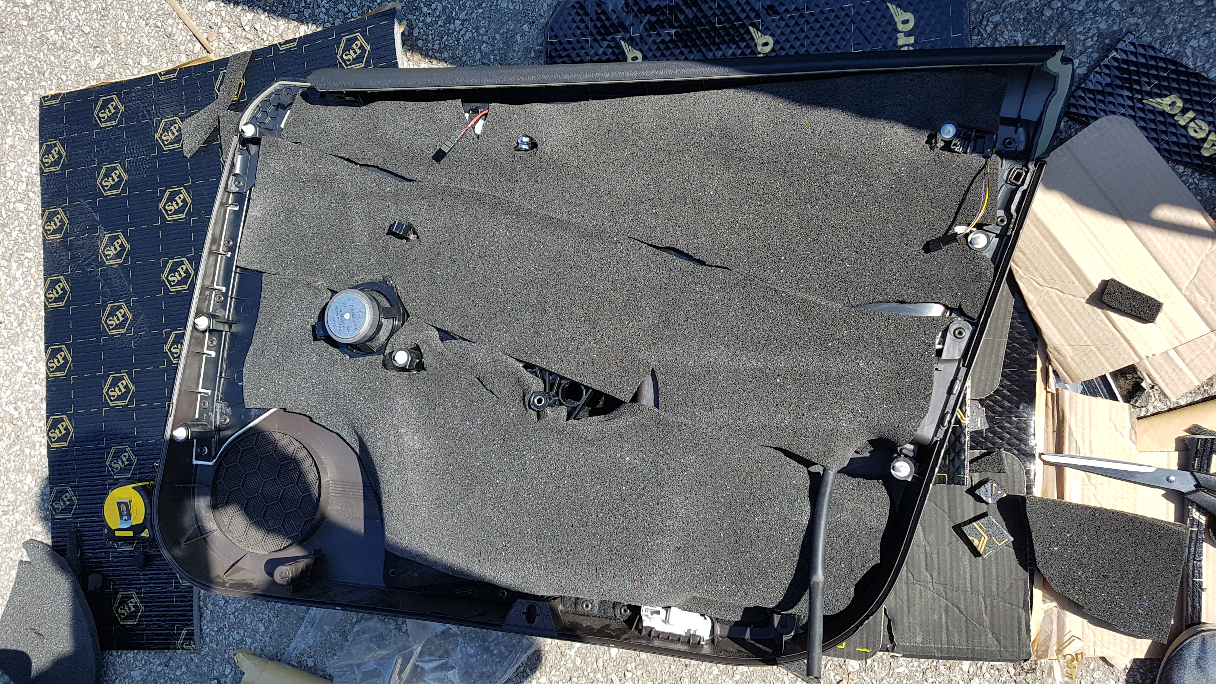

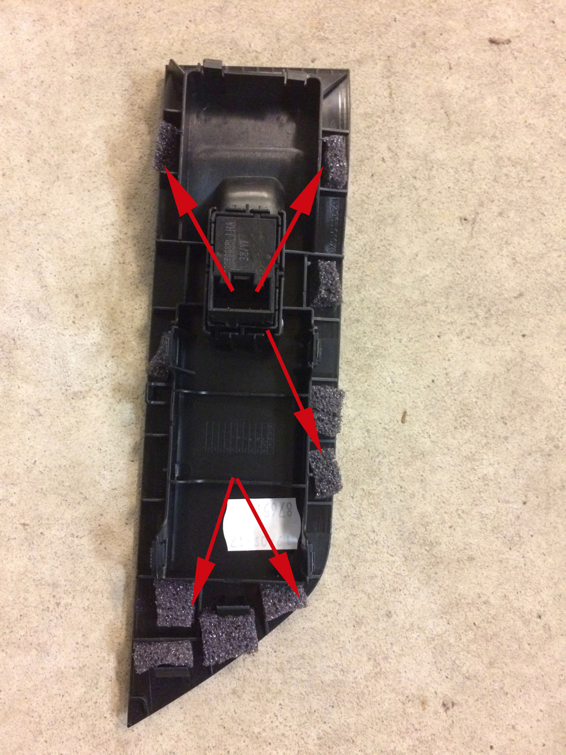

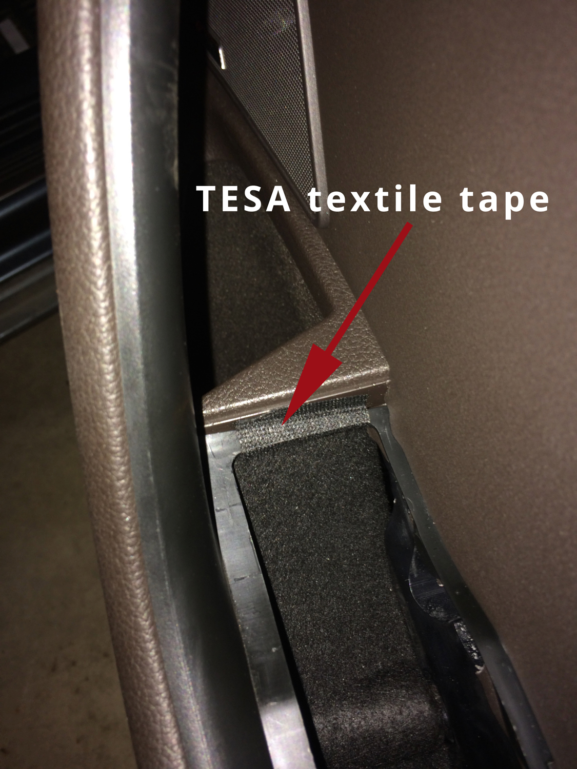

I had passenger side door panel removed today so I sound deadened the window switch thingy too.
Used TESA textile tabe and as per usual, 7mm Silent Coat Sound Absorber. TESA textile is used in the front part of the switch panel.
When looking at pictures, I probably overused the 7mm sound absorberd and so much is defo not needed:D
And it's silent now. You can toutch it any ways possible and no creaks are emitted.
Here are pics:
Edited by alf.onso

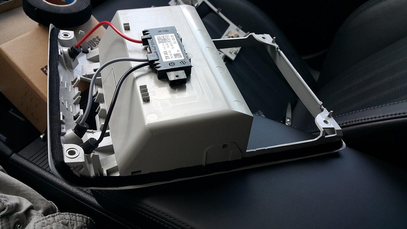

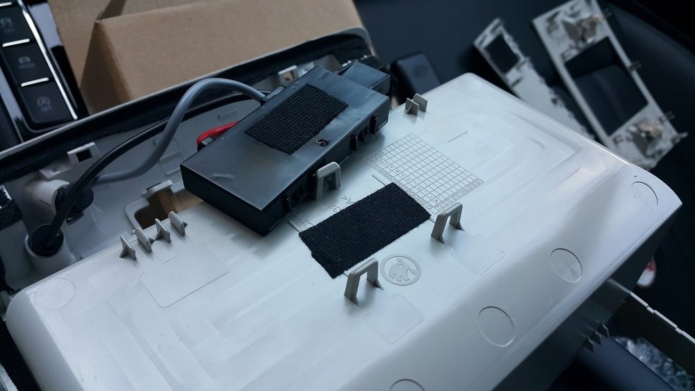

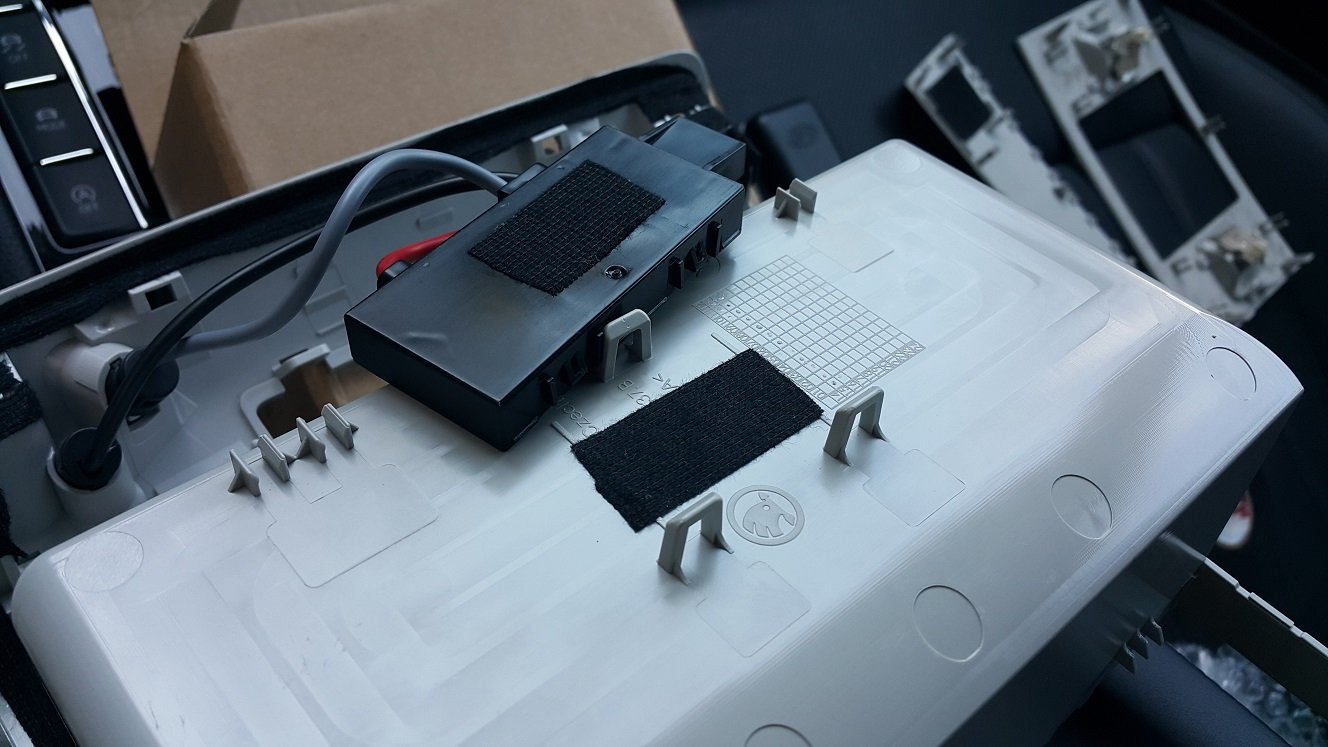

Some photos from my rattle removal from dashboard insert:
After split of the dashboard... Then top of the insert - all plastic connected pieces needs to be separated by tape. Be careful with removal of the 0.0 reset button.
... and dome lamp, and between front windscreen and foof linning - yes it squeze the contact between the glass and linning
Blue strips of tape...
Red mark means - there is need to add some tape...
Put a little teflon between plastic and roof...
Edited by Enriquez
You guys ROCK! I'm defo doing the plastics that's ****ing me off. =) thanks!!! I need this tape, need to check if i can get it in local store so I do this tomorrow :D
My car has 24.000km. I'm going to do full sound deadening when I get all materials =). Mileage doesn't matter. Most of things we do doesn't have anything to do with the warranty (as far as I asked 2 dealerships). We're only adding material. Removing panels etc isn't really big deal as long as u don't break something and ask for warranty =).
P.S.: @Enriquez your instrument cluster looks like brand new, how do you treat it? :o mine is soo scratched =(... talking to some AliExpress company to deliver me screen cover (like screen protector). Going to give it a good polish first though.

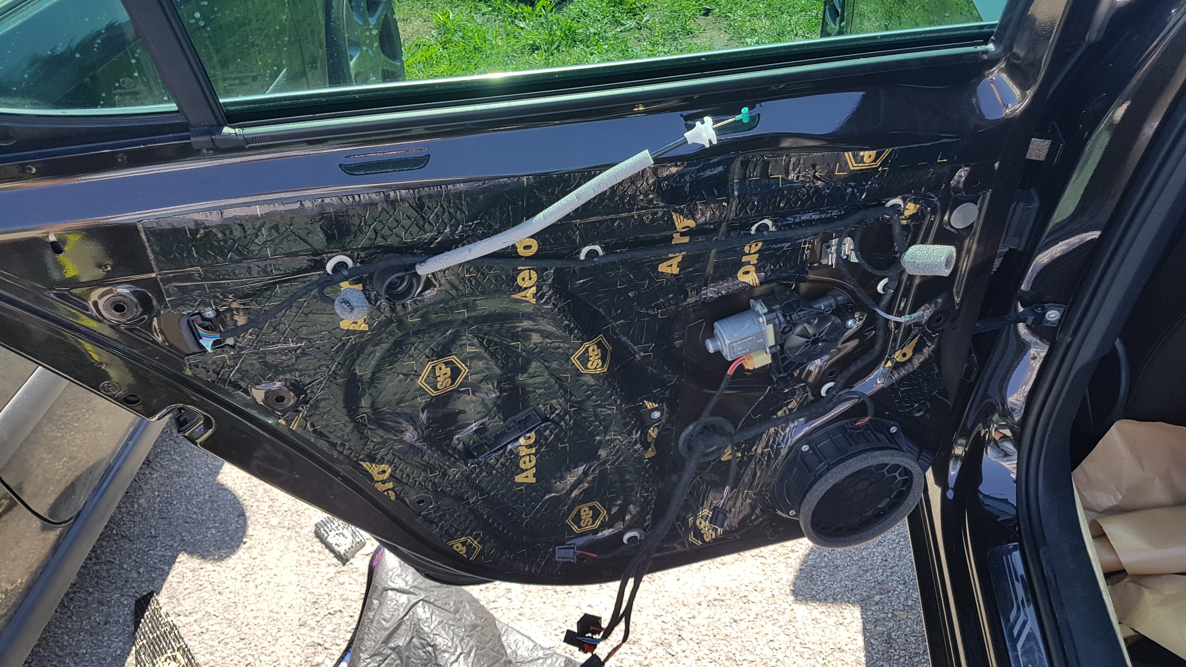

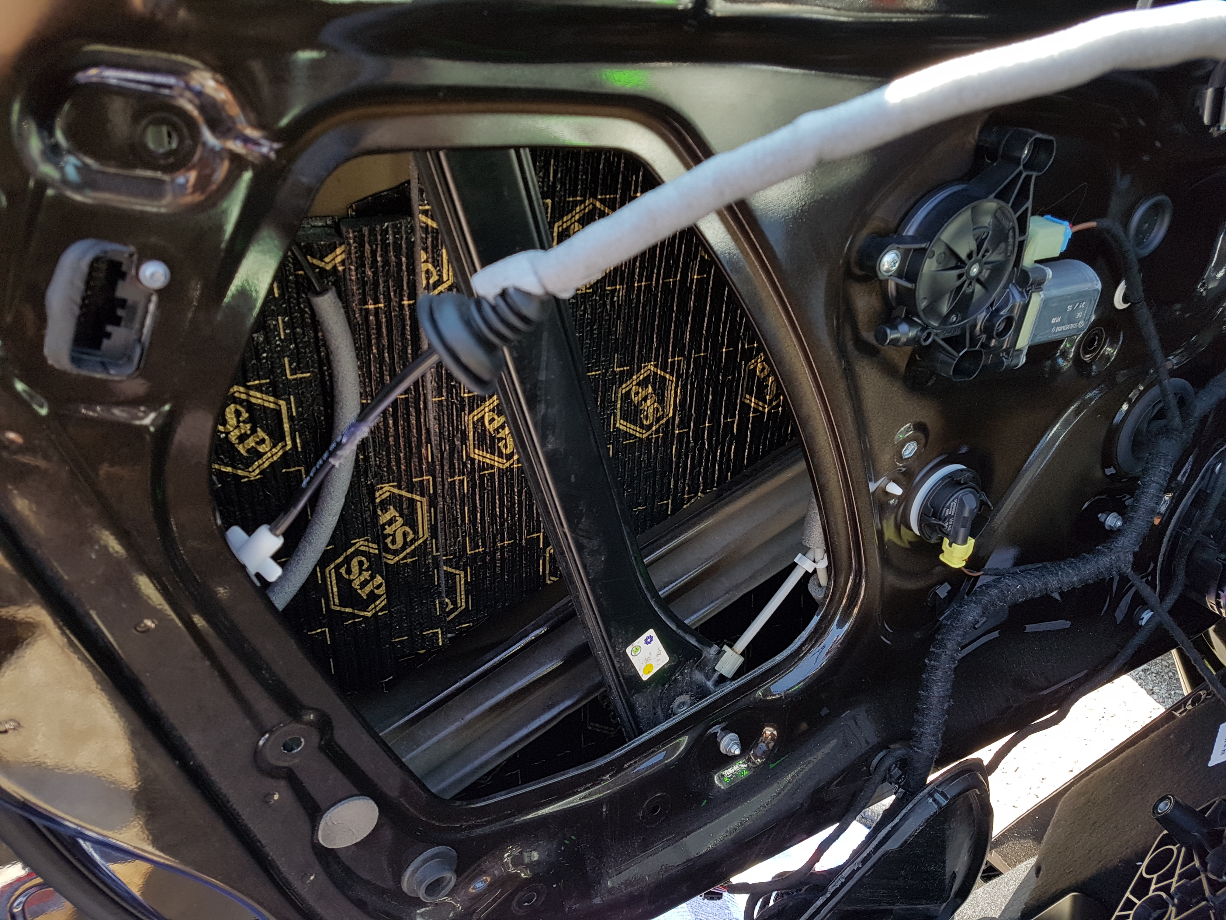

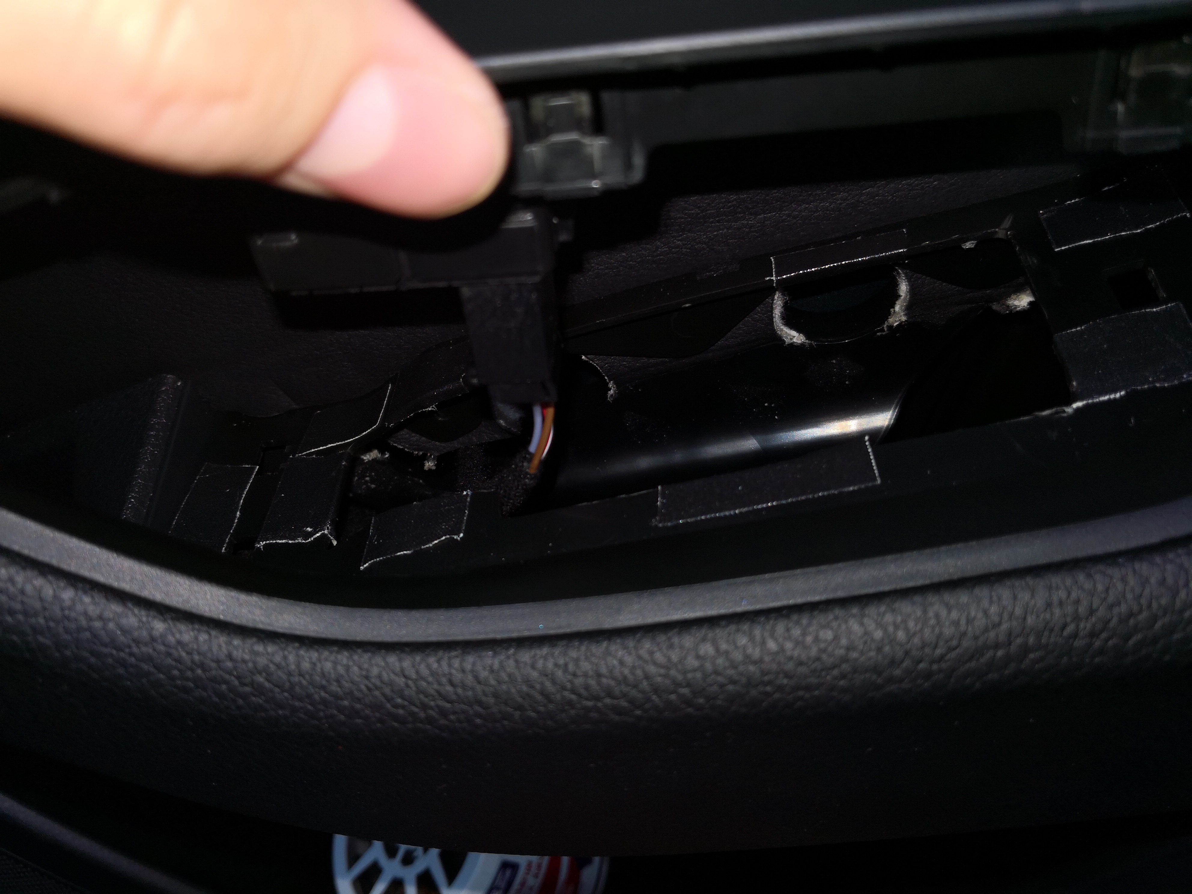

Couple of more pictures from yesterday's odd noises deadening.
Had some occasional small noise coming from the passenger side door panel so took my old friend TESA textile tape and removed the door panel.
I knew the sound location but not the exact piece making it so I deadened two most likely objects.
On the second picture, I wrapped shown plastic part from both sides. It is a "socket" for one door panel "clip" (dunno proper word in English - hook?).
I know that I would have gotten rid of that sound after 15mm sound absorber is installed to the door panel but as I plan to swap door panel PU leather insert into Alcantara, I didn't have pattience to wait that long (15mm sound absorber must be installed after Alcantara). Thusfar I have managed to swap Alcantara only on drivers door:D

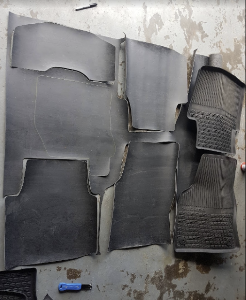

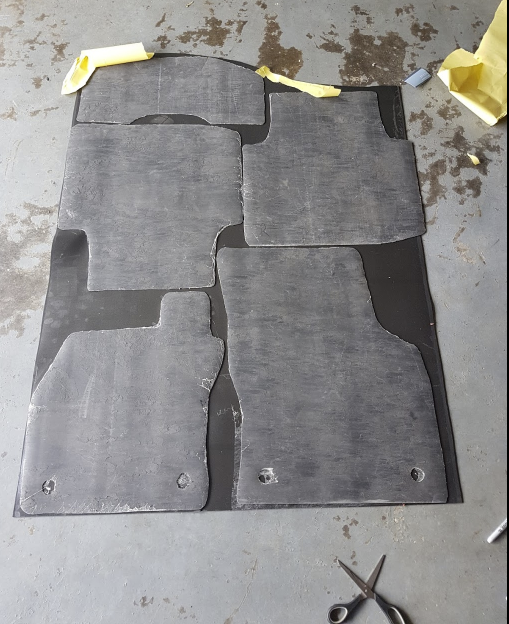

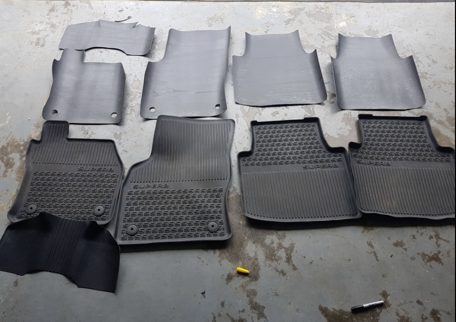

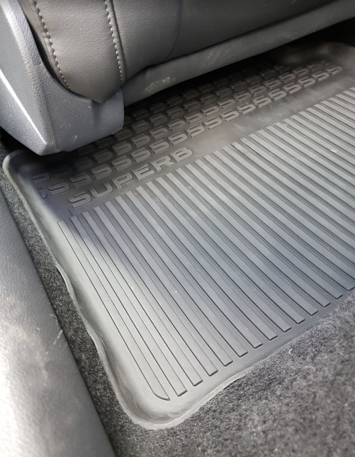

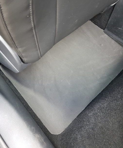

So, another weekend, another experiment.   One of the problems I dislike about the rim & P7 setup is the low frequency rumble on rough tarmac around town at 30mph.  The rear wells limited some of the noise but the rumble and floor pan vibration was still there.   taking out the carpet in a full stripdown and silent coat on the floor would probably eliminate it but I was not up to doing that currently.
So, took a different approach.   I have the rubber mats installed which I figured cover a lot of the floor pan.  The rear mats extend under the seat and the front passenger up into the wheel well area.

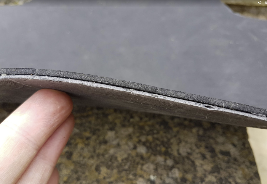

So I bought a roll of 2mm mass loaded vinyl with 27db noise reduction, laid it out and drew around the flat part (not curved edges) of the mats:
Used the blue tool to score the outline then flexed the score and tore out the pieces - its easy to work with and tears along the deep score marks
This left me a set, including the centre tunnel piece
I also bought some 3mm foam.  Rather more ridged then expected and the adhesive was terrible.  I used Everbuild spray contact adhesive (Comes out like silly string but there's no way you'd want it spraying on you... Tip, use gloves for this, its very strong) to spray one side and then apply from an edge and roller down as the rest was applied.  Once its made contact its damn hard to lift off.   Note I cut out where the holes are for the mat mounts so it fits over the whole plastic piece, not the peg.   I didnt calculate the width so the upper right bit was a bit too big and I had to stick an offcut to the side.   Note the layout is for the foam isolator to be facing up.
The tunnel piece needs diagonal slits to make it sit properly on the rear top parts of the tunnel.
Here's the composite structure.
With the deadening mat in place it fits flush:
And the mat sits back flat
So, question is did it work?   Well, it seems to have reduce the vibration and rumble.  Now my son complains about the loud rattle in the passenger door which is noticeable more now.   On the rough tarmac sections its nowhere near as loud as it was.
I need to do some further db meter tests to ensure its not bias thinking but as far as I can tell, its made a positive difference.

Decided to take the path towards silence, started with doors and bonnet. The result was impressive - doors are now silent while driving (before that you could hear the road noise and cars passing by) and the music is clear and crisp.
A few tips from my side:
1. Start with removing the window switch panel, if you take the door card off before doing so removing the connectors will be a pita.
2. Wear light gloves otherwise your hands will look like of a junkie (cuts and bruises)
Will be doing the rear arches, boot floor and tailgate next.
Edited by Puuriit
Time spent on the work:
Front driver door - 1,5h (I started with this so learning is included in the time, it is also the most difficult one from all 4)
Front passenger door - 1h (this is realistic after you know how things are done)
Rear doors - 40-45 min. each
Bonnet - 30 min.
It depends of course how seriously you plan to do it. I did two layers on the outer skin (2mm STP Aero + 10mm STP Accent), 1 layer on the inner skin (STP Aero 2mm) and 1 layer on the plastic door card (STP Biplast 10mm). On the bonnet I also did two layers (2mm STP Aero + 10mm STP Accent).
The tools you will need - T25 Torx, 10mm spanner, plastic trim removal tools, sound deadening roller.

yesterday i followed @Enriquez's instructions, and forget about this small detail:
it's important one!!!
a small squeak when pushing front left side still here :(
that comes from the holder of roof cover.
i didn't found right amount of power to able remove it and insert something between.
but i found one new, here unlisted, source of plastic clack
Superb is one big squeak :)
