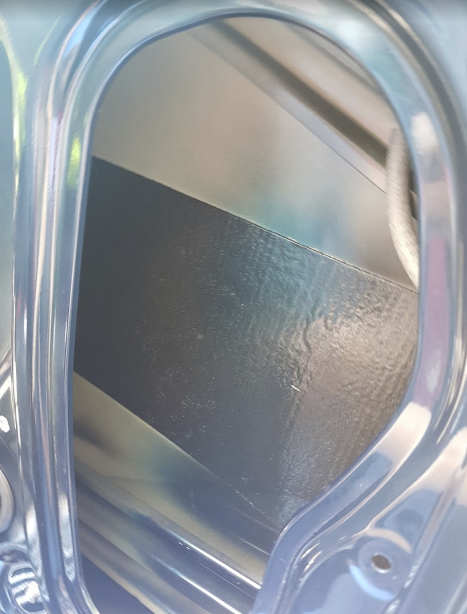

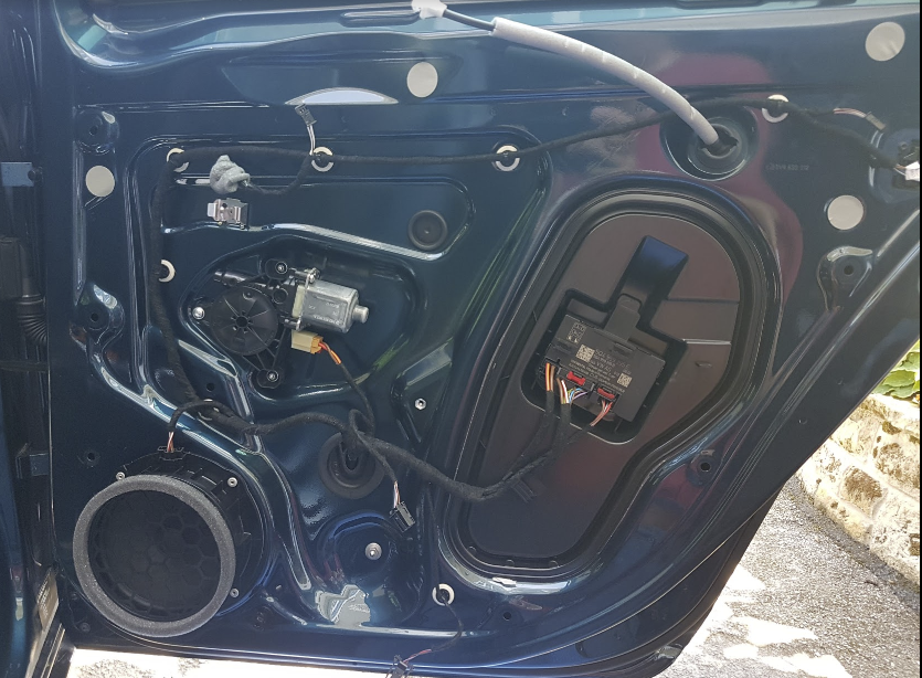

First was the rear doors.  Now, I dont do this type of thing often and was surprised by what was behind the fascia.   When you look at the videos on youtube  you see cars with large holes in the inner metal skin.  Mine was not at all like that
A lot of reason for doing this on most cars is that thin plastic sheet vapour barrier which provides no noise isolation.  In my door, its fully sealed.   Also note the speakers have rivets in them making access somewhat less than ideal
With a pair of plyers you can pull out the large plastic seal by gripping on the tab.  On the outerskin was a large deadening sheet:

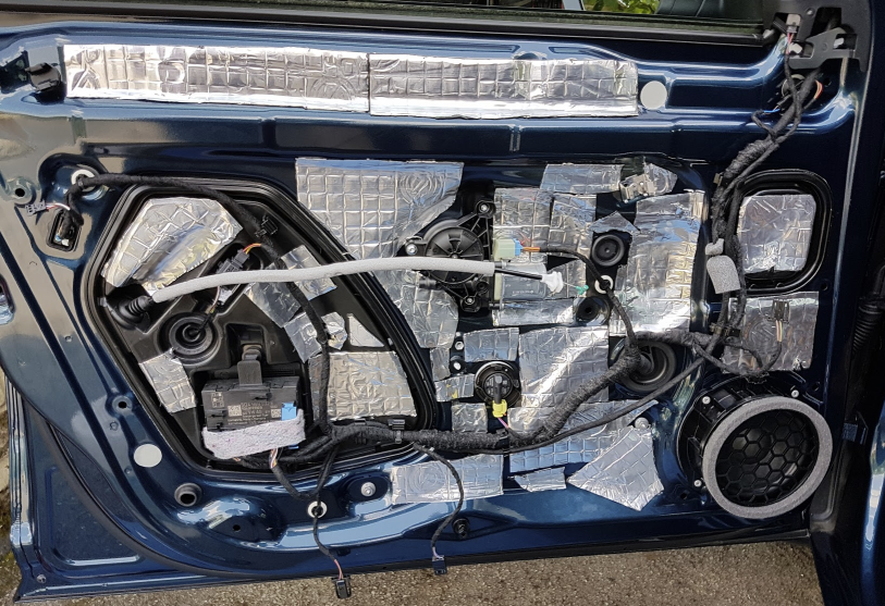

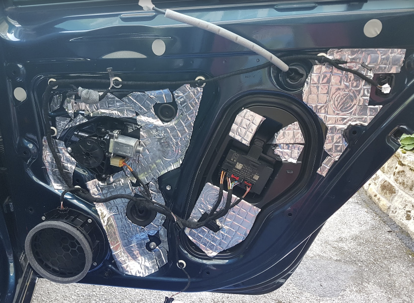

I coated the whole door skin, including behind the speaker, and notable points around the edges where it was resonant then put the plastic cover back on.   Now, the 'cover the whole area' on the inner made no sense to me.  Tapping around the skin showed points of resonance so I applied just enough to make it sound dull:
One the plastic facia, sorry didnt take a photo, I coated the large flat plastic area with silentcoat as I noticed this resonated then used some 4mm dodo sound reducing foam to cover most of it, noting where door mechanism was.  Note that the bottom part where the door pocket/bin is seemed quite close fitting so didnt coat that area.   Reassembled without any problem.
The door sounds very dead, noticeably heavy.   It is however hardly changed in the amount of noise from the doors and audio is marginally improved, almost negligible for rear sound

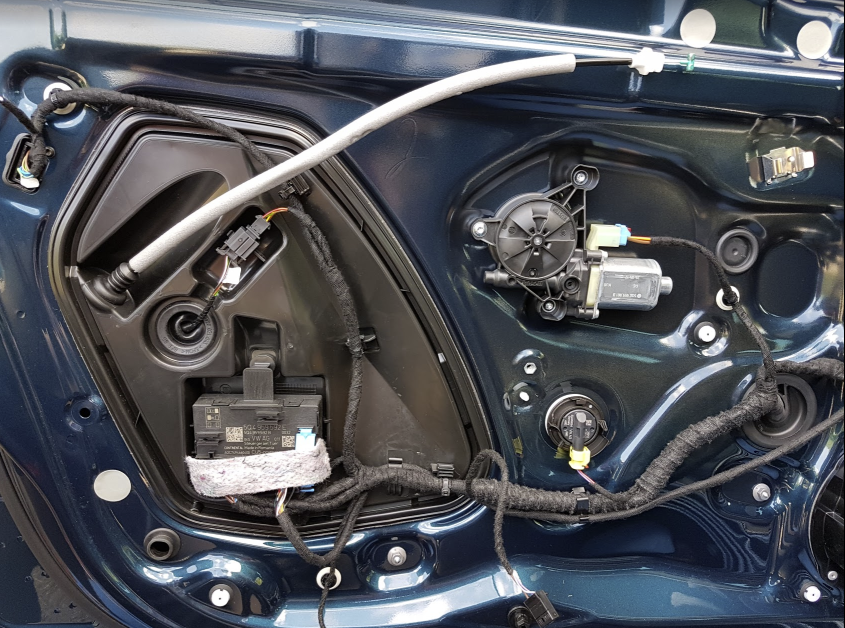

Next did the fronts.   These are a lot more difficult.  The points of concern are the 'crash clip' on the top corner of the door and the complexity of the bits inside:
In order to get the plastic cover off you need to disconnect the cable in the top left of the image, pull out the white retaining clip from the door next to it.  We unplugged the control in the plastic shown under the door release and pushed through the grommit then shuffled the foam along the door release and slid the grommit and plastic panel along.     Its difficult but gave all the access space to fully line the door.   Again on the inner skin, same principle applied to coat just enough (Its under warranty so obliterating everything in silentcoat doesnt make sense.  Anywhere that sounds hollow apply some

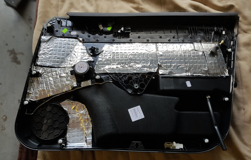

Silent coat on the facia:
Then the foam on top, noting that the top part of the door has cable issues in one corner and its close fitting at the bottom.

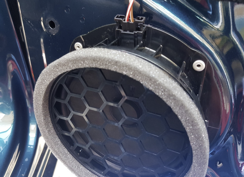

Did you put only vibration damper inside the door or also a layer of foam on top? I did add a special 10mm sound deadening closed cell foam layer on top of the vibration damper inside the door and this killed everything that was carried by air inside the door (before it was basically the door that was playing the sound, not the speakers) + the full coverage of the inner skin makes a difference since the speaker vibrations go through that part and you want to make it as solid as possible if you are looking for clear and crisp sound. Covering the door card with vibration damper is not necessary, a layer of f.ex. 10mm foam is enough - at least on my car, the card itself is quite solid and does not rattle even if I turn up the volume or drive on rough roads.
Regarding the external noise coming in through the doors - before doing the work I clearly heard the tyre noise of cars driving next to me (especially on the wet road) but now I don't hear it anymore. There probably is some still left but the main source of that noise is now the front side windows and unfortunately, I cannot stick a sheet on that :dull: I would say the most pointless part is doing the hood, this had 0 effect.

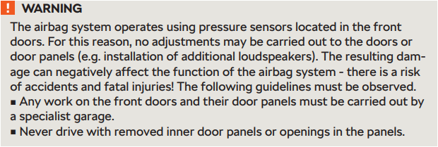

I installed anti-vibration and noise insulation mats on bonnet, doors, pillar (B I think, between rear/front doors) and trunk (just floor, didn't take it all apart yet) the noise difference is small at this stage. But the sound from speakers is MUCH better. Also closing doors feels like Audi A8.
Any how, what got me seriously worried was this warning in the manual:
What's even worse is that I did all doors without even turning off electrical system :O. I could've got airbags deployed and I wouldn't even know why! I always thought sensors are in pillars!
Any thoughts?

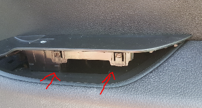

does anyone know how to remove the B-pillar covers?
Thankyou!

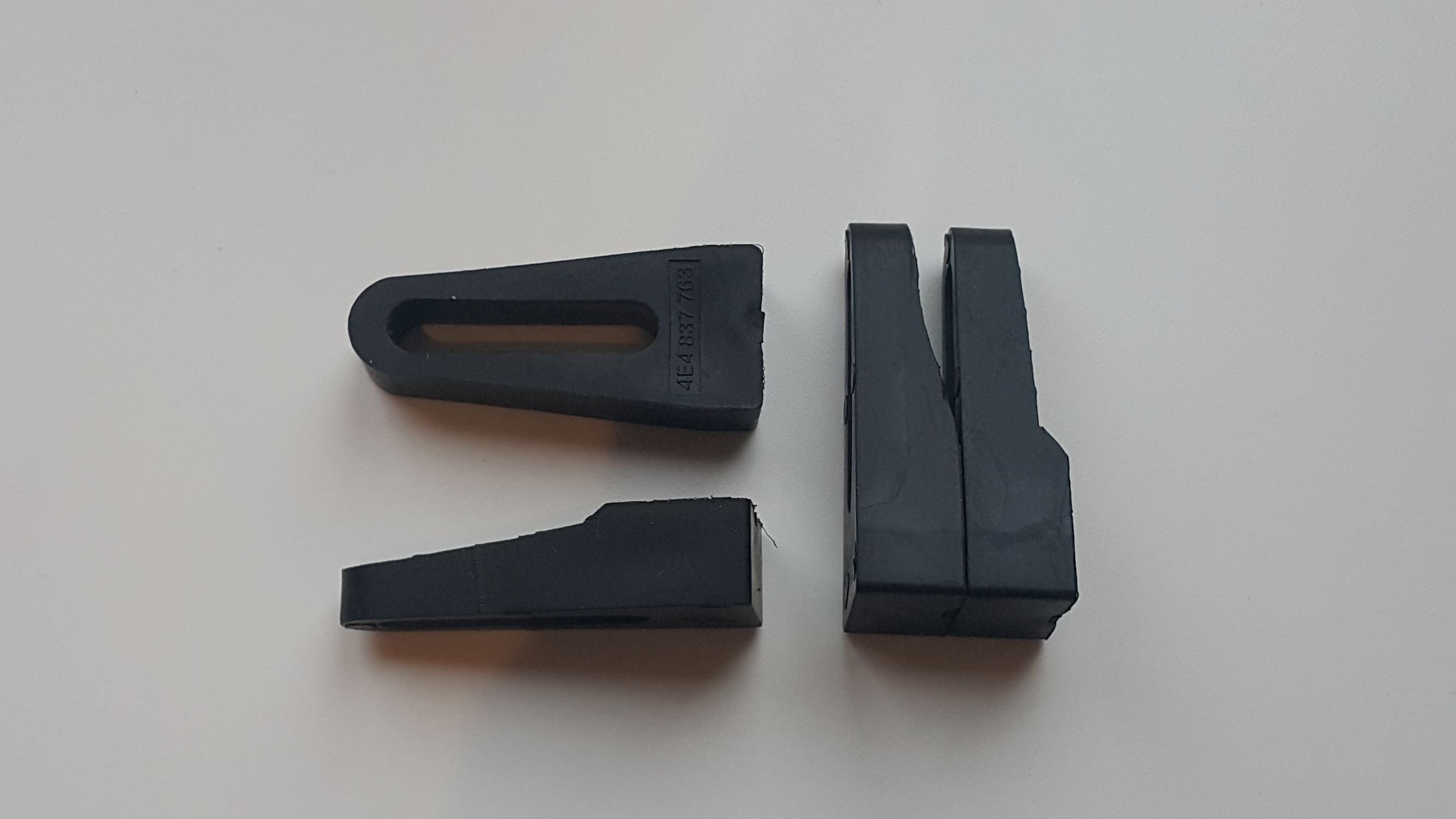

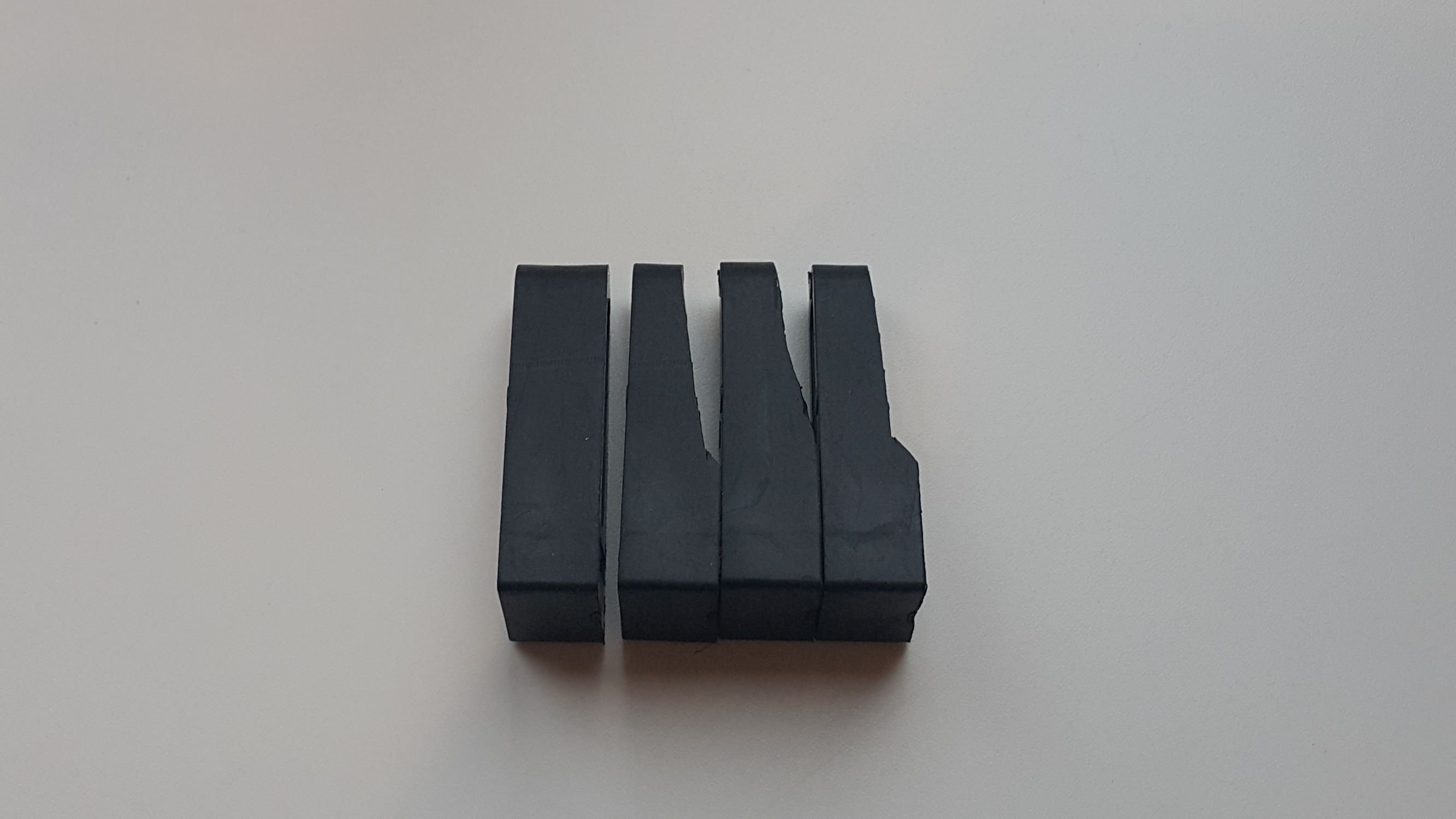

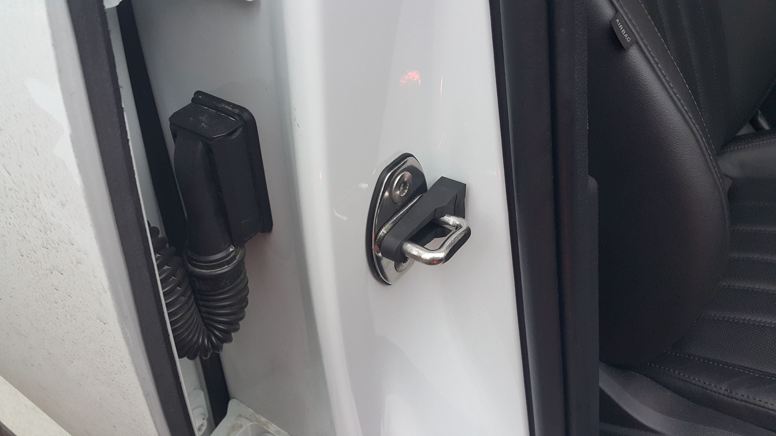

added rubber dampers of the Audi A8
4E4 837 763
4AE_837_763_2_4MP.thumb.jpg.966bdcd416459ce5f7bbe180fb3d851a.jpg 4AE_837_763_3_4MP.thumb.jpg.4bc2d0831b296078d33dd1df57ba8a5f.jpg
What do those rubber dampnera do?
They upgrade his car to an Audi A8, obviously!
prevent dancing of doors
Wouldn't turning off the music do the same?
:music::ninja::happy:
Does it actually help? What sort of difference do you expect/did you get? Less noise?
