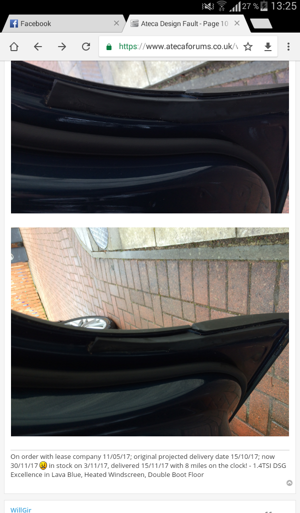

Cleared out these seals on my car yesterday using a small paint brush and flushing them out with water. Really poor design, but worth keeping on top of if you intend keeping the car for any length of time as these well may end up rotting the door edges. The bottom edge of the door isn't much better where there is a small bit of plastic with a drain slot built in, yet another dirt trap which collects bits of grit etc.
Found this on a seat ateca forum.

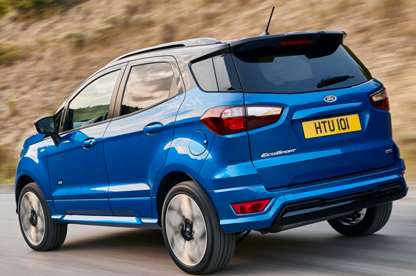

work colleague has just purchased new ford ecosport , it has and extra plastic piece under rear arch (just visible in photo) that i think alleviates this issue of dirt build up, will get an actual proper picture when he has car in work next  , might be worth seeing if its something that could be fabricated to fit the Karoq ???
That car wont have the problem, the back door isnt part of the wheel arch like a Karoq.
On 12/06/2018 at 13:49, fabman said:
...will get an actual proper picture when he has car in work next...
No offense to your mate but the less we see an EcoSport the better. Apart from it's challenging looks, Ford can't even design the whole rear door properly farless a seal.
 no offence taken "Mate" , simply making an observation :blush
