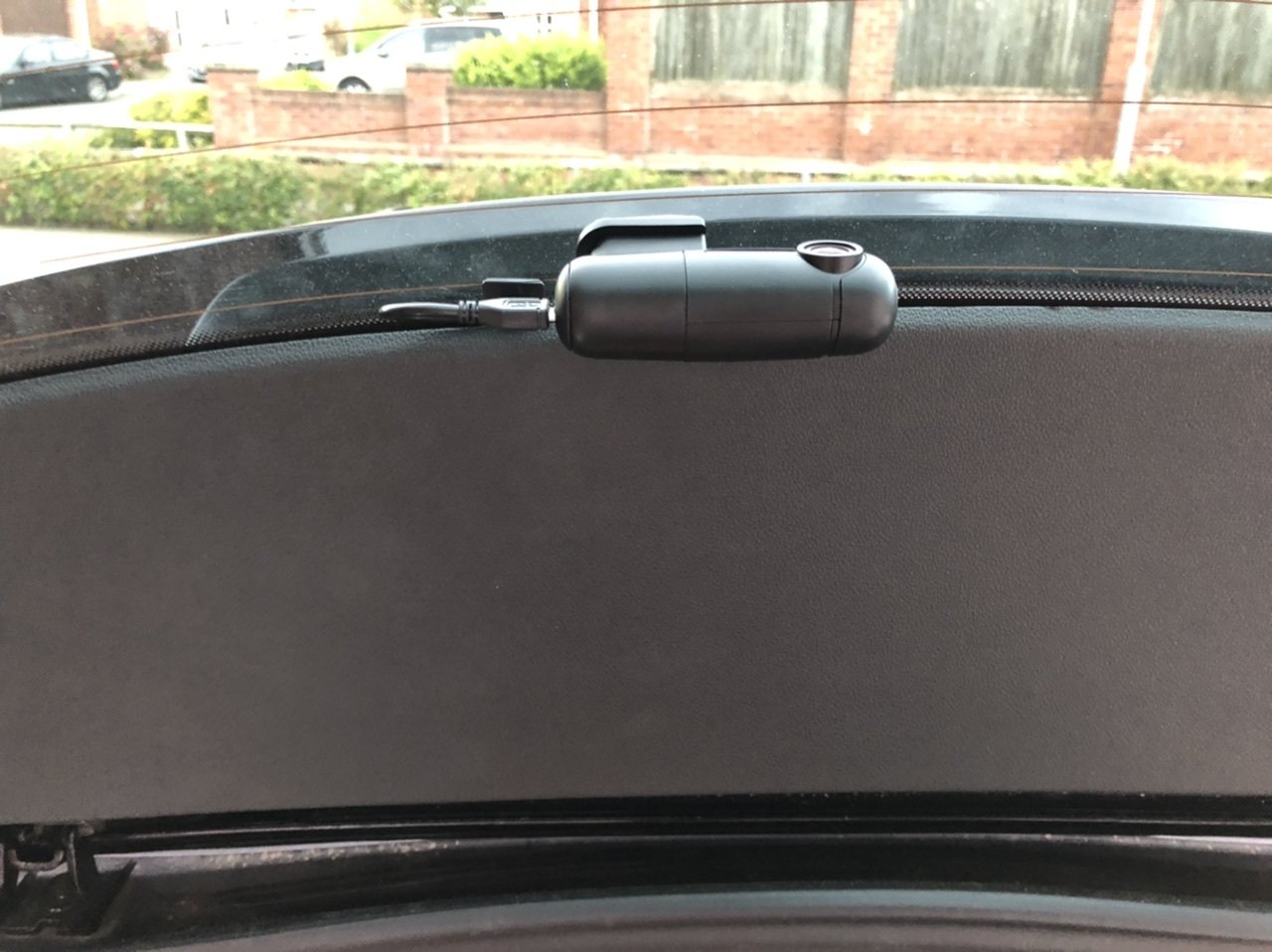

I have now fitted a dash cam at the rear, thin neodymium magnet under the head lining and another magnet glued to camera mount, saves sticking camera to the rear window.

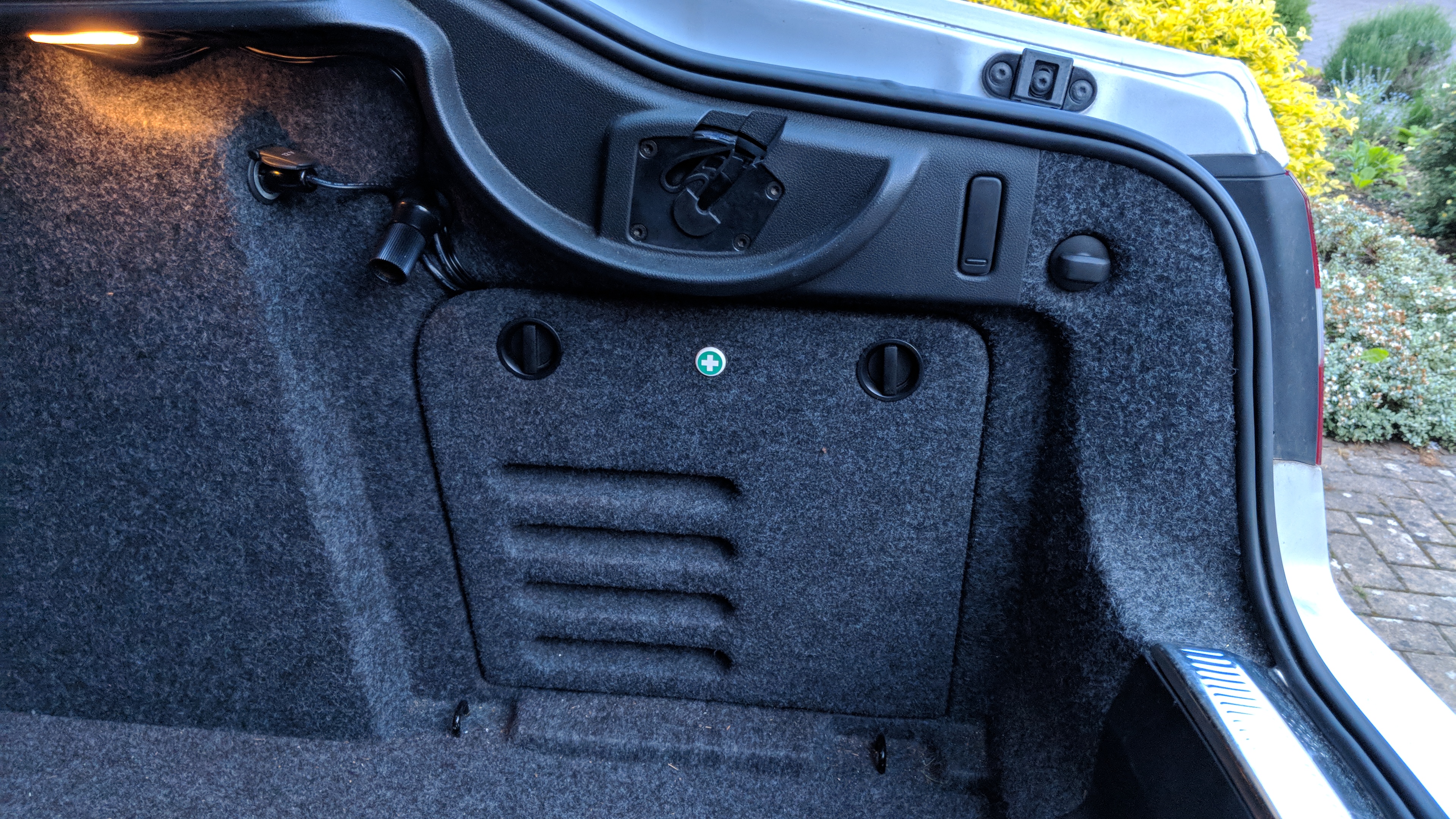

Routed power cable round under the tailgate seal to the 12v socket plugged in all works fine. But this is the first car I have owned where the 12v/cig lighter socket is permanently live.
Forgot to unplug twice now and battery dead after a few days parked.

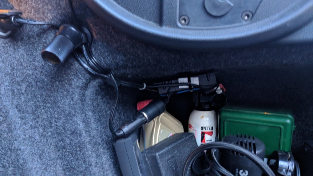

I have a split charge relay PCT Volton ZR1220 with a 12V plug on the input(plugged into the boot 12V socket)  an a couple of 12V sockets on the output
that run a dash-cam and a cool-box when I have it in the boot. Works a treat. I've cable-tied it into one of the boot side cubbys. Basically when I start the car the dash cam and cool-box (when in the boot!) turn on within a few seconds and when the engine turns off they turn off a few seconds later. I suppose the only potential issue is they turn off when stop/start also turns the engine off

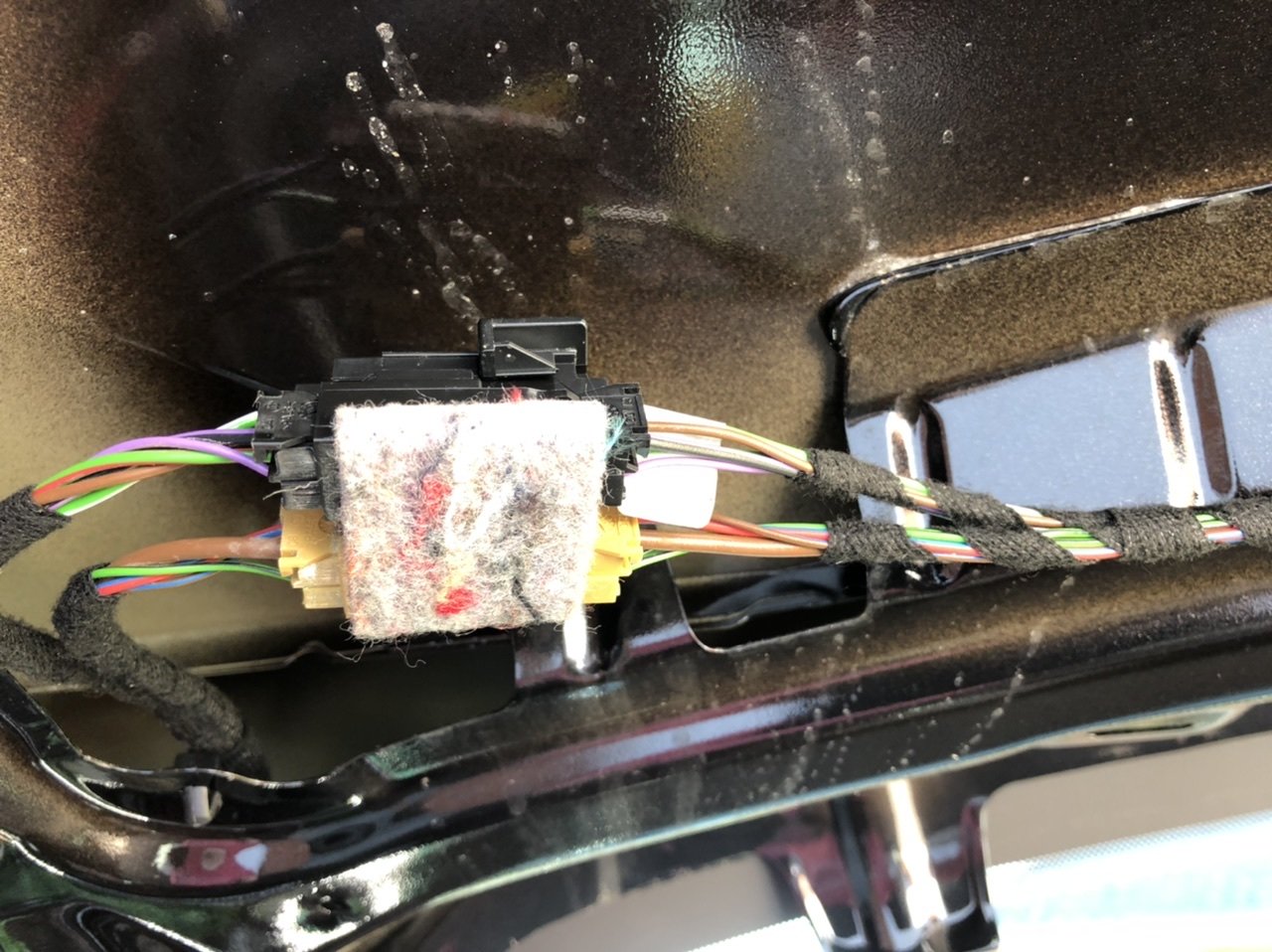

Photos attached (Superb II twin door installation)
Rear Wiper Motor has a Switched 12v supply for Self-Parking of the Motor.
Hi.....I've also got a dashcam that I'm wanting to fit in the rear window but having trouble feeding the wiring behind the window trim.  Your idea of using the magnet sounds interesting.  Not sure which dashcam you're using.  Given that it is a very strong magnet, just wondering if it has any detrimental effect to the operation of the dashcam.

The rear camera is a MIO 538 and is unaffected by the magnets.

thought I’d add that I’ve done Mine and tapped into the power to wiper motor.
black and purple, earthed to nut for lock mechanism.
all working.
