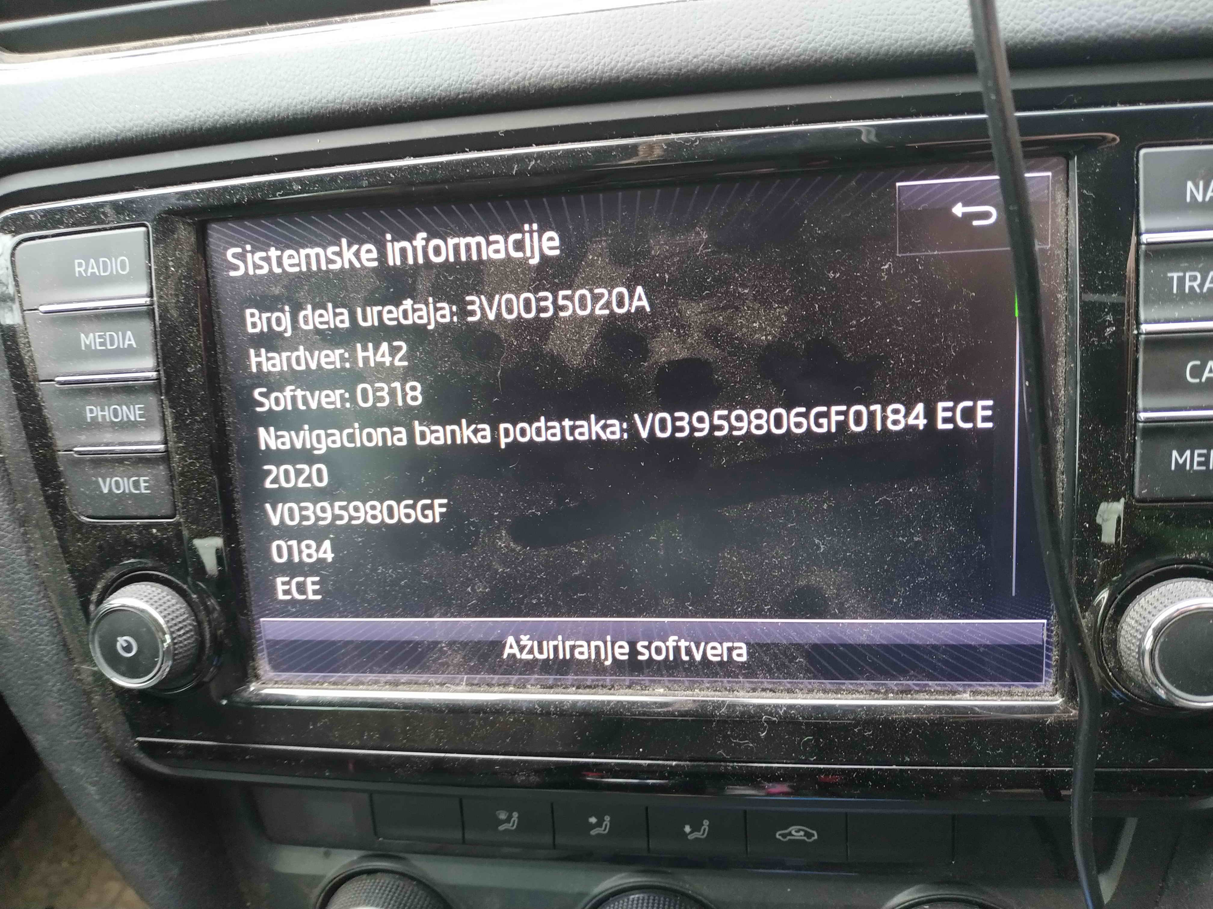

On this link:
http://updateportal.skoda-auto.com/?appVIN=&appLanguage=en-GB
you just have to enter your VIN, and direct download any updates for your Columbus. Mine is Octavia 2015. It worked for me. Radio logos and Map update 2020. It take, in my case, ~5hr to download map package (25Gb) from Skoda, and cca half an hour to upload them on car.
