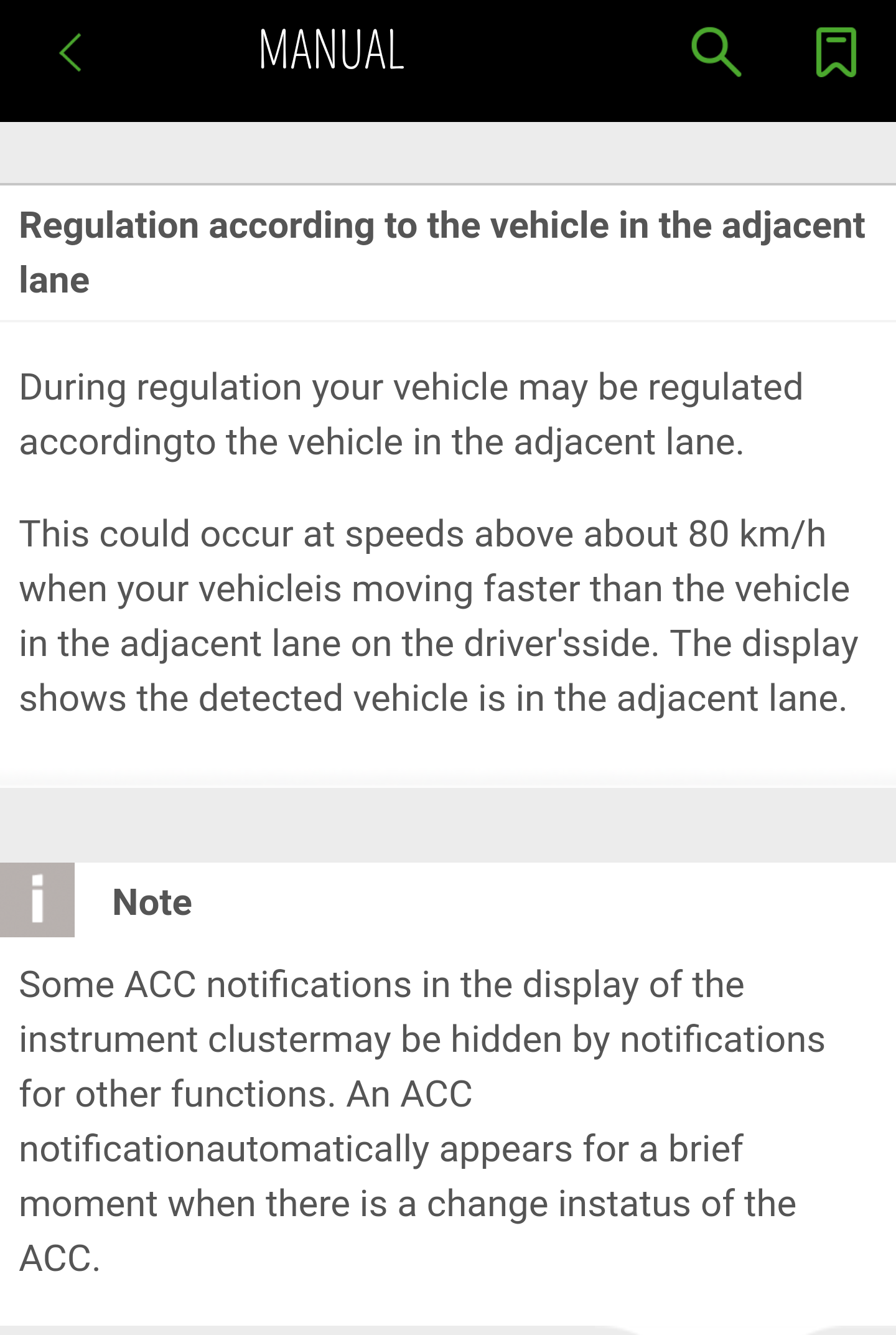

It is a normal feature of the ACC to slow down to match the speed of a vehicle in right lane for RHD, and left lane for LHD.
It's a stupid law thingy. Sh1tty and annoying feature of the ACC.
It's there in the manual too.
U can override it by tapping the accelerator so it ignores the car.
Sadly u gotta do this each time u approach a slow moving car in the adjacent lane.

The 'no undertaking' part of the ACC can also be overridden by briefly pulling the ACC stalk towards you.

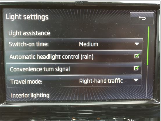

The only setting I found to change "left" or "right" is under lights section of car setup... Attached picture ---
can you/anyone confirm if this is the one needs to be changed? or I am missing something obvious here?
That’s the one.

Ok, well then it was set to left-hand traffic till now - now i have changed it to right-hand traffic.
BUT - same behavior... :crying:
It should be on left hand traffic.

Erm, don't you guys have left hand traffic in the UK ..... ? If so, why would you switch it to right-hand?
But about ACC, I don't recall needing to push the accelerator too far. Will try today:D
Yes, it is left hand traffic in UK and so the setting was set to Left Hand however just to test if any different it makes or not - i changed it to right hand traffic - but nope - it still dont overtake the car on left lane on motorway or dual carriage way.
