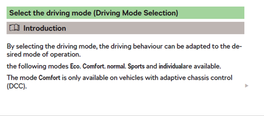

According to my manual (2017 so may not be applicable) Comfort is only available on cars with DCC. So if you have comfort setting you have DCC. Otherwise you don't.

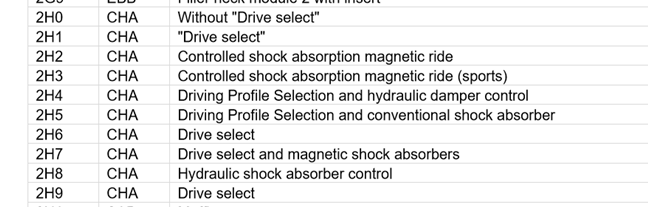

The drive mode feature codes are 2H* (where * is a number). I believe (though happy to be corrected) the code for DCC is 2H4.
You should find the code for what you have fitted in the spec sheet or on a paper sticker in the boot.

Just because it has drive mode selection, Sport/normal/comfort doesn't automatically mean it has DCC. Needs also to check DCC settings are active as in above pics.
