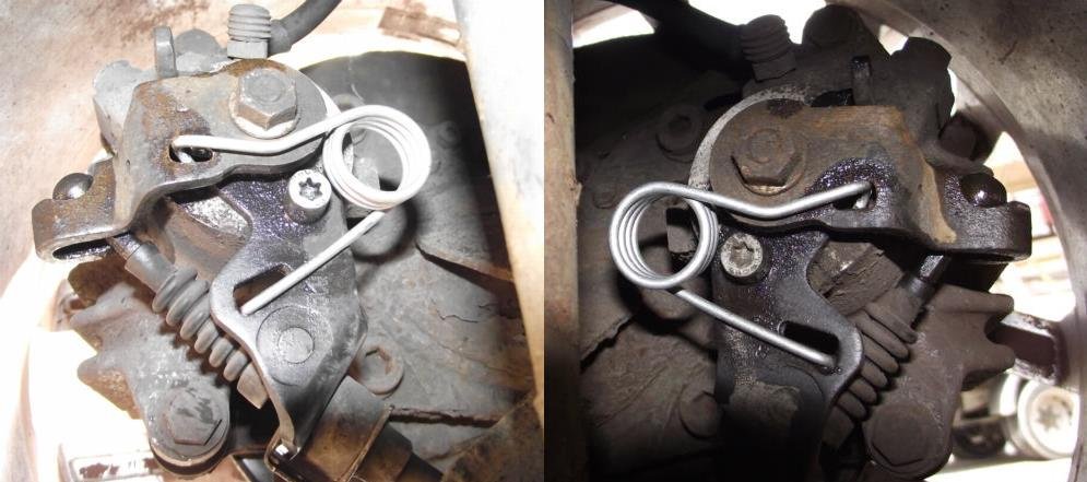

They arrived this morning and took 10 mins to fit. (Grip the lower straight loop end with mole wrench, insert top bent loop and just twist lower end into place.)
Edited by LB123
My old VRS did this. Fitted the above. Never went away. Fitted a new calliper. Never went way.  Changed handbrake cable. Never went away. Flogged it.
Mine look different to these,not absolutely sure but I reckon they need changing side to side,the offset on the spring should match the offset on the two levers I think.
       Maccy.
they look correctly installed
I'm sure they're correctly installed. The shape of the hooked ends match their current holes. The through arm parts of the springs sit nicely and naturally in the correct part of the roughly L shaped slots in the arms. There is no tendency for them to come out of place. They sit 'out of the way'. They just look right. That's how they're staying!
Well the “cranked” section is needed to clear that fixing, after that being taken into consideration, there is not much scope for fitting them wrongly or to the wrong side, maybe I was lucky first time round and bought a pair individually bagged and tagged, okay for another version of car, but using logic I got them fitted that in time seemed to agree with other’s way of doing this. With my wife’s new Polo, it was just a case of refreshing my brain by looking at saved pictures and doing the same again, only this time with the later Polo not having rear brake pad wear sensors, there was no need to move that cable out of the way!
