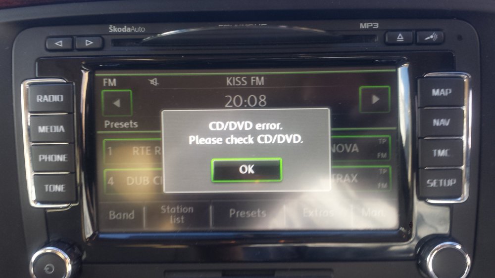

Picked up my 2013 Mk2 Elegance, a nice upgrade from my old Mazda6. But the Columbus system has me stumped. I tried to put in a cd, it takes it, stays in for about 15 seconds and then says CD/DVD Error, Please check CD/DVD. And then ejects the disk. I've tried cds, dvds and cds with MP3 files and the same every time.
Any advice on what might be going on?

Could be an issue with the lens or laser in the disk drive. How does it fare with music on an SD card?

As regards the CD/DVD error, most likely a faulty drive in the unit, although it might be an issue with the radio board or the ribbon cable connecting it to the drive.

Try a good CD/DVD lens cleaner first (Hama or similar)

I agree with vborovic.  I had a similar problem which a conventional CD player cleaner solved easily.
By the way, I love the fact that the opening photo displays KISS FM as the current station ... I hope its not a message from the unit "Kiss your FM goodbye" ... :rofl:
