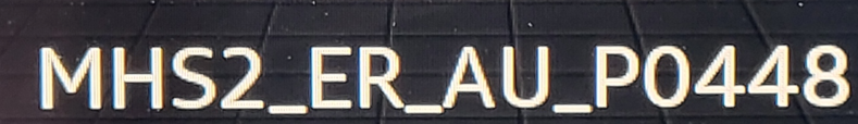

Hello,
It's the first I download the Columbus Update, before I was using another MAP files provided but someone else , but I've lost contact with him.
When I compare my SD card folder with Columbus archive content, it's not the same structure.
So I'm confused it will work ?
Thank you for your help
my SD Card
My current software version
Columbus content

Thats an Audi unit based on
https://mib-helper.com/index.php?train=MHS2_ER_AU_P0448#details
A MIB2 High Scale whatever that is.
Wiki:
https://wiki-online.vcds.de/de/Plattformen/MIB
Not a mib2 high as we know it.
Not come across those before.... does it look like this:
https://www.audi-mib.bg/audi-delphi-mhs2-scale-map-activation-2021/
Reckon you need an Audi forum / trawl Russian websites for knock offs... Audi map were sold with mapcare so were never free. FeC can be adjusted so maps for Skoda and VW etc can be used but whether they were fitted to those cars... least not. So a nitch unit. You might find they have fallen off the back of an annual generation or may be not. If not ebay may be a source for a map card.

Your best bet is an Audi forum. Your unit / file still needs to be patched hence the need for an Audi forum where people are familiar with the process... Your man that you have lost.

Hello,
Thank you for your help.
I know that the FEC has already been activated and the VIM also.
So I need to find the GPS map data.
I will take my chance in another place ;)
Thanks and have nice dat

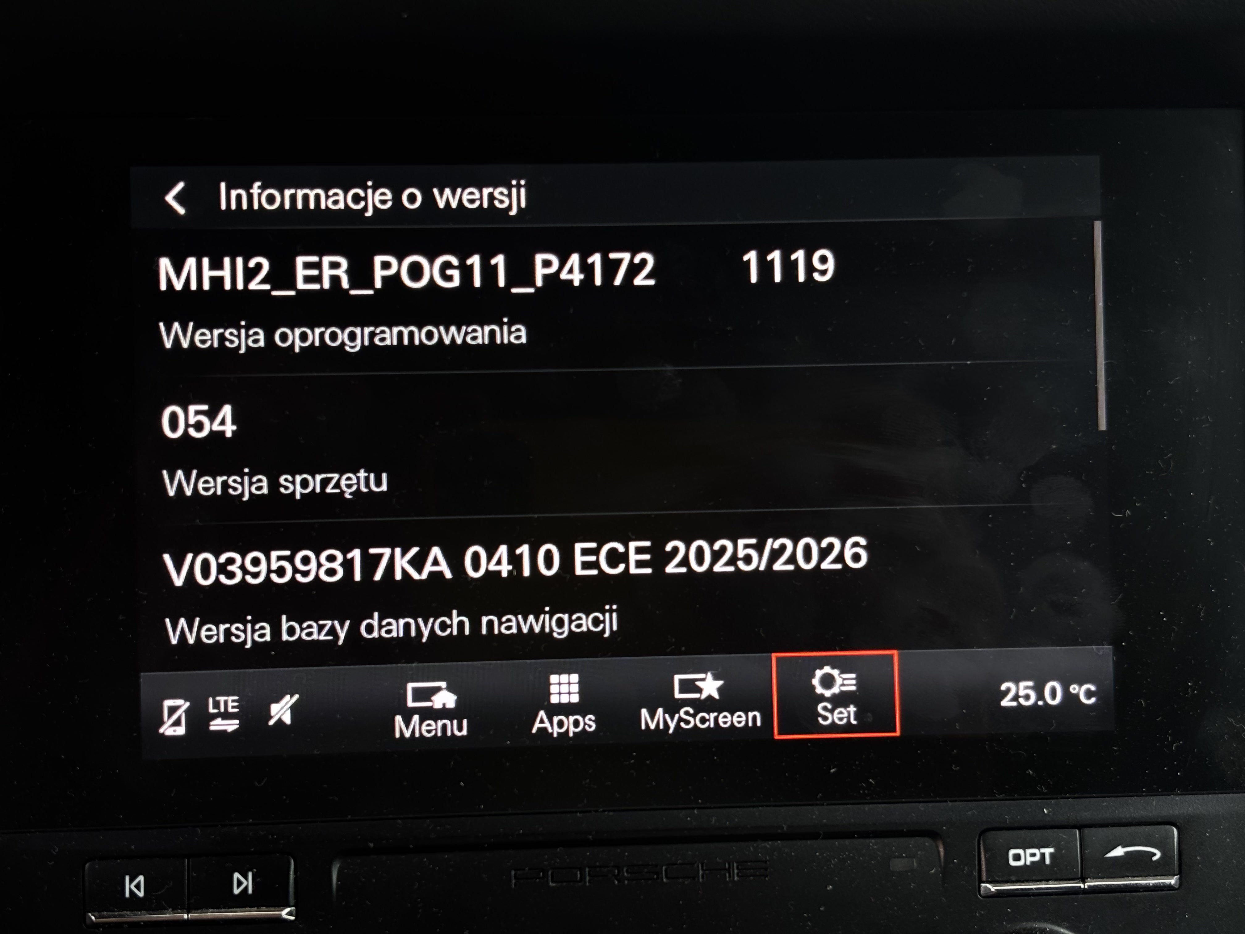

Confirming that it works on Porsche PCM4.0 as expected.
