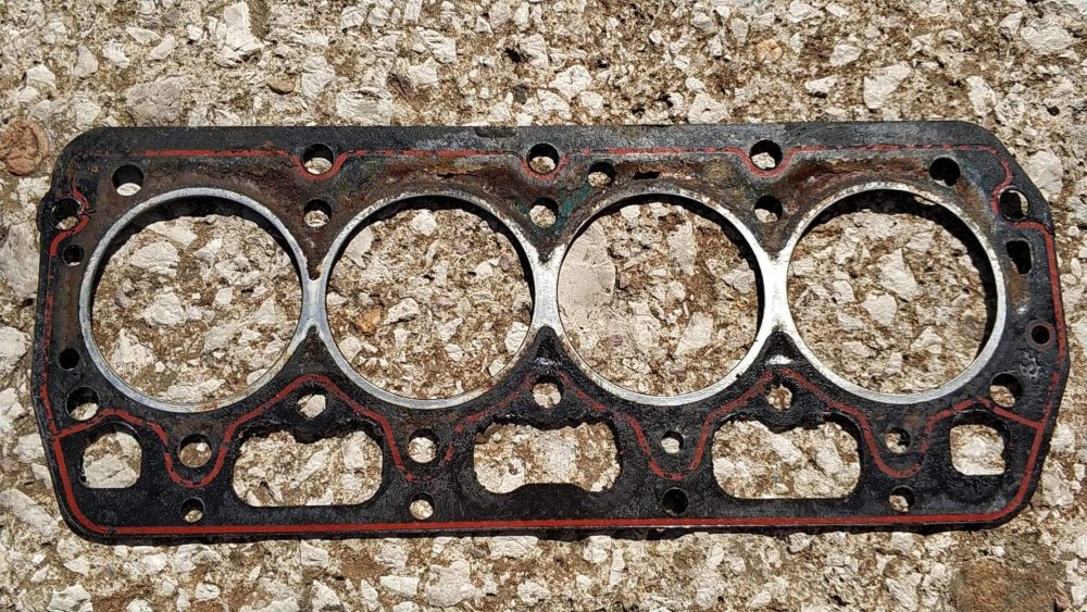

So, I had the lack of idea, what to do. I bought new head gasket (old one was in bad shape, rusty), skimmed head 0.2 mm and folded it back.
Well, it was a problem! For today, my car runs easily above 140 kmph and it hasn't any cooling problem despite of hot weather in Poland (about 35-37 degrees).

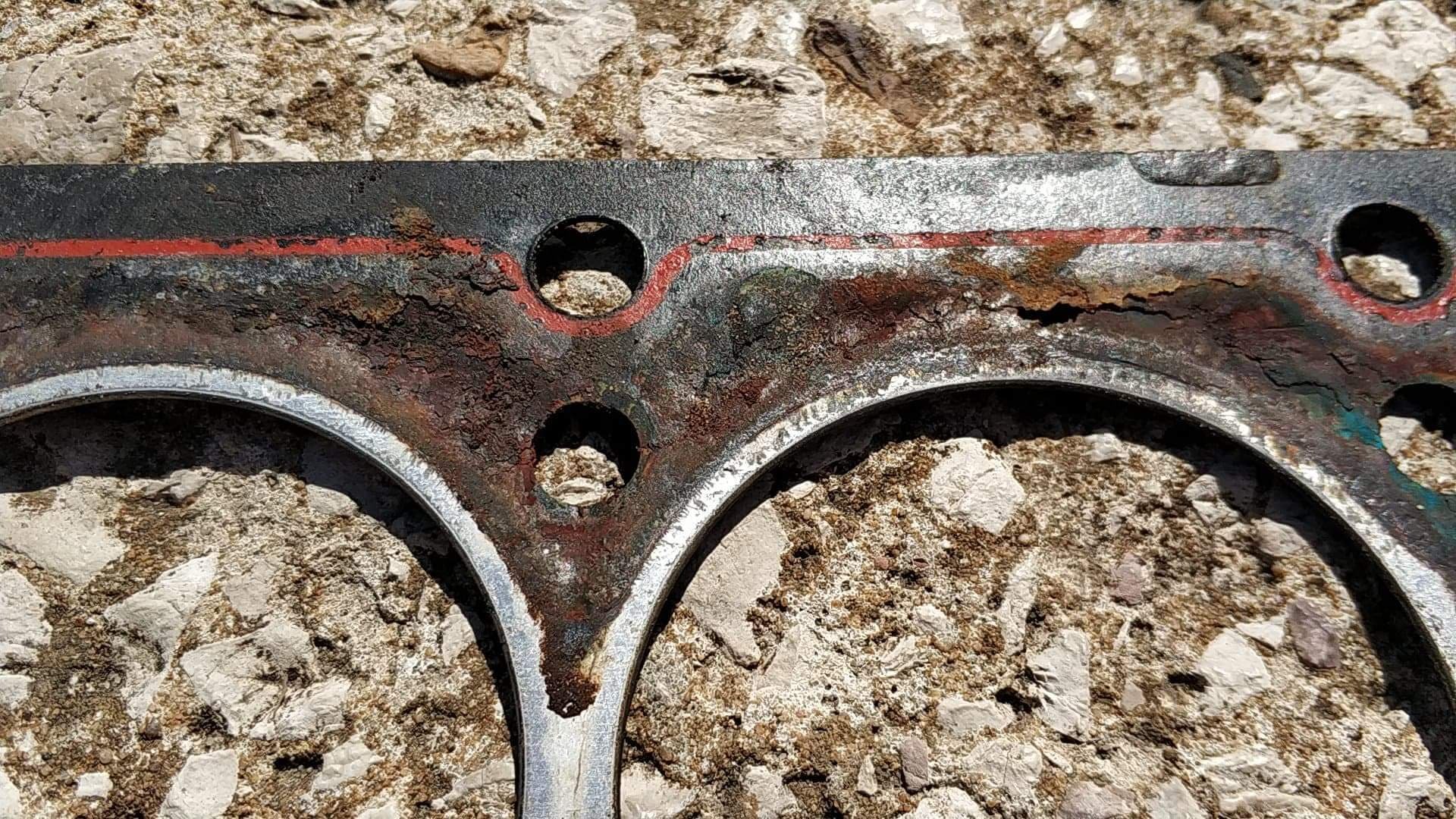

Here is a test question. What "tells" you the old head gasket and the cylinder head itself? Any clues related to overheating?

About head gasket - it's common failur, including symptoms. Oil/water mixing occurs in later phases.
I had same failure on same cylinder - one closest to water pump. Have you checked if liners have right nip clearance (hope it's right term)? In my case it was somehow smaller on cylinder, which leaked, but after 50k km it still seems working properly.
You were lucky that head material was intact - corrosion caused by bad coolant is common.

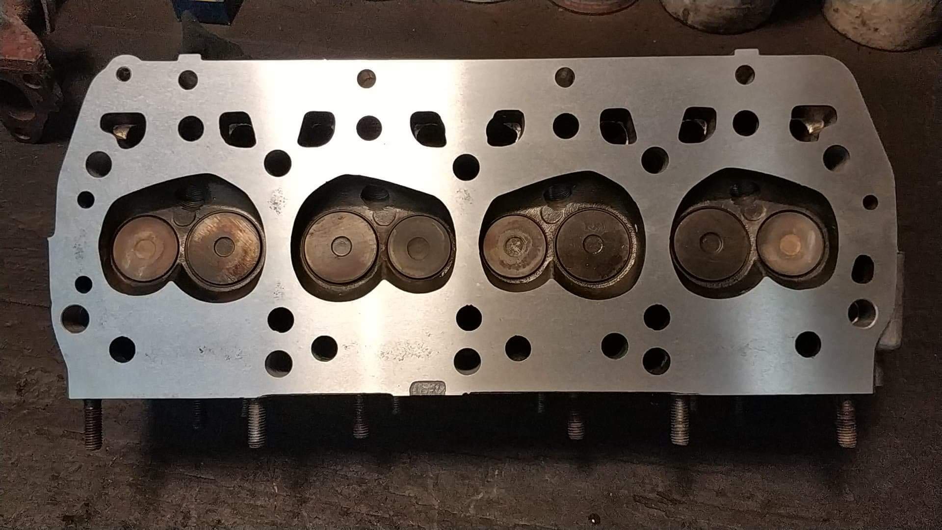

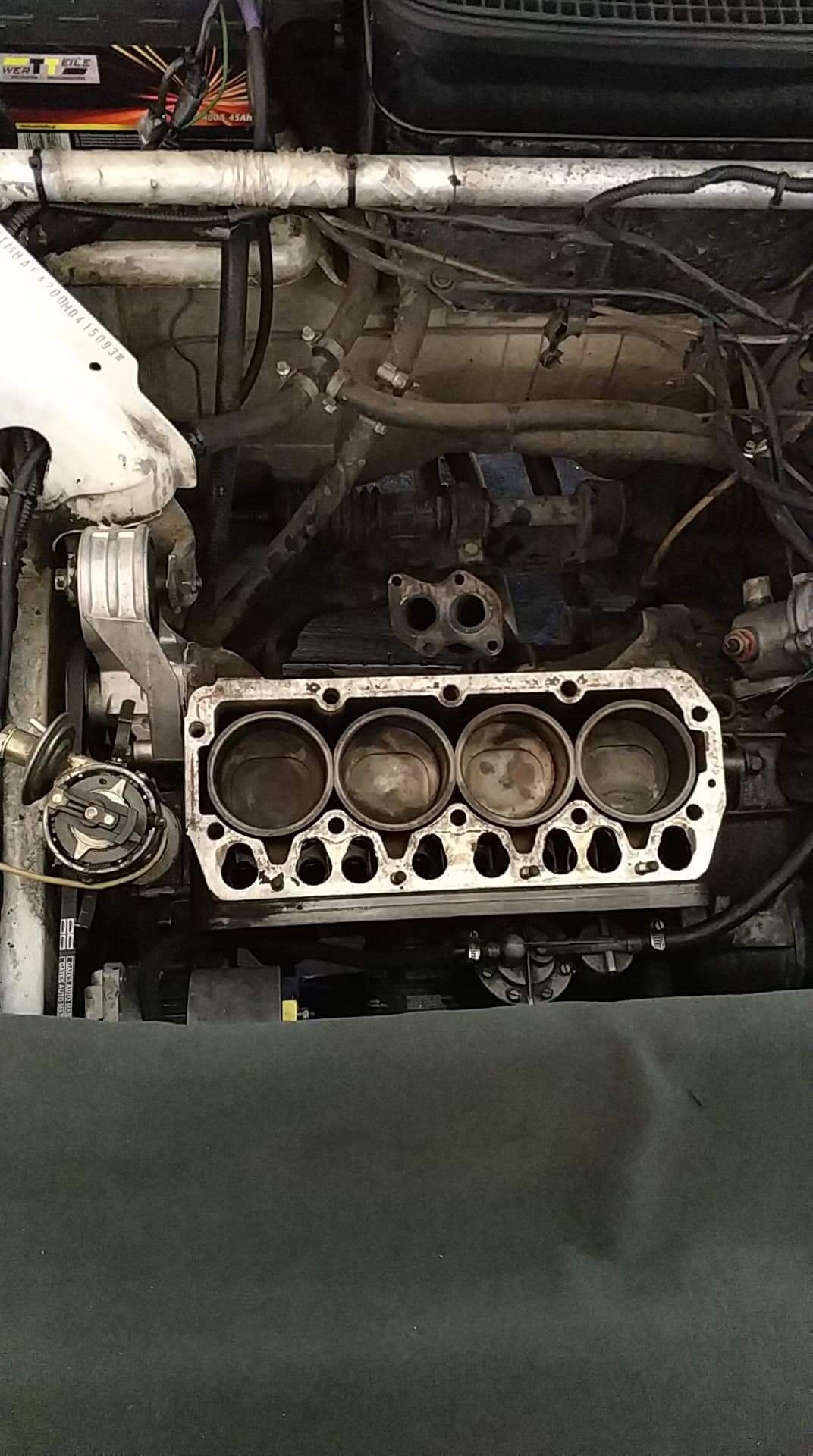

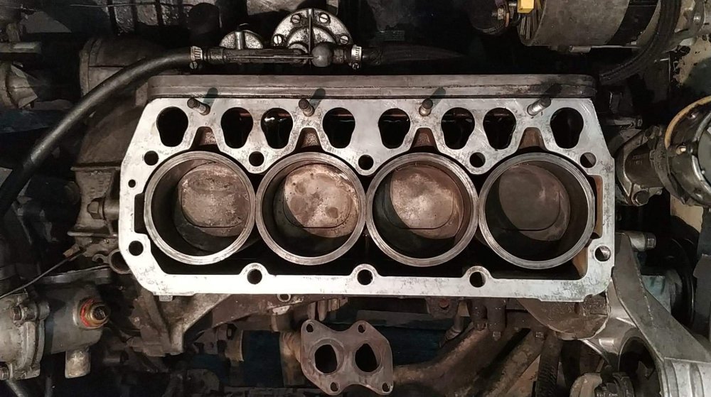

I haven't any clues related to overheating, so I tried to repair everything about coolant system without touching the head gasket, my mechanic said that it is impossible that I have a heat gasket failure, because my Favorit had right compression ratio and there was no visible fumes from exhaust, also the oil was in great shape. Fortunately, after head gasket repair, Skoda stopped overheating. For sure it will be pleasure for my car that it has a new radiator and fluid :D I was really happy when I saw head and all engine without damages from Fridex coolant. So, I have three more photos with parts of engine.

Well, your mechanic should learn that a head gasket failure could start with a very small crack between coolant passages and combustion chambers. It is not always an explosive failure like we see at car rallies. That might escape to a compression test (not compression ratio, which is a constant). The definitive test is a cylinder leak down test.

So far I had 2 failures, once between 2nd and 3rd cylinder, once near 1st cylinder and first symptom in both cases was overpresure in cooling system with some overheating. No missi g coolant, no fumes or oil degradation. So I think that this "impossible" thing is more like rule for Skoda engines.
Most of gasses get into coolant circuit during higher loads (once one of my cooling hoses exploded after short full-throttle ride)
Compression pressure test won't show anything in this phase, since pressure in combustion chamber during expansion is much higher than during compression.
