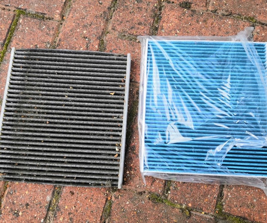

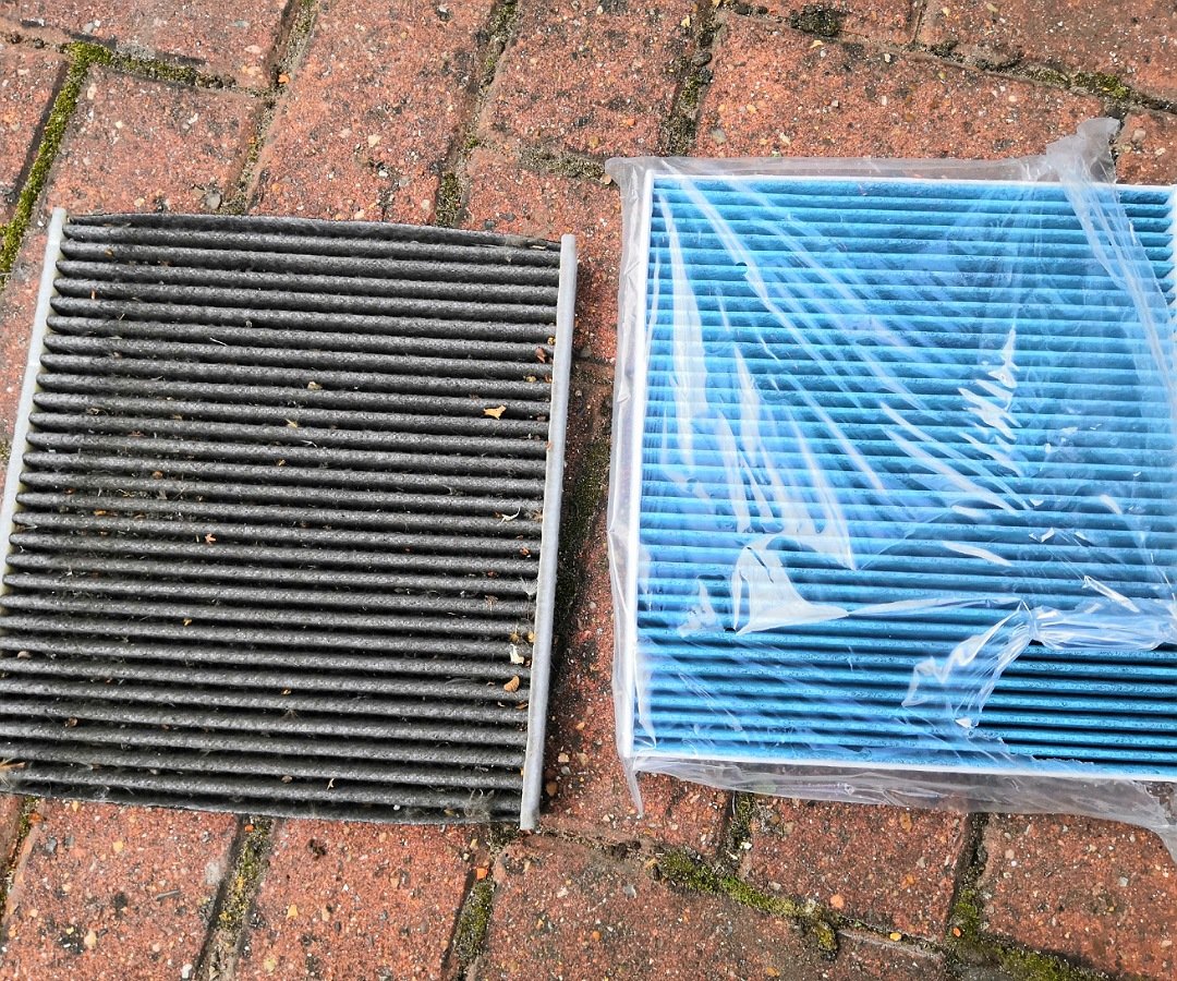

 Replaced cabin filter, I think this is the first time it has been replaced in its 20k mile life. Manky...

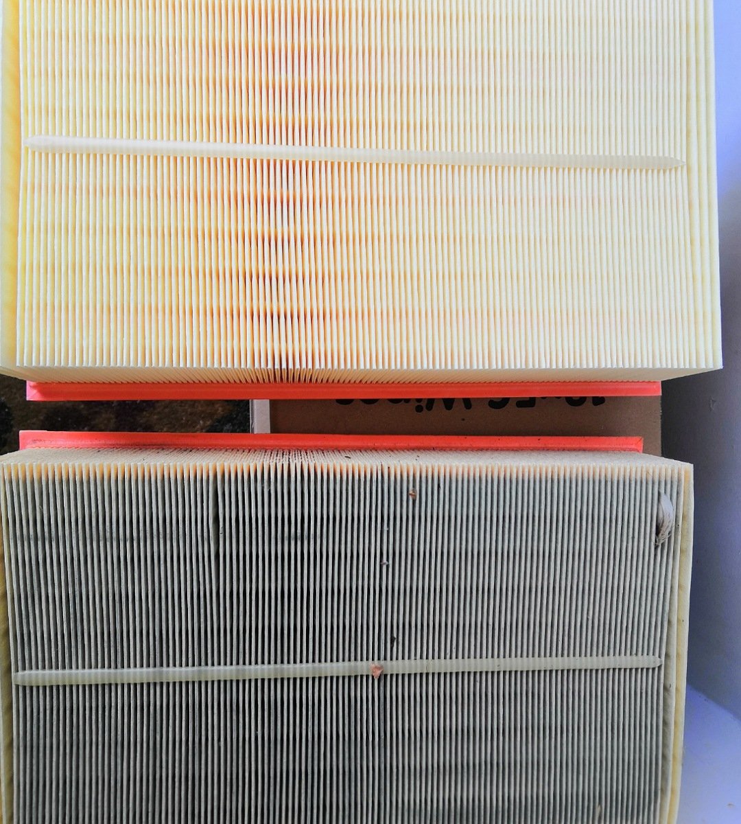

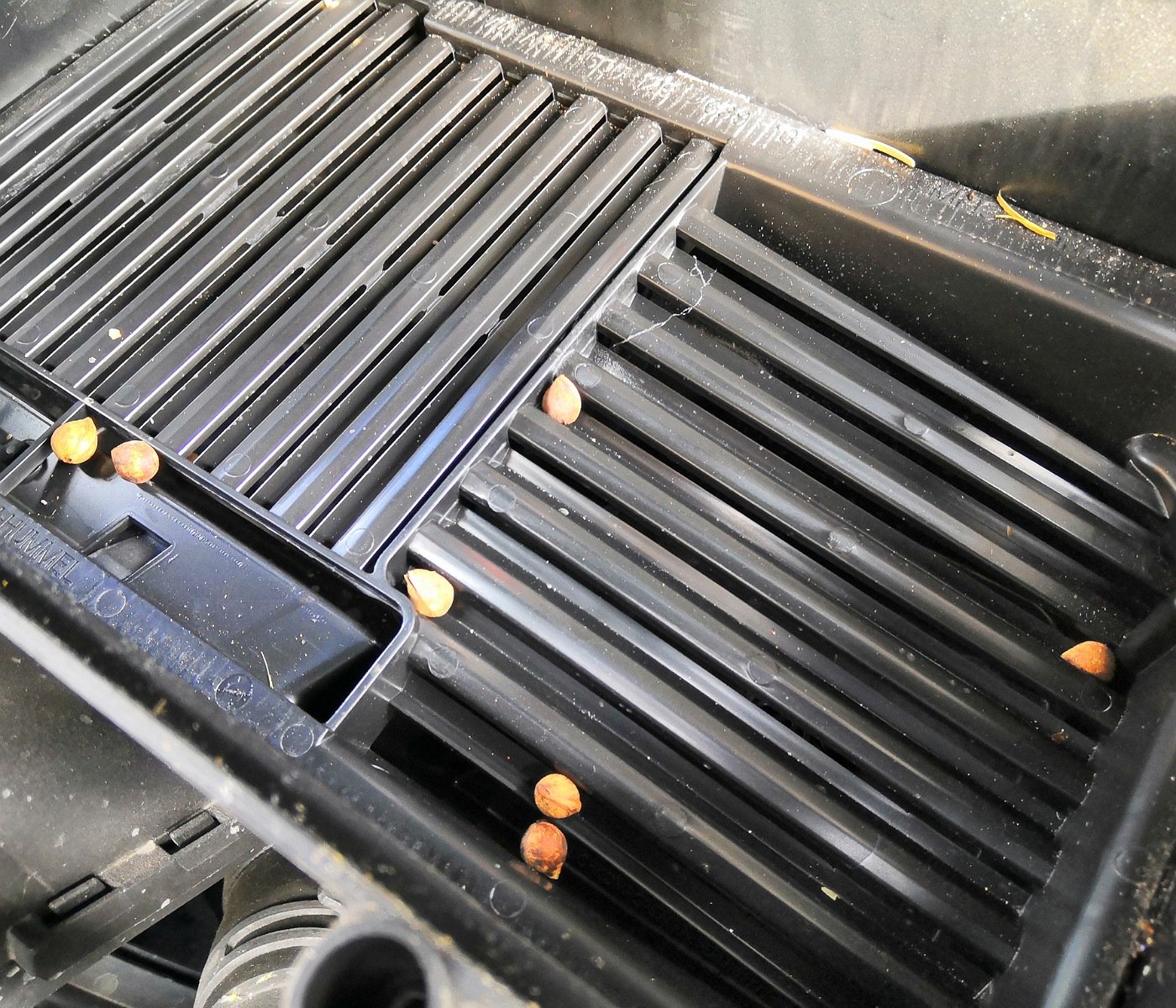

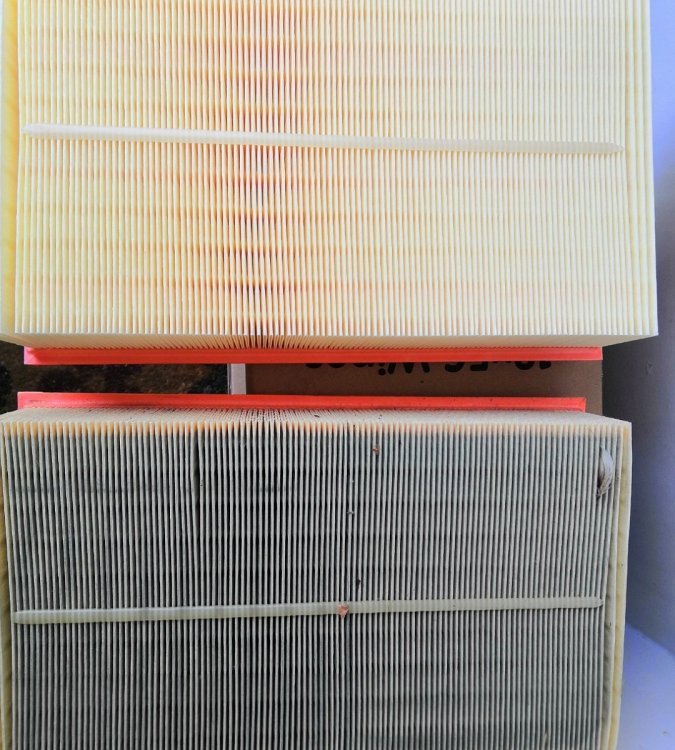

Replaced air filter, cleaned up some foreign objects blocking the turning vanes in the intake. Probably gained 5hp now... Lol

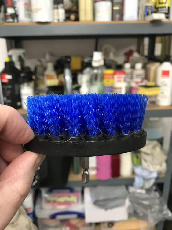

1 hour ago, UndertheRadar said:
Try some APC with a drill fitted carpet brush and if needed steam it first if you can.

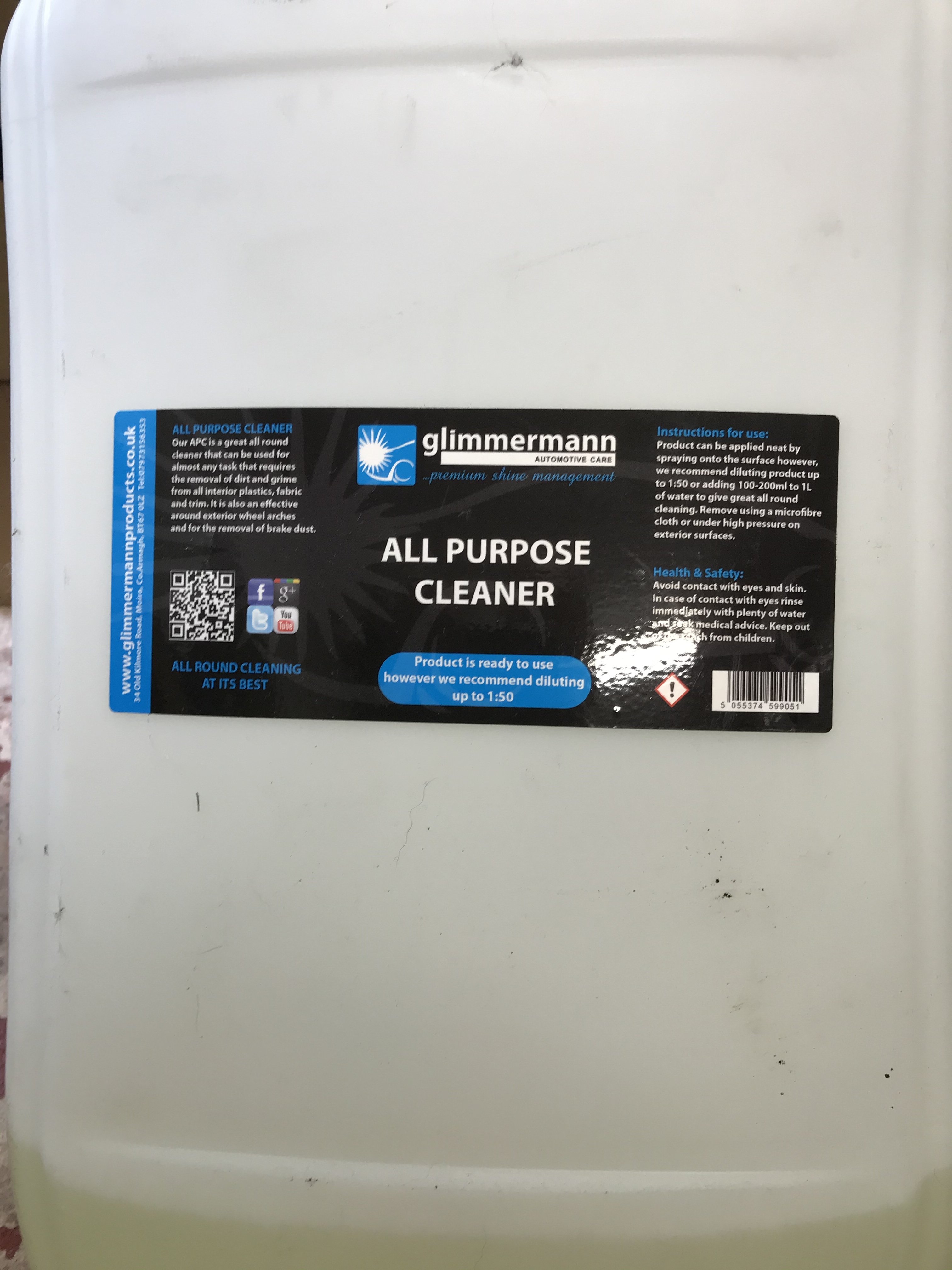

I use this one as it’s cheaper to buy in the long run, but there are many different ones from the likes of meguiars or valet pro etc as well.
just realised you can’t tell, but that’s a 20 litre drum. Makes the above easier to understand.

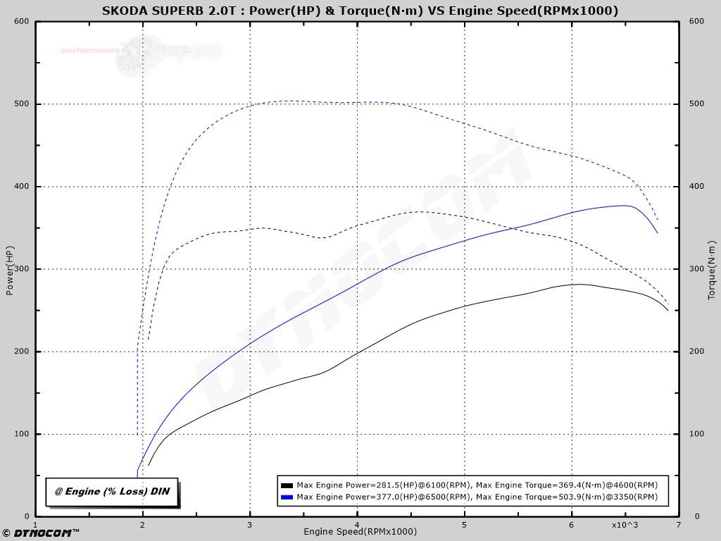

I’m pleased with the results 👌 Custom Stage 1 tune by a local company.
Assuming that was a 280?
Well the later 272 with gpf

Your standard engine was very similar to my figures of 283bhp and 369nm.:)

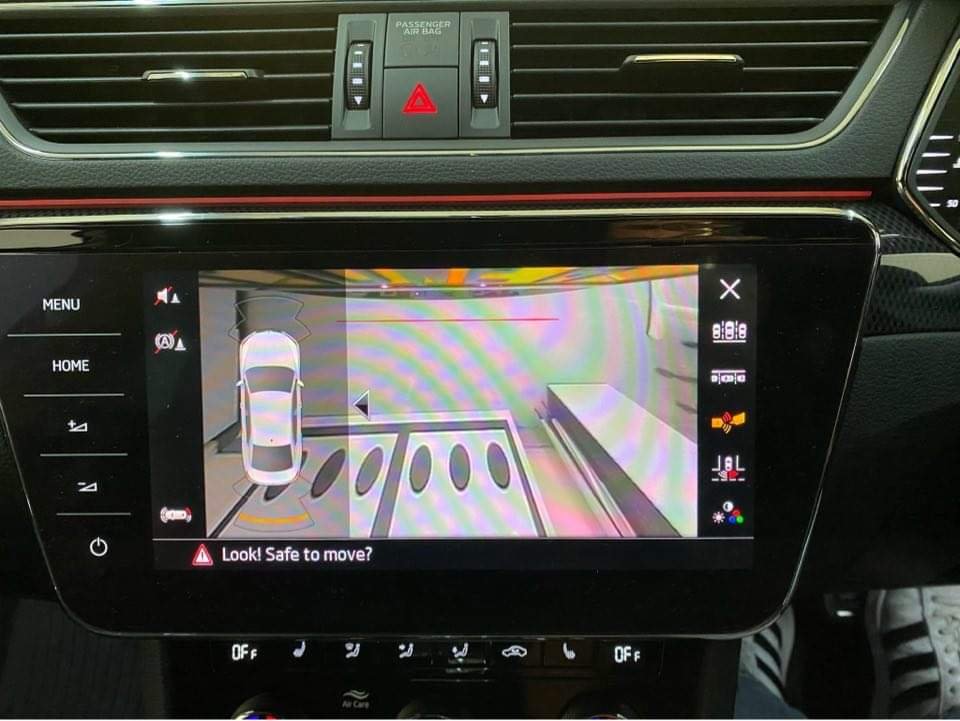

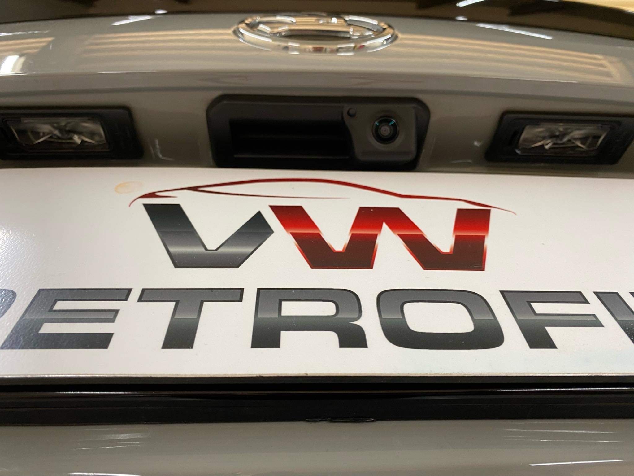

Busy week this week, car has been in the workshop again today for some more work....theirs numerous threads regards retrofit of the rear view camera but i wasn't confident enough to buy the kit and give it a go myself like some have so i took it to a local guy and in under 2 hours i was on my way home and another box ticked
@lowey how much did they charge as I see you are fairly local to me and a job I would like doing sooner rather than later?
 Just down the M42 junction 2 in Redditch : https://www.vw-retrofit.co.uk/
cost me £380 inc
2 hours ago, lowey said:
 cost me £380 inc
Good price. I bought mine from TPS, fitted it myself, and got Skoda to code and calibrate. Cost me about £350 all in. Plus the best part of a day of agro for me and a mate! (Having not done it before it took a lot longer than it should have. Learning how to to overcome problems etc).
You definitely made the right decision. £30 for no agro!
