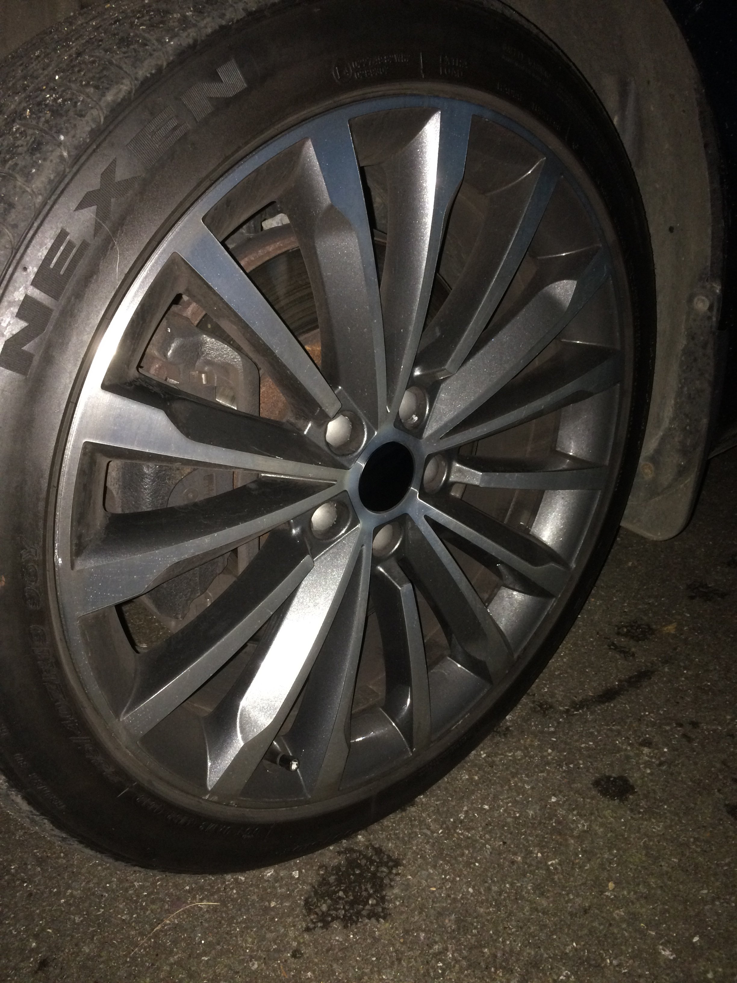

    Had the wheels refurb'd... and new centre caps and new tyres all round. Much much nicerer. Before and after

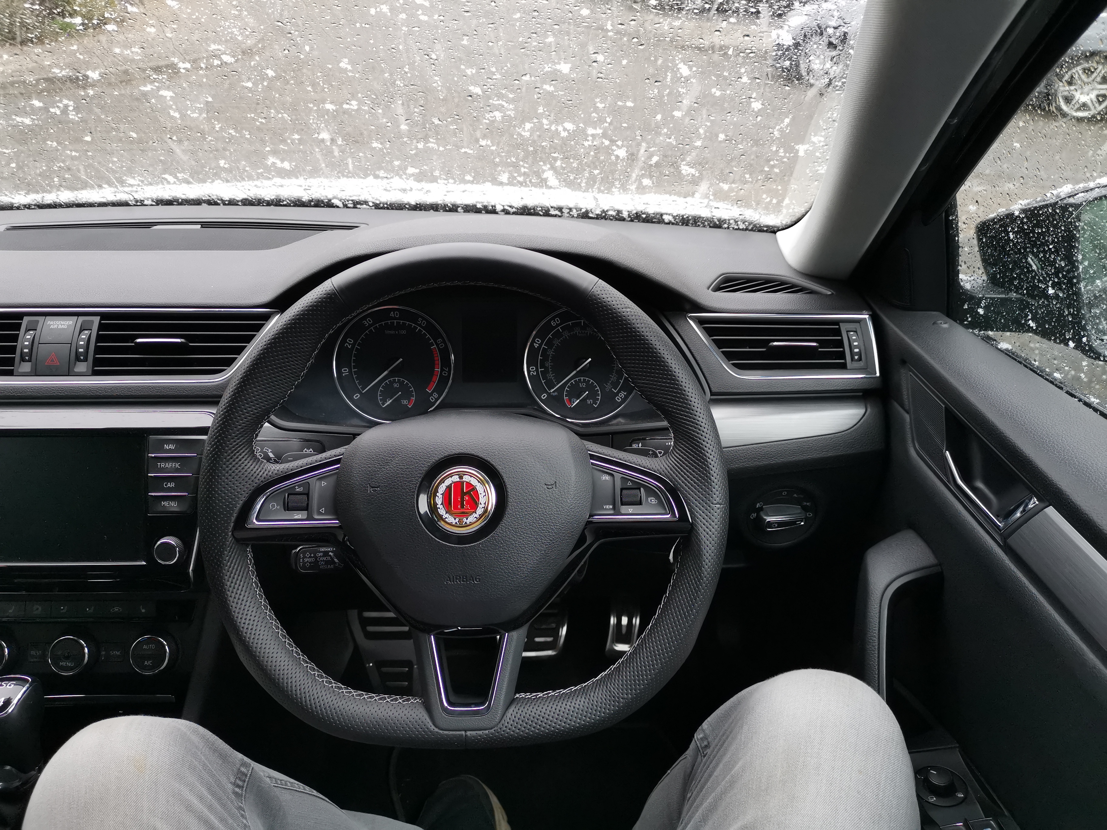

So I'm planning a virtual cockpit retrofit and wanted to start gathering parts. I read that to do it right, you should have a view button on the steering wheel. But why pay £70+ for buttons and faff around switching them when you can find a flat bottom sportline wheel with the heated option and view button (retails at £600) for £80 on ebay...
Was that c/w the airbag?
Apparently the heated wheel air bag is different?

Didnt come with airbag. As long as you get your part numbers right, airbag is a straight swap
@AlValI hate you so so so much!!! Been after one of those forever!!!! It is 3V0419091AF isn’t it the wheel? Thought the airbag was different. Where did you find it if you don’t mind me asking?

Yep 3V0419091AF, there are a few extra letters at the end which I think designate the stitching colour, in my case BGW (silver?)
Ebay, I paid EUR100 (£84), and there's not a scratch on it.

I had forgotten how much a decent wheel changes the driving experience, years ago swapped my mk4 golf wheel for an R32 one, and I remember thinking it was the best mod I ever did, and I'm getting that same feeling with this.

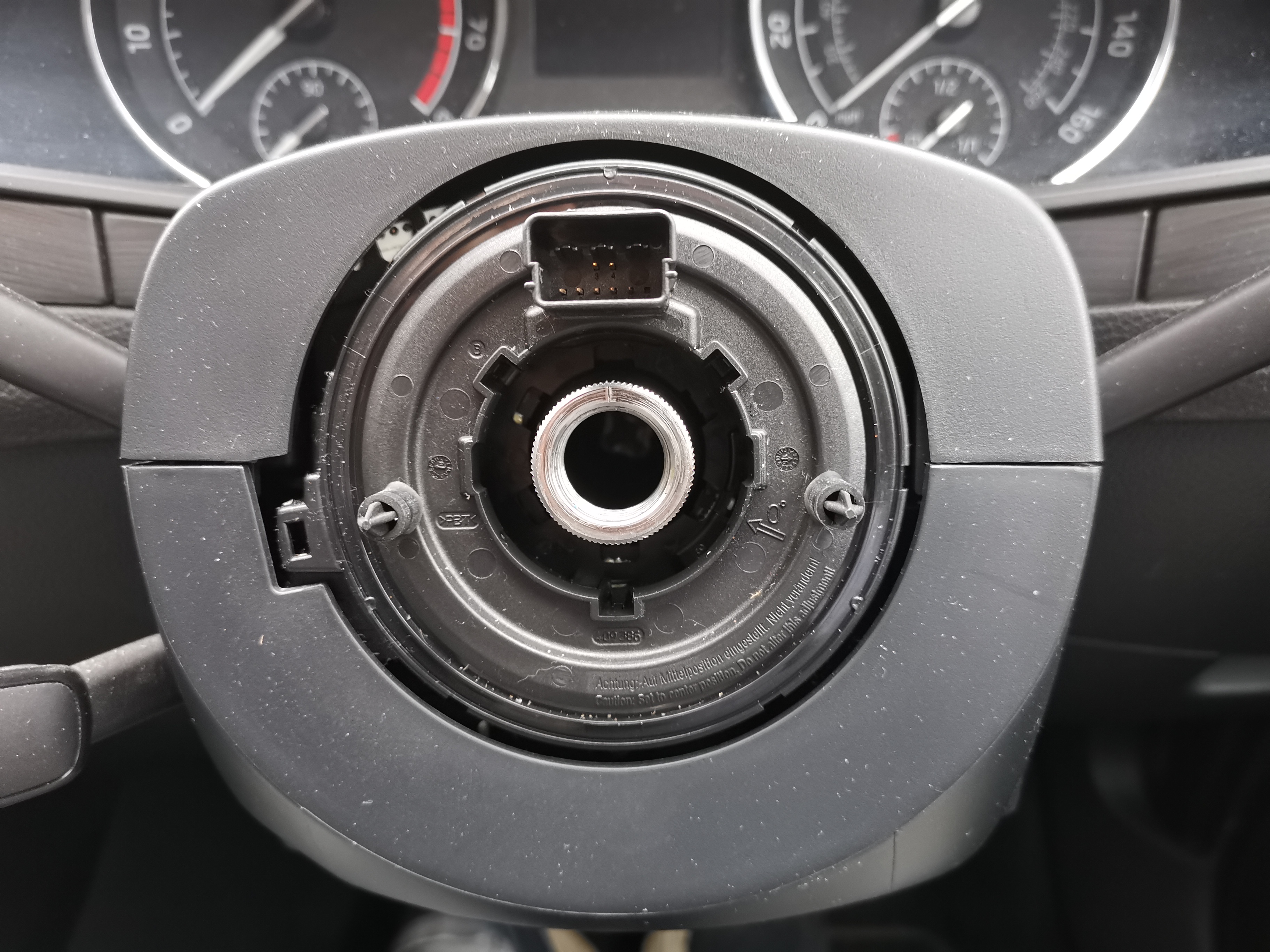

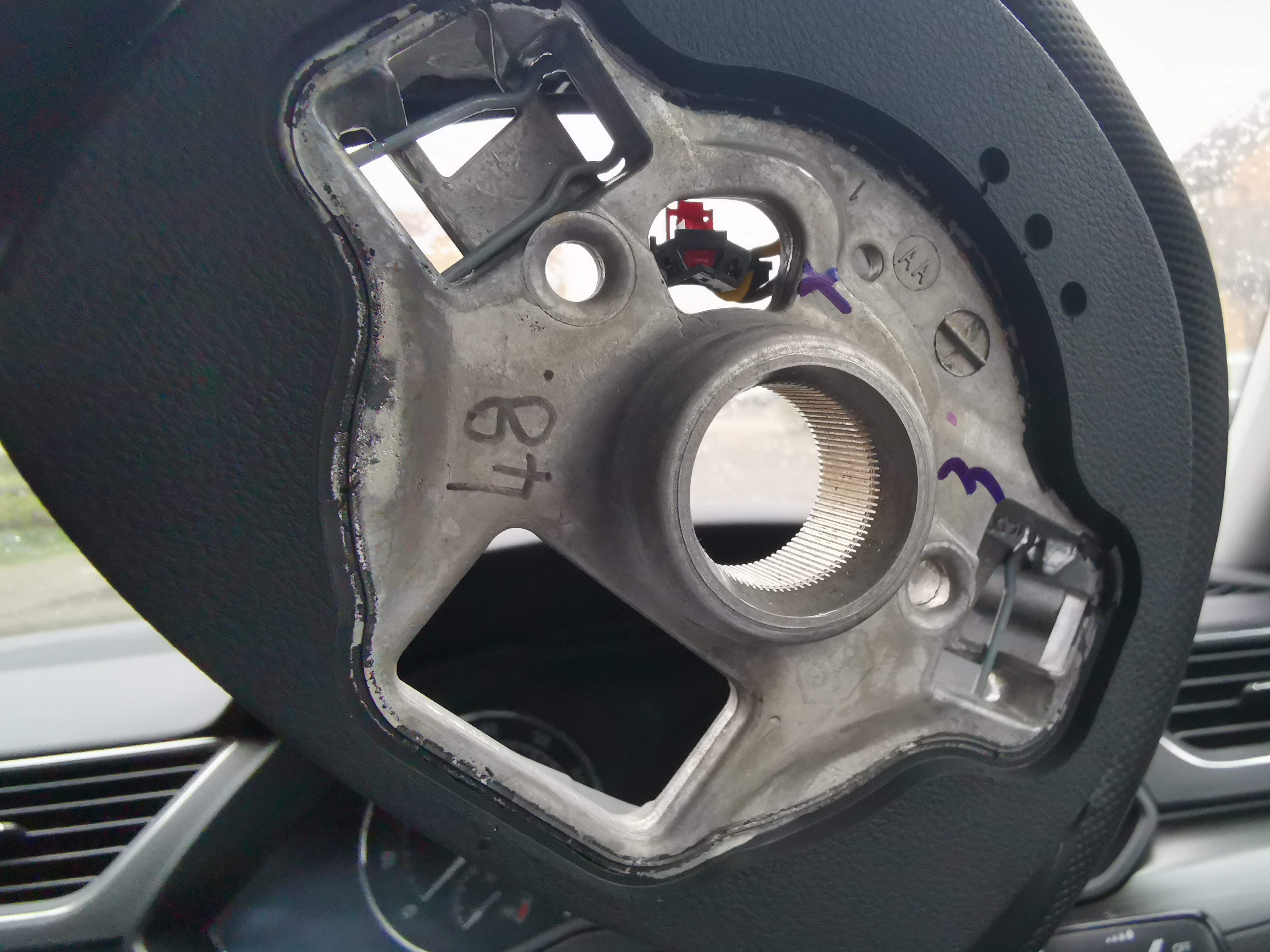

However I was sure I read somewhere that if you had heated front seats, the wiring for heating to the wheel was already in place, but on mine the wire for that isn't visible at the hub. Maybe it's hiding behind this circular round plastic spinnything on the hub that contains the airbag connector in the pic below. See also pic of back of wheel where you can see the heated wire connector poking through. I reckon there's an alternate version of black round spinnything that contains heated connector also. More research needed there to get the heat working on it. I wonder if it's not related to heated windscreen as opposed to heated seats (I don't have the heated windscreen)
So lucky!! I keep missing the cheap ones, missed one in Feb as well, £90!!!! The heated wiring will need adding. If you aren’t feeling the love for that task I’ll swap you with my equally perfect non heated one, same stitching and button layout :D I have this time number saved on eBay search but they never tell me when they are for sale!

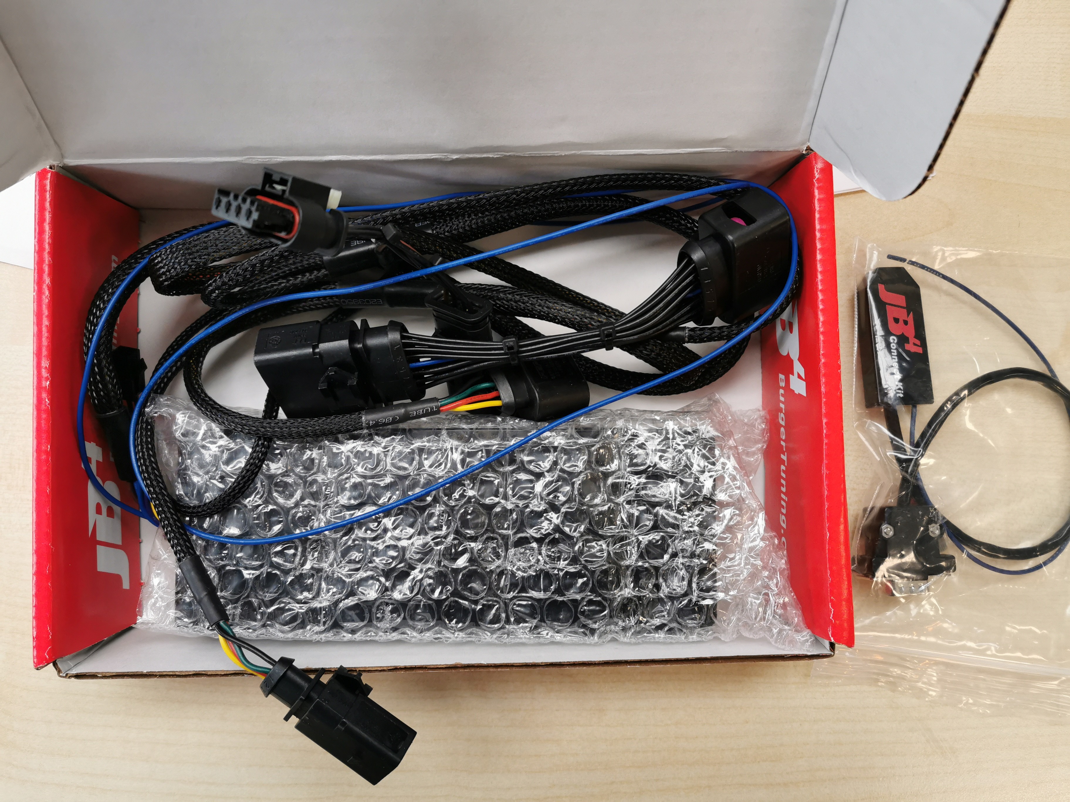

Not done anything to the car just yet but postman has brought something rather exciting😍 should be fitting in on weekend😇

Can't find the heated version spinnything ("clock spring") less than £100 5Q0953502B, never thought that would be more expensive than the wheel haha
Yeah that’s another expensive component lol :D
Enjoy the extra Bhp. How much?
Did you get that exhaust you were looking at?
I already do 😁 fitted it today and wow...map 1 what a difference... Will have it on dyno out of interest once exhaust arrives.
Yes exhaust has been ordered 4th of March...just today i spoke to that company and it will get sent next week😎

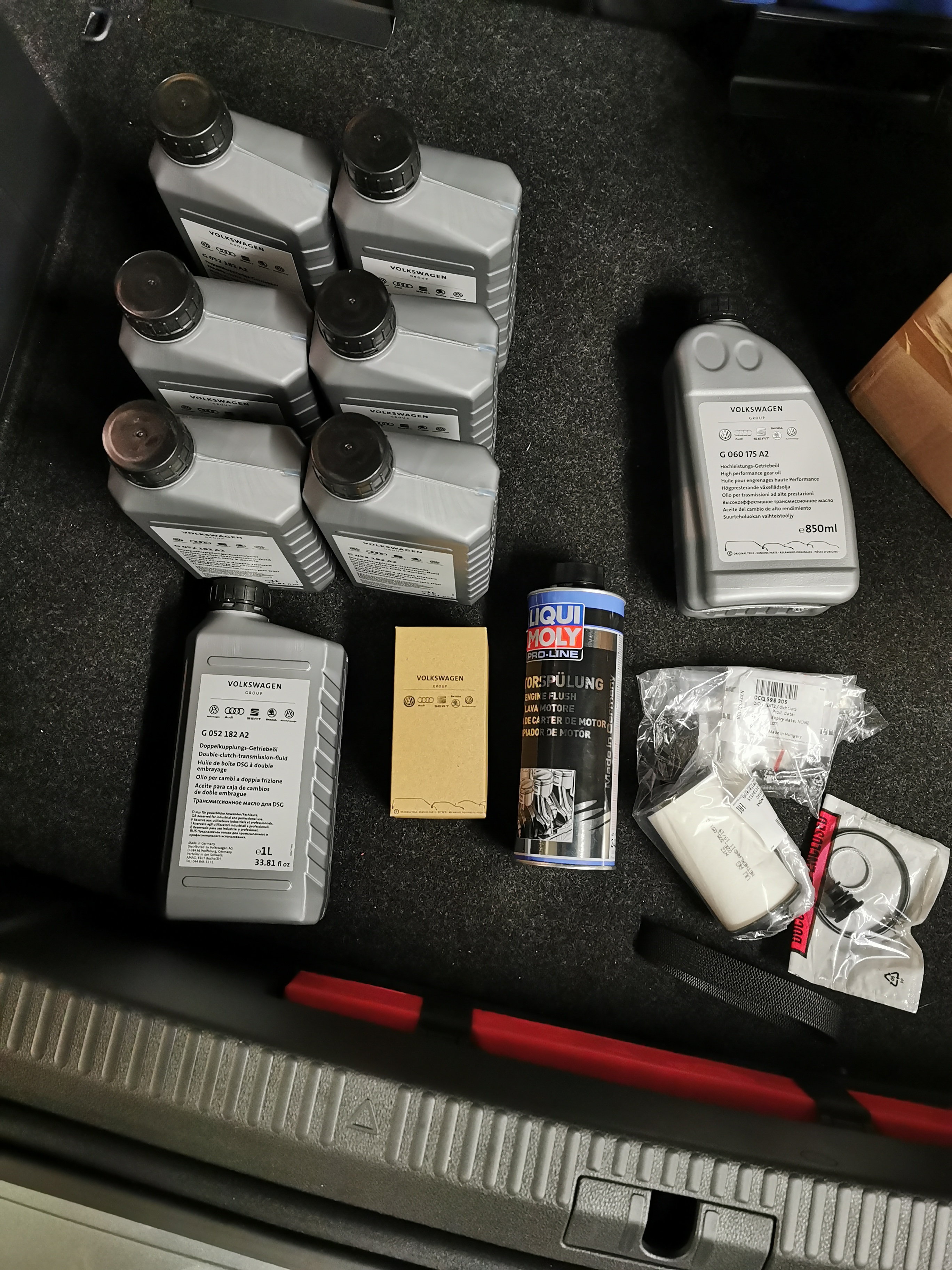

Getting haldex, DSG box serviced, engine flushed and oil & filter changed
Mines due its 2yr service in a few months. I’ve a set of NGK R7438-8 plugs sitting here to go in it at the same time. Like the iridium ix fitted to the older gen units, they do give a smoother and faster response under throttle.
