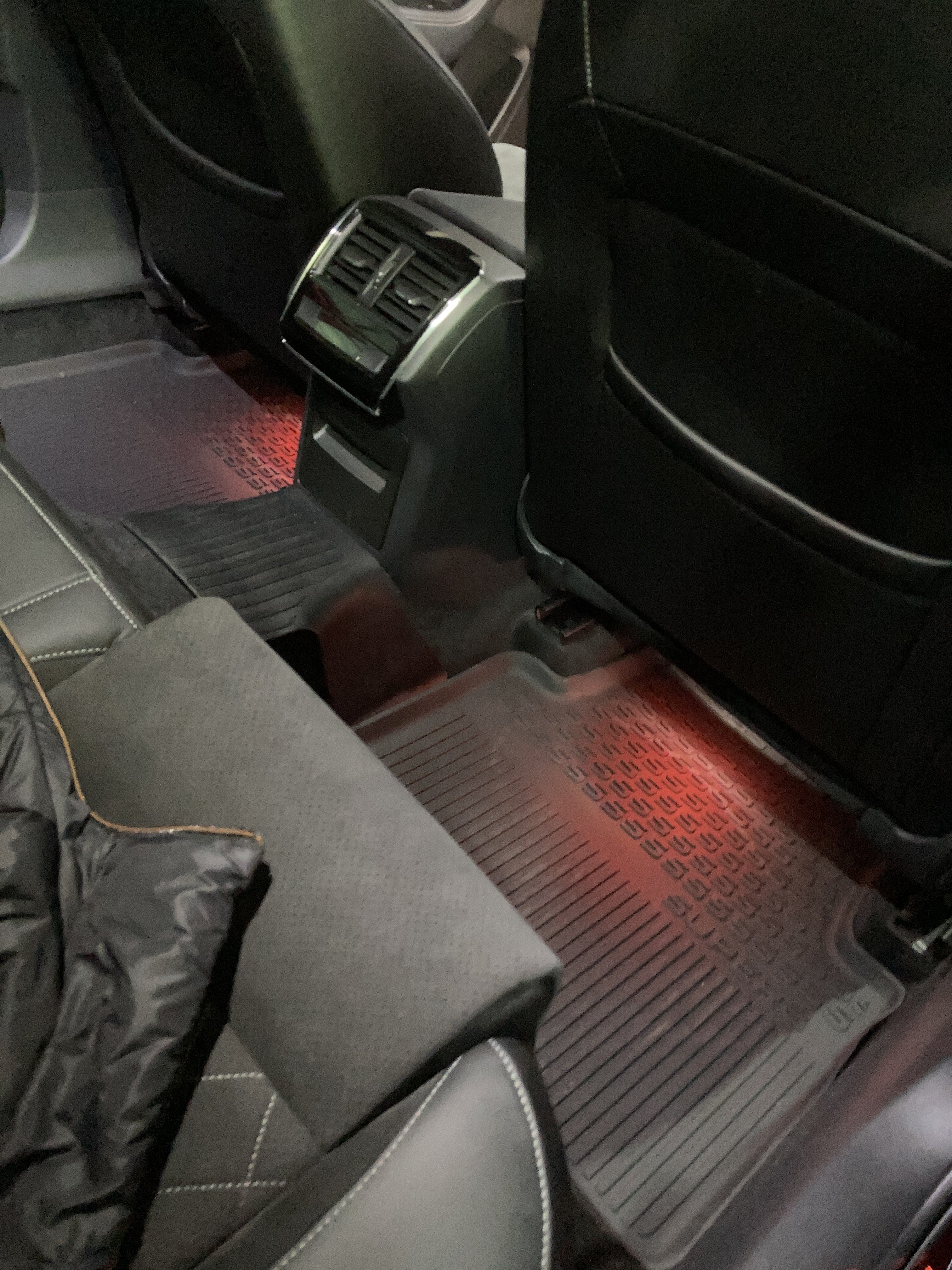

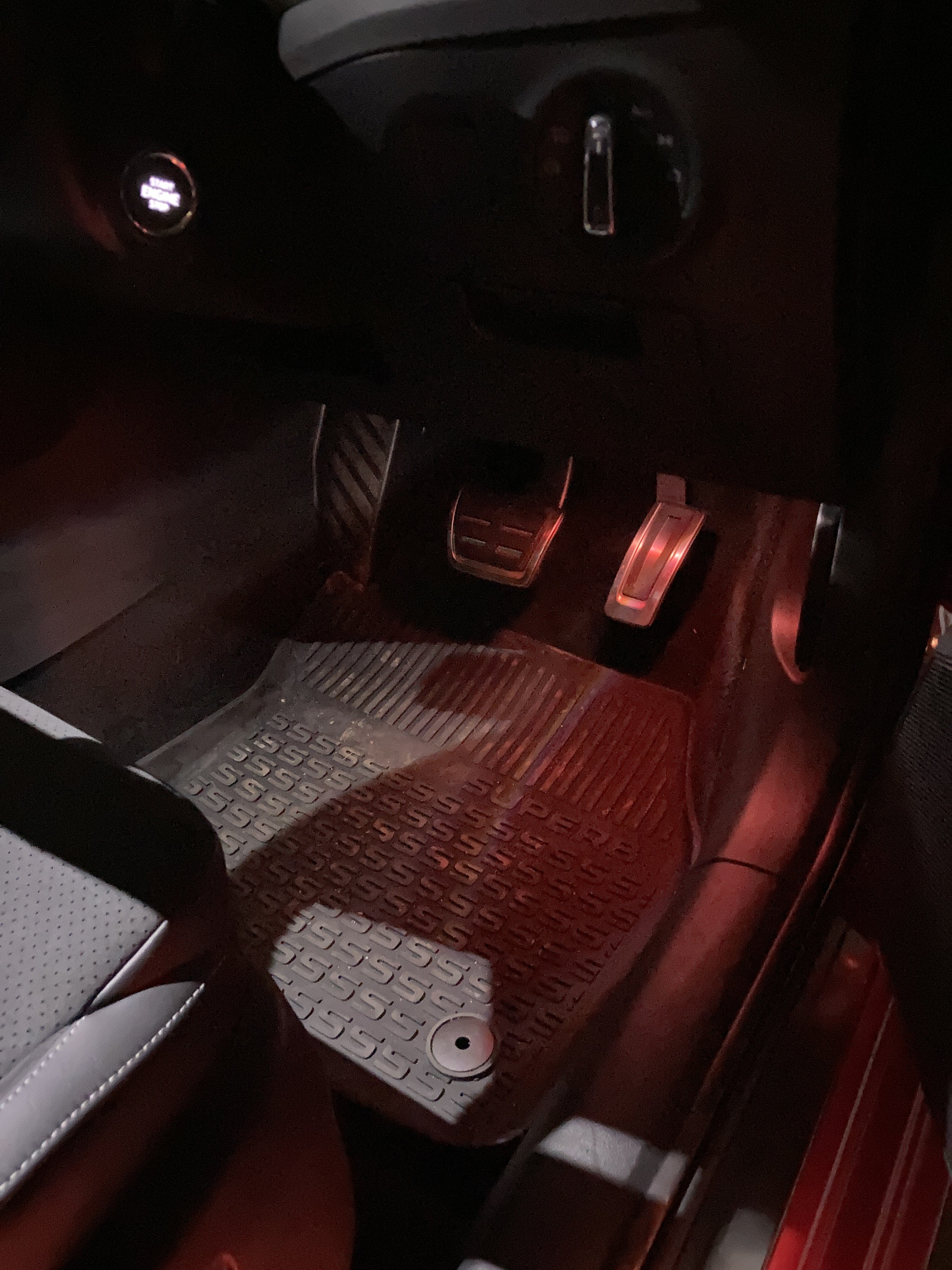

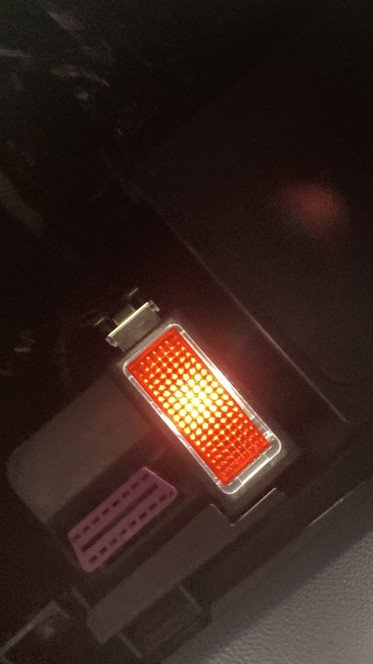

With a Velvet Red machine, you can really only have red ambient lighting (in my humble opinion), so I took the easy route and applied some rear light repair tape to the footwell lights, works a treat (pictures are slightly washed out by the garage lights).

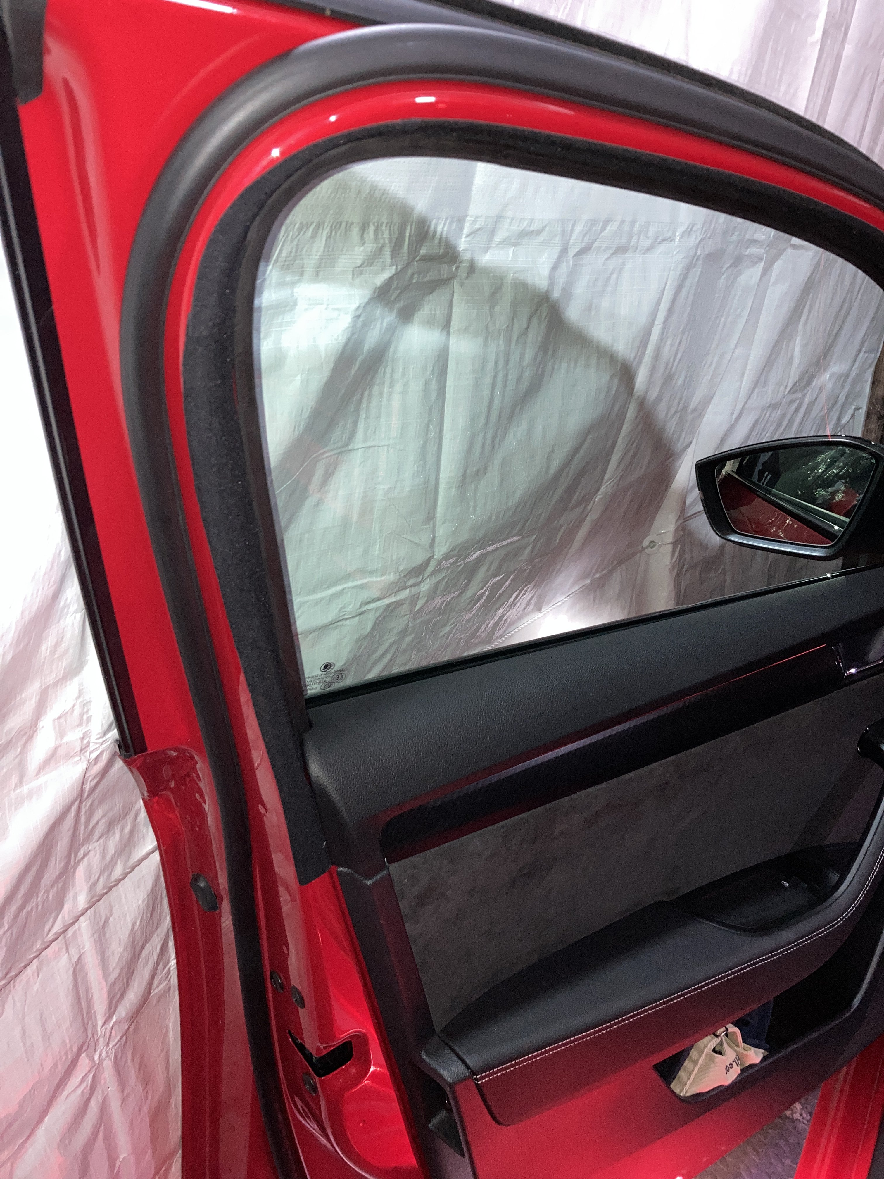

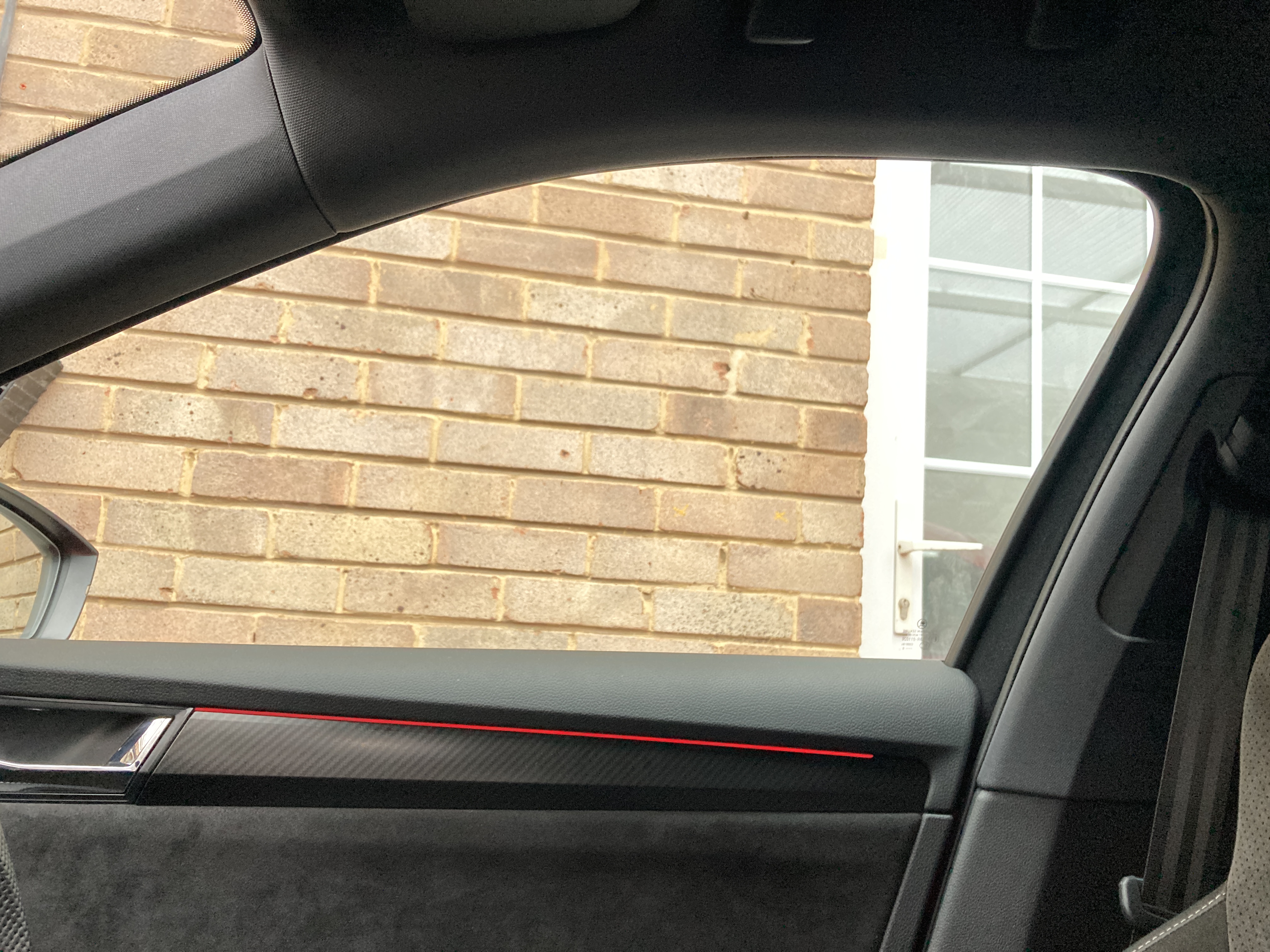

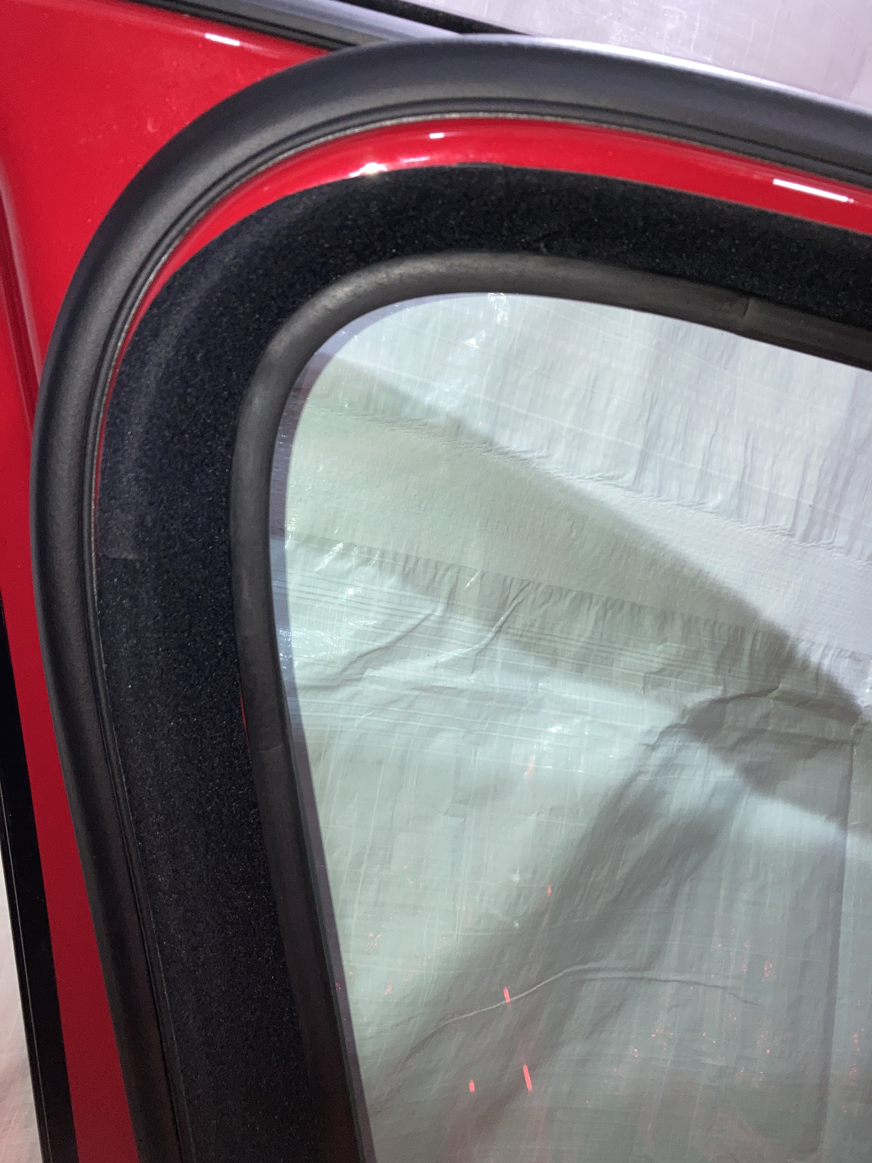

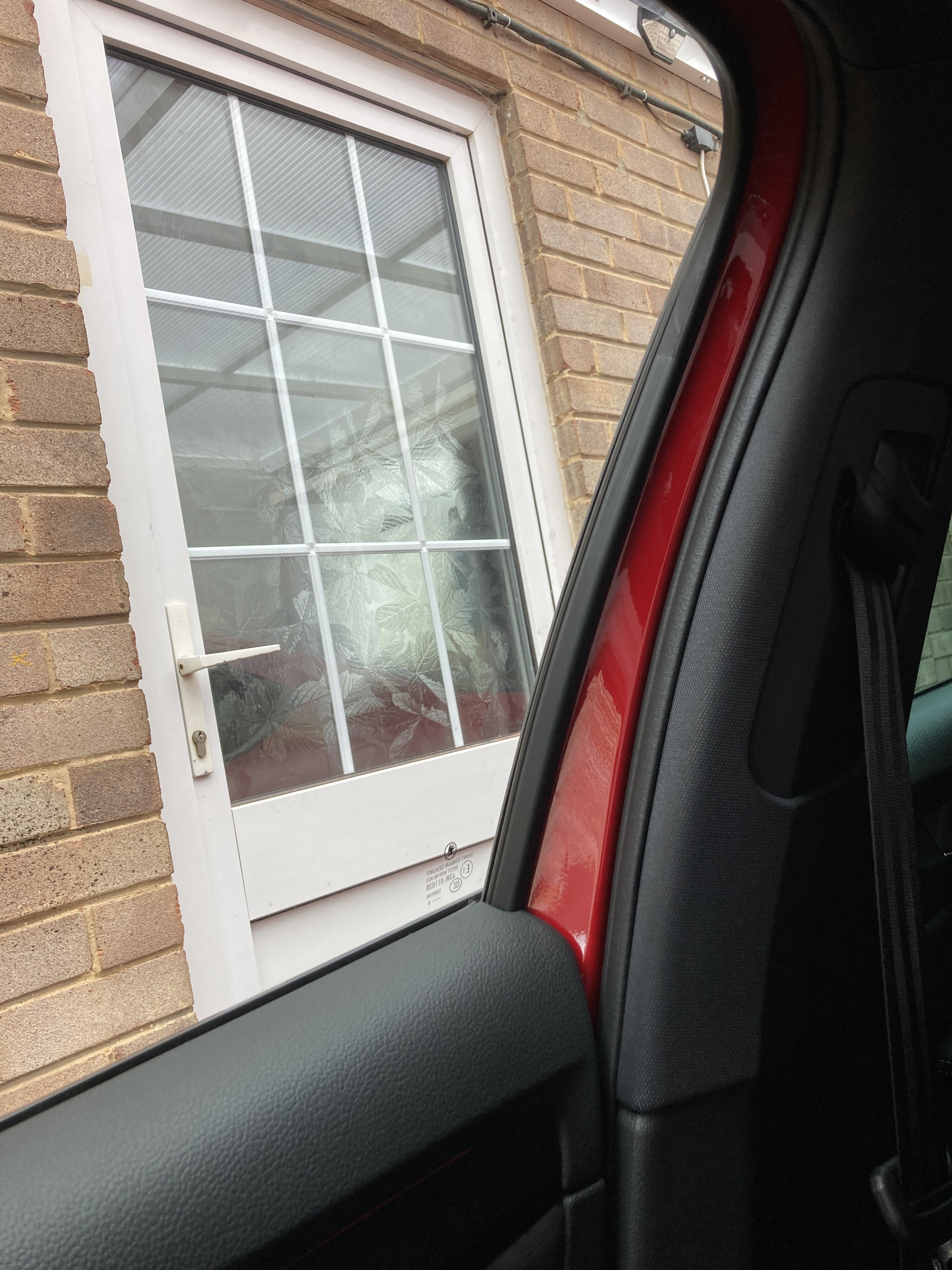

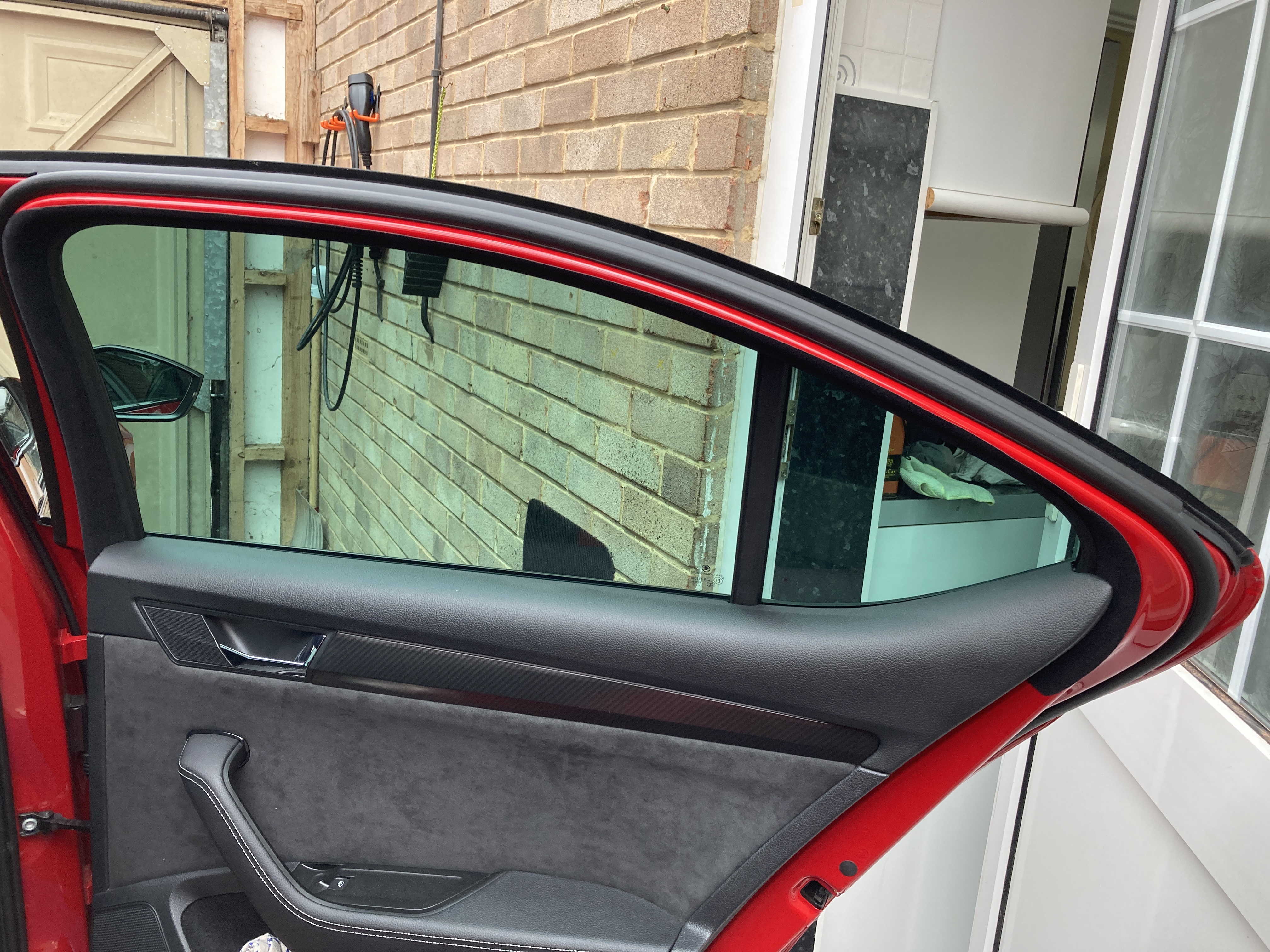

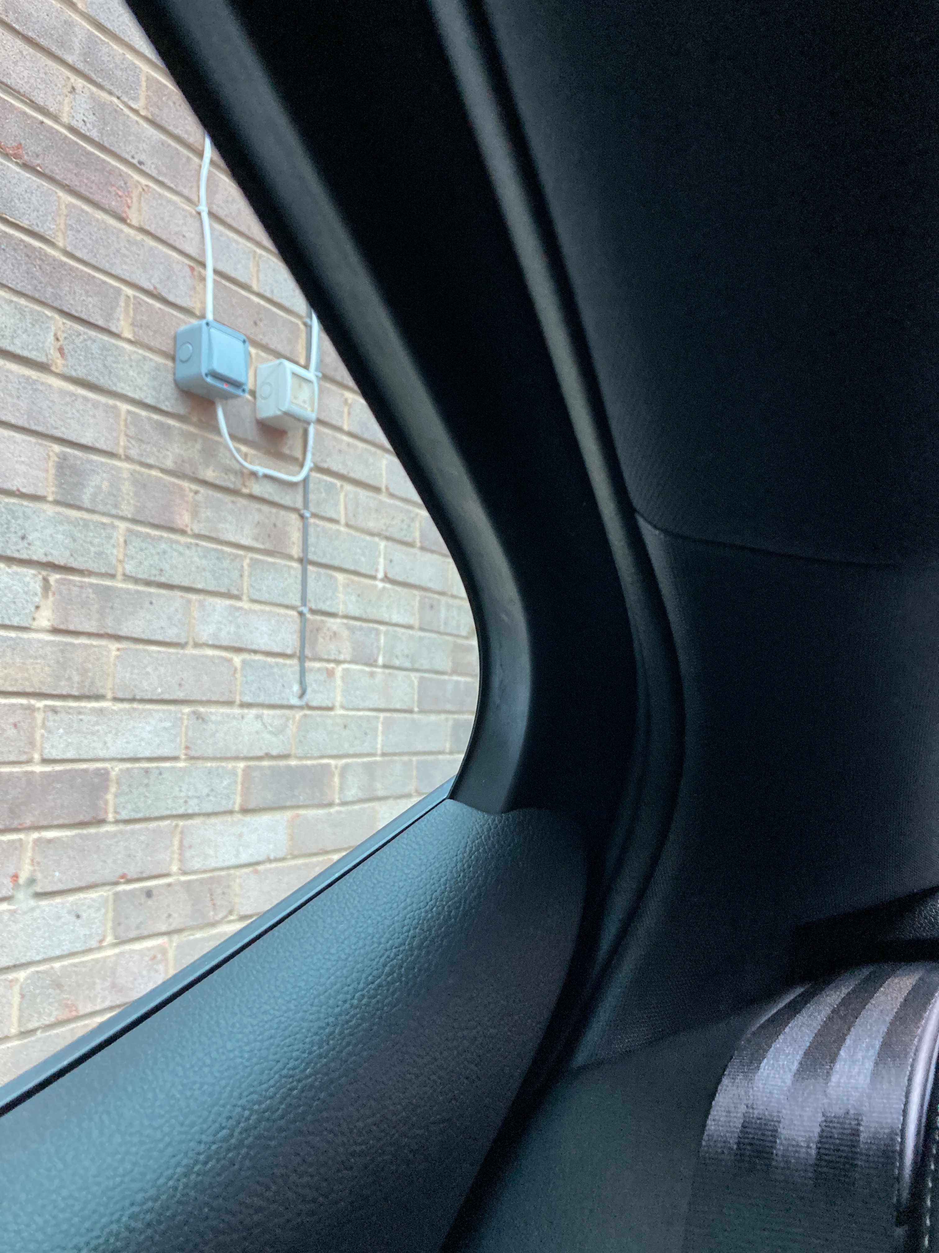

Then, still on the red theme, for some inexplicable reason I detest seeing the paint on the window frames. I've managed to cure those feelings of hatred by applying black velvet Fablon (sticky black plastic). I made up templates with masking tape and it's come out perfectly on the front and rear doors.
Couple more pictures.....IMG_7541.thumb.JPG.45440f9e0961868f81a4438a615bbd01.JPG
^ Man after my own heart, great job. It bugs me too. Did you peel back the window rubbers and what does it look like with the door open?
Yes, I slipped the window rubbers back and that was easy and give a perfect finish line to the seen part. I managed to curb any OCD failings to the line you can only see when the door is open, it's good but not perfect! The final shape was also dictated a bit by the window frame shape (edges and fold lines) to ensure the Fablon stuck down nicely.
I did the long runs in single pieces then short bits for the tighter curves. The black absorbs light well which makes the pictures difficult but you don't see the joins in real life.
I used masking tape for the initial templates, pencil line, cut out and transfer to the Fablon backing and use that Fablon piece for the mirror image for the opposite door.
When I had the Yetis I was always going to do it but never did. The first Yeti was white so wasn't too bad and I coped with the bronze of the second two Yetis (L&K brown leather interior) and with the Citigo there was no choice - there was more red paint on the inside of the doors than black panels.
With the really high quality Sportline Plus interior on the Superb, it had to be done. It came out better than I thought and am very pleased with the finished job.

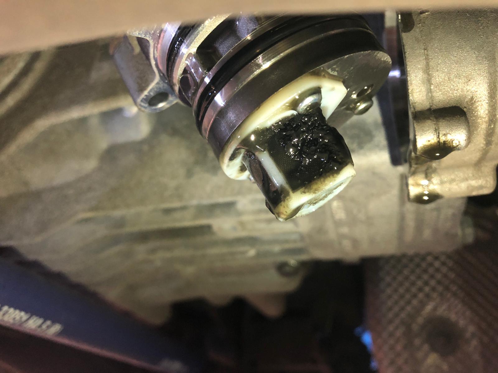

Haldex oil change and screen cleaning
Actually I'm lying since I did this a week or so ago but I didn't find the time to post it here too, still i think it'd be interesting for others to see what a Haldex screen looks like after just 22K km and 2 years of age, (albeit one that has seen its fair share of Launch Control)
1163250125_4c1faabf-fed2-4051-93f8-8accdf9b5cbf(1).thumb.jpg.9739ac36fdb141409b7e91bc5d9a4c39.jpg
Remember, this is an item that is supposed to never be disassembled and cleaned during the lifetime of the car, just an oil change is foreseen every 30K km... :worried::worried:
It'll be on my private maintenace schedule every 12-18 months depending on usage and signs of clogging (trumping during launching or when the AWD should be fully engaged).
The Haldex reset after cleaning seems to have helped too.

Pretty similar to mine after about 30k miles. And the oil was full of black gloop too! Definitely something I’ll be doing again soon!

30k miles is more understandable, mine was at less than half that mileage (22k km = ~ 14k miles) which is rather shocking.
Mine was in similar condition after 45000 km. But it's a stock TDI190, may be I'm less tempted to 'smash' the throttle :notme:... It's not a sleeper as a TSI280... :giggle:

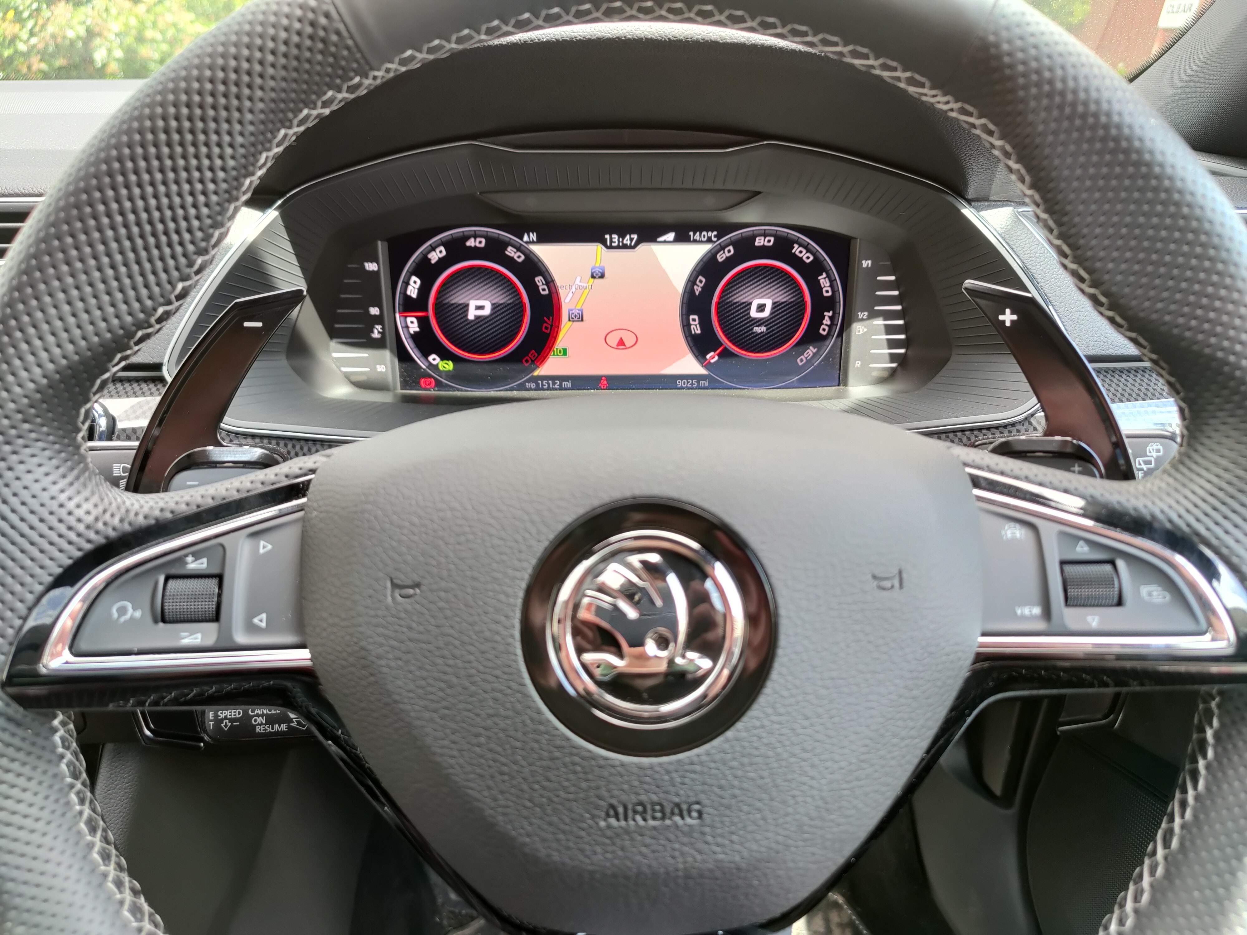

Managed to find some used Leyo paddle extensions in black from eBay, which arrived today. Only £40 - very impressed with the look and quality. Not sure I'd pay the retail of around £150, so chuffed to get them at this price!

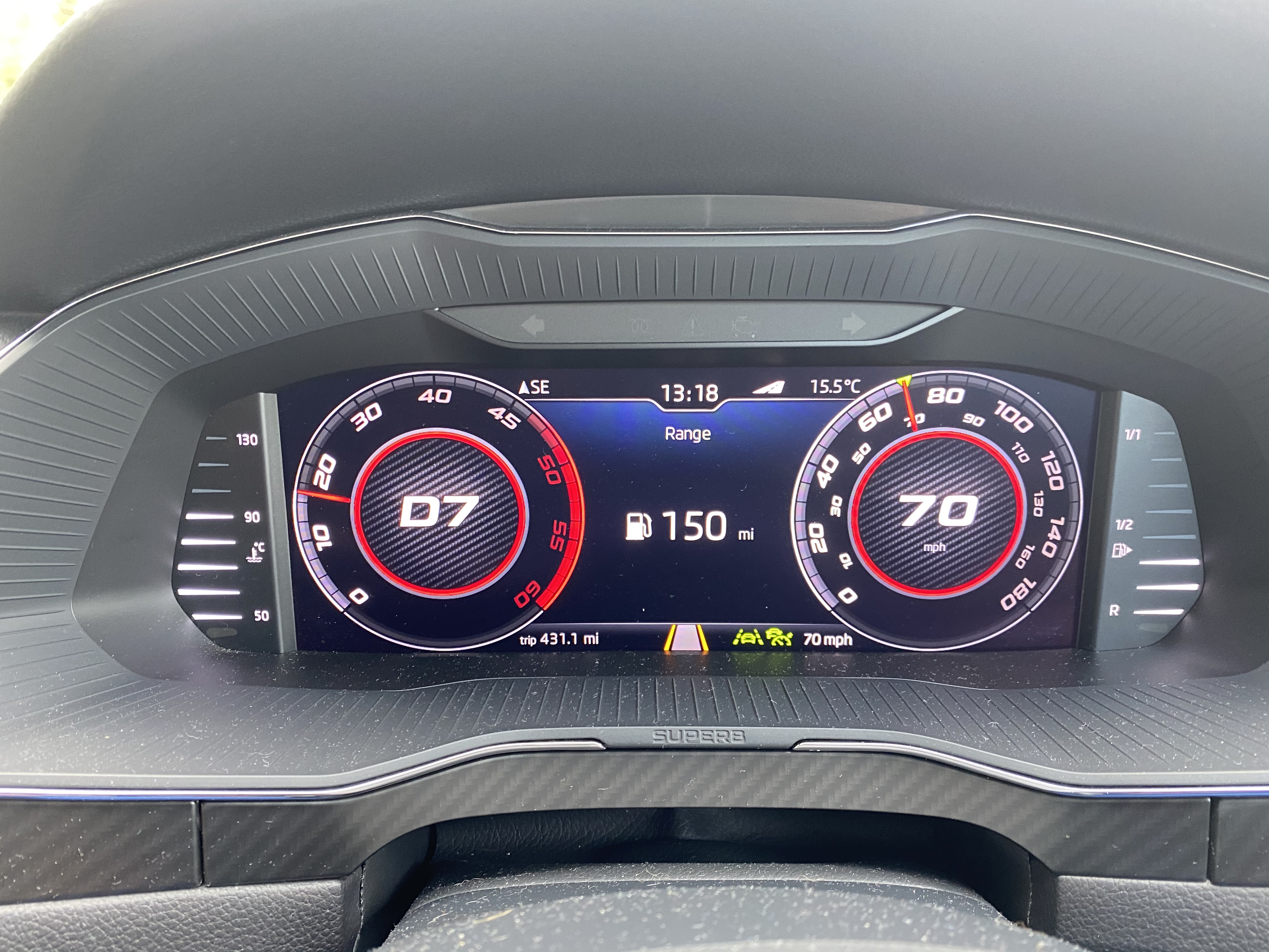

Got the chance to play with the Lane Assist now it’s coded and it’s the biggest thing I missed from the Octy retuned!
It’s so odd seeing the extra lights and feeling it doing it’s thing again haha
Yes, a passenger took the photo.

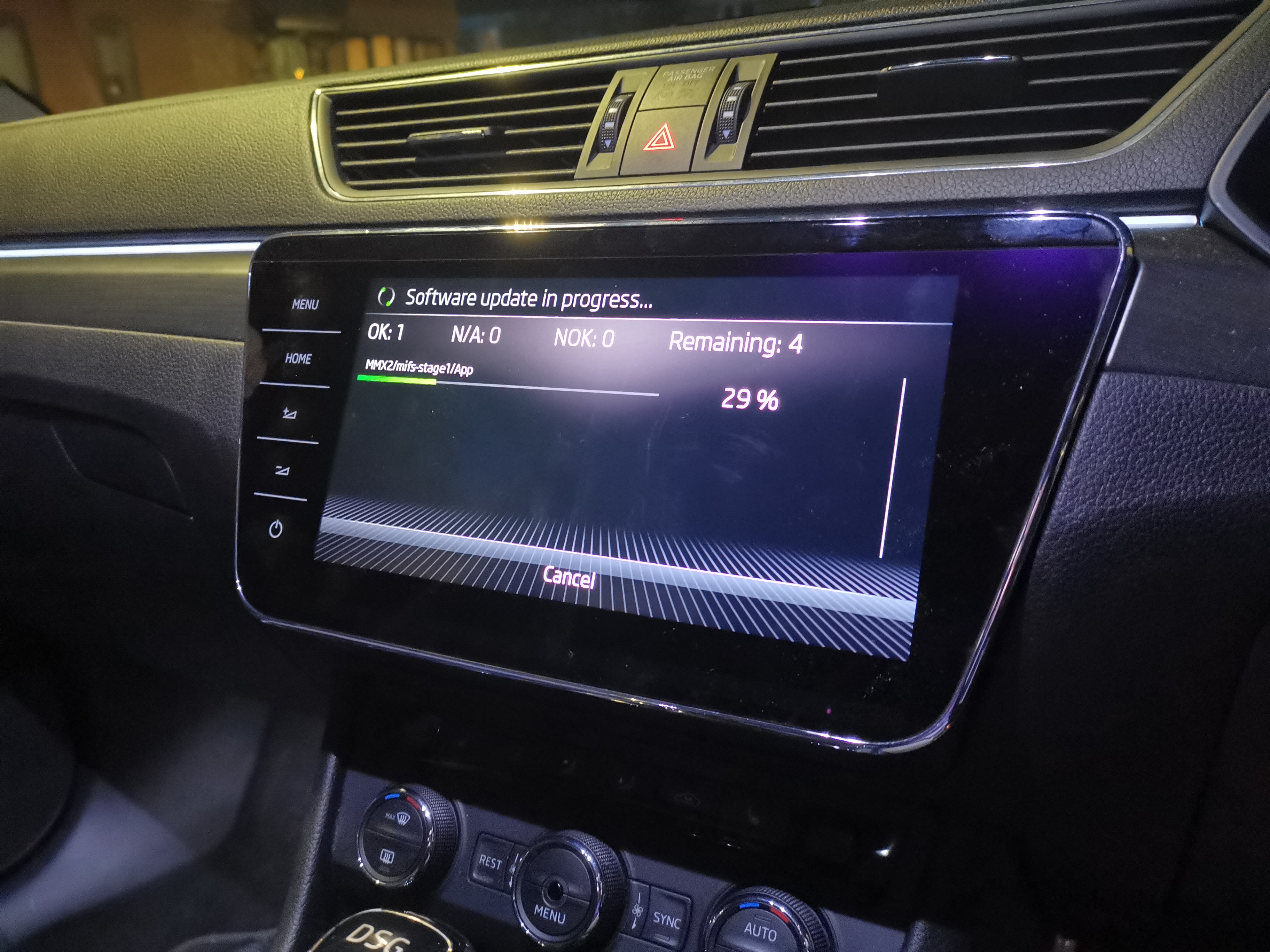

Took a full vcds admap of module 5f, Removed the MIB2 columbus unit and screen and installed columbus MIB2.5 with 9. 2 screen which I got from ebay.
Took a full vcds admap of new unit, used winmerge to compare adaptations and set it up properly for my car as my old MIB2 was, updated  nav maps to 2021, updated to latest firmware, installed mib toolbox, tomorrow will do component protection removal and enable video in motion
