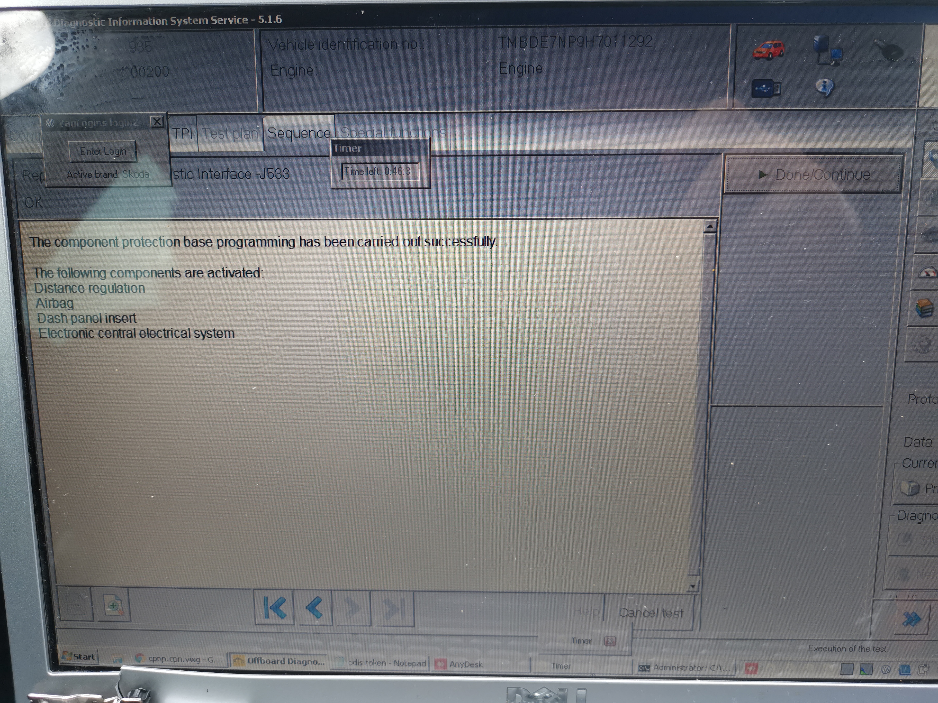

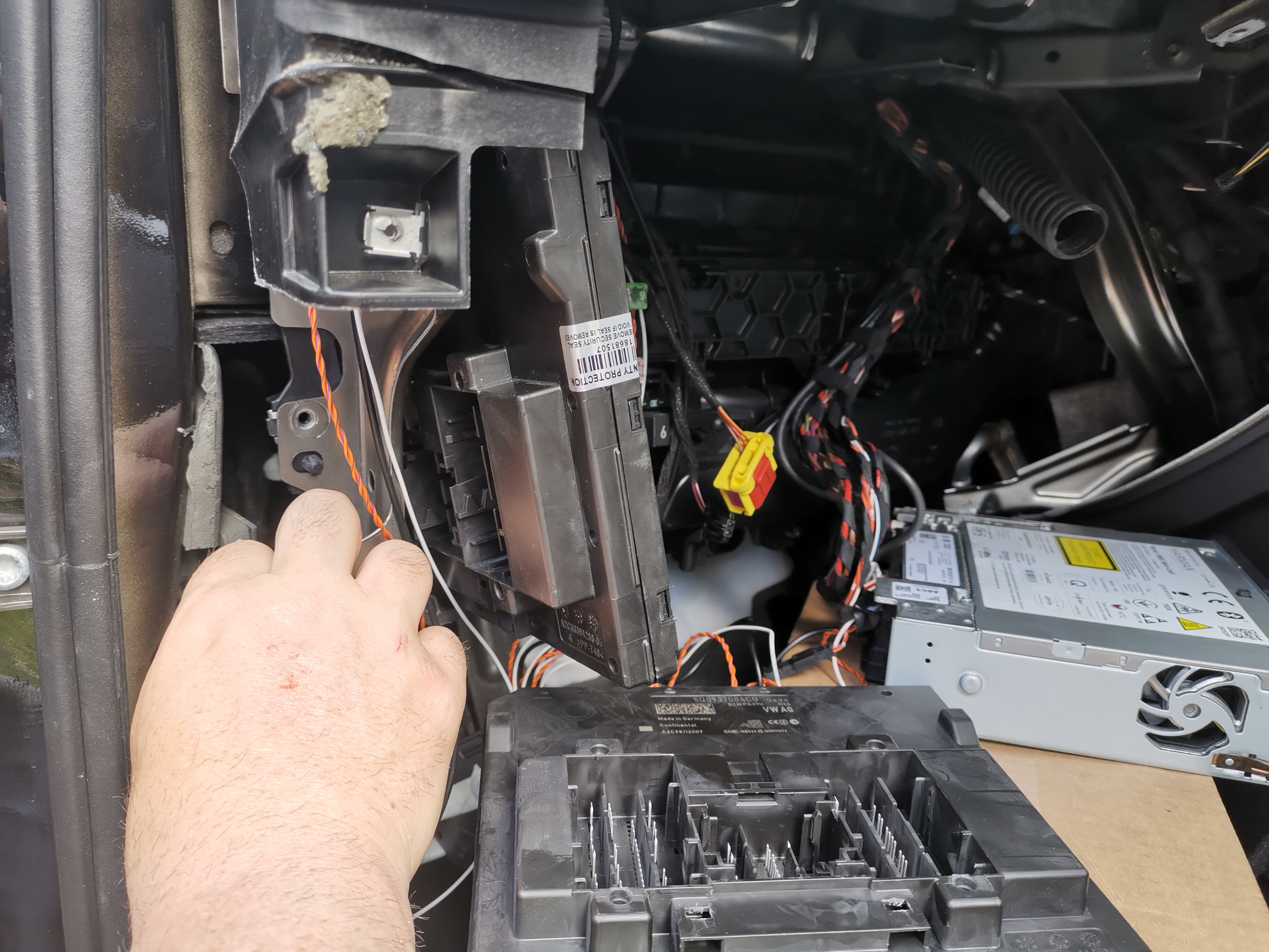

As part of preparing my car for a virtual cockpit retrofit, today I upgraded the canbus gateway module (module 19) from 5q0 907 530AM to 3Q0 907 530AC.
This is not an operation for the faint of heart in terms of coding/programming. If you get it wrong, bricking your car is more than possible here..
I got the module used off a VW for £39 on ebay.
I paid eur20 for 1hr access to an odis online account from vaglogins.com, as component protection removal is needed as part of the process.
Remove drivers knee airbag, remove drivers footwell air duct, swap gateway module
I used the guided function in Odis-s to go through all the flashing, parameterization, coding, cp removal, restoring features, etc etc.

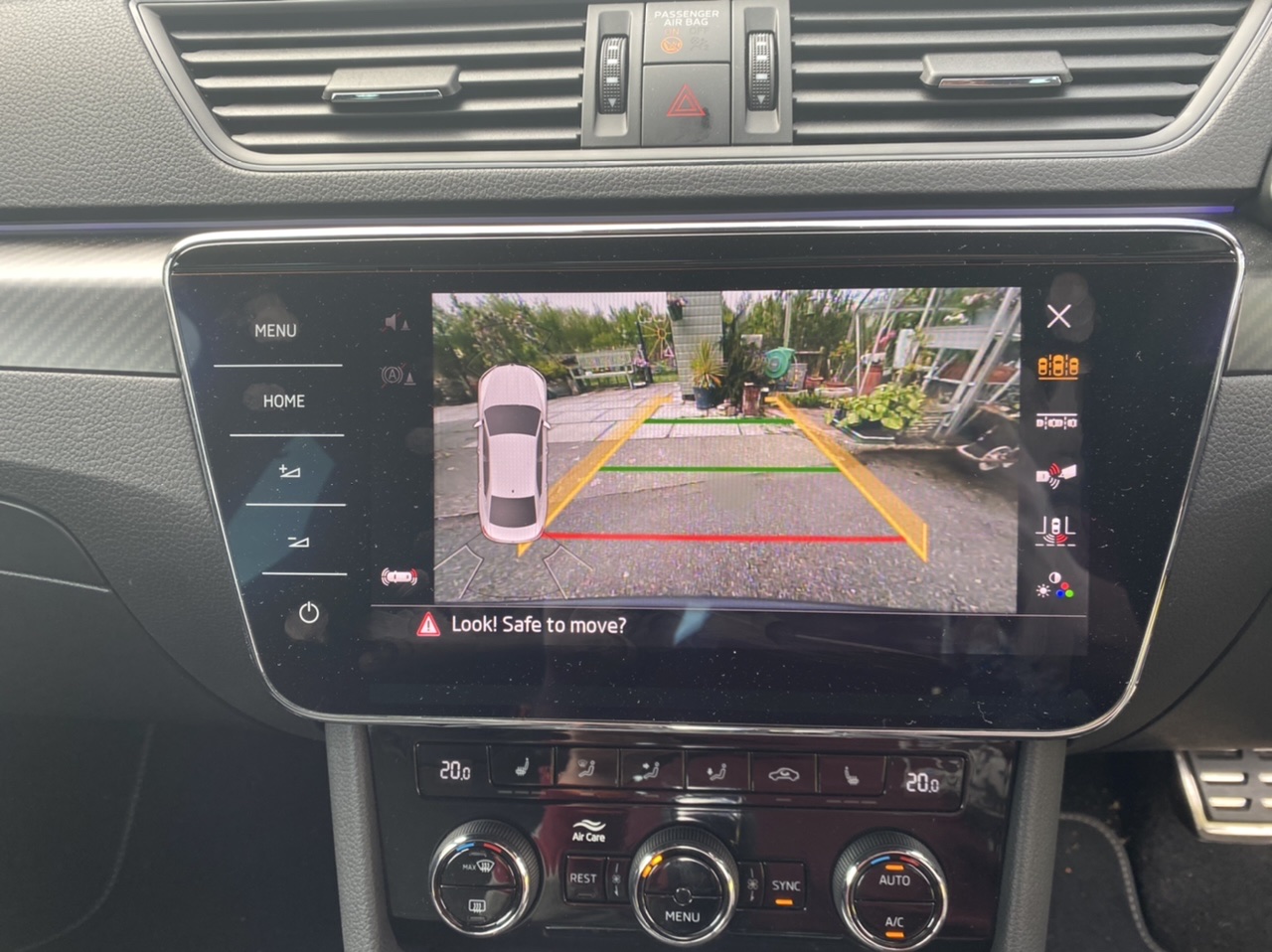

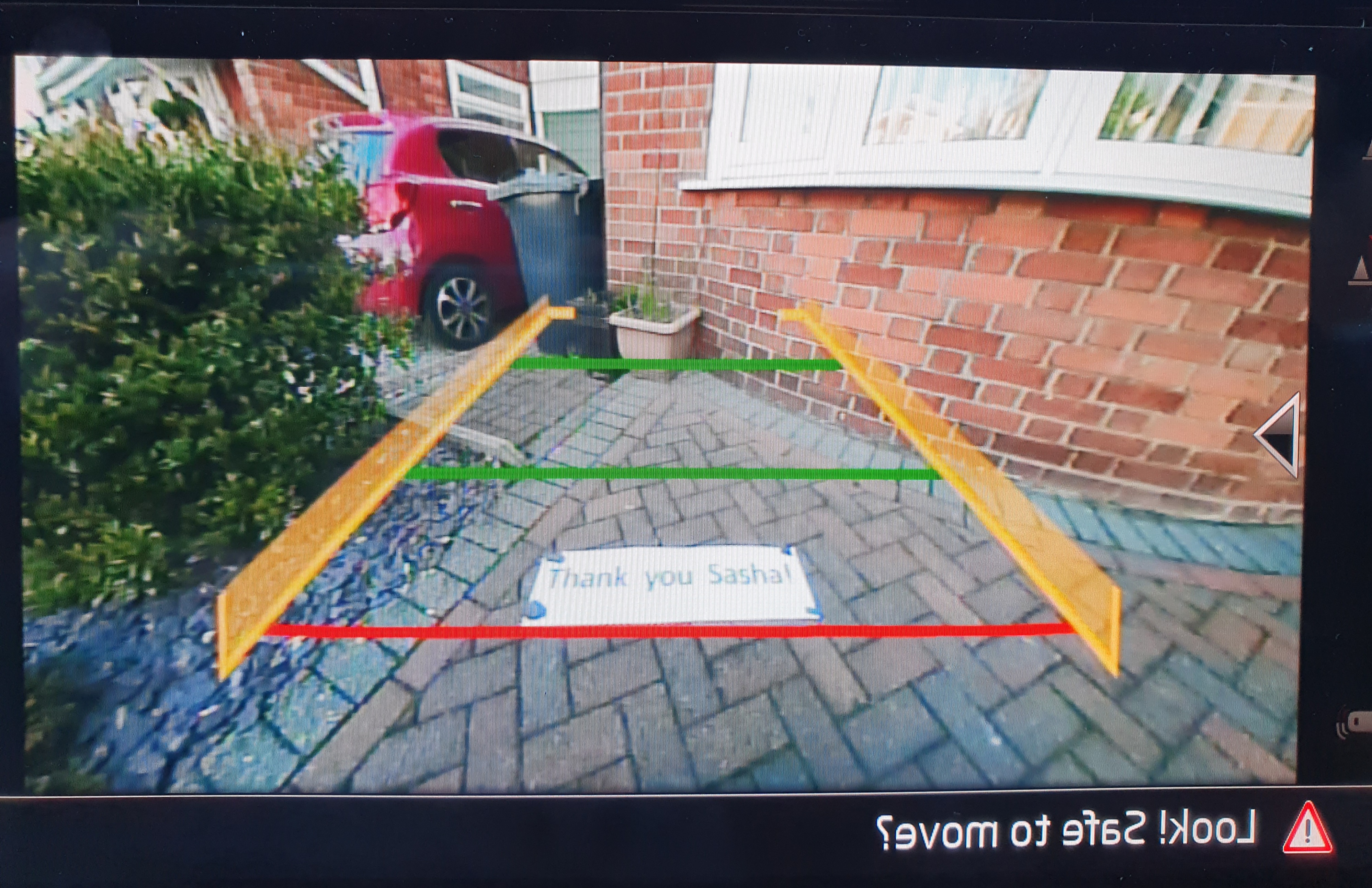

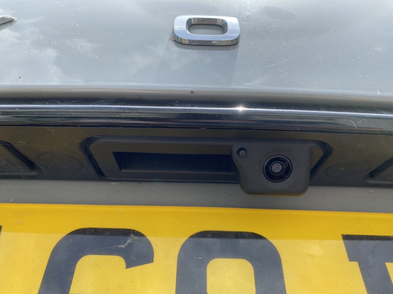

Had the pleasure of doing another camera on @JBD1974’s lovely Superb which is another one that is almost my cars twin!!
I will be doing the same in a few weeks hopefully
Then the alloys are being changed to veeman fs66 I think, then lowered in a few months
I'd love a little more poke but from a previous bad and expensive engine experience with a bmw I won't be mapping again
1 hour ago, JBD1974 said:
A pleasure meeting you @SashaGrace and I'll echo the comments of others  - thanks for a very professional  job of installing the camera, the bonus coding tweaks and tea.
If you're thinking of installing a reversing camera etc I can't recommend her enough!
That’s awesome!! I’ll let you know when the virtual pedal parts start arriving 😅

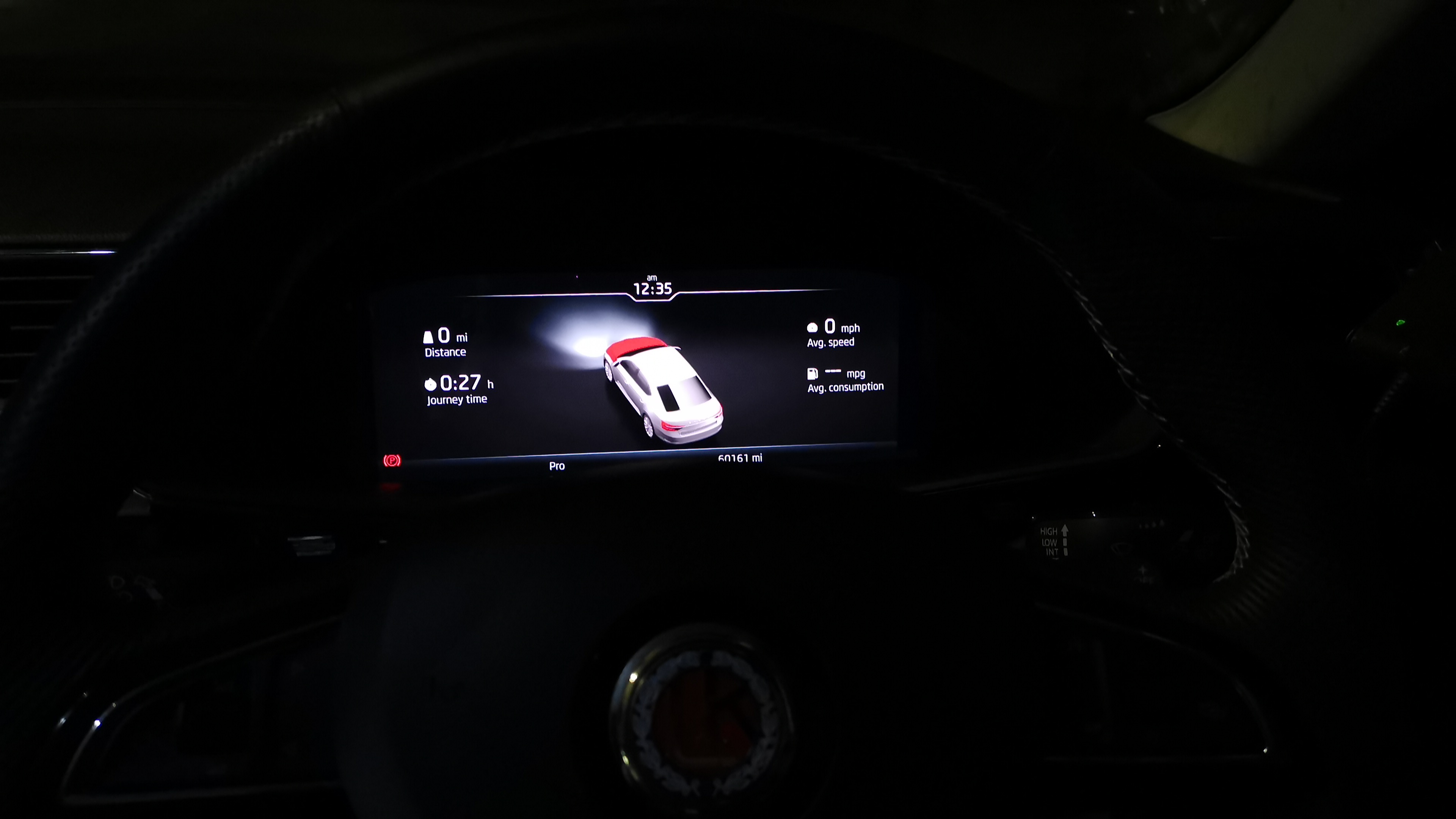

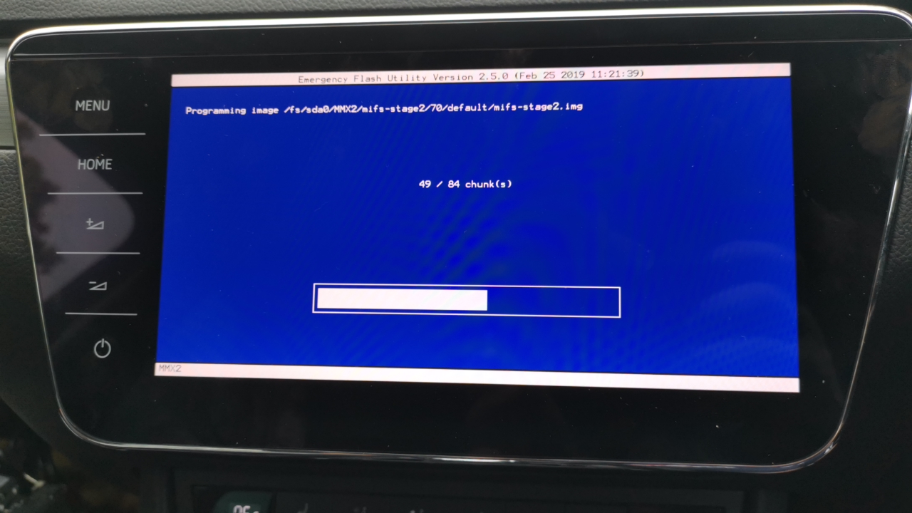

Retrofitted MIB2.5 high (columbus) to replace mib2, retrofitted virtual cockpit. Havent got the maps coming through over MOST from mib2.5 to the VC yet, must be some coding I missed. Getting working geko/fazit/odis live accounts with cp removal enabled to do this kind of retrofitting yourself is the hardest bit, but got there in the end. You can have a bad day when you start getting these blue screens haha, but got it all sorted
Edited by AlVal

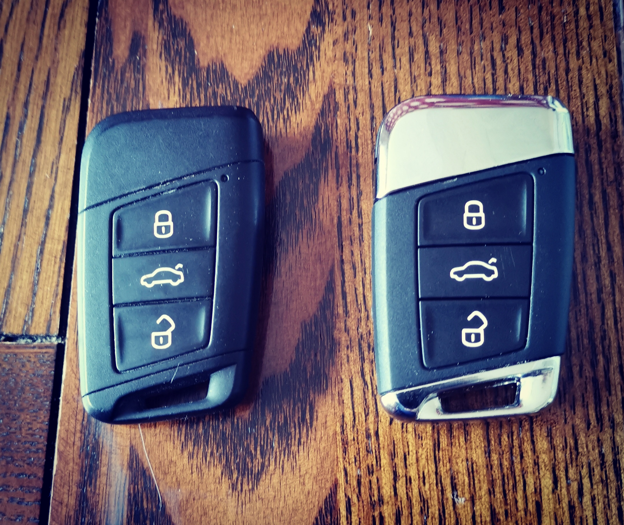

On 22/05/2021 at 21:56, AlVal said:

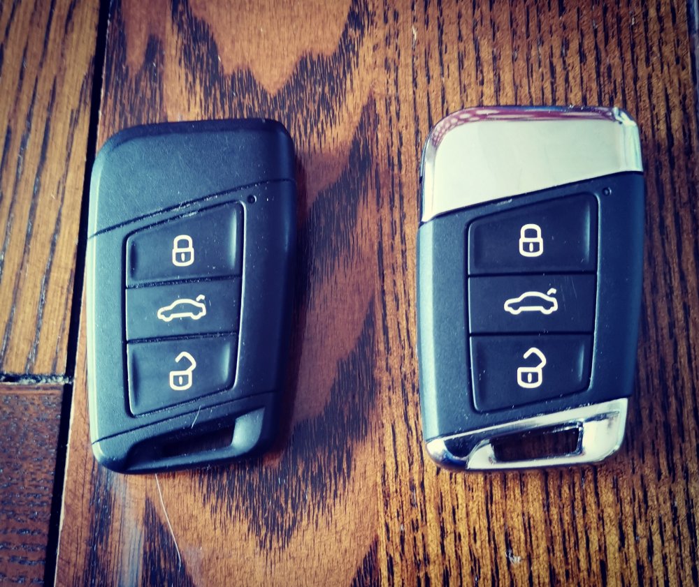

Swapped out the second "basic plastic" key shell for a metal capped shell using the metal shell from aliexpress, link courtesy of @SashaGrace
£9.56  30%OFF | MQB Car Intelligent Keyless Go Smart Remote Key 434Mhz with ID48 Chip for VW Passat B8 Magotan Superb A7 Variant 2014-2020 Year
https://a.aliexpress.com/_mrh2g4t
U now need to get the "Superb" version from Superskoda.....
