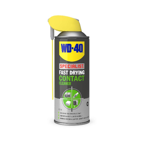

I had a similar issue with my Yeti KESSY start/stop button a couple of times over the 7 years and 90k miles I had the car.
I didn't need to dismantle anything apart from carefully prising the chrome ring out from around the start/stop button then giving a good spray of electrical cleaner in where the ring sits. Worked a treat and a 5 minute job.

Think I'll do a pre-emptive strike. I have just ordered
This stuff is amazing. I sold both mine & my wife's car privately before purchasing my Superb, she had an old Peugeot 107, which are notoriously bad for corroding contacts, due to water ingress through many poor seals. I was on the cusp of someone coming to view the car, when the indicator stalk developed a known issue due to corroded contacts in the mechanism. A couple of blasts with this stuff, and a wiggle of the stalk and the issue seemed to be resolved.
I'll keep the can to one side for now, incase my stop/start develops a similar issue to DBT85, unless of course, they're right in that the switch needs dismantling to clean, due to silicone covers etc.
