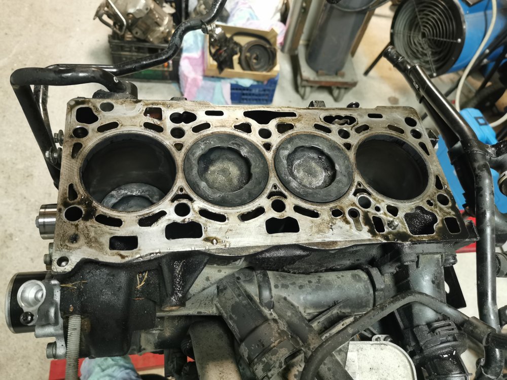

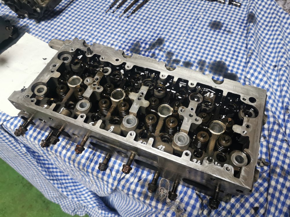

    I ordered new  - Head gasket - Head bolts - Head module bolts (18pcs) - piston rings - conrod bearings + bolts - main bearings + bolts - thrust bearings - crank
  • Finally found what was causing high oil consumption for my VRS, please see attached picture, this how piston one looked for car with millage 160K. And one more thing, don't do long service intervals,

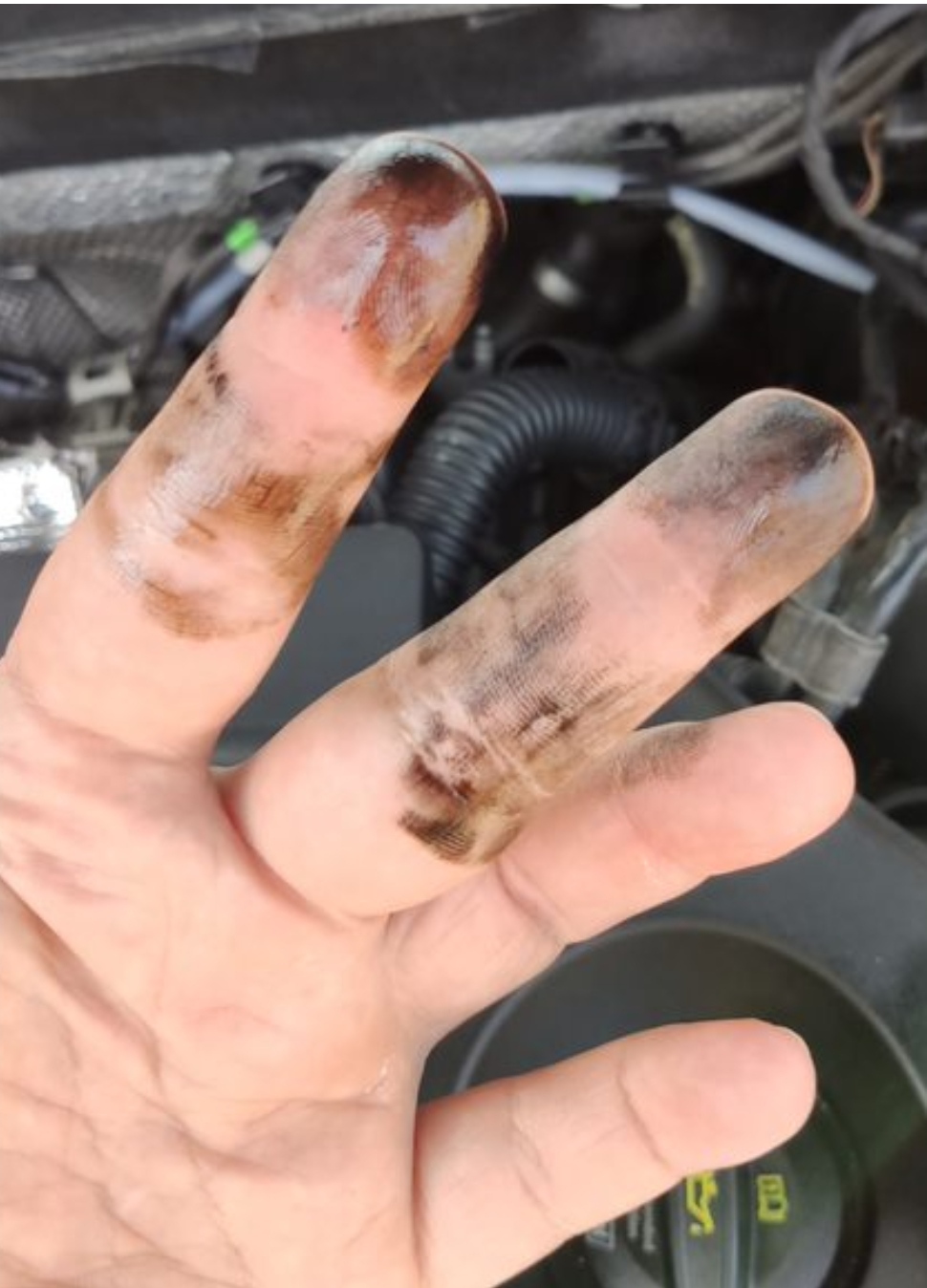

 This is how it looked like when taking out the pipe that goes from pcv to the intake. This is probably the easiest "test" to do.

Just checked my intake to pcv pipe and it was bone dry.
This means you're lucky ( or not?? 😂 😂 Might be something way more expensive).
