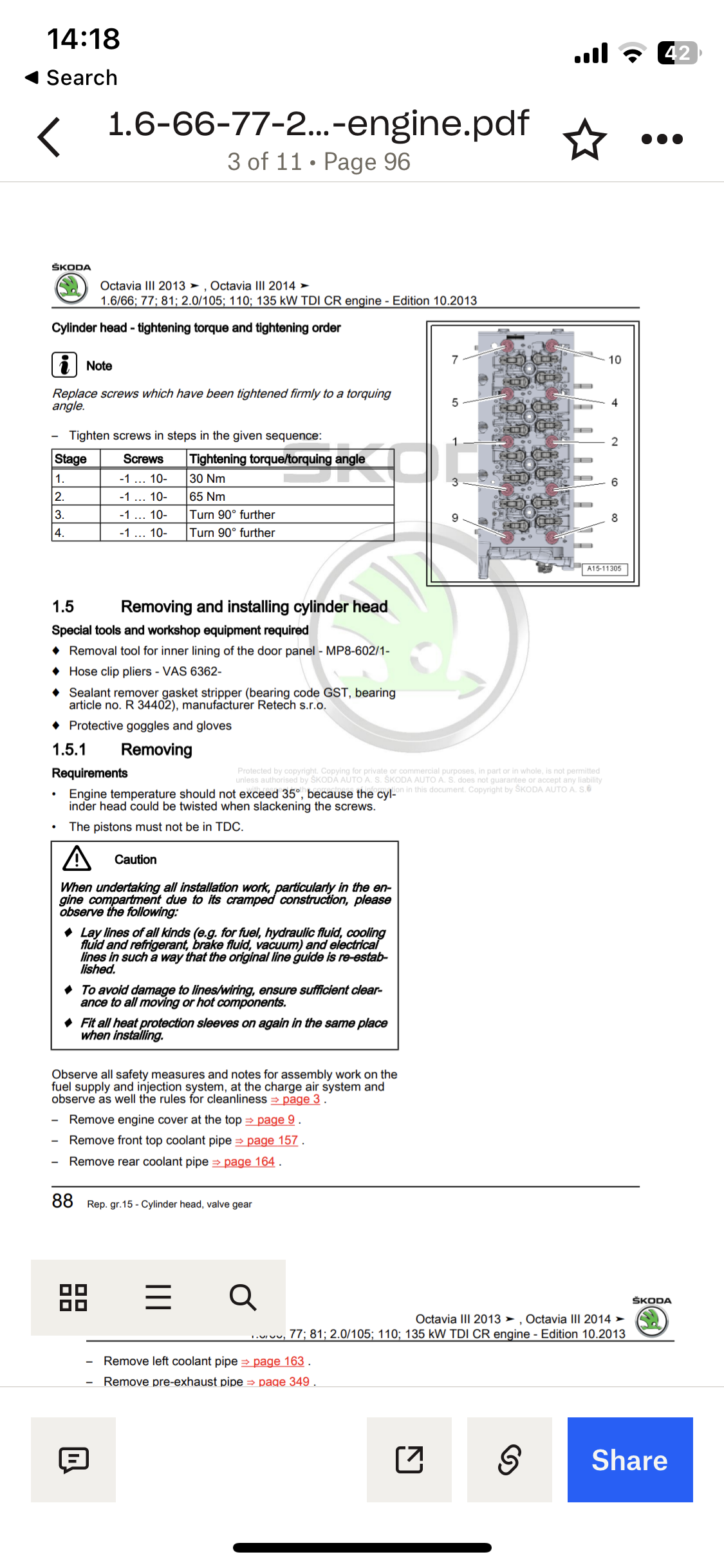

Sooo here is the thing. The balancig shafts and the crankshaft sprocket don't have any markings, the manual for the Seat (184hp engine) says that the cranckshaft should not be removed. So if you want to pull out the crank you need to mark everything down. I didn't do that. I left the oil sprays in and honed the cylinders carefully. The botom part of the engine is complete, now I'm waiting for my friend to finish the head (new seals, clean the ports an valves and check the flatness of the head)
Now I need some info on the tightening of the head bolts. Haynes manual says
- 30Nm
- 70Nm
- 90°
- 90°
- 90°
But the Seat manual for the same engine says
- 30Nm
- 65Nm
- 90°
- 90°
Any advice? I woild rather tighten per Haynes instructions but 3x 90° is kinda alot. I'm affraid I'm honna break the bolts or even pull out the threads??
Thank you
@TadyTheFish - it appears Skoda changed their guidance at some point based on the snippet from the 10.2013 manual posted by @T07 above and the same section from a 04.2020 edition.
Personally, I'd go with the latest version but even this is now 3 years old:
Might be worth an hour on erwin to get the latest version. It's only €7 + tax normally :)

I got the latest copies in 11.2022 downloaded, and the date of the information is still the same as your posted 04.2020.
Unless you need more information from the documents, @TadyTheFish then nothing new has been added.
So the latest info is 30Nm,70Nm and 3x 90° ? kinda big jump in tightening force don't you think?
The change was probably due to the fact that there was a problem with cracked gaskets under the head.
