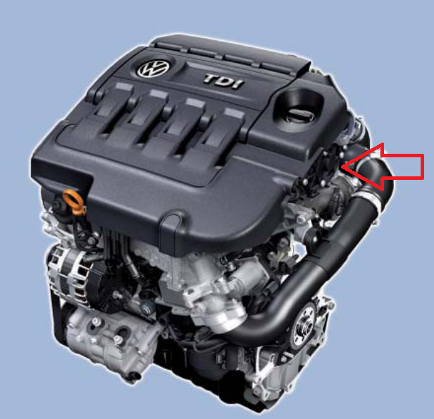

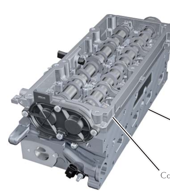

Hi! My 2014 Skoda Octavia VRS 2.0 TDI CUPA engine also suffers from high oil consumption way above 0.5L/1000KM.
Already had compression tested so it's not ring seals, I also suspect leaking turbo as there's some light blue smoke when revs are high during acceleration.
But I've also noticed some oil at the bottom part of the plastic cover on right side of the engine (crankshaft cover)? Is it possible that the oil is leaking through there? Is there any seal that maybe needs to be replaced?
I am attaching some pictures which part I am talking about.
Regarding the turbo, should I just take off the air intake from the turbo and look from oil residue there?
Thanks in advance for help.
Bad valve seals can also cause high oil consumption. Keep us updated with what you're finding.

Checked the cover on side and it's not that. Turbo intake clean, crankshaft ventilation hose has a little bit of oil vapour.
There's smoke coming out from oil cap and much more from oil dipstick. I suppose that valve seals could be the reason? Is there a way to diagnose it other than disassembly?
