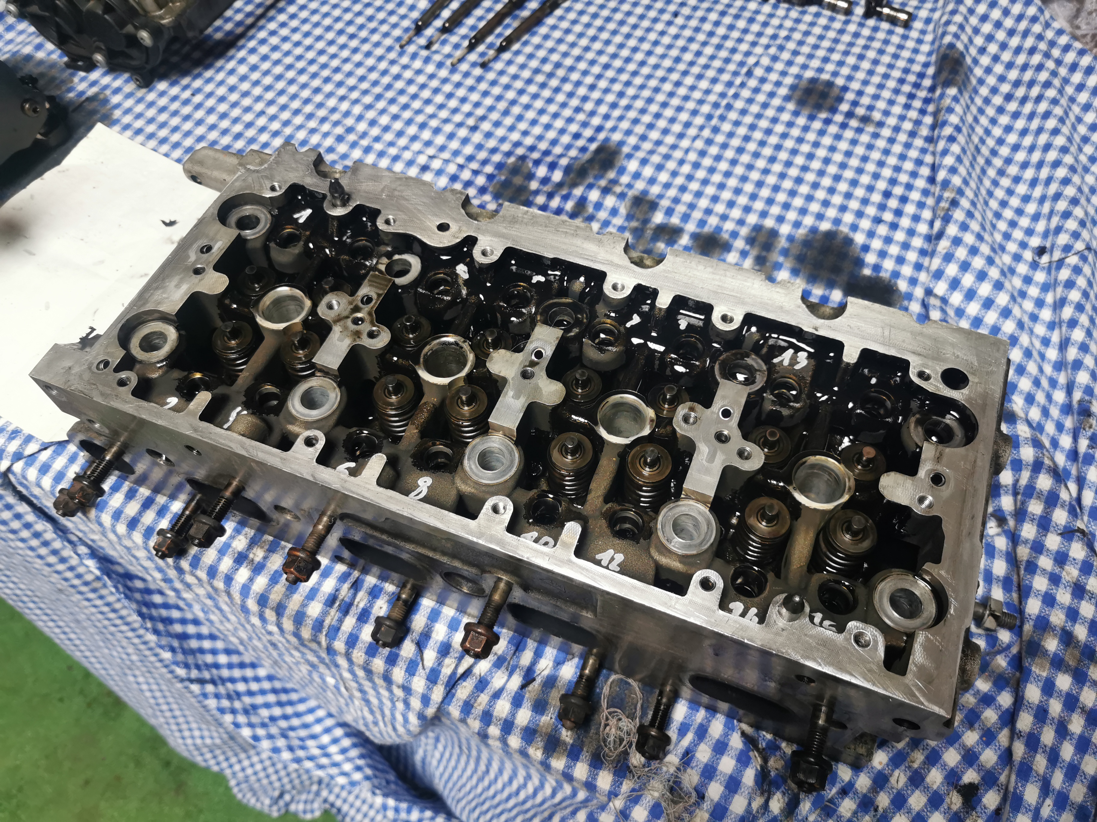

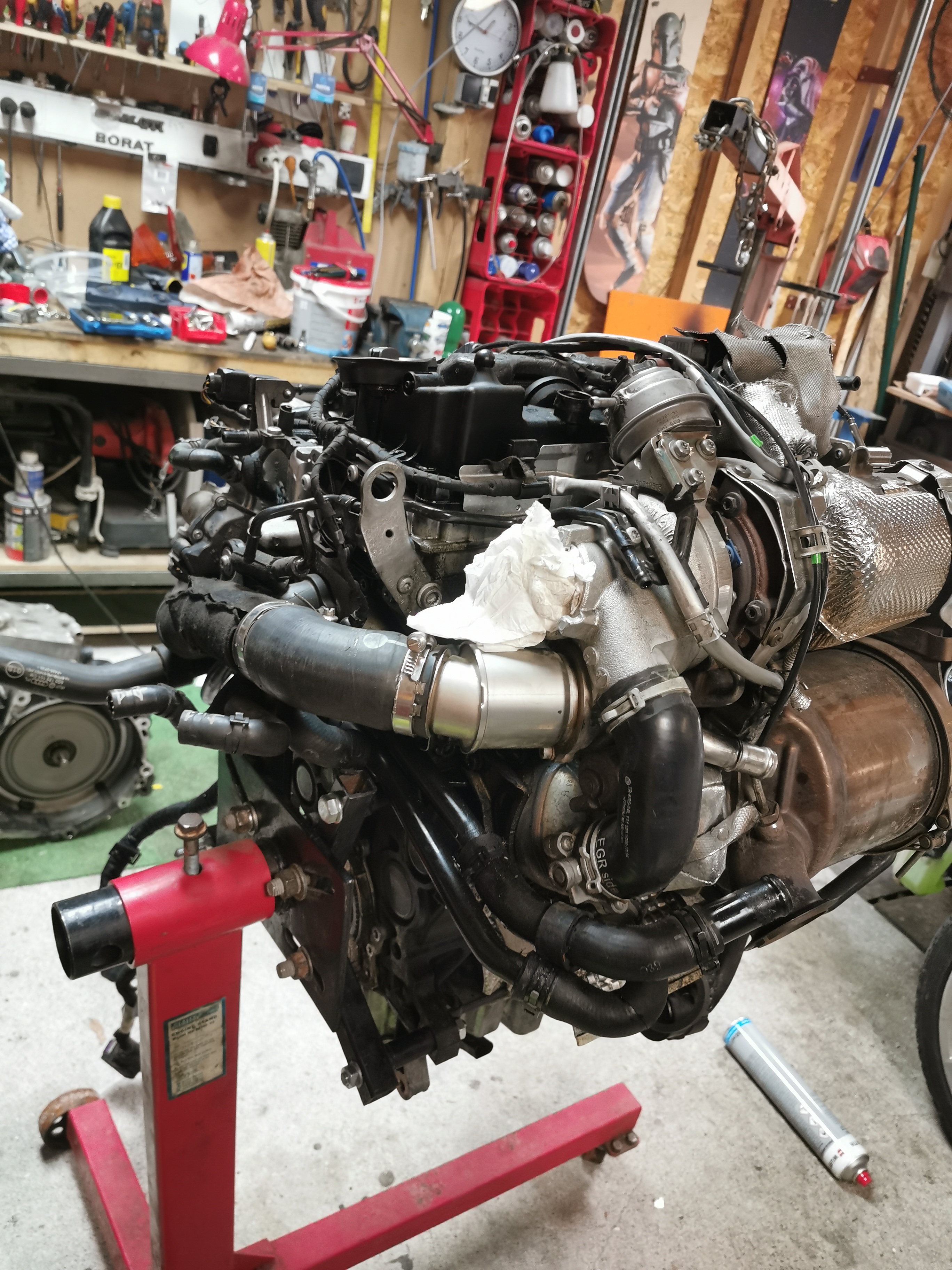

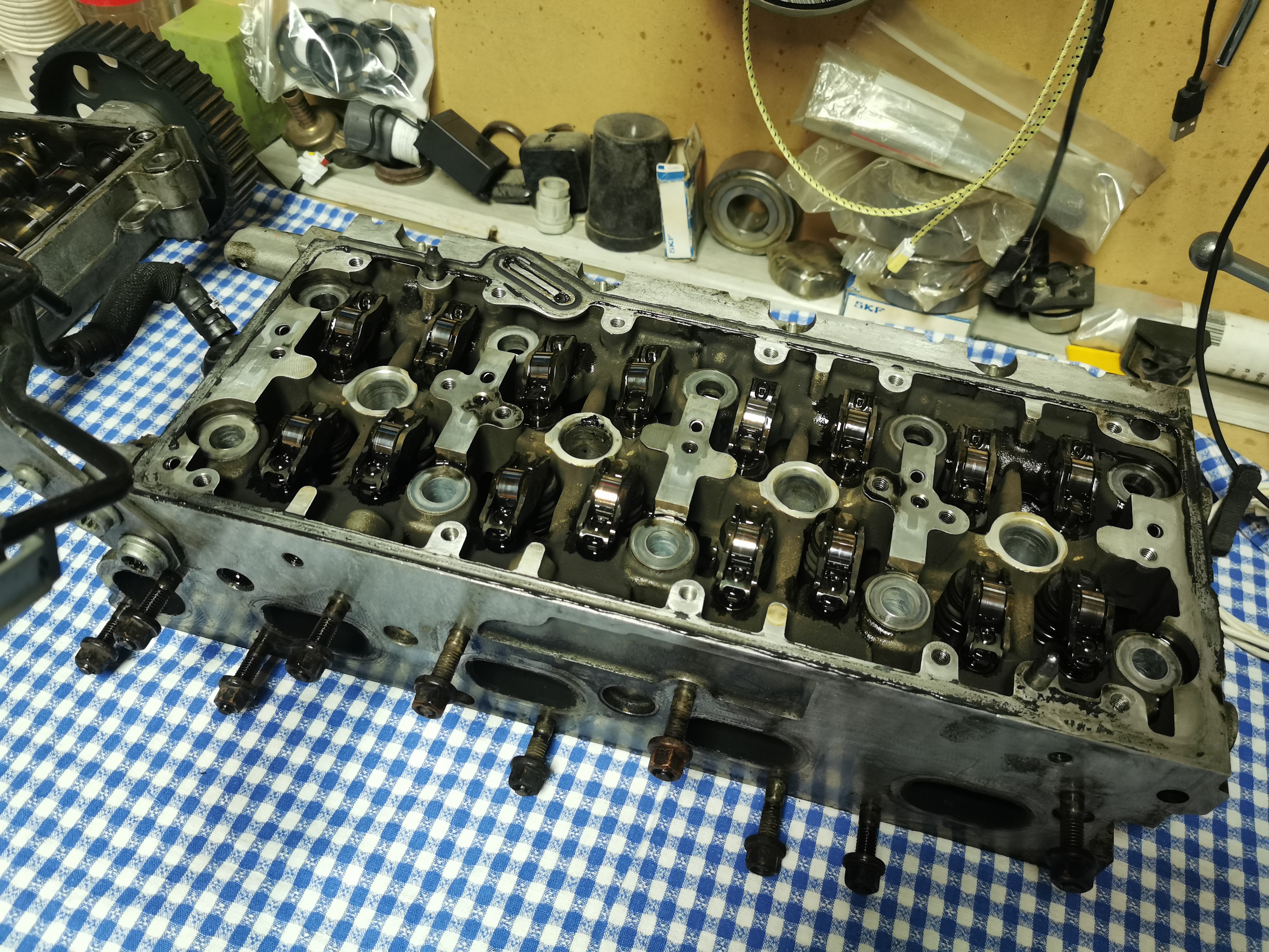

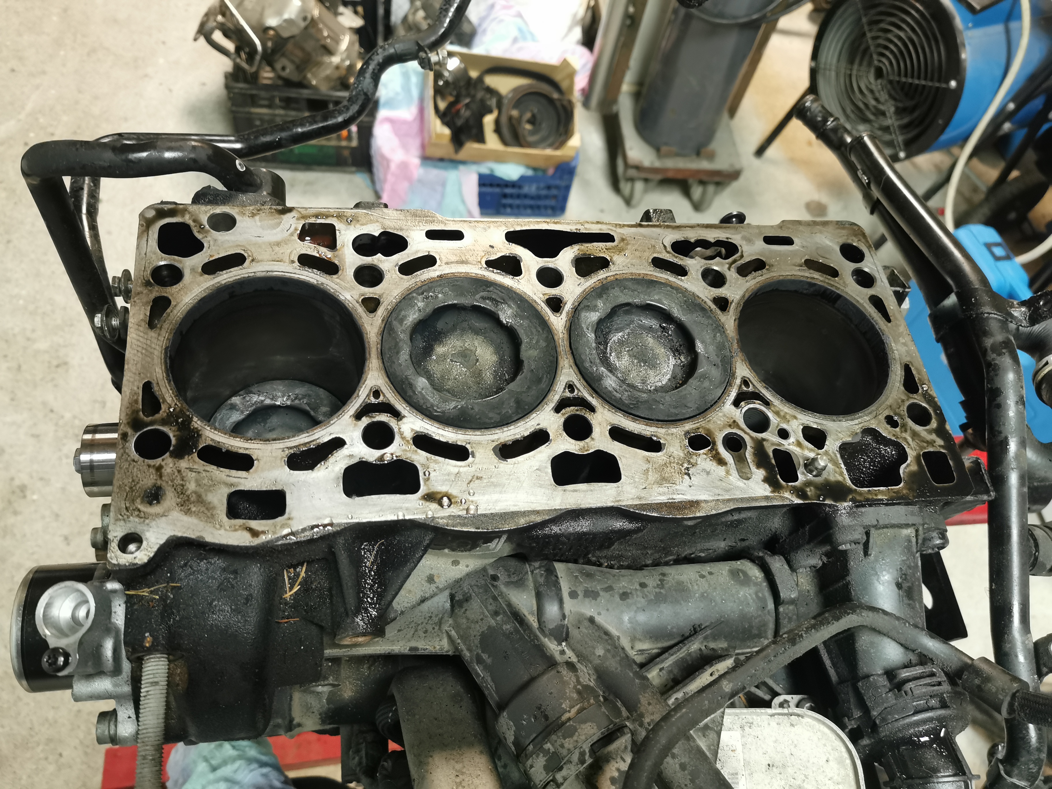

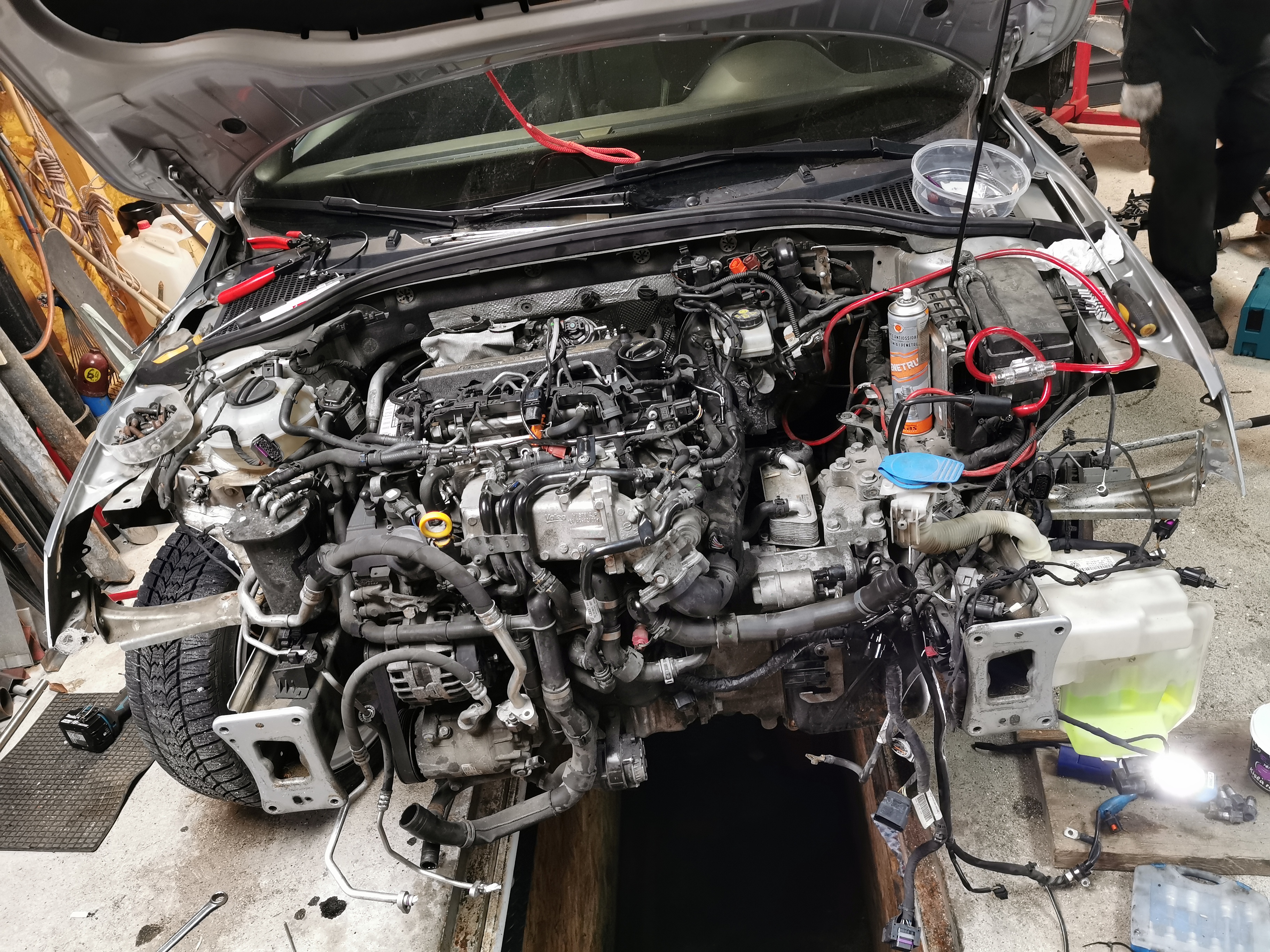

Soo i puled my engine appart 🙈
I cant upload any more photos. Anyway the pistons are good only the rings are shot to hell. Mine used up 1L per 400km of highway use. The bearings are ok but I will replace them. I'm a little torn up about replacing the main bearings. Mine has 200.000km so I'm thinking if the engine is open I should spend the extra cash and replace them also
