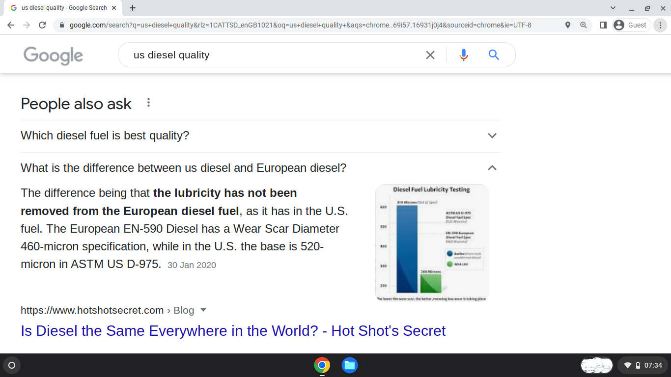

Oil tests / analysis and quality checks is 'Simply Clever'
In the USA there has been lots of Oil & Filter shops changing oil at short periods for decades.
But in the US there are different Gasoline Fuels.
Here we are talking Diesels though, so it is common sense if talking 'Oil Recommendations, Specs, Service Schedules you look at the difference between US Diesel / DERV  and European Diesel / Derv / Heavy OIl road fuel.
