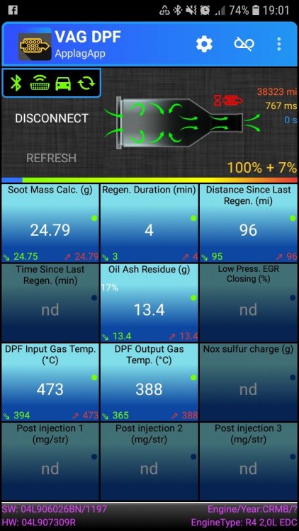

So applied the wynns as recommended. Then went for the 3 miles, again as recommended. As i started out i thought i would open the app and see if the soot had increased in 10 mins. A bit shocked to find it was 100+7%. Have nevr seen it above 95% in my last octavia.
So whether or not the wynns cleaned the egr, it definitely loosened something! Took forever to get the dpf back to 25% as although it was burning as fast as it could, i think the engine was still dumping soot and prob will do for another few hundred miles.
Screen shot of dpf app attached.

Car was run for 2 days with millers diesel additive and some harder acceleration. During this time the soot output to the dpf was consistently higher than normal and not just when I put the boot down (monitored through DPF app). After 10 mins of spraying Wynn's into the engine, the DPF had accumulated soot equivalent to being driven over 200 miles under normal conditions (again as displayed by the DPF app as my original post). I've been driving a diesel with DPF for over 7 years and monitored the DPF app regularly without ever seeing it fill like this, and that includes after the car was remapped.
If as you say all these additives are pure snake oil, feel free the explain the above.

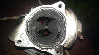

I would be interested to see how long it lasts for. Having cleaned a few EGR valves I suspect it’s removed very little as it won’t have had time to dwell and dissolve the real grunge that reduces airflow but enough to show as additional soot. You’re normally able to tell when the EGR is clean after driving with a dirty one as the engine will be more responsive to your throttle inputs.
Next time I have an EGR to clean I might get some Wynns to try direct and see if it’s anymore effective.

This is an old EGR valve and as you can imagine it’s not too hard to remove some of the grunge in there with a spray cleaner under compressed conditions  but to really clean it takes time, lots of cleaner and mechanical removal.
I watched a youtube clip before buying the wynns of someone testing it on an egr. They removed and showed the EGR before and after. The Wynns only removed the freshest looking crud (probably the most recent layer) but did little for the years of build up underneath. Possibly if it were used at every service from new it may make a difference over the life of the car. It was by no means a resolution to a blocked EGR. I used it as a preventative measure as i'll be holding onto the car for a while. If it works it works.
Completely agree.
I’d agree with that as a maintenance product it would work but as a cleaner it would have a minimal effect.
No doubt you could run this through week after week and it would gradually removal the gunk but the cost would be far greater than fitting a new EGR.  Not sure what damage it would do to seals etc if you were to do so not recommended.

There is another confounding factor - we are taking it trust that the VAG DPF app accurately tells us how much soot is in there. It's not impossible that the fuel additive does something that falsely raised that reading, either because it burns to soot itself, or changes the properties of the soot so the DPF "reads" differently. Different particulate size? different unburned hydrocarbon-mixture properties? etc. Not to labour that point though, it's conjecture, but it adds another level of doubt.
