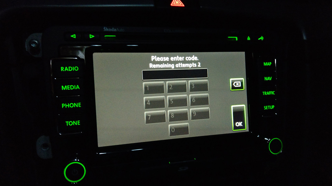

Not required, the code is only required if the radio/nav unit changes its car. As long as it is VIN coded to your car's VIN, you can freely disconnect the car's battery any number of times, it will always come back online properly (unless its memory would somehow be corrupt, but then you have a faulty device)
For the reference and for those of you who've never seen the code page - this will appear after the boot logo/splash screen only if the unit changed the car or if it somehow lost its VIN coding:

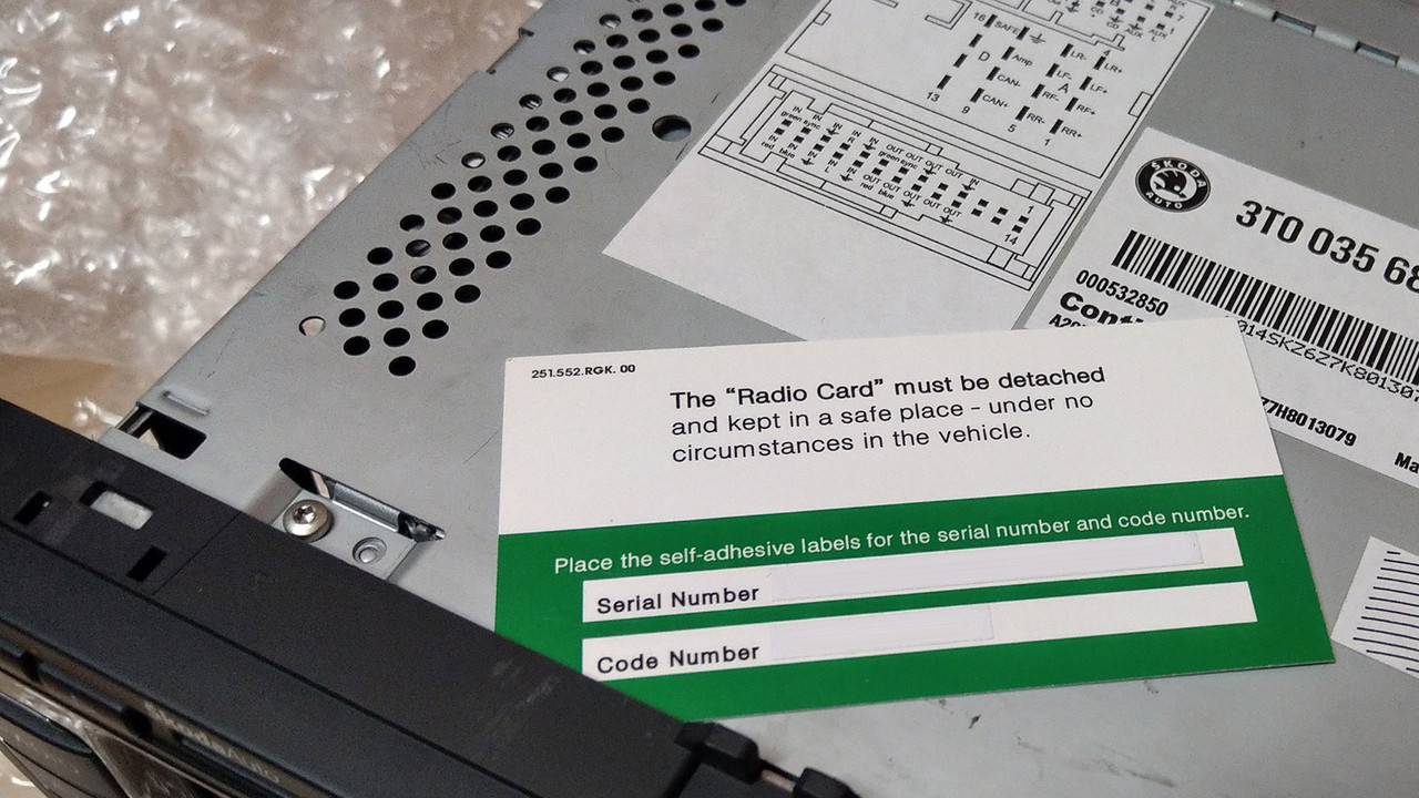

The original radio/nav card with the code looks something like this (the data is purposely blanked):

You can buy the code on ebay for some 20 GBP (there are people out there who have connections), the only thing that is required is the device serial number.
Radio or bcm must not be the original unit if it asks for a code after battery changed
