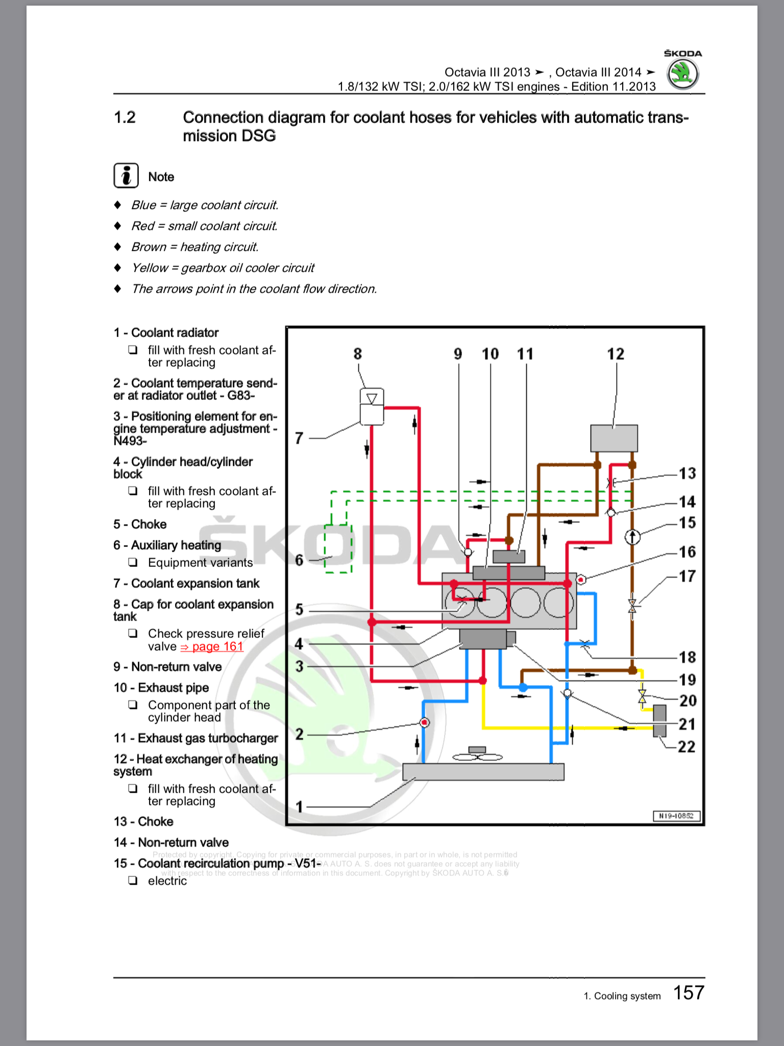

Turbo replaced, engine reported as not needing to be replaced.  Temperature Control Unit replaced.  Test driven this morning and it seems the original fault (no internal cabin heating) is still there.  Given the turbo and heater matrix are on the same circuit, they're understandably being cautious.  Is the turbo and heater matrix coolant line only served by the electric pump does anyone know?
I know it's not the same pump, but it's just got me wondering about plastic impellers and metal shafts - scrub that, just spoken to Skoda who said that'd throw a fault due to amperage drop.  They're now going to measure the internal temperature sensors, as if one of these is registering high/faulty, it won't call for hot water.

Hope they sort it. I read the self study guides for these engines (borrowed from a VW tech friend) but don’t have access to them anymore. There’s all sorts of stuff on the cooling system, including, I’m sure, a coolant shut off valve for the climatronic system. Your dealer should have access to all that info and more...

It is correct that there is an electric water pump (No. 15) it is used primarily to cool turbo etc. When the engine is turned off, I will not reject it also used to pump hot water into heater In the cabin to speed up the heating in the cabin when the engin is cold. the primary water pump for the engine is No. 19 on the chart

They are going to replace the electric water pump tomorrow (no.15 in Knudsen's pics, I believe).  Possible that the pump is causing red herrings elsewhere.  Interesting.
Gaz
 unfortunately there is a general problem with the water pumps, I have just replaced both water pumps (19 and 15) due to leaks (the symptom was slow loss of cooling water) on the main pump (19) there was a crack in the thermostat housing (that is part of the pump on This model)

I don't know all final details yet, but it turned out to be the coolant check valve, showing as open when it was actually closed.  Just discussed with the mechanics who worked on it and they are happy the engine is fine - all mains shells checked and they were fine, oil pump was fine but has been changed as a cautionary measure.  Nothing reported to have got past a gauze filter so top end fine.
