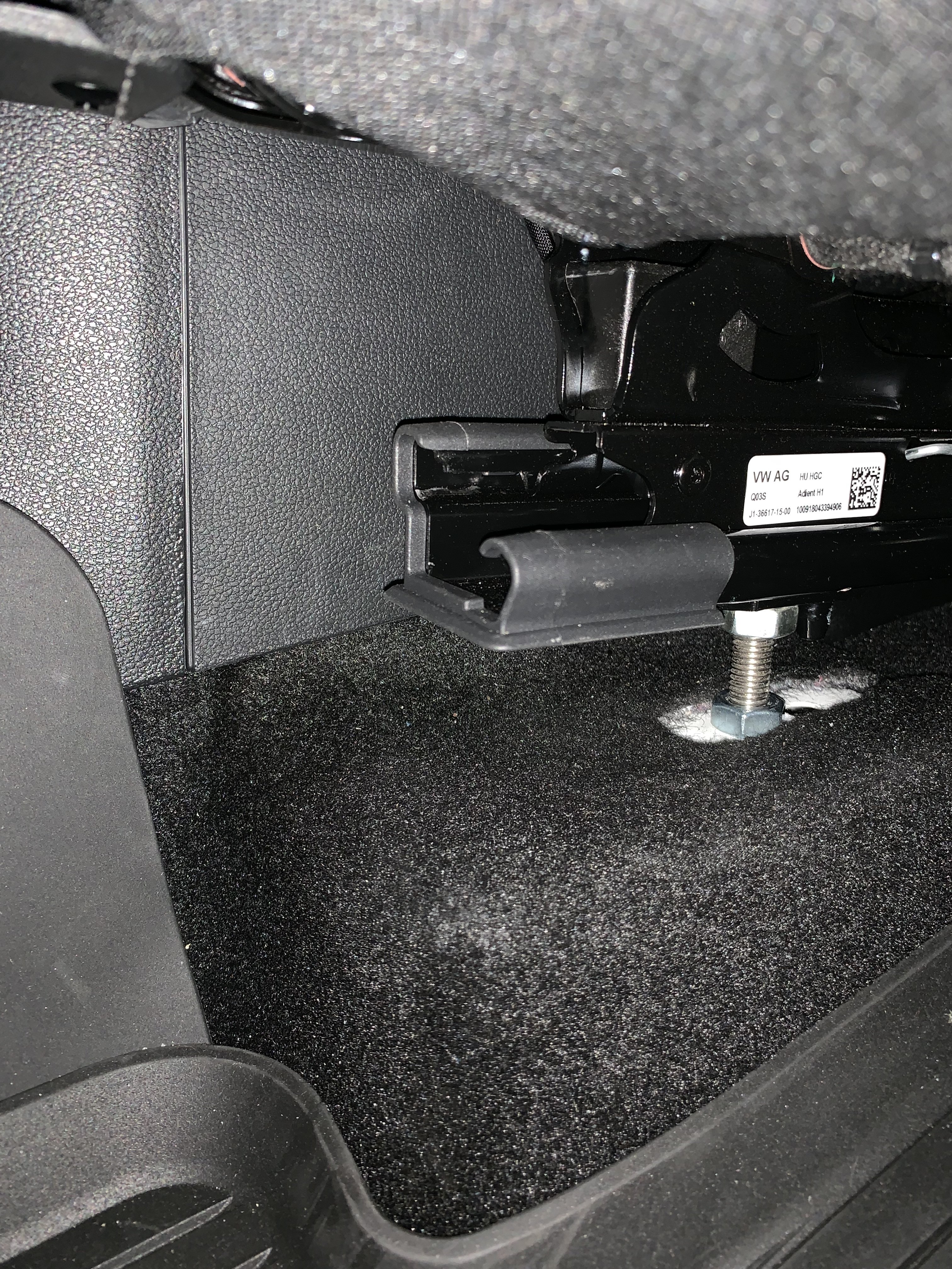

I changed the seat bolts at the rear for longer ones and lifted up the rear of the seat frame. I did this on my Yeti too. Only takes few minutes
I have had a look but cant see quite what bolts you changed.  Any chance of a photo?
Loosen the front bolts. Slide the seat all the way forward. Remove the rear bolts and replace with longer ones. To space out or lift the rear of the seat frame I used two nuts. This means you can vary the lift by fiddling the nuts. It’s a bit messy but it means you can fairly easily change the lift. Alternatively use a piece of tube between the bottom of the frame and the car floor. Obviously this is a fixed distance but you could try different lengths etc. 6368B822-EFA7-4CC6-A635-29B9355C5F23.thumb.jpeg.88683979d6993f128d7399e3a8ee1044.jpeg
Thanks I can now see what you have done.  Will give it a go.

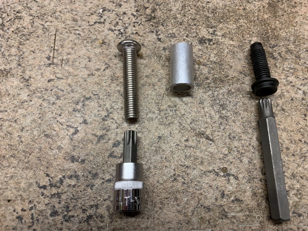

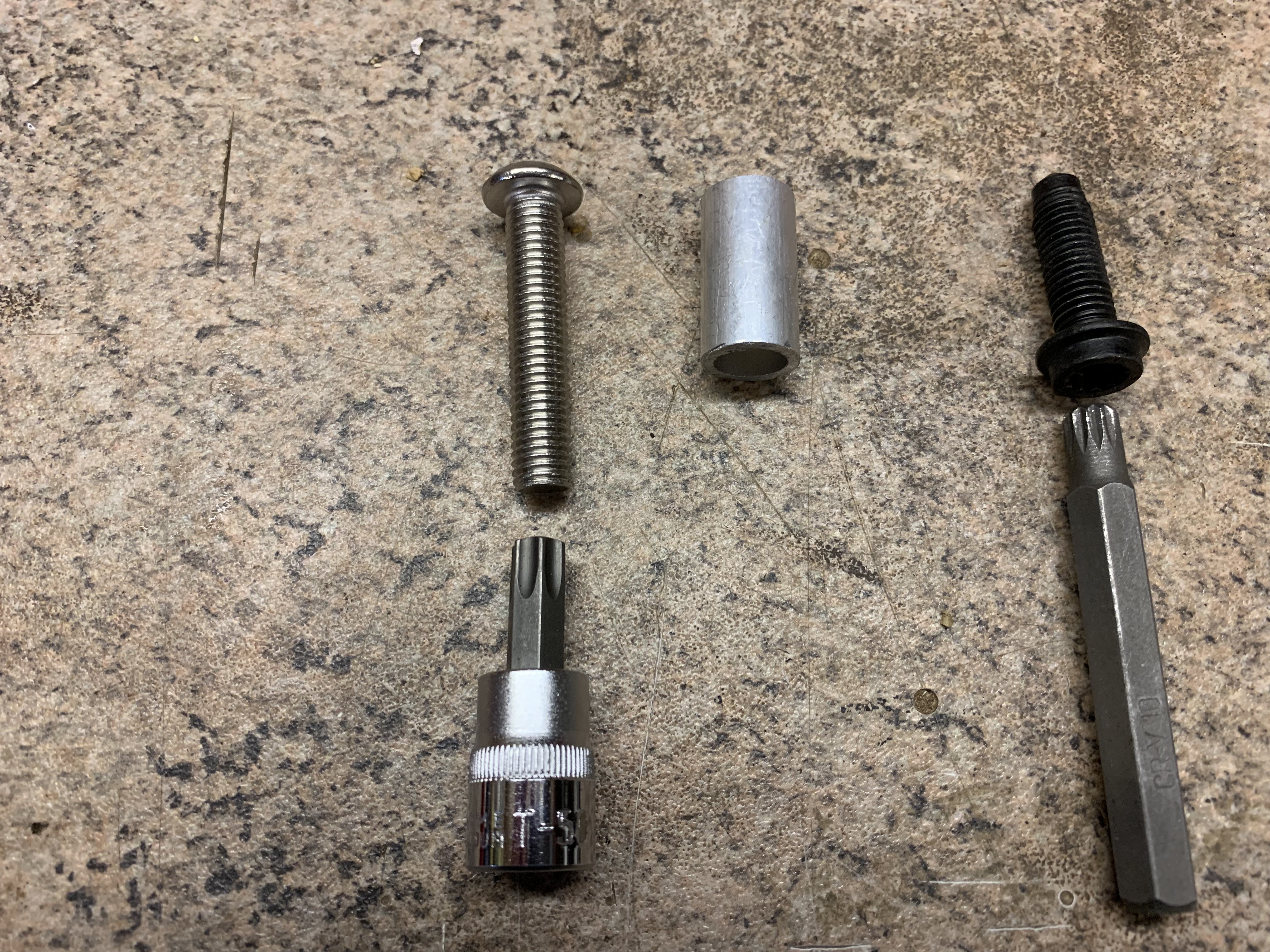

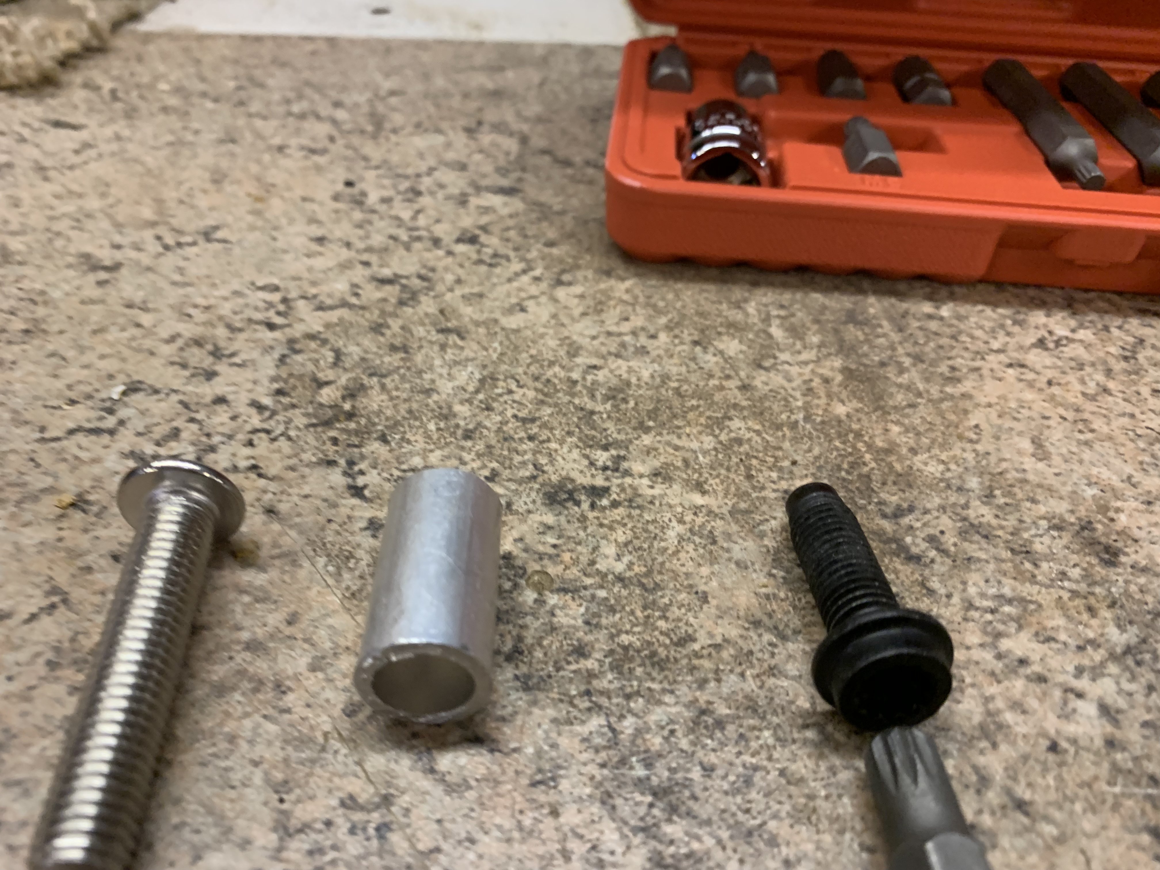

The original bolts have an odd head/socket - do you know what type it was and/or how did you undo the original bolts. I see you replaced them with hex headed bolts/nuts
I think they are called Star Splined or something like that.  They are not Torx but if you are careful a Torx bit will work . Hex head replacements from the bay of E.
I don't like to use the wrong tool so i did buy a set.  I will try to post a photo later
I’ve pictured an example of a tube spacer, a T50 Torx bit and the correct M10 Splined bit up against the original bolt and the replacement hex socket (Allen head) bolt. I actually used a slightly longer one and cut it down but you will get the principle
Edited by 33q
Should have made clear I used an Allen bolt not a regular hexagon bolt

Have done the job now as you suggested.  The seat seems much more comfortable.  The real test is how it feels after a 2 hour drive.  Thanks for all you help.

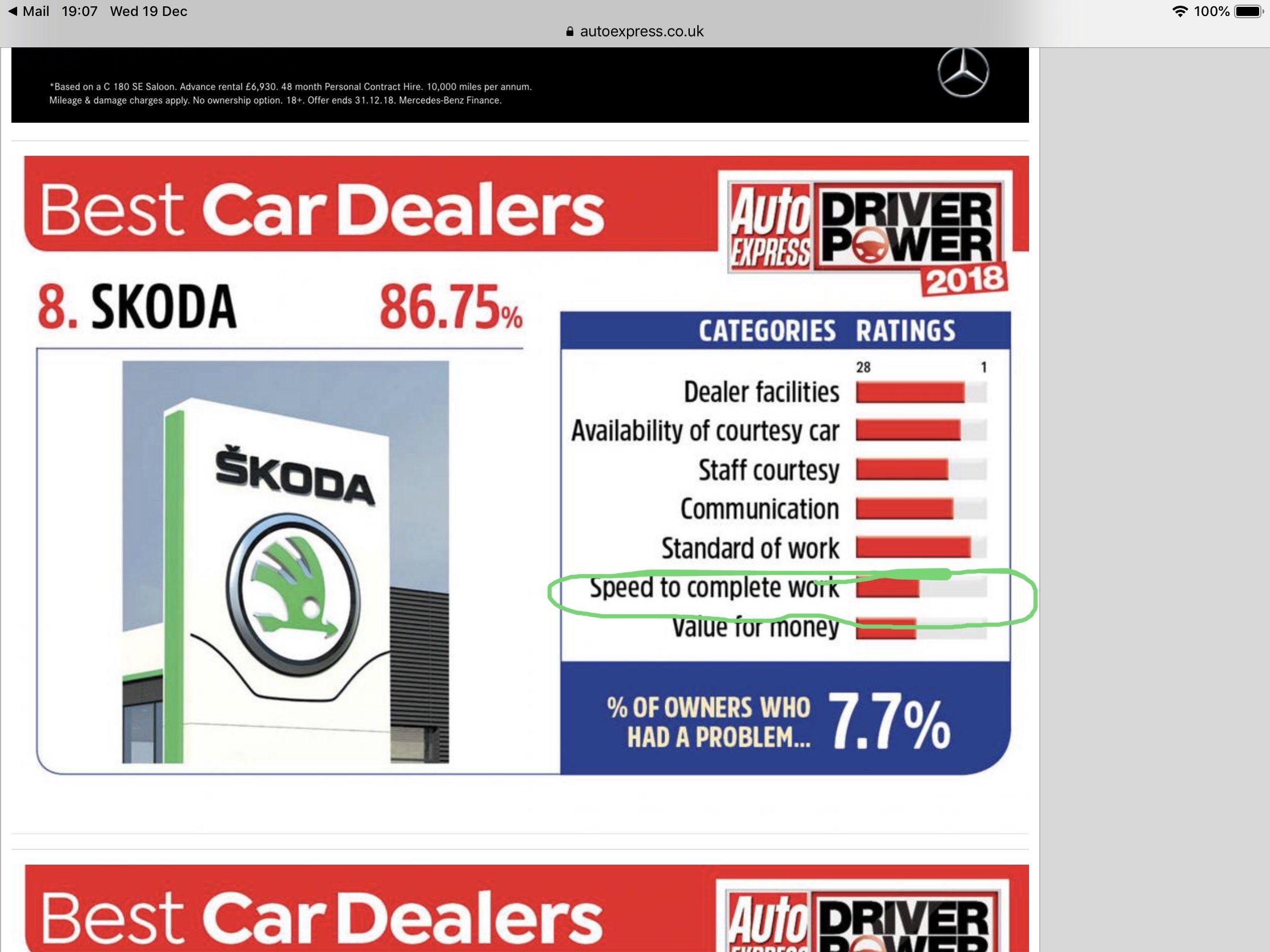

Thanks Sad555 for the information; 7.7% of Skoda owners had a problem? This is a shame because Skoda have done so well pulling their reputation up to a very high standard claiming many prestigious awards but from comments posted on this thread alone Skoda appear to be slipping. I note you now run a Kia.
