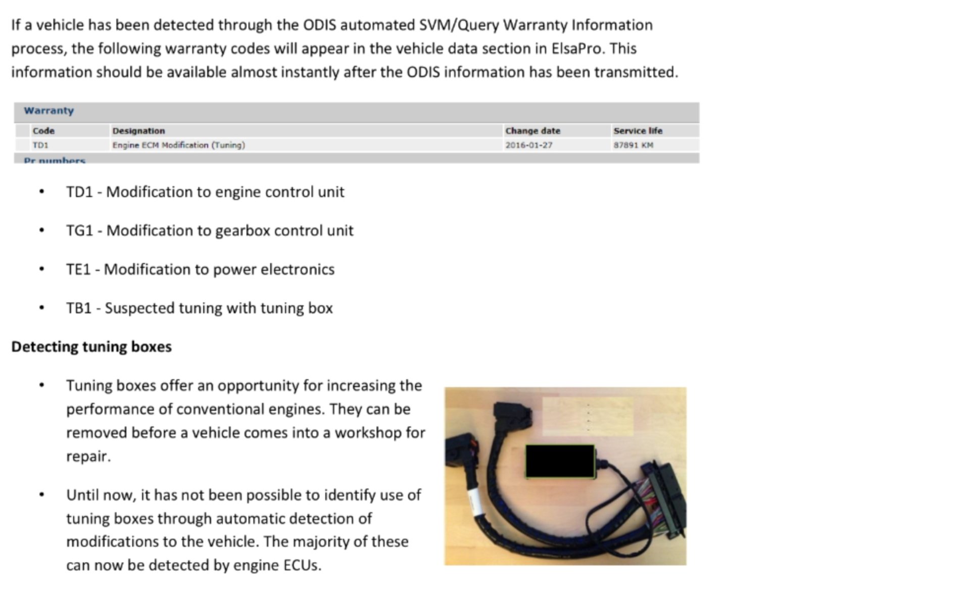

Oh and anybody that says tuning boxes do not leave evidence is not being completely truthful; in the event of a warranty claim, do not be under any illusion that out of band data can't be seen.......especially when you're looking at a warranty claim on £8K's worth of TSI engine.

Great point, well made, a little short prospective though, the work required to recover the "out of band data" & interrupt it, is quiet extensive & therefore, expensive.
Realistically, you gotta need £5k of warranty to get VAG to sign off on that much expense.
Let's not forget a JB4 leaves the same "exceeding standard operating parameters" whereas the remap, changes the qsum counter on the ECU so, that's seen at standard service.
If you mod your engine for more power, they can tell, if you give them a big reason to dig deep enough, Nuff said ?

Has anyone experienced a TB1/TD1 flag with either DTUK or Racechip module ?
(not even sure if the rumors about TB1 flag(suspected use of Tuning Box) are real)
