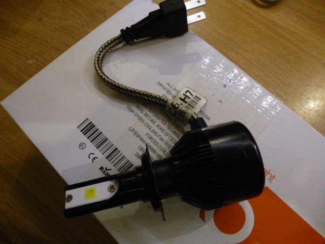

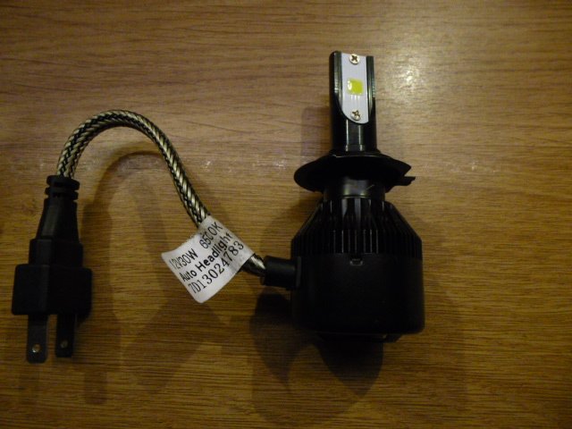

Can you post a link of the LED bulbs you used?
If you're getting an on-dash error, then it is likely they aren't CANBUS-friendly i.e. don't have the blown bulb-warning cancellers built-in.
h7 led,s
