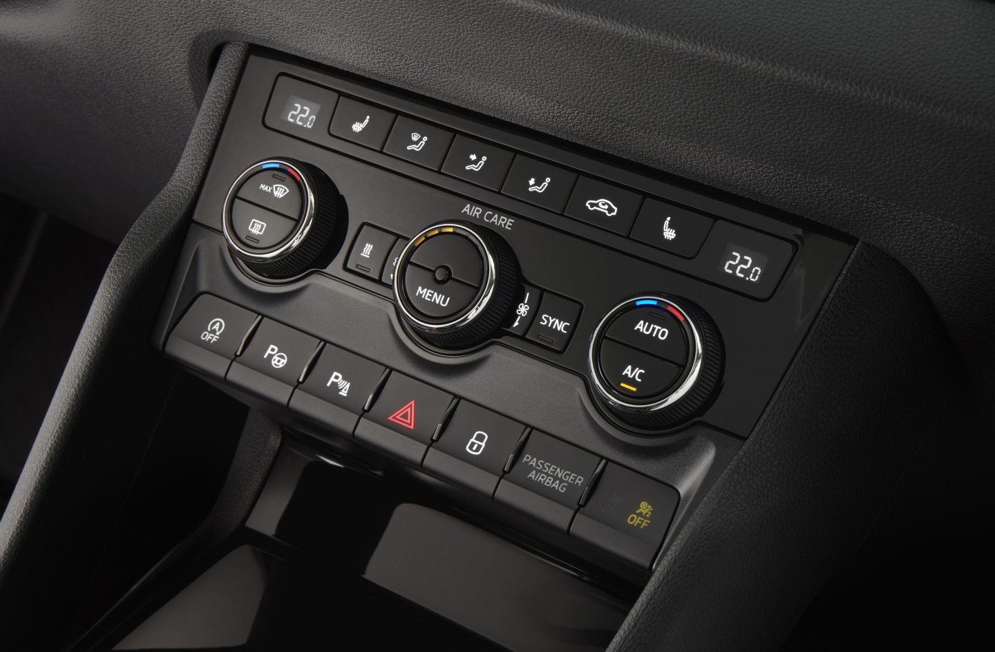

I've got into the routine of turning stop/start off after starting the engine.
No need to try and second guess when the car in front will move off, or the traffic lights will change. No jerkiness or lag, no reduction in Climatronic performance, reduced degradation of the battery. Less engine wear. The only slight disadvantage is the slightly shinier button on the dash.
I’ve been pressing that button in my Golf for almost 9 years and the button doesn’t seem to have suffered.......unlike the drivers window down button that looks very shabby now.
Good to know!
I like the buttons on the Karoq / Kodiaq, you can press the smaller lower edge of the button leaving the symbol free from finger pressure and grease wear :D.
