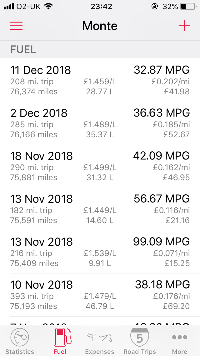

Extremely good MPG! Not...
For the past couple of months we've been using the 1.6 tdi for motorway journeys only. And every time the Maxidot show the average MPG in the  70s which is hybrid car performance, however, when you actually do the maths on a full tank (until it hits reserve) gives us 450miles. Today we did a 200mi round trip 90% motorway at 70mph and it averaged 75mpg apparently. I know cold weather and all of that but the actual consumption is basically the same.
It didn't used to be like that, why is it lying this much??
