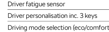

Ditto - Despite having
Listed in the specification (MY19 SE Technology, I only received 2 keys.
With memory electric seats (std on VRS 245 MY18) you get three keys.

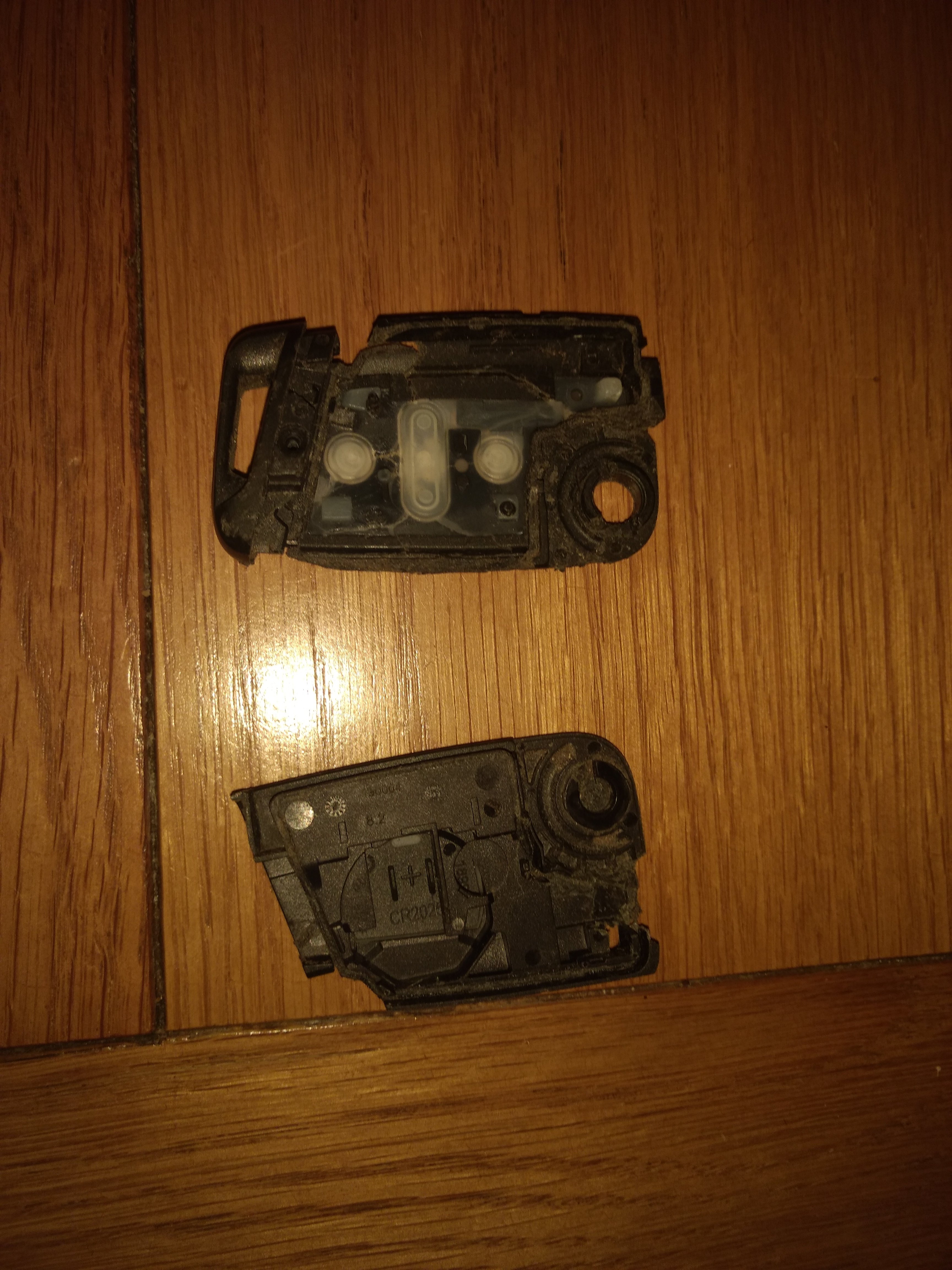

Not quite sure which hollow bit you mean, but I didn't get all of the old key plastics back. The bit which runs the length of the fob to hold the two sides together was gone.
Edited by juan27
See the attached photo.
