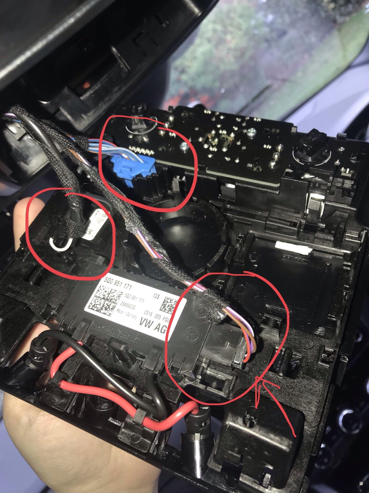

Can i disconnect the three plugs without upsetting alarm?
Honestly couldn’t say, I didn’t, I just removed the motion sensor from the trim.

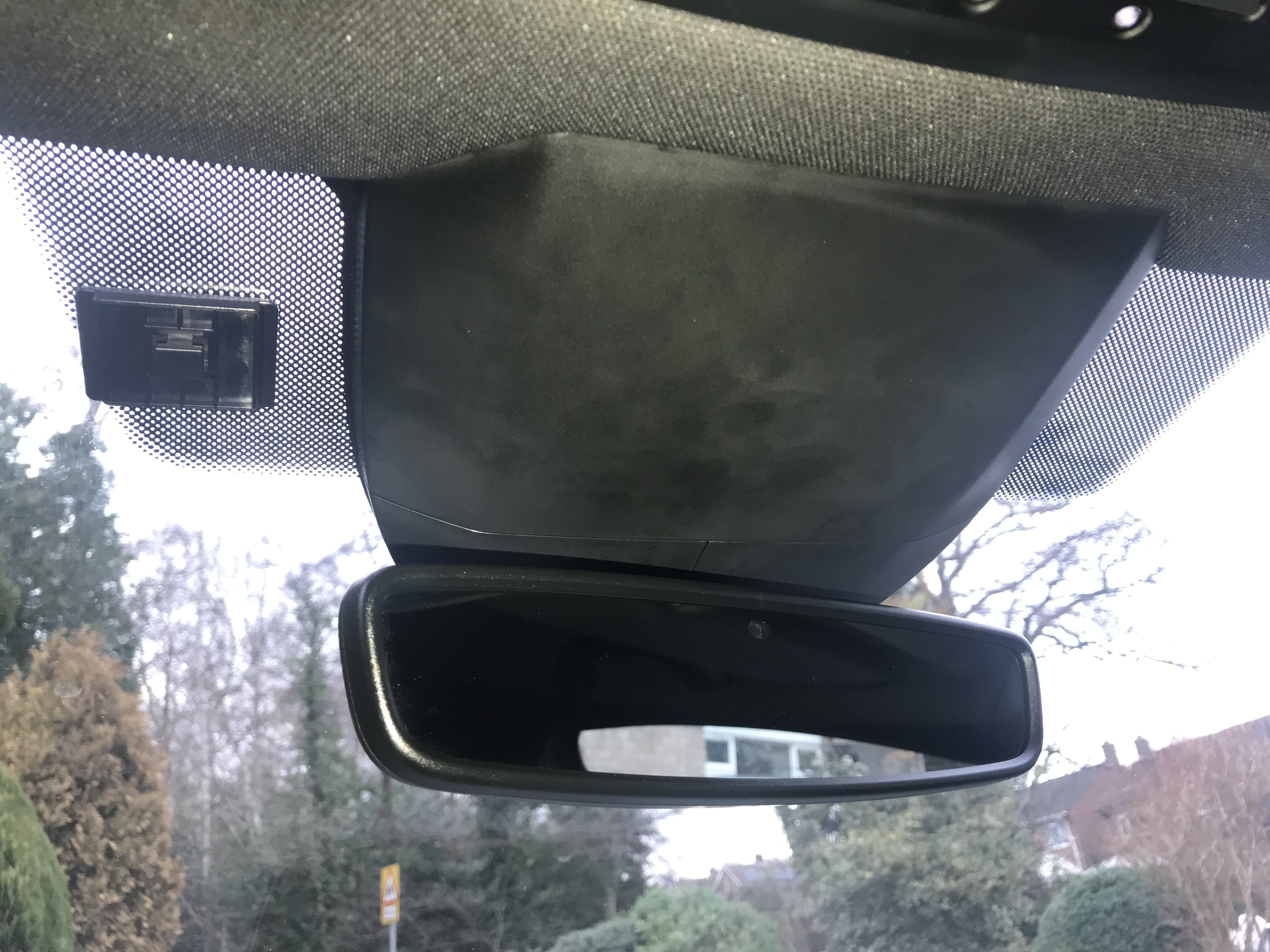

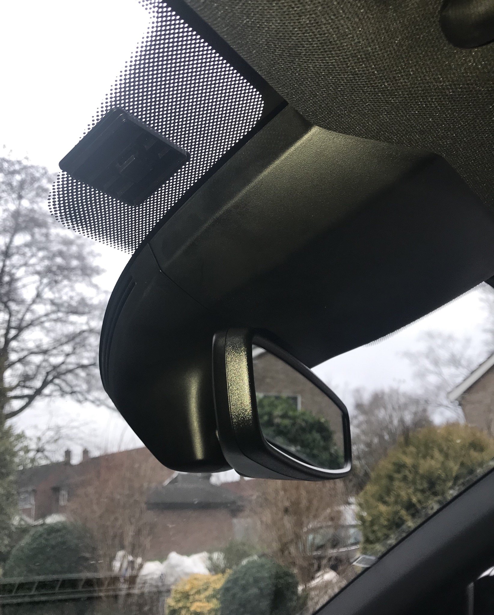

I'm now convinced it's the rear view mirror shroud which is moving or flexing against the glass. Any ideas how to remove this?
Neither of the guides look like mine. I've only got the rain sensor I believe.
